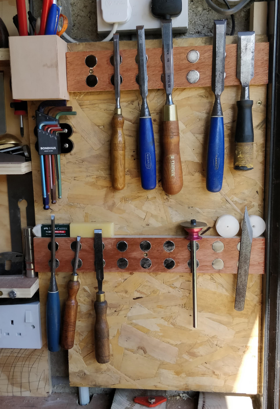

Maybe it is trick of perspective but the top row of chisels look to have interesting laceration potential when using the electrical socket.
Some nice ideas there. Personally I cannot stand magnetised tools. Does my head in picking up an Allen key or screwdriver with swarf or grinding dust stuck to it...

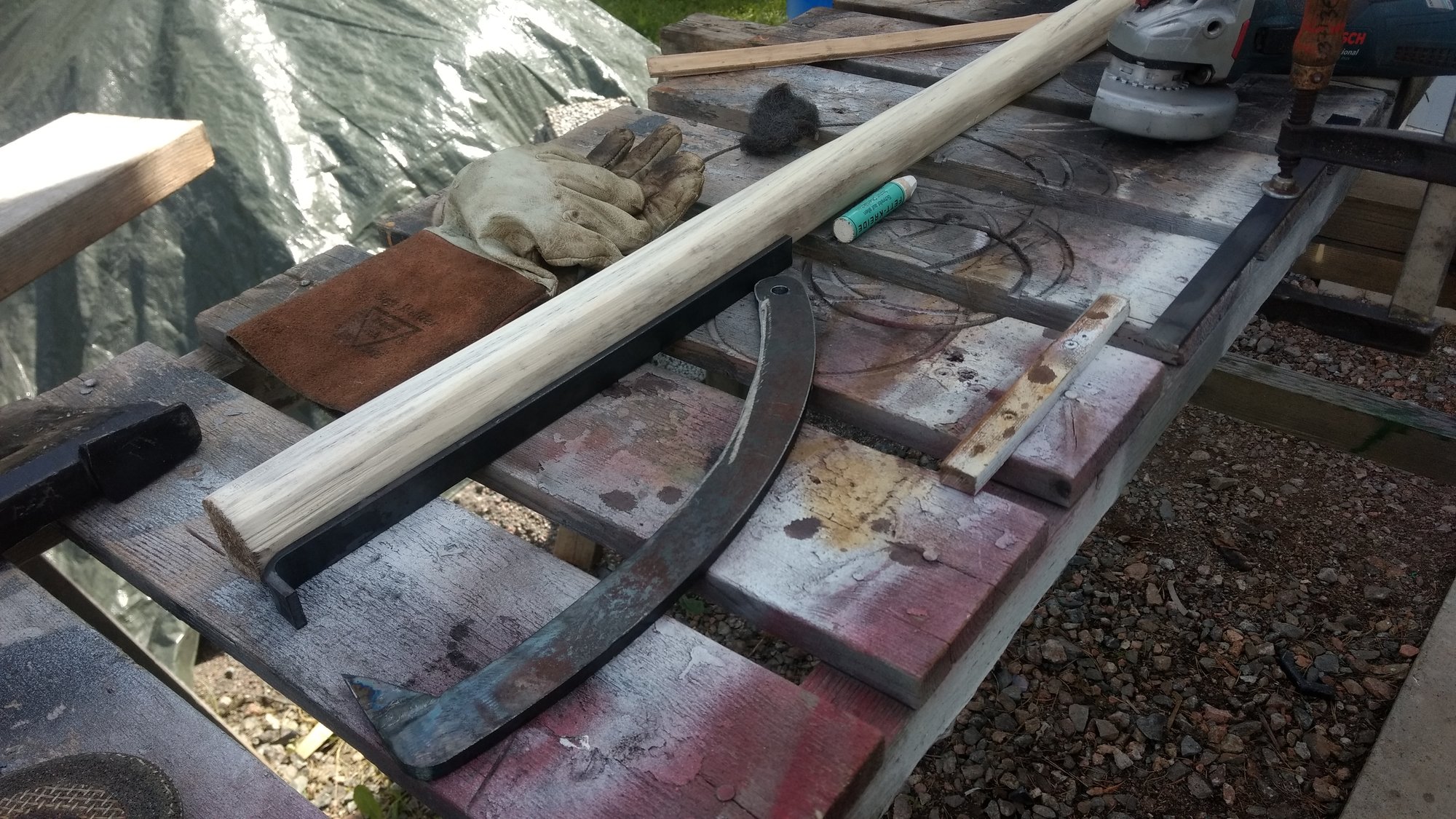

Cant hook is working now, though needs some refinement yet I think.

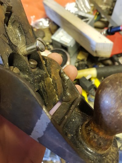

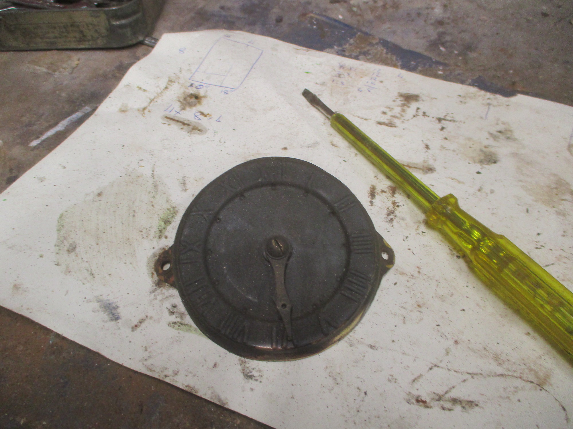

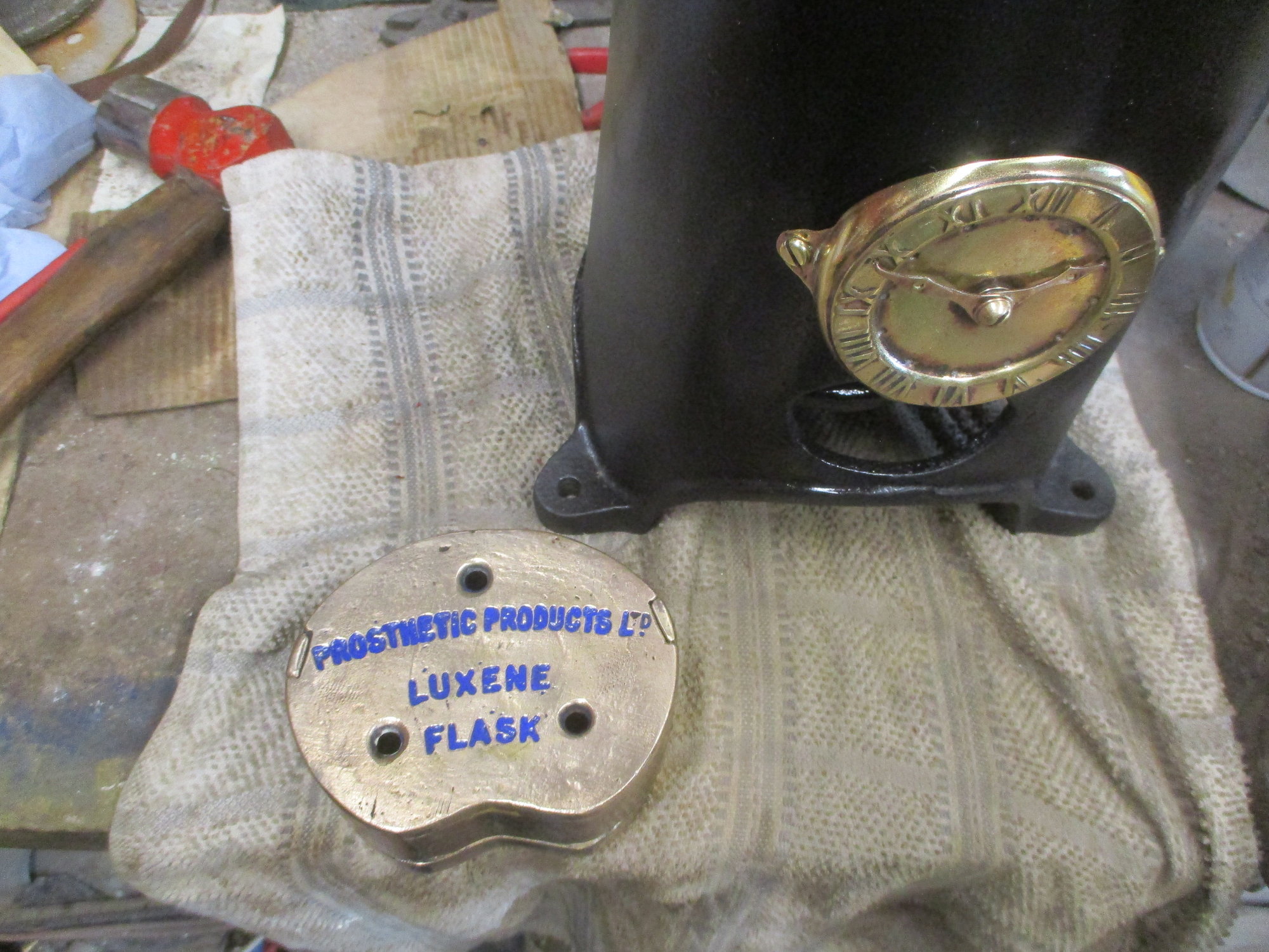

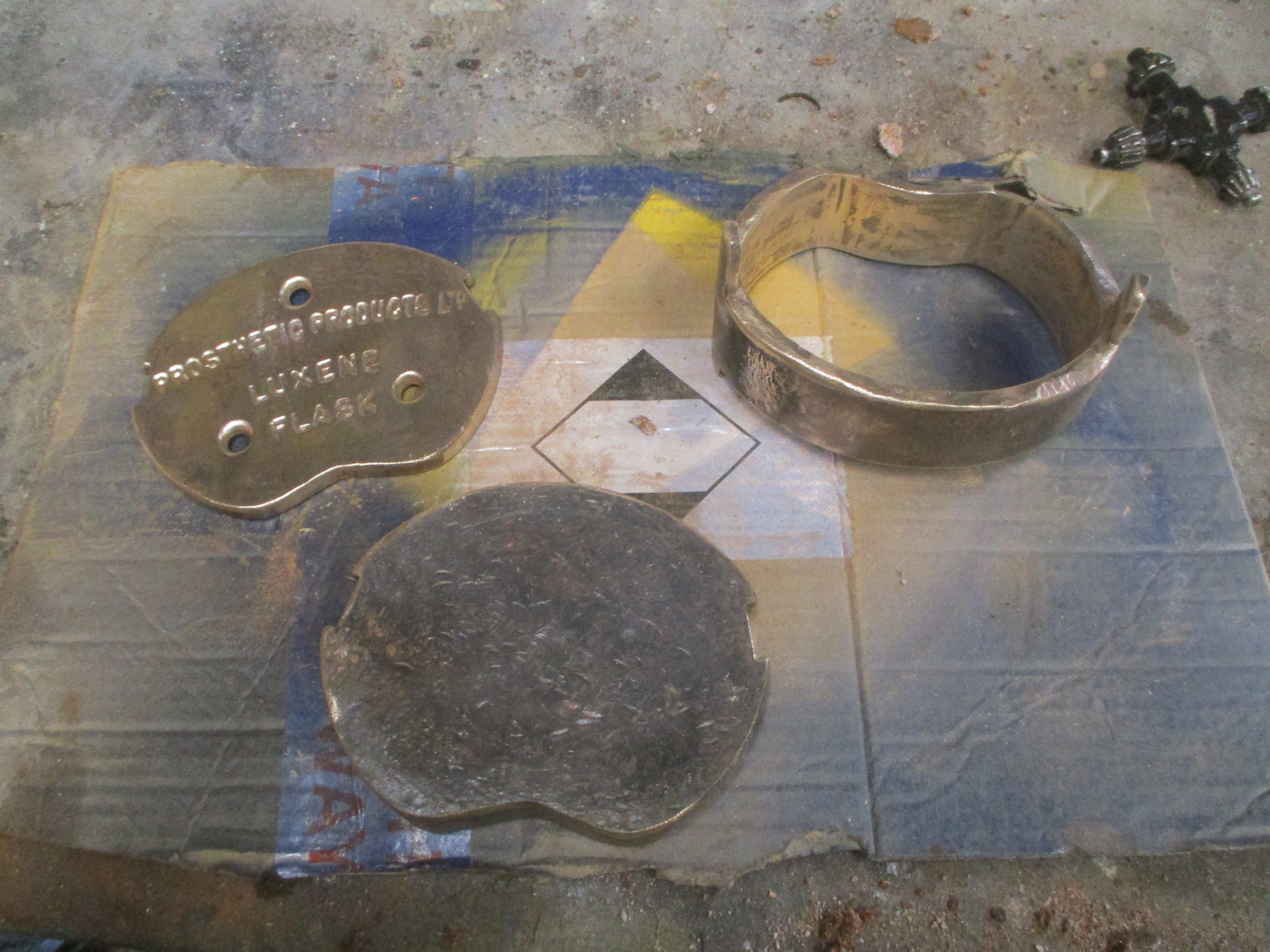

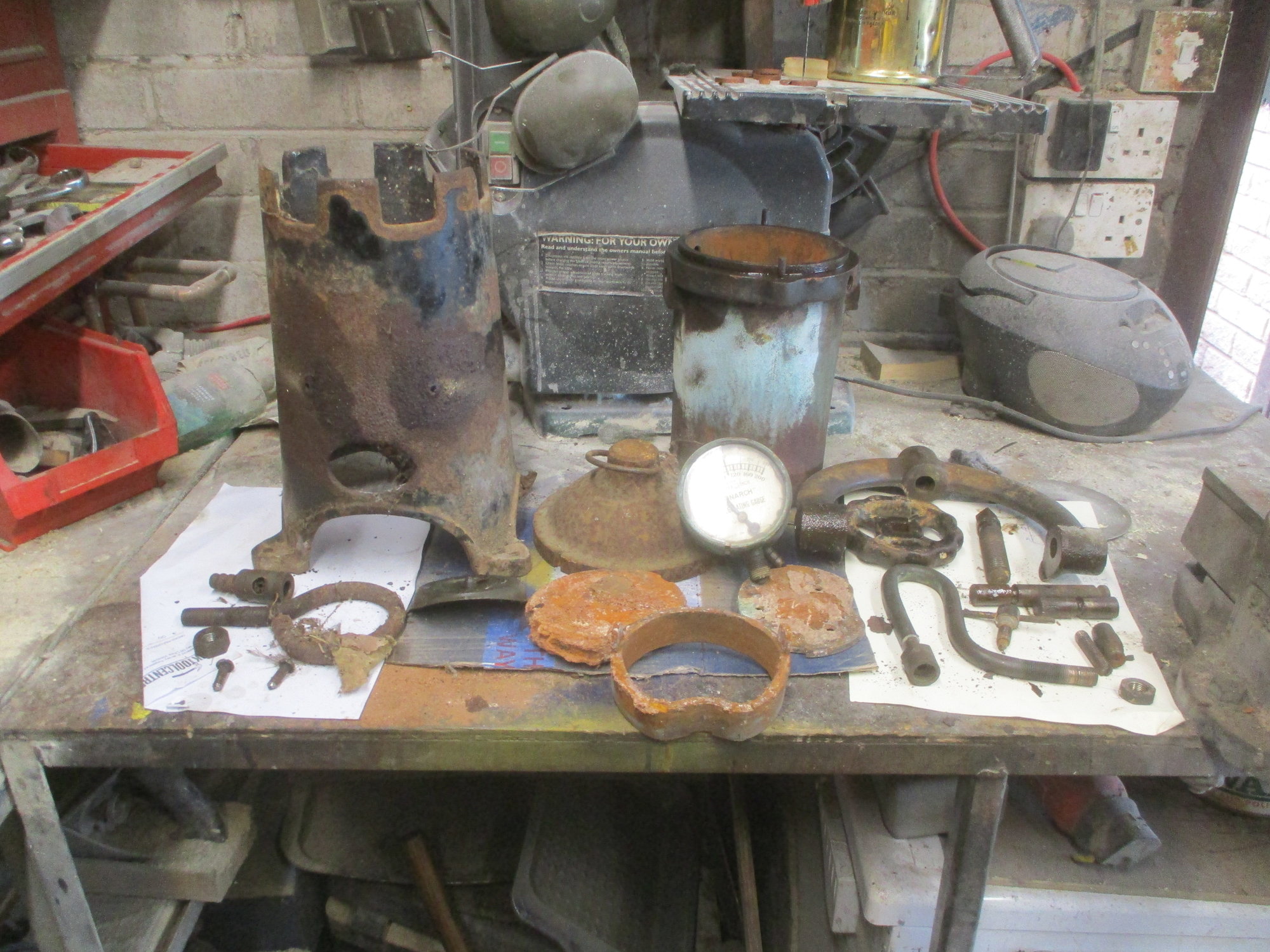

This item was part of a bigger item I acquired the other day.
My first glance at the first pic and I thought it was a very poorly made burger.....![]()

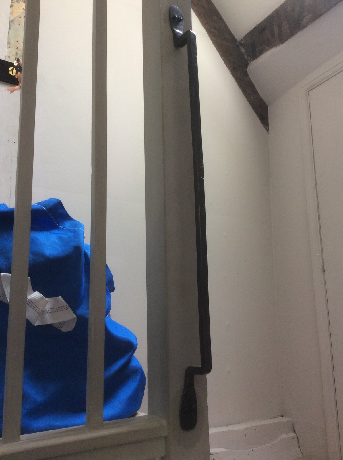

One of the (relatively few in my opinion) advantages of being 1.98 m (6'6") tall is that I can make full use of the roof for storage!

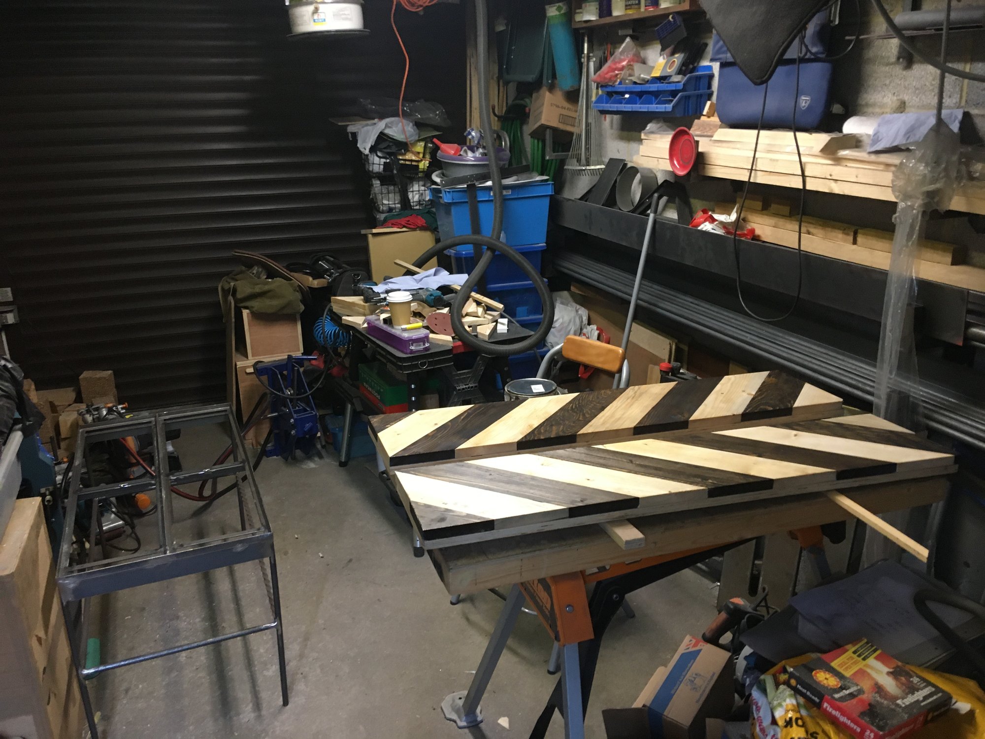

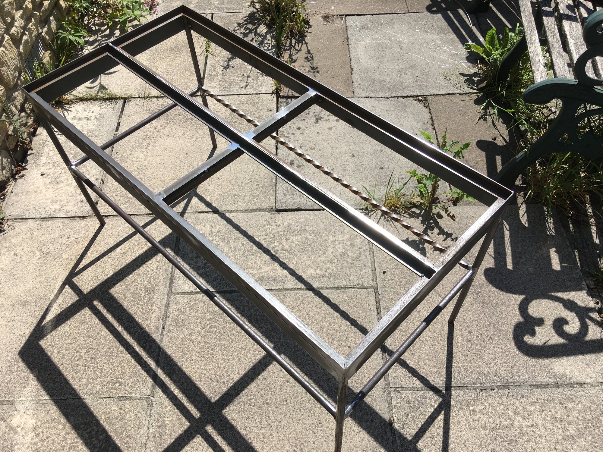

That gap would look good filled with stainless or bright steel or brass.Saw a small pile of pallets dumped somewhere nearby, so liberated them.
I sanded a few up, and thought they'd sit nicely in a steel frame.
Eventually the pile was just in the way, so it had to be used up, and made into something - anything!
I can't remember why, but somehow the frame ended up divided into two halves - so the pallet wood went into each half, but with each half going in different directions.
The frame itself is fairly sturdy - the top strip is 50 X 5mm, with 20 X 2 angle around the inside of it, to support the top.
The legs (and the other inter-connecting round pieces) are 20mm round bar, and the centre cross piece underneath the angle-iron support frame is 1'' square box section with a 3 mm wall.
The slats were stuck onto pieces of 18mm ply, partly to raise it up slightly so as to be able to see the end-grain, and also just to keep the damned slats still!
There's obviously a gap in the centre, as there are 2 pieces of angle-iron back-to-back, to make an up-side-down "T" shape, that the ply & pallet wood are located in - and resting on.

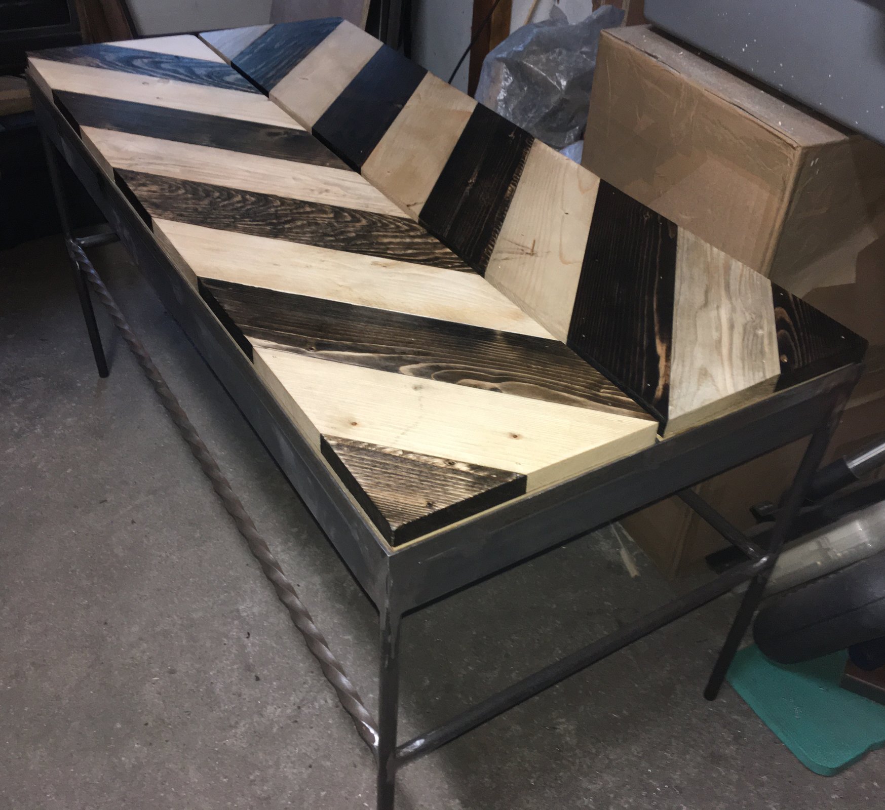

A bit of varnish:-
It might need feet too, as the bar-ends seem a bit severe.
From above:-
I might even get it powder-coated - to save me from doing any painting - maybe in clear - or does that just go misty and cloudy with the UV effects?

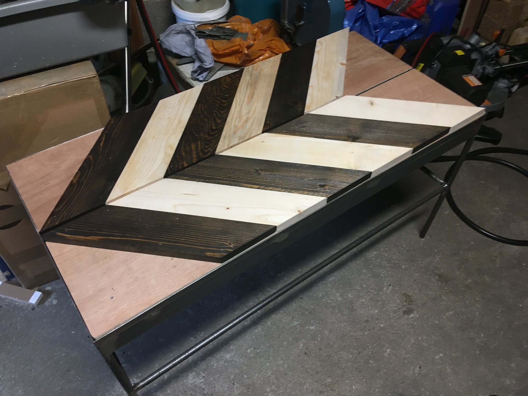

Top pieces in place:-
I don't even need a table either - so after all that, it's still in the way!
I suppose I could fill it with all the (other) odd, un-hinged lockdown "items" I've made out of what was lying around!
I'll probably end up trying my luck on e-bay, once it's got in the way one too many times.
