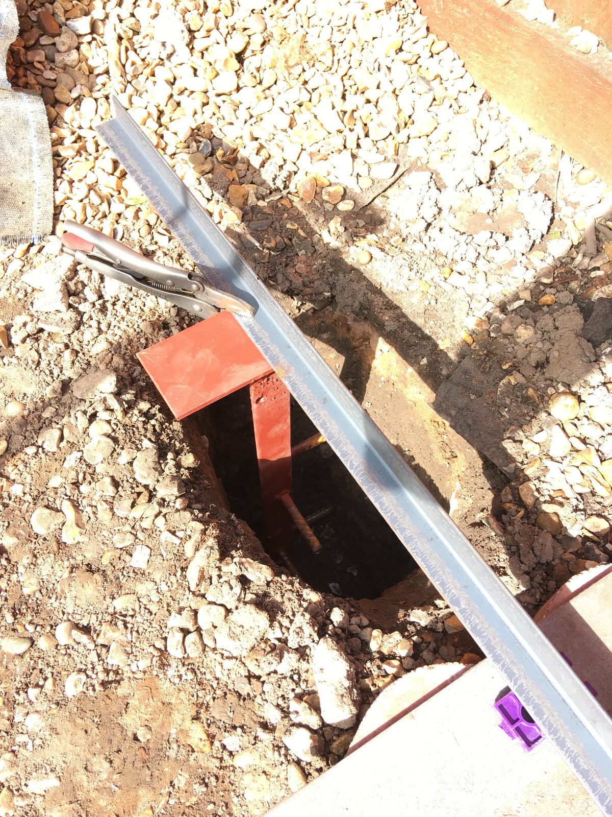

First bit of palisade fencing for a local village hall.
This is all fabricated by us, only thing. Ought in was the pales and the bolts.
two gates to fit tomorrow.

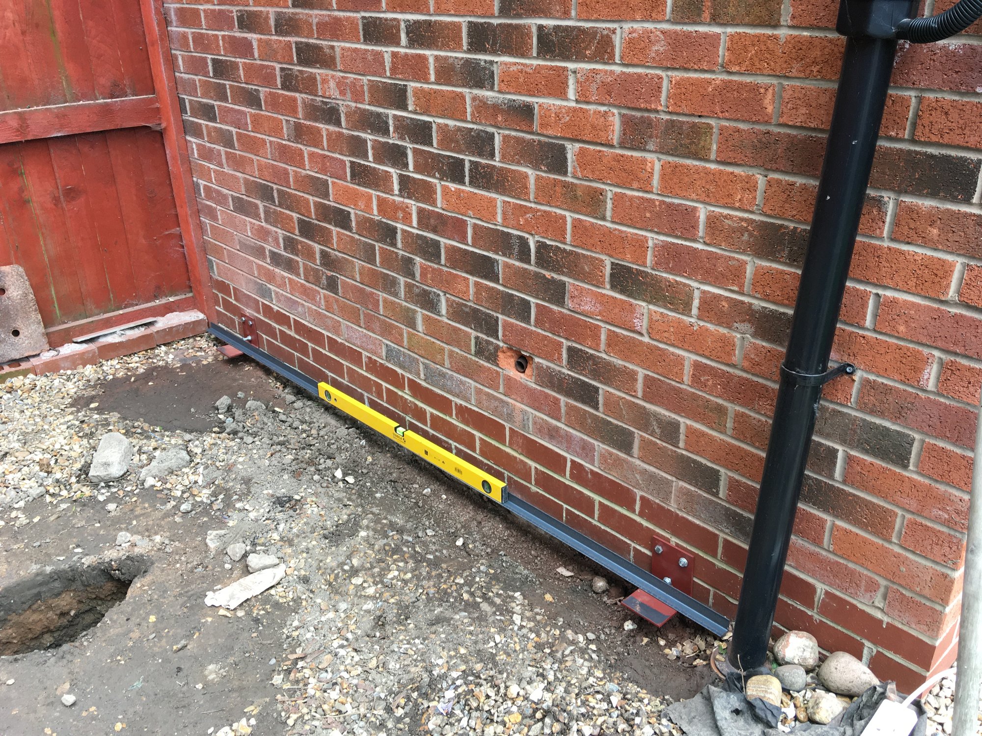

A 50x10 flat bar with x4 rawl bolts into the wall.How does it fit on the right hand side? Another post or attached to the wall?
I prefer resin myself but it’s mucky stuff and does take time to set. I may well use resin on the other walls as I do hate rawlbolts. Through bolts are a bit better but I don’t like cutting off the bolts, even if you use domed nuts it still looks odd.Hmm. Nice job. I’m paranoid about rawl bolts splitting the bricks near a corner. I always use resin unless they’re a good 3 or 4 bricks in from the edge.
I’m sure my neurosis is totally unfounded, but I’m a belt, braces, and fitted trousers kind of guy!
Never heard of them will have to have a lookThunder bolts are the answer, I genuinely use 100's a year.
I have heard of them, concrete bolts.
I’ve got the Fischer kit with the cleaning rods, blowgun and nice heavy duty applicator gun.That chemical resin is amazing.
I had some left over which needed using up, and glued two off cuts of concrete fence post together, I've tried sledge hammering it to no avail, as a destructive testing experiment.
Don't forget to blow out the holes with a compressor first.
No compressor to hand? Child's drink straw, close your eyes...
Ok so thunder/concrete bolts seem to be quite popular. I think I bought some for a job once but never used them.
Do you need to be very fussy about the hole size? Suppose I wobble a bit and the 12mm hole ends up being 13.5mm - would that seriously compromise the strength of the fixing?
