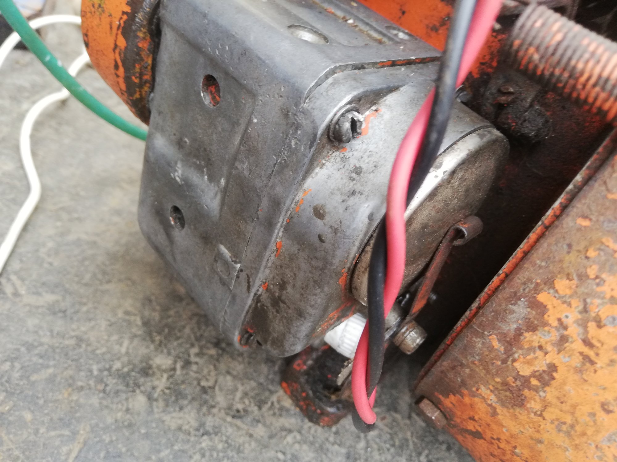

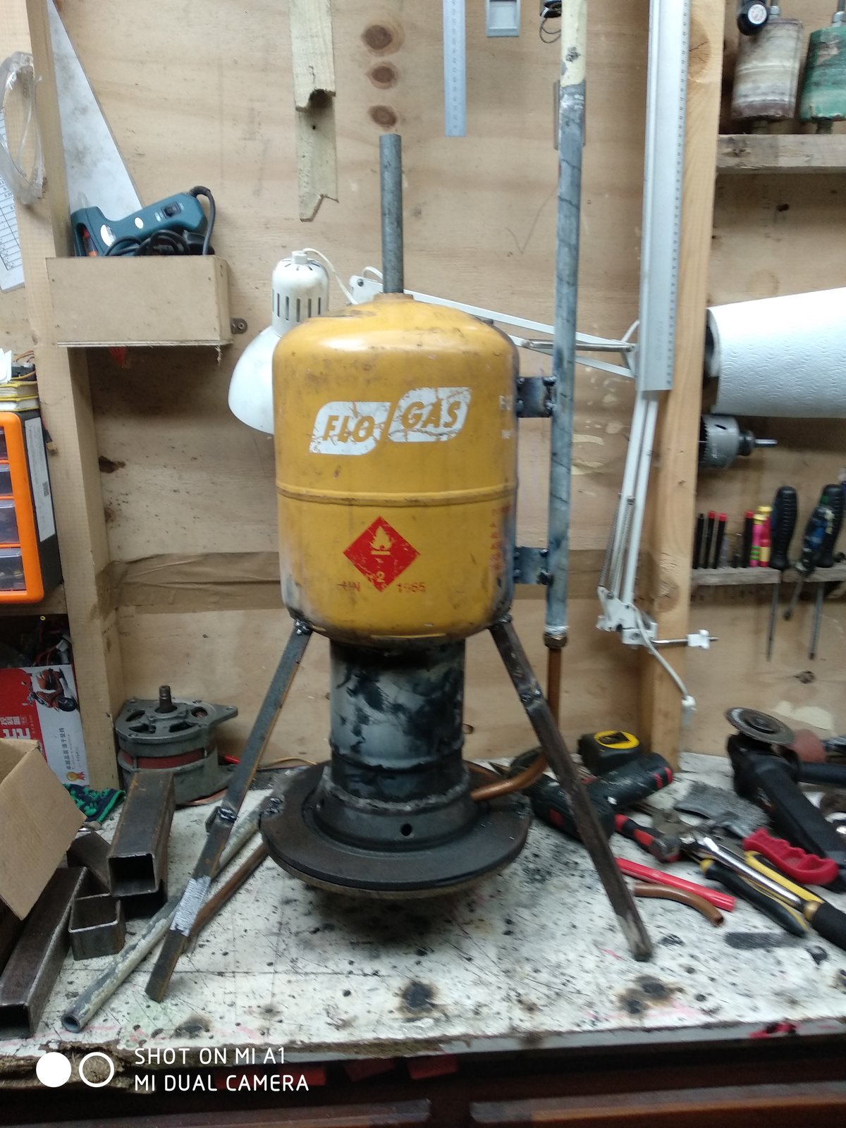

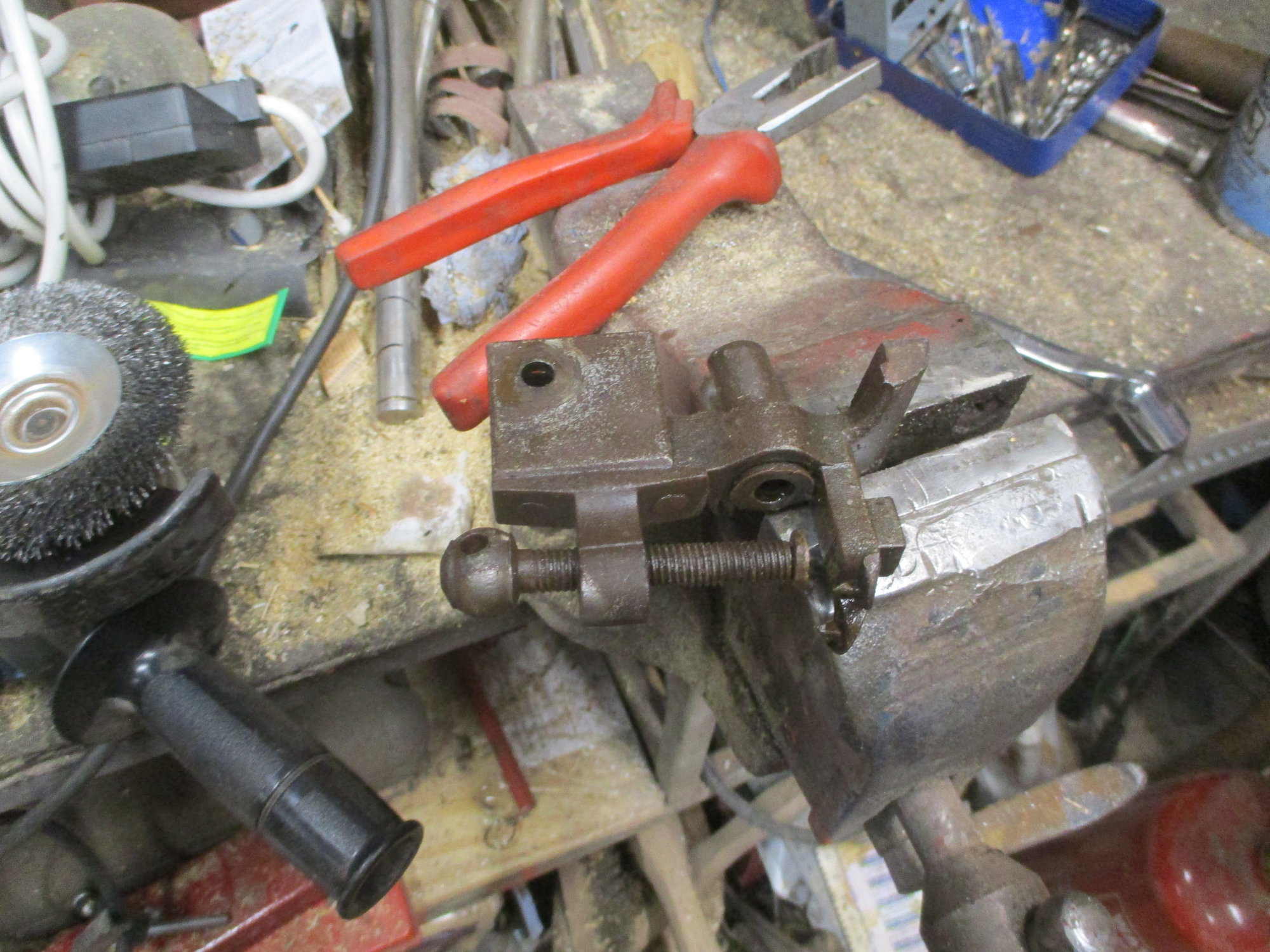

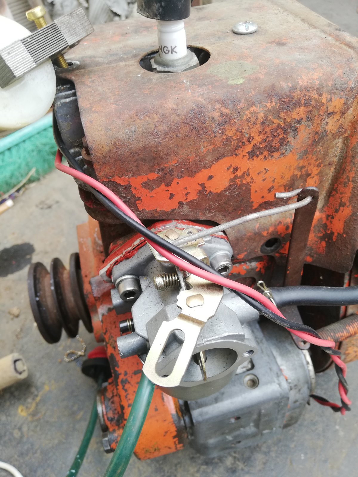

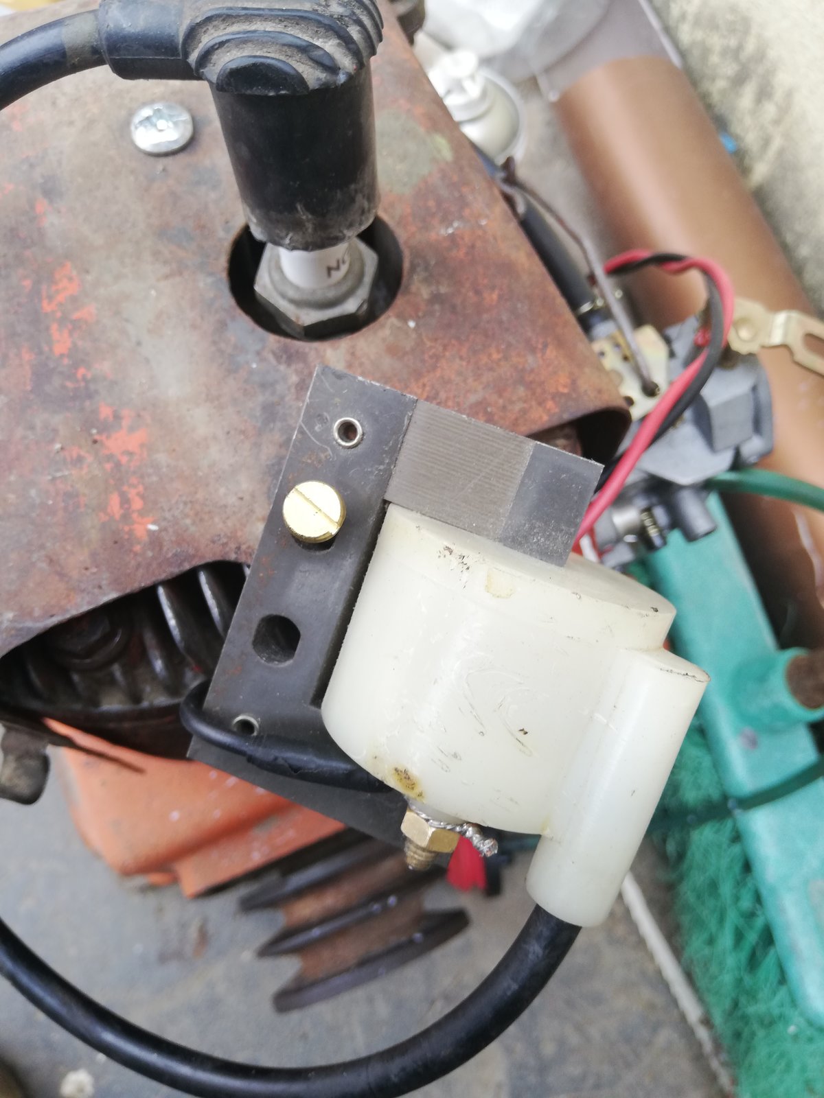

Took a Lombardini LA65/58 oil engine back to life
Modified the Magneto to use an external ignition coil
Now I have to test run it to tune the carb and the ignition timing but It's runnable right now
If everything goes well I'll end up having an engine driven air compressor in few weeks
I have to figure out how to make a fuel tank for it
It requires straight gasoline to start and oil to run (I have to mix kerosene , gasoline and diesel to make the fuel mix, but I think it could run on 2 strokes fuel mix )
Anyway I have to make two fuel tanks and found a way to close the gasoline and open the oil line .
