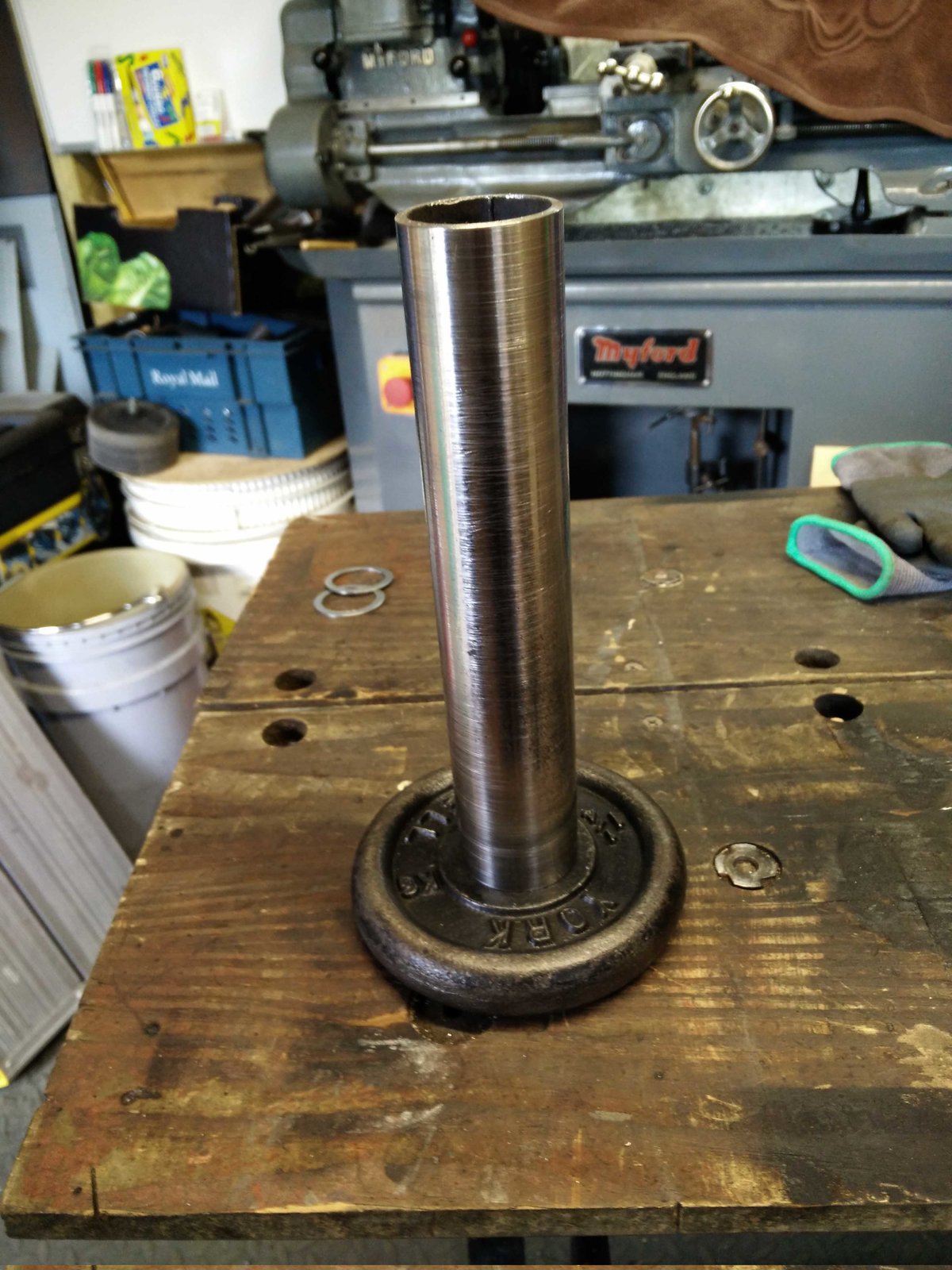

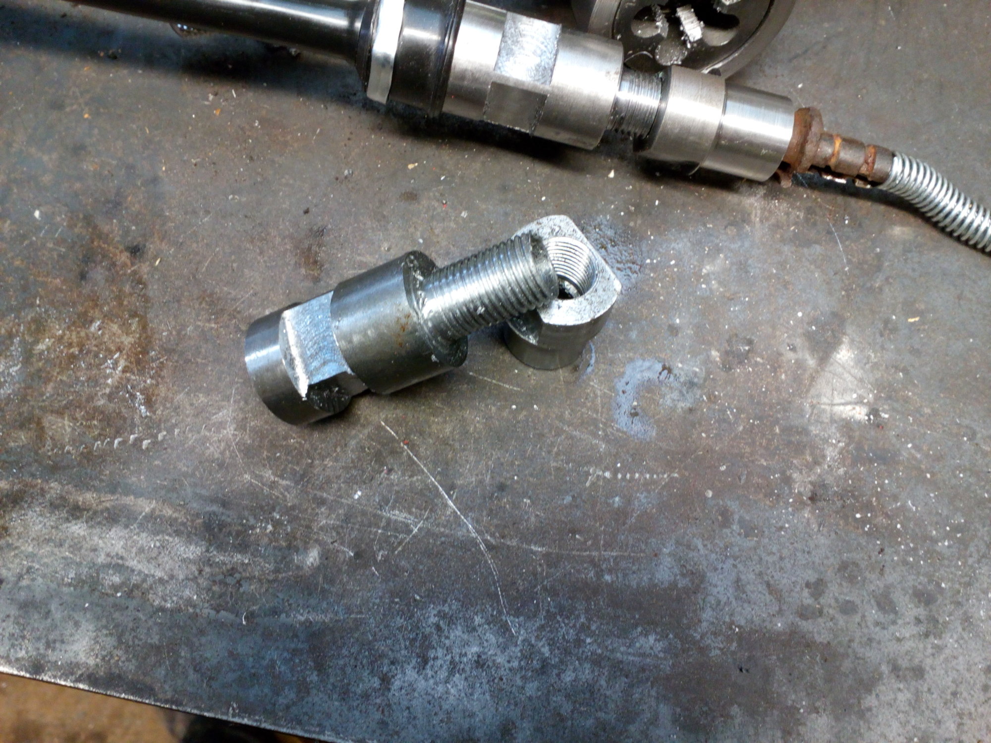

Turned up on an arbor made from an old scaffolding nut and bolt held in the three jaw chuck. I have no idea what grade stainless it is but it turned remarkable easily with a DCMT carbide tip, the 1MM relief was taken at one pass with a CCMT in a boring bar.
