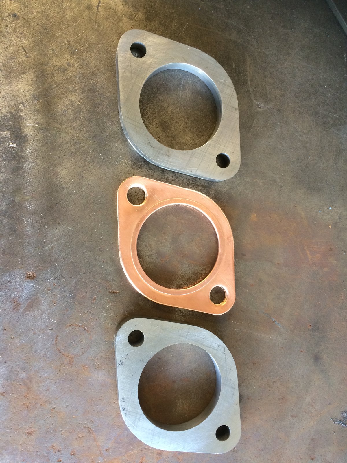

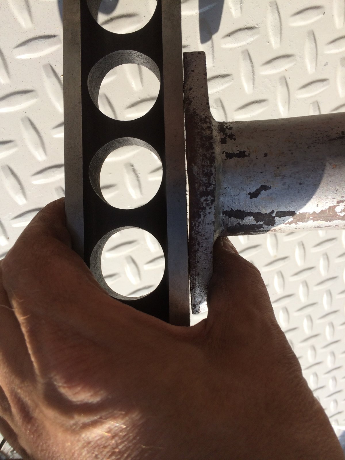

 They are also too short having been cut and welded so were hitting the chassis. Stainless pipes with mild flanges.Do you mean Slurry (cow manure) as silage is just grass, albeit a bit smelly when it's off or well fermented!

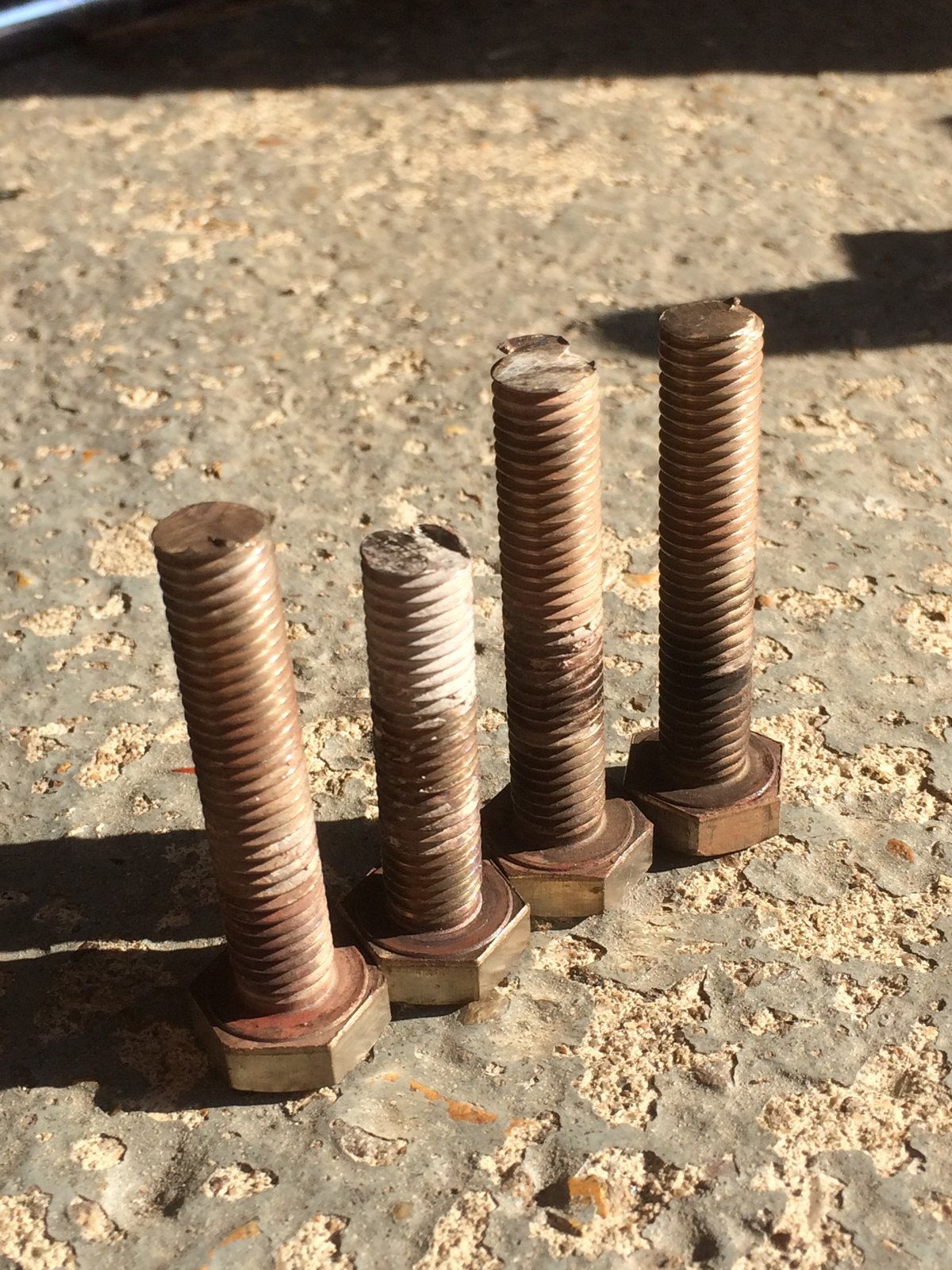

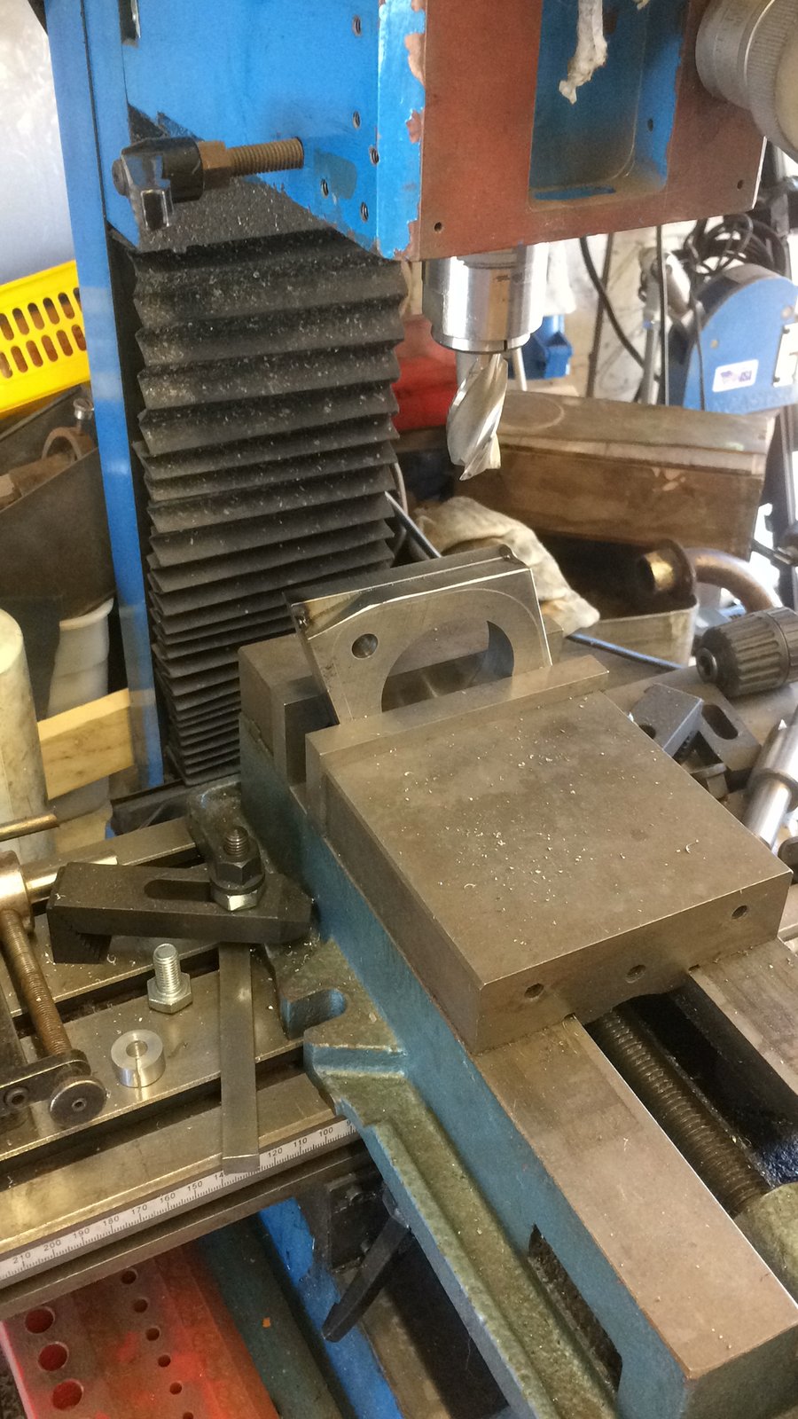

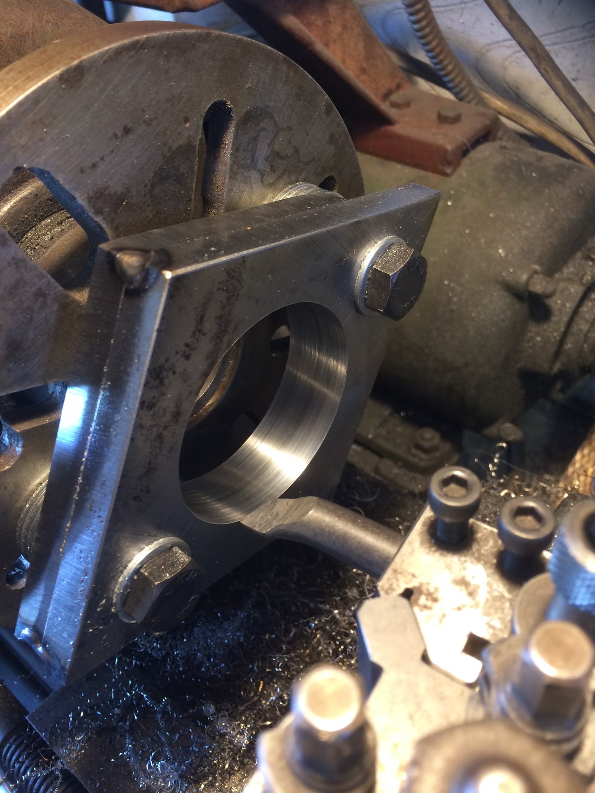

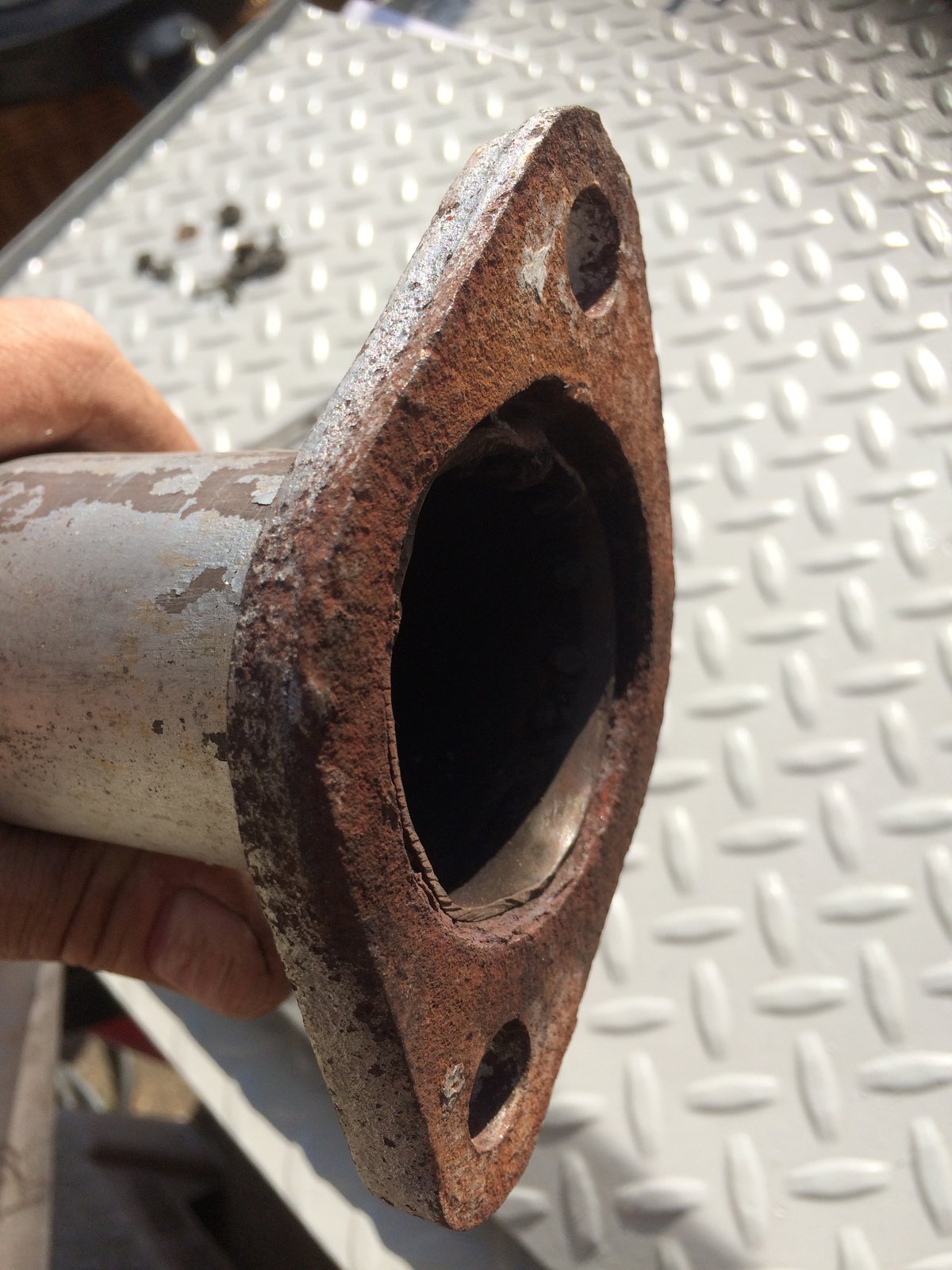

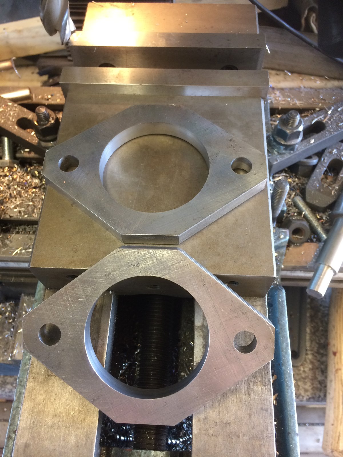

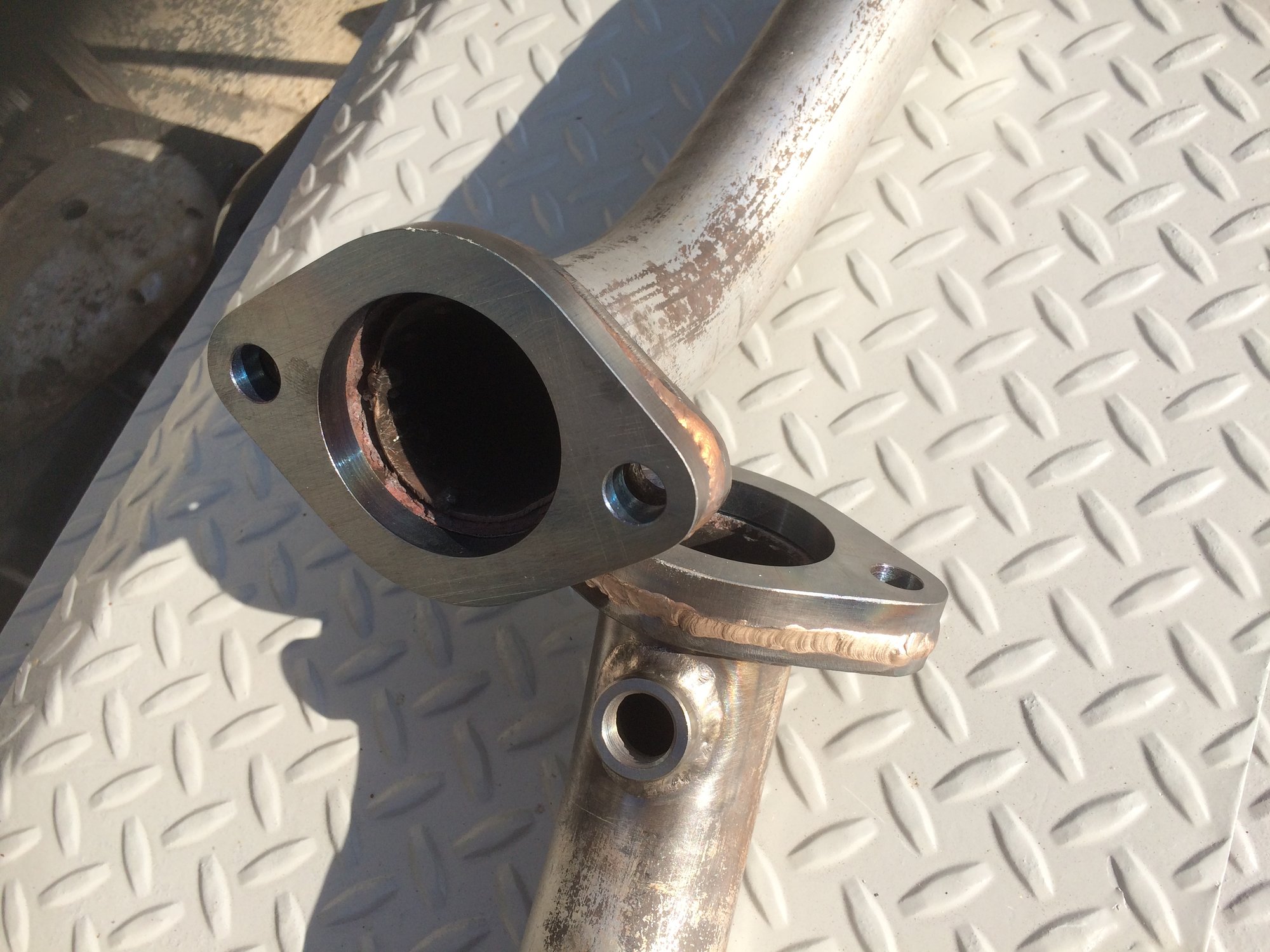

Nice workTo cut a long story short all I could say was Foxtrot Foxtrot Sierra when I went to replace a pair of blowing downpipe gaskets last week, found these as downpipe to cast iron manifold flanges.
View attachment 147529 View attachment 147530
With heatproof Aluminium paint the downpipes look new to the untrained eye and were recently fitted.They are also too short having been cut and welded so were hitting the chassis. Stainless pipes with mild flanges.

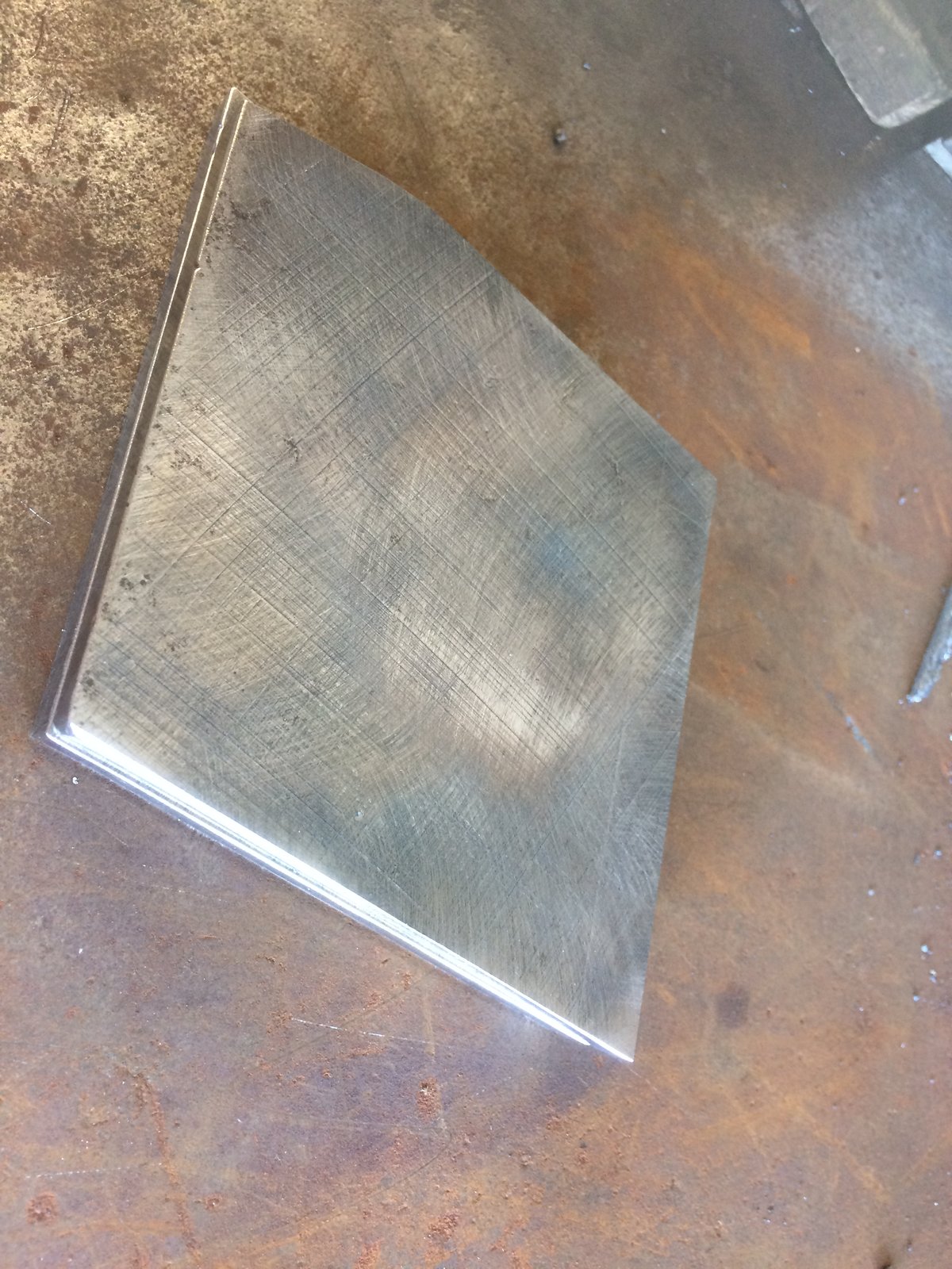

Temptation was to plasma cut a pair and Mig them to the existing flanges, kind of what I ended up doing.
Plasma cut some scrap and flap wheeled the dross off, impressed they’re both within 0.5mm by eye!

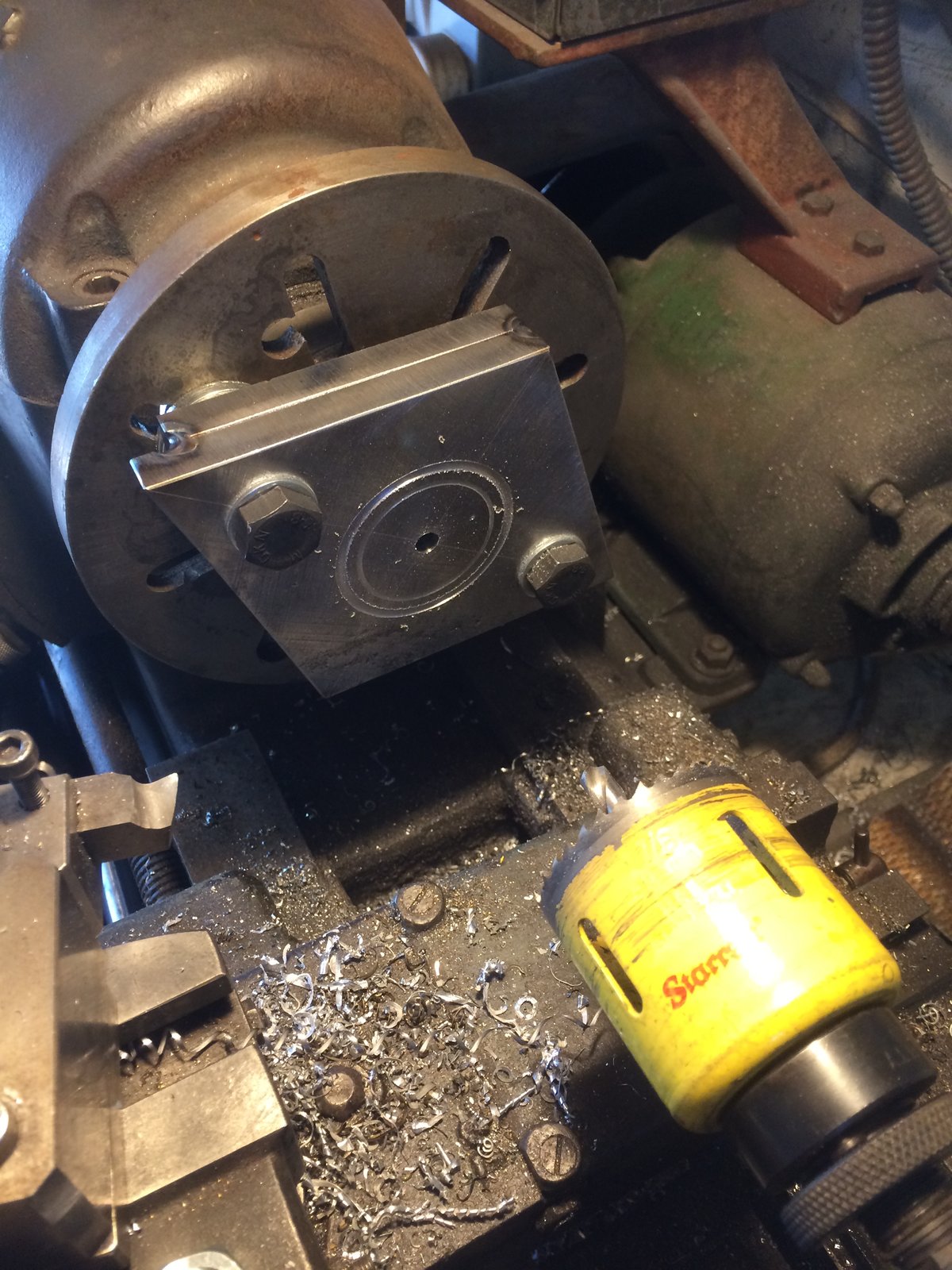

Tack all the corners together, mark and drill the bolt holes then centre on a faceplate in the lathe. Hog the centre to 48mm with a holesaw.
Bore to 57mm.
Rasher down to shape on the mill using MkI eyeball and scribe lines.
Fettle on linisher to shape.
Tig braze to original pos fanimold flanges.
The calibre of bolt cutting exceeds the parts supply!
