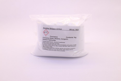

Specifically I use this, alkaline rather than acid but then I think that is what is required anyway.Worthwhile dunking the basket & contents in a mild acid solution before anodising, to remove any oxidisation or suchlike from basket & contents, possibly?
Anodisie Stripper and Etch | Gateros Plating Ltd
Anodise Stripper & Etch can be used on all types of aluminium to quickly remove old anodising ready for re-anodising. When the part has been stripped simply rinse under running water. Depending on the grade of aluminium you may or may not have to dip in de smut solution or mechanically remove...
www.gaterosplating.co.uk
