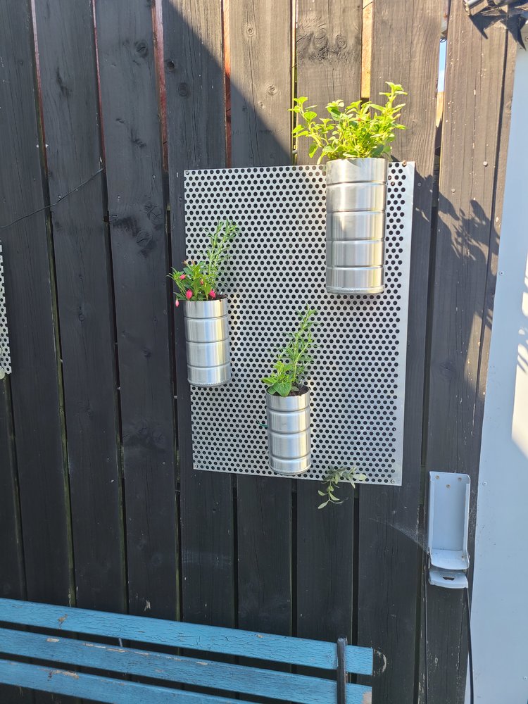

the missus sees a few random tubes lying in the wshop and says can you make me a few plant pots, View attachment 449994¾
