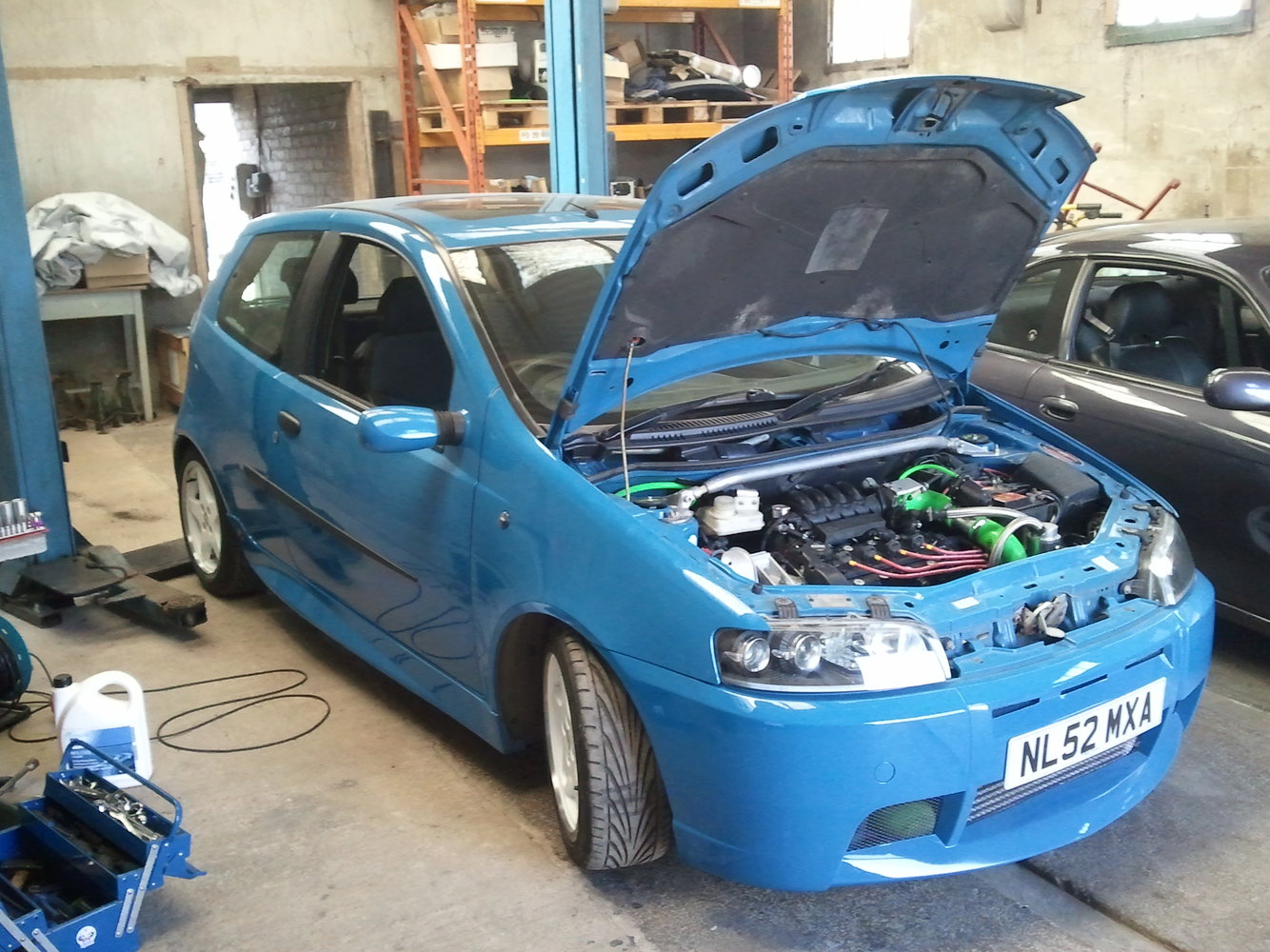

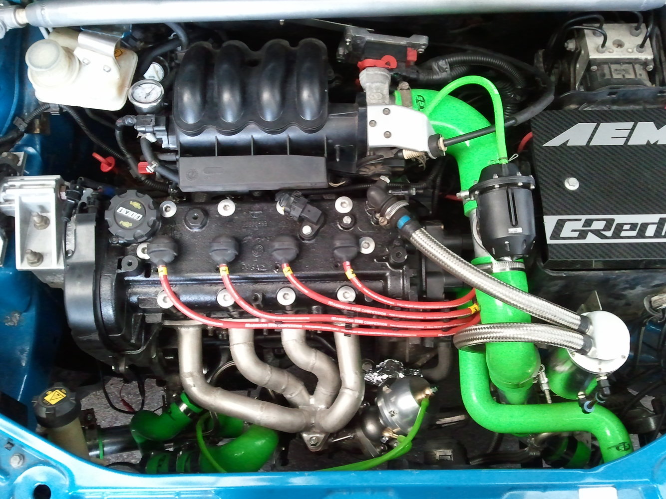

That's a shame.I had a 188 punto sporting, I put a MS2 ECU and a turbo on it, made 160hp with original engine bottom end. It was the timing key that snapped on the crank, it still ran but was way down on compression. It just slipped a little bit.

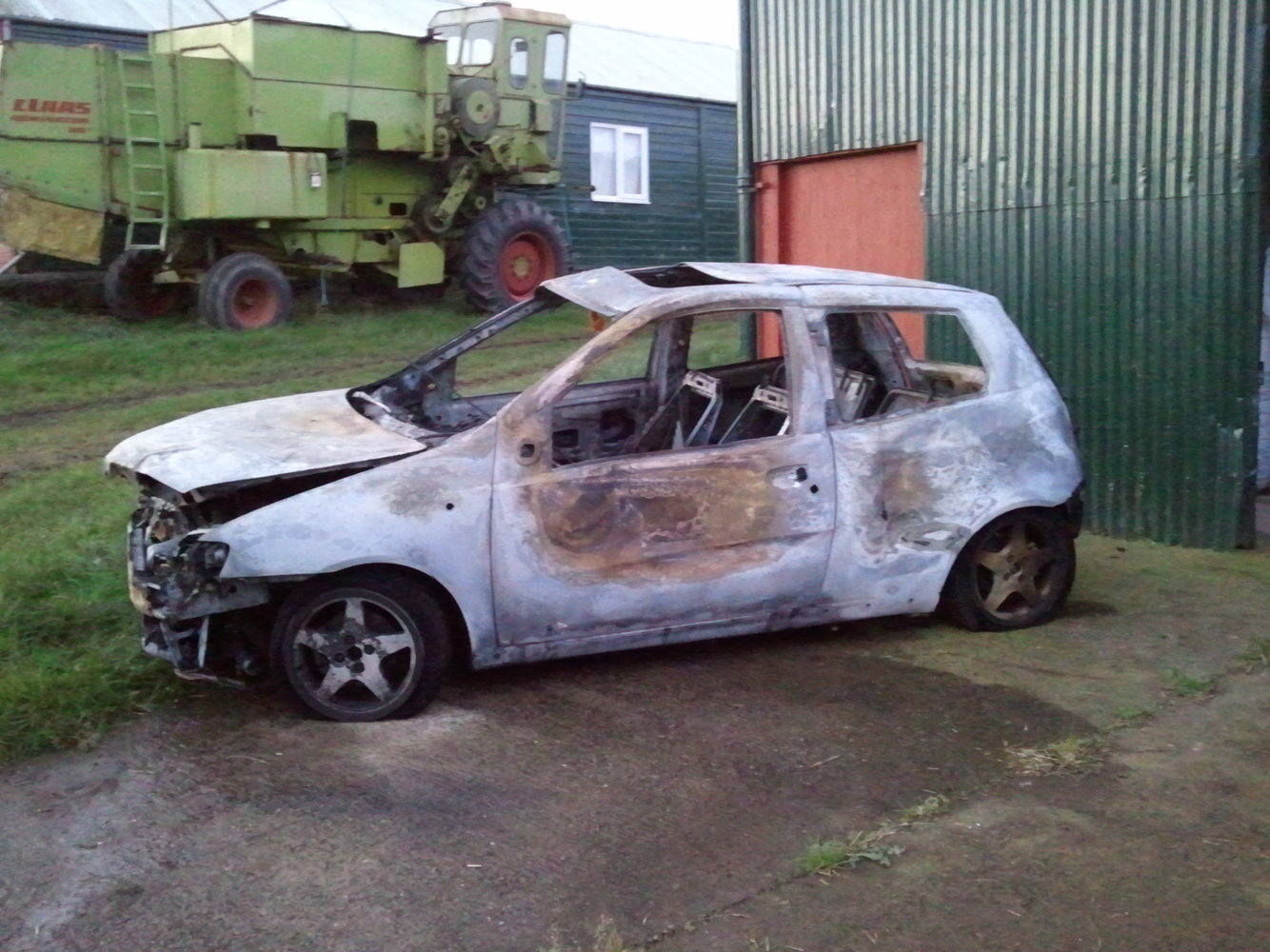

I rebuilt that engine with a 1.4 bottom end and forged pistons, made 190hp. Then one of the conrods snapped and it set the car on fire, lol
View attachment 445634 View attachment 445635 View attachment 445636

I did a turbo conversion on an 8v as well for someone, i used an extra injector controller with 4 MPI injectors in a modified inlet manifold to provide the fuel, and a decompression plate under the head gasket. It made around 120hp with 0.5bar boost IIRC, it was a long time ago now.That's a shame.
I've read an article while researching about FIRE engines modified to forced induction.
And stock are capable of 120ish BHP with low boost, they unfortunately have not combustion chamber designed to manage higher boost levels than 0.4 bar .
They knock if you don't work on compression ratios.
The 16V has a great potential for boost applications since you can even completely modify the valve timing by varying the overlaps and has s stronger engine block.
The main problem with the 8 valves is in the SPI system which makes cylinder 1 and 4 run lean, MPI surely better and ours have this system
