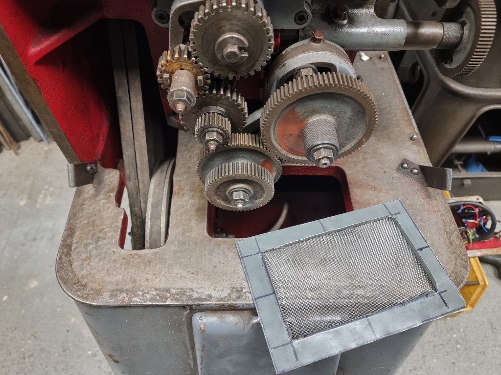

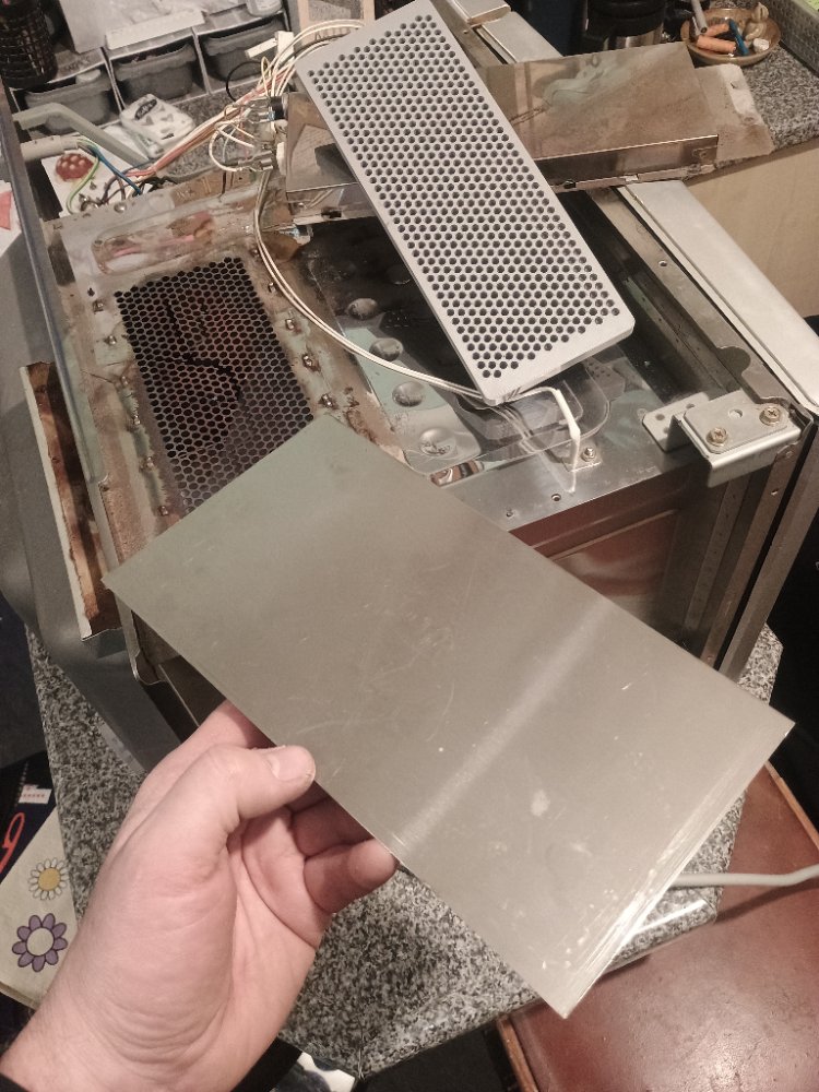

I had to pull my hobber apart today because it was blowing the earth leakage trip. Spent all day on it in the end because I found that the hobber has a 1.5kw VFD and 1.1kw motor whereas the grinder has a 1.5kw motor and 1.1kw VFD, so I swapped the VFD's over now I don't have to worry about overloading the grinder VFD.
Anyway, one thing that really annoys me is dropping the quick-change washers down the hole into the motor cavity on the hobber. Its a really cool system where you loosen the nuts and slip the washer off then you can change the gears as they slide over the nuts, and pop the washer back in. Those washers like to head for the hole right underneath and there's no easy way to get them out.
So I knocked up a mesh screen to cover the hole and still allow ventilation for the motor, and there are times when the change-gear setup require the hole to be there.

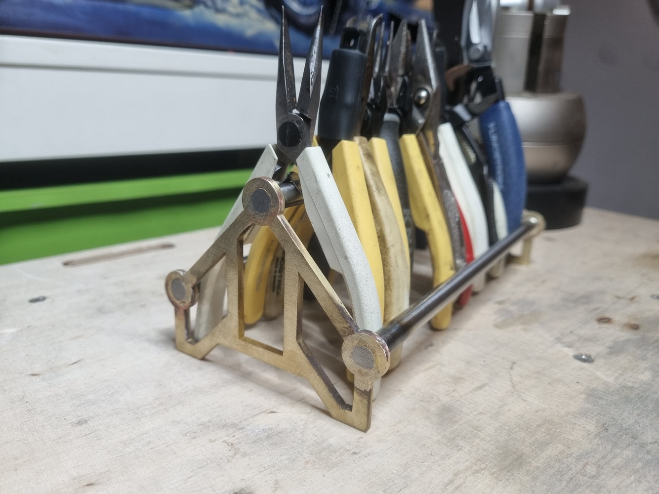

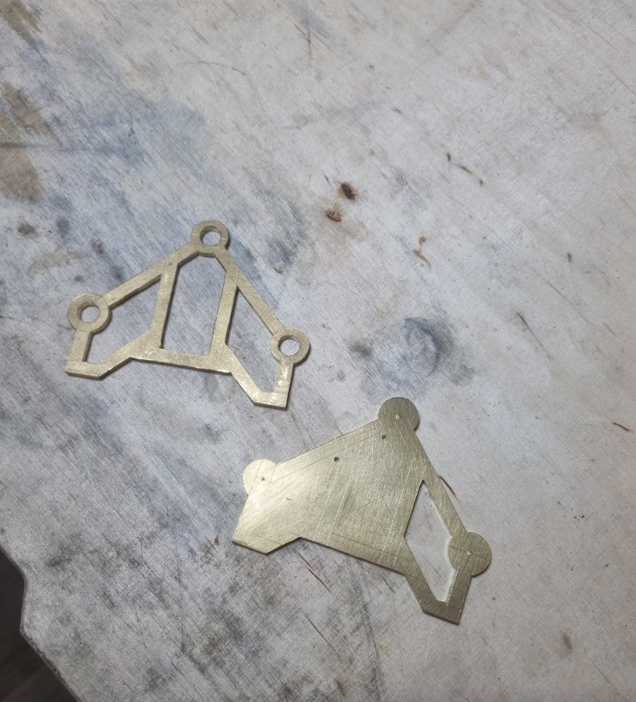

). Still needs cleaning up, I'll probably get to that in another month.

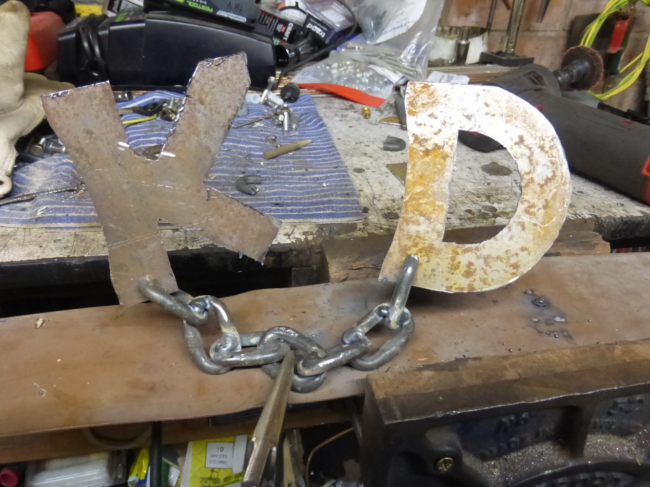

no spotted I've got the K upside down , it's ok they're not fixed yet might even swap em around .
