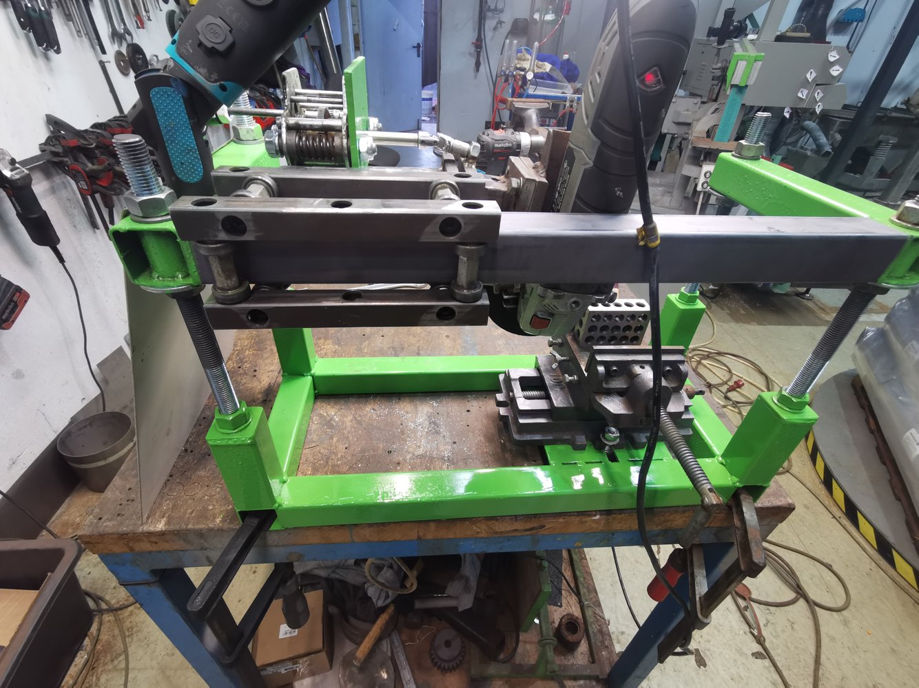

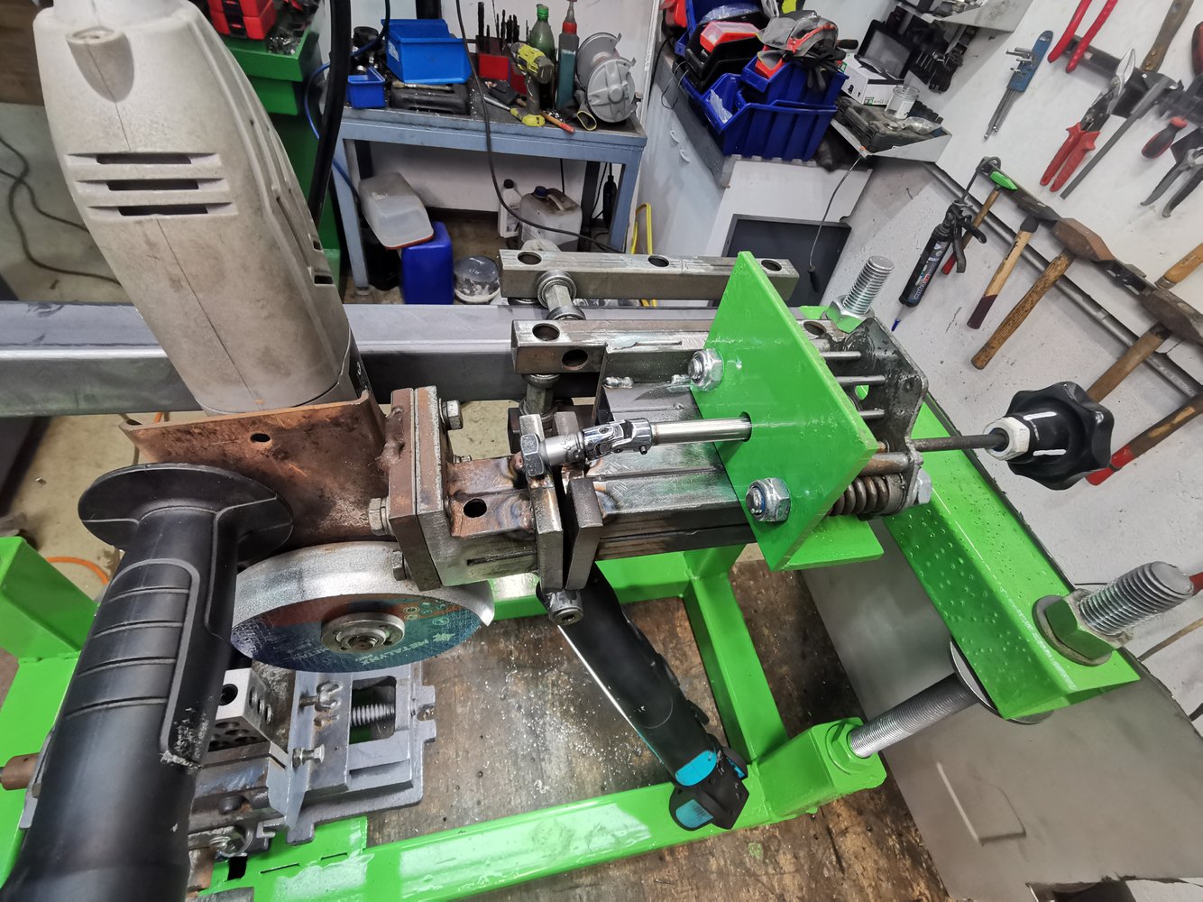

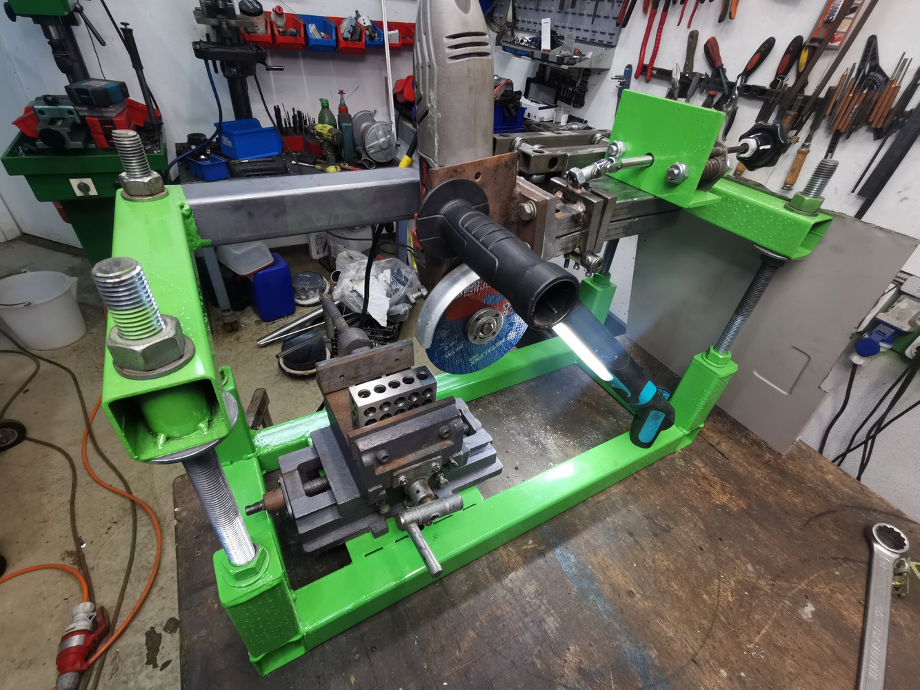

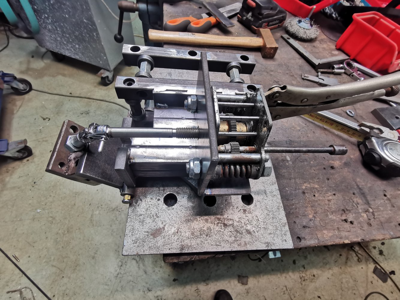

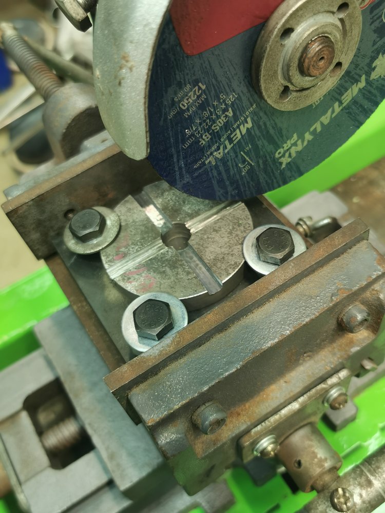

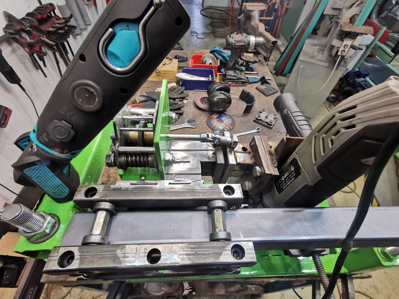

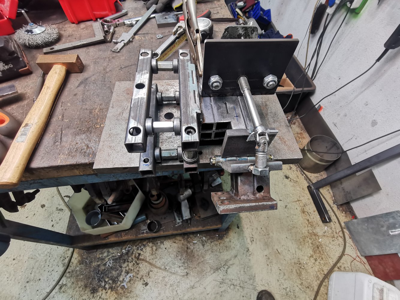

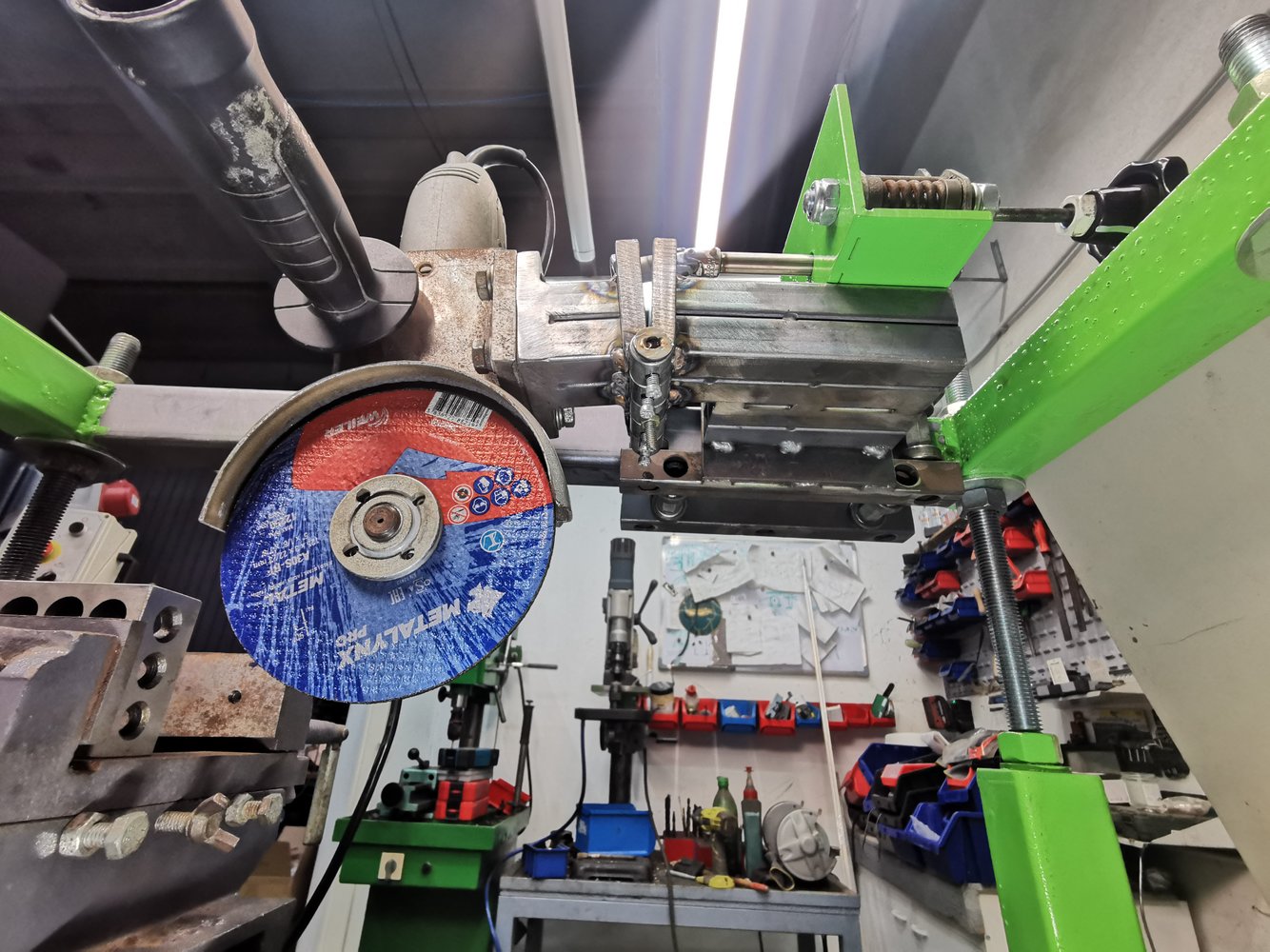

The process of gnawing grooves"Shaitan machine" for grinding grooves in metal has been assembled, improved and configured. It's not fast, but it does the job I need.
View attachment 425799 View attachment 425800 View attachment 425801 View attachment 425802 View attachment 425803 View attachment 425804 View attachment 425805 View attachment 425806 View attachment 425807

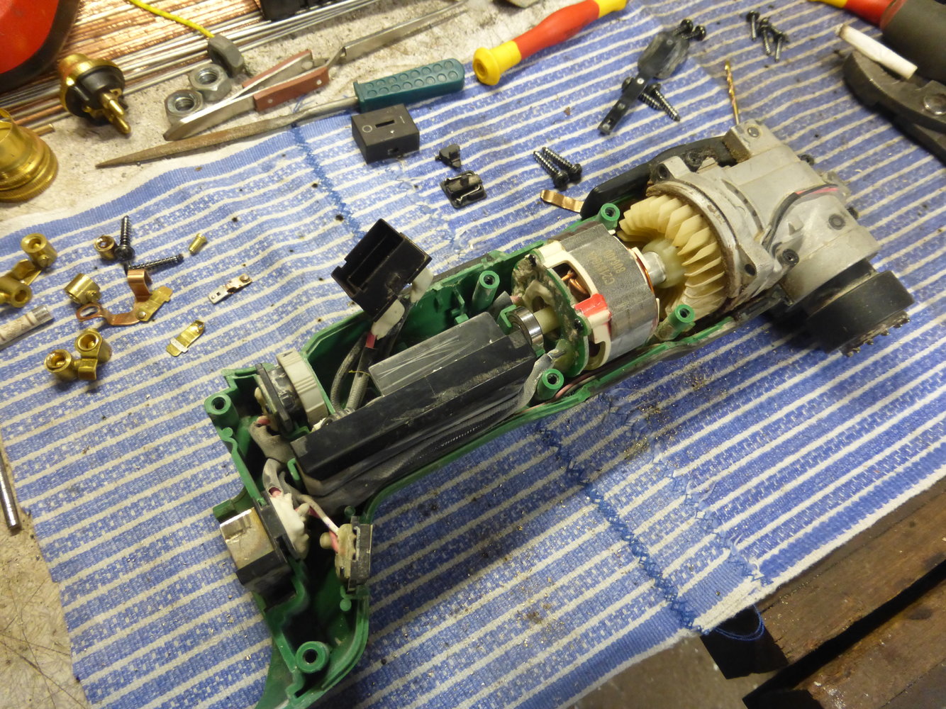

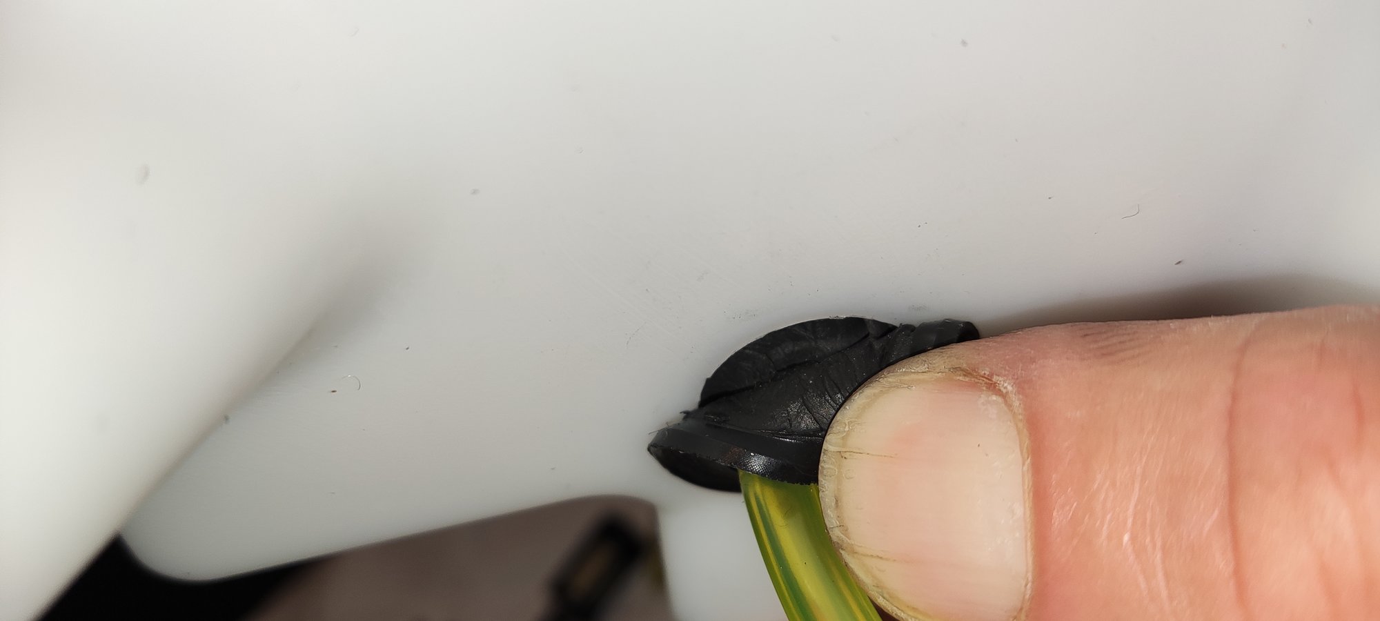

however looks like it needs full disassembly to swap it so I didnt.Sore thumbs!

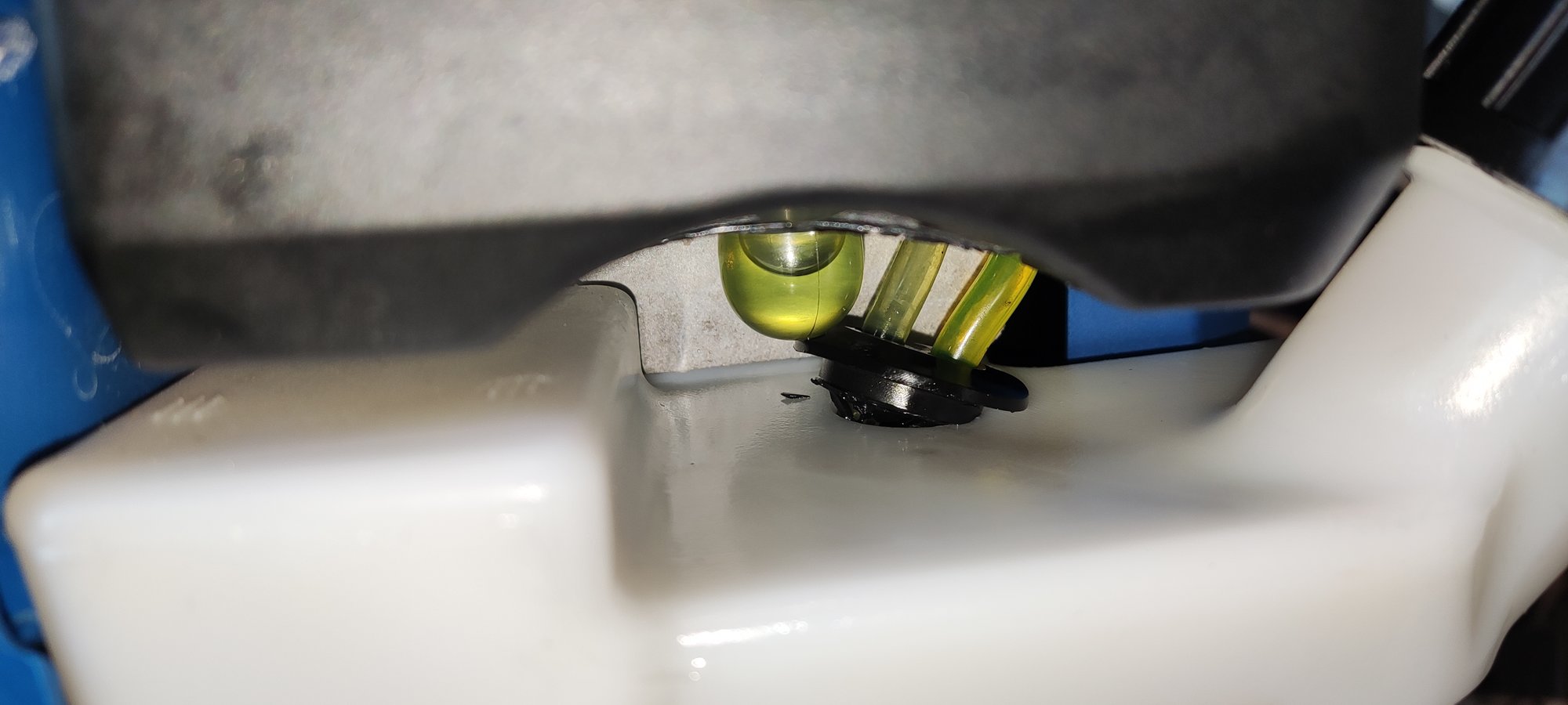

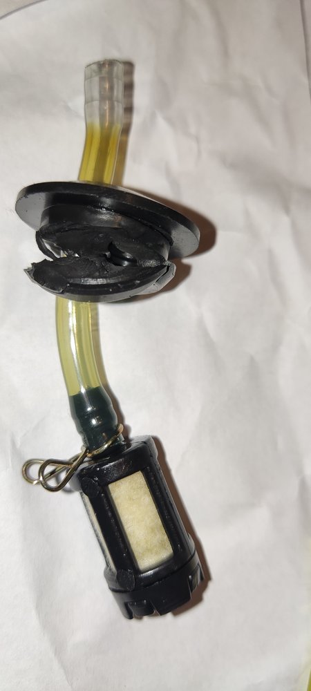

The hyundai blower I got a few weeks ago had a split fuel grommet. They sent me a spare tank and extra grommet. The spare tank grommet was also splithowever looks like it needs full disassembly to swap it so I didnt.
The spare was a slightly different type. I tried various pushing implements. I fear it may take weeks for the skin of my thumbs to recover as pushing was ripping the skin away from my nail.
Cant recommend Hyundai, it seems to be a common problem from the reviews. However its now working and not leaking.
An impressive gadget!The process of gnawing grooves
We had to come up with design details on the fly. The design uses 95% scrap metal and the remains of an unknown device with gears that performs the functions of a micrometric feed. Lucky so lucky. I've been wanting to throw it away for a long time. What can't you do when you don't have a milling machine?An impressive gadget!

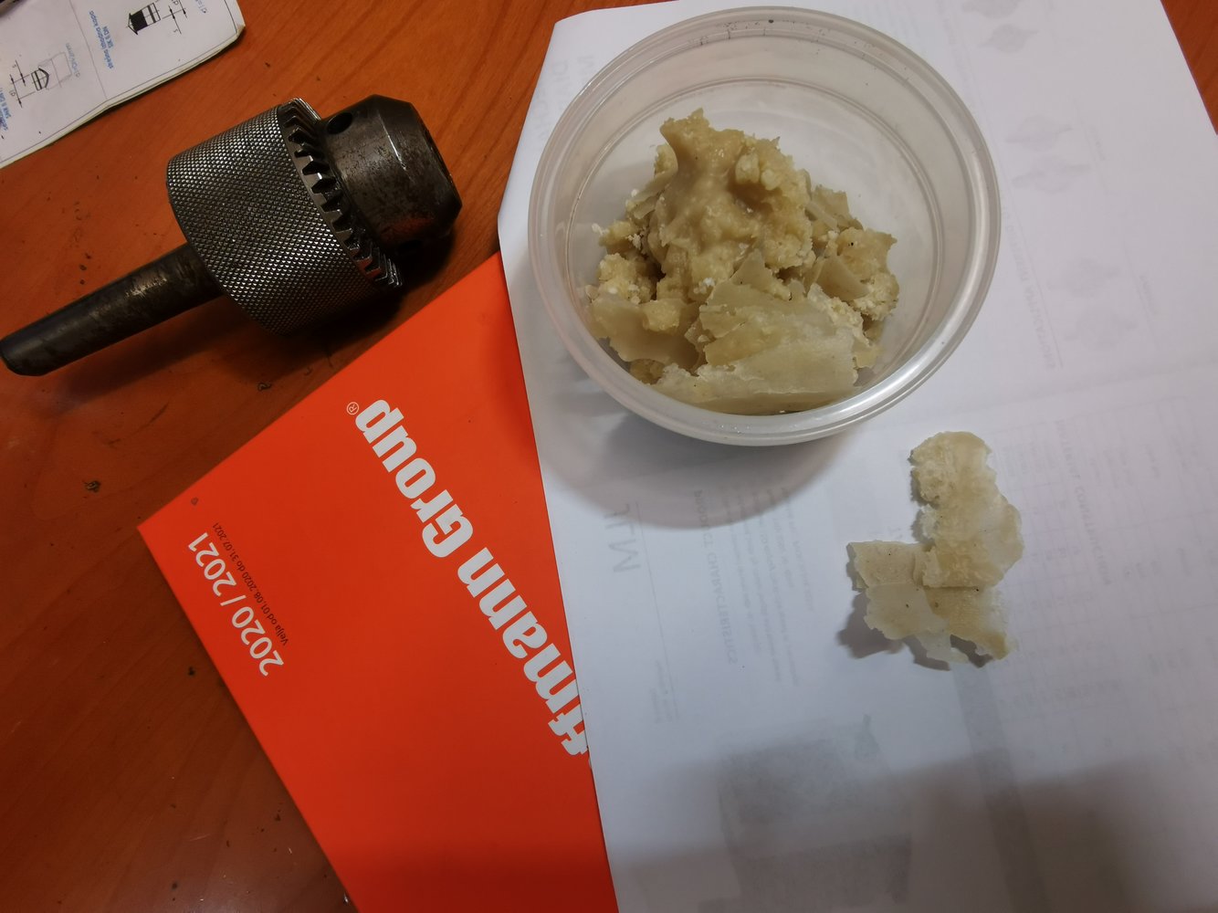

Saponified beeswax, using a technology now called Marseille soap. Component of encaustic paints and Ganosis.Punic wax. What's that?
