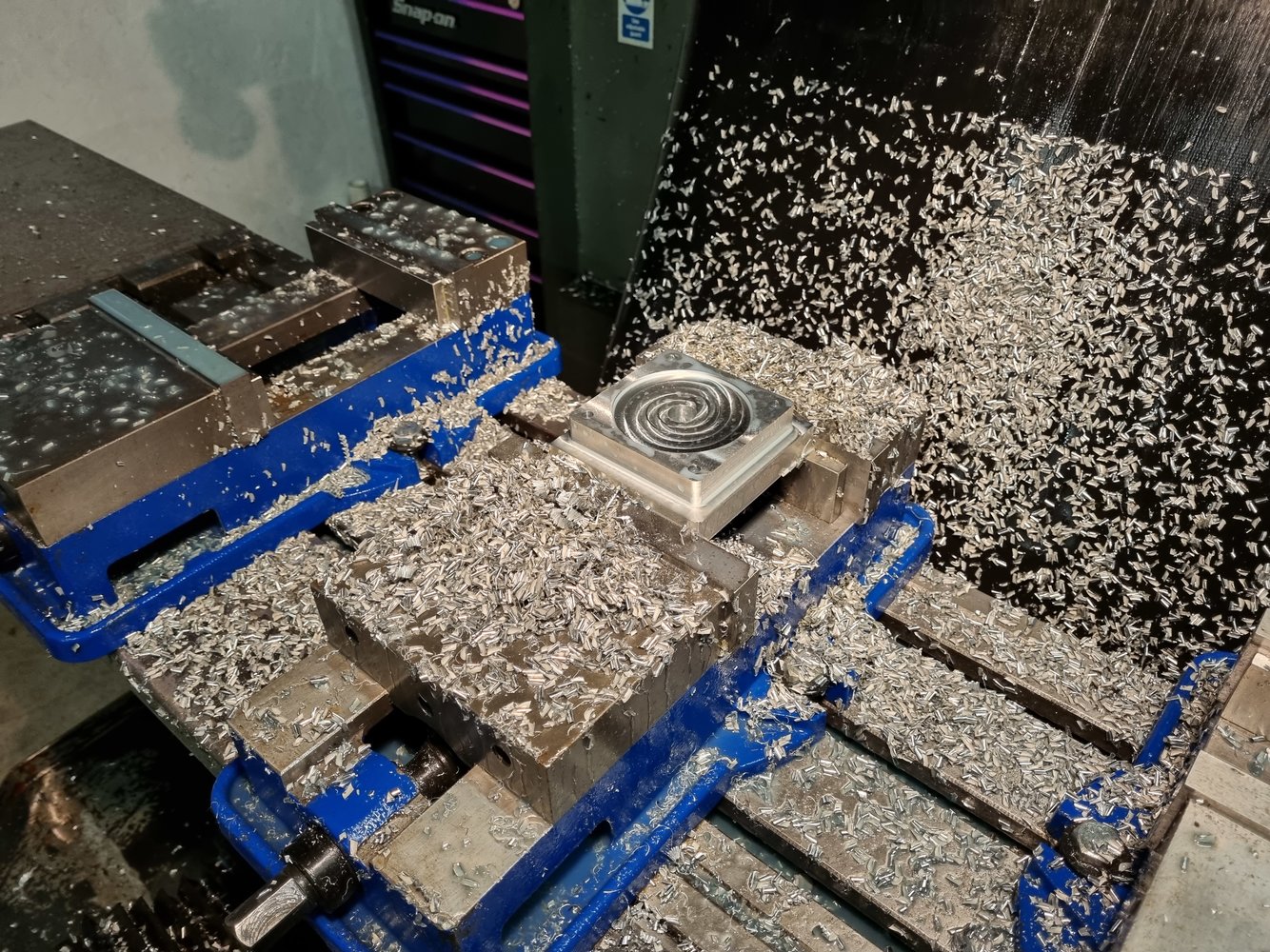

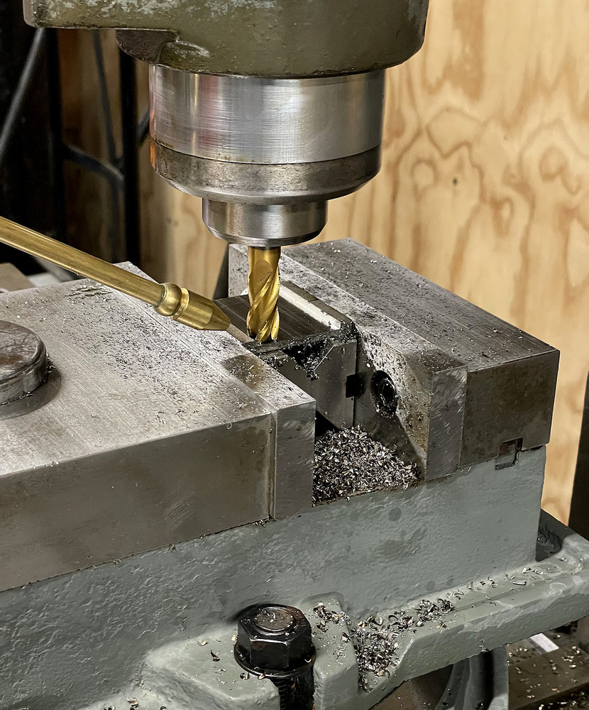

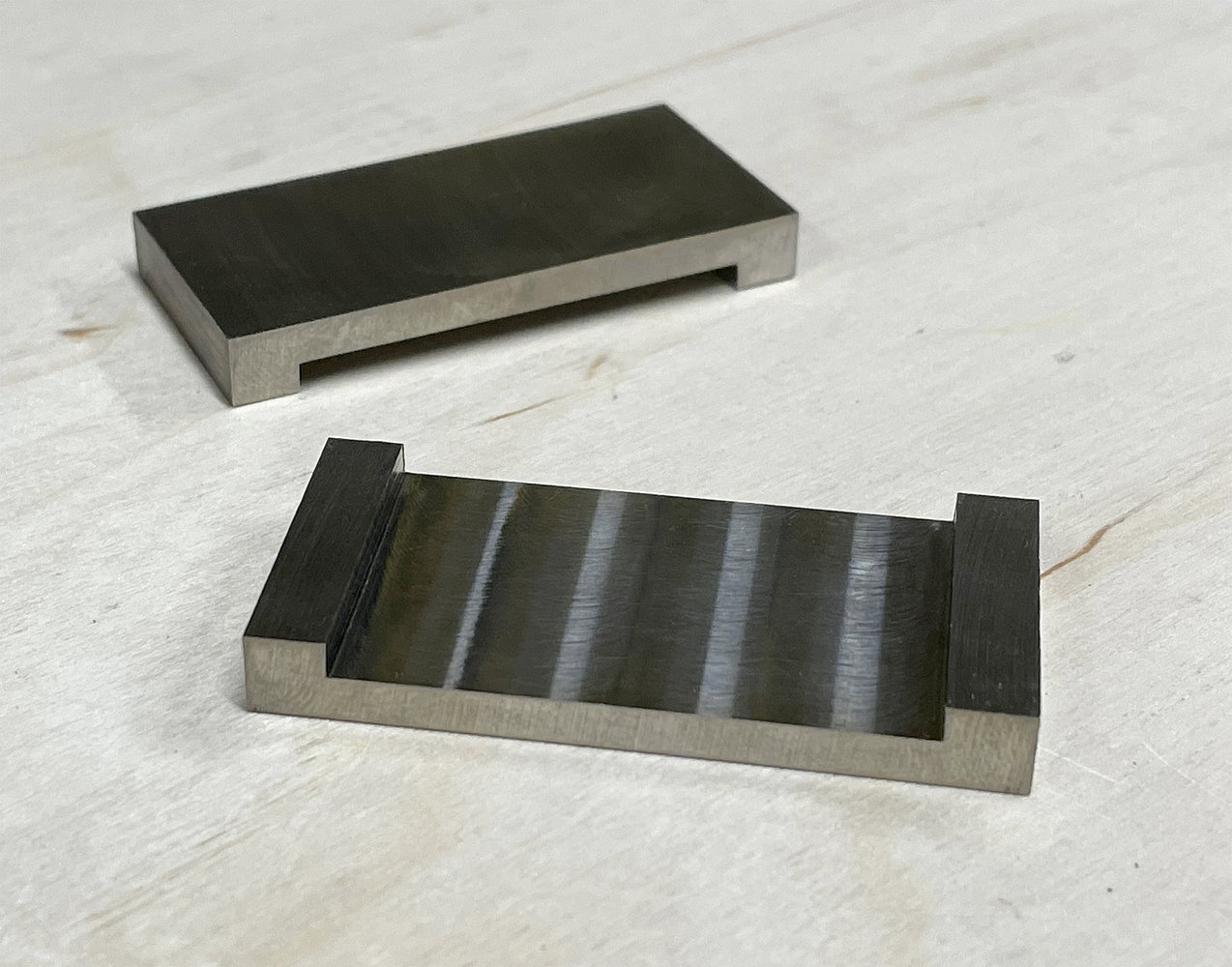

First, I milled a couple of small stainless plates on my Bridgeport:

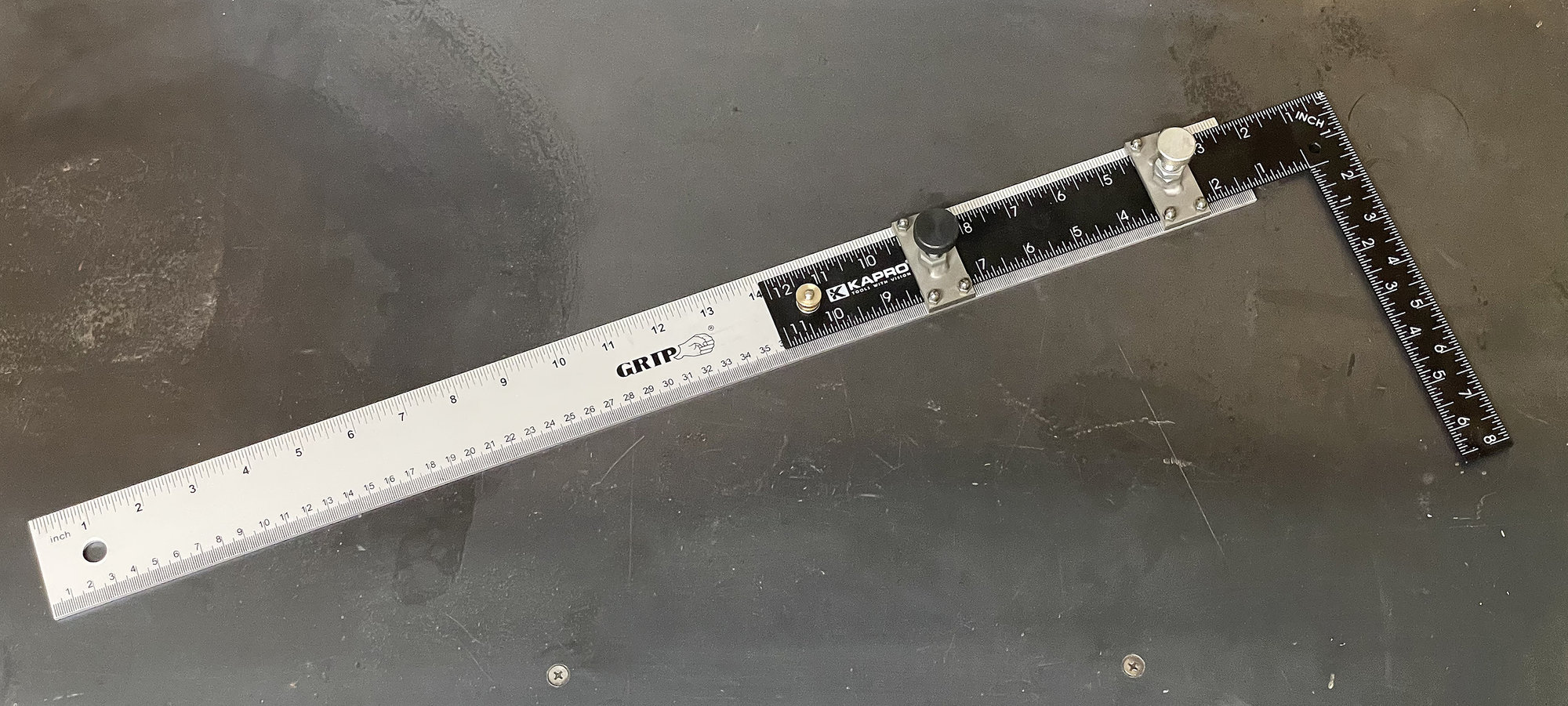

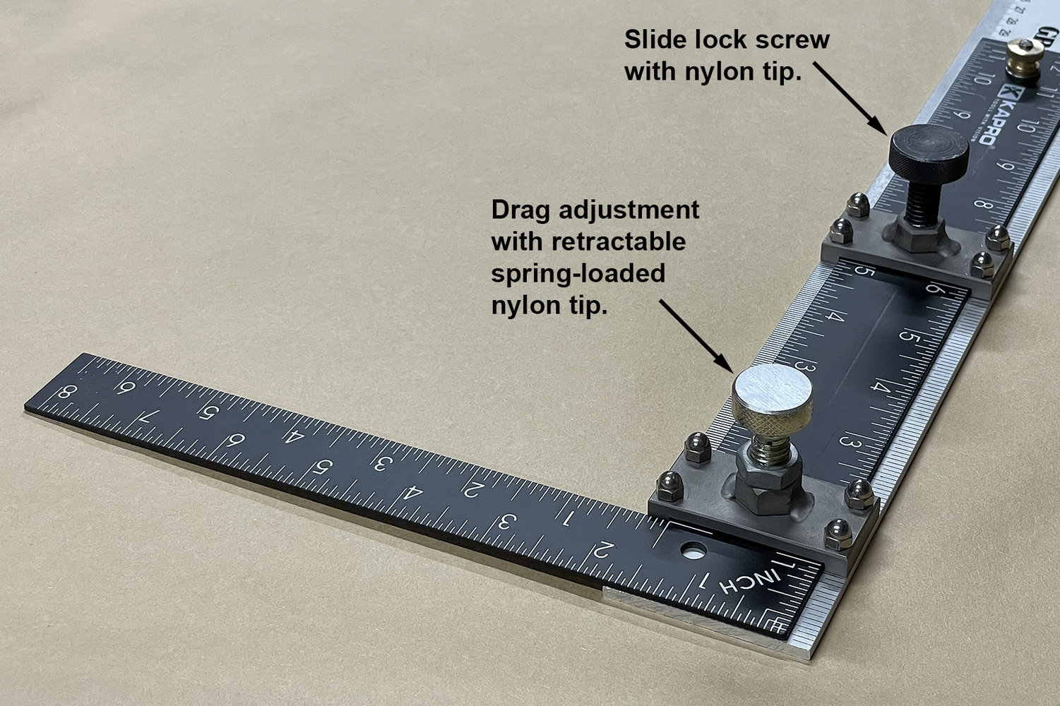

Then I drilled mounting holes, welded a couple of nuts onto the plates, mounted the plates on a 2-inch-wide rule, and installed a retractable spring-loaded drag and a locking screw (both with nylon tips). I also chamfered the edges a bit to avoid sharp edges. The black L-shaped rule that slides in and out of the the longer rule makes it easy to take a measurement perpendicular to the beam.
All I do is add the extended distance to the 24-inch length of the larger rule, or even better, I can simply lock the length with the locking knob and transfer the length directly to the board for cutting…no need to even note or remember the measurement.

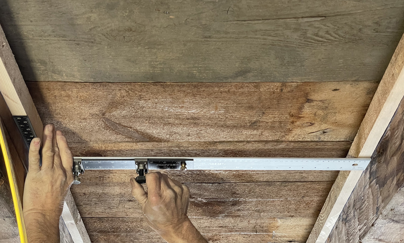

Here’s a demonstration of a measurement between the joists with my gadget. Note the hand-hewn surfaces of the joists/beams. FYI, the beams average anywhere between 7.5" x 7.5" and 8" x 8" and are about 16 feet long.
If I want to use this gadget for longer inside measurements later on, I can remove the small L-shaped black rule and install a longer 1-1/2-inch-wide rule.
