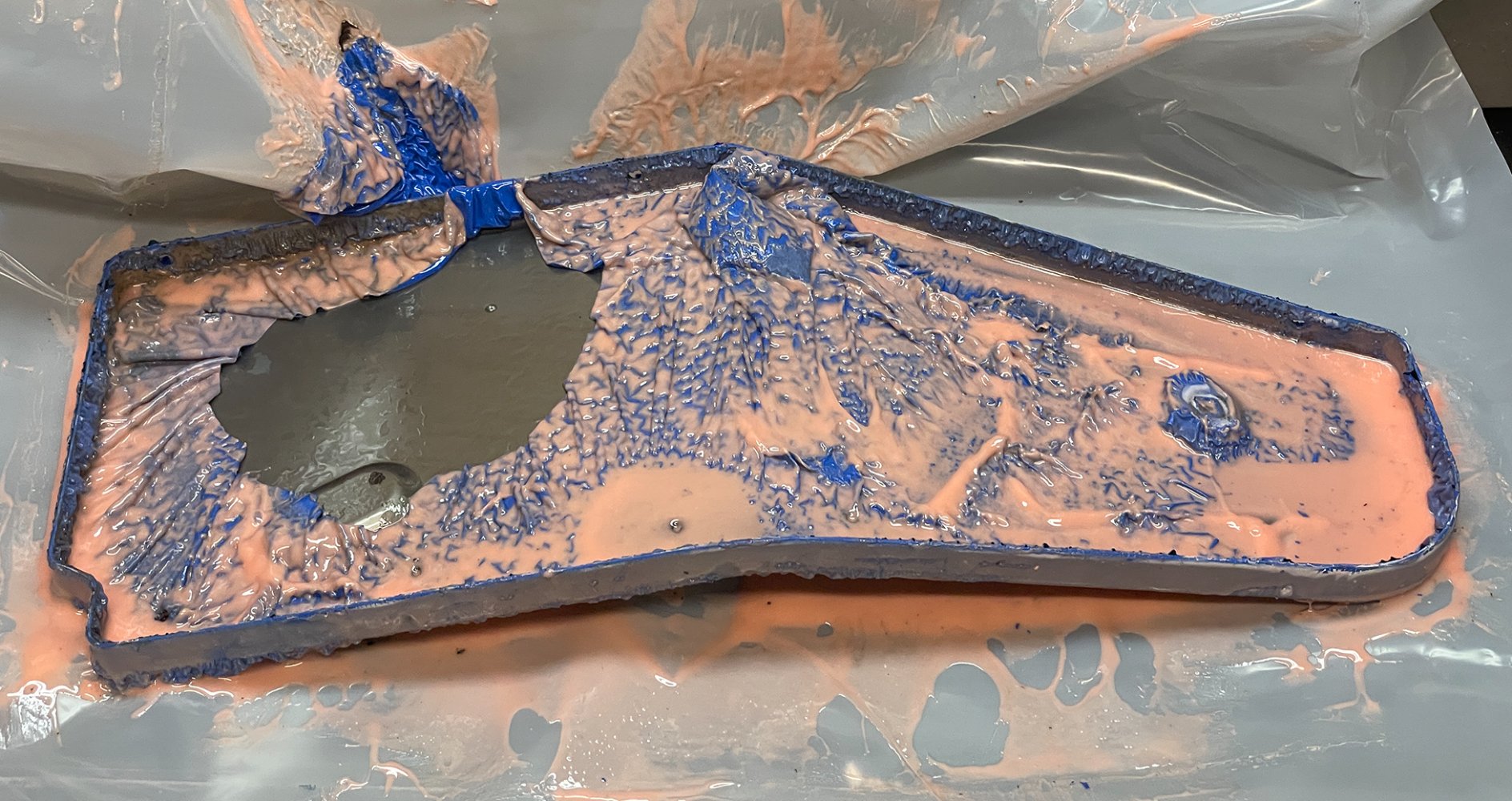

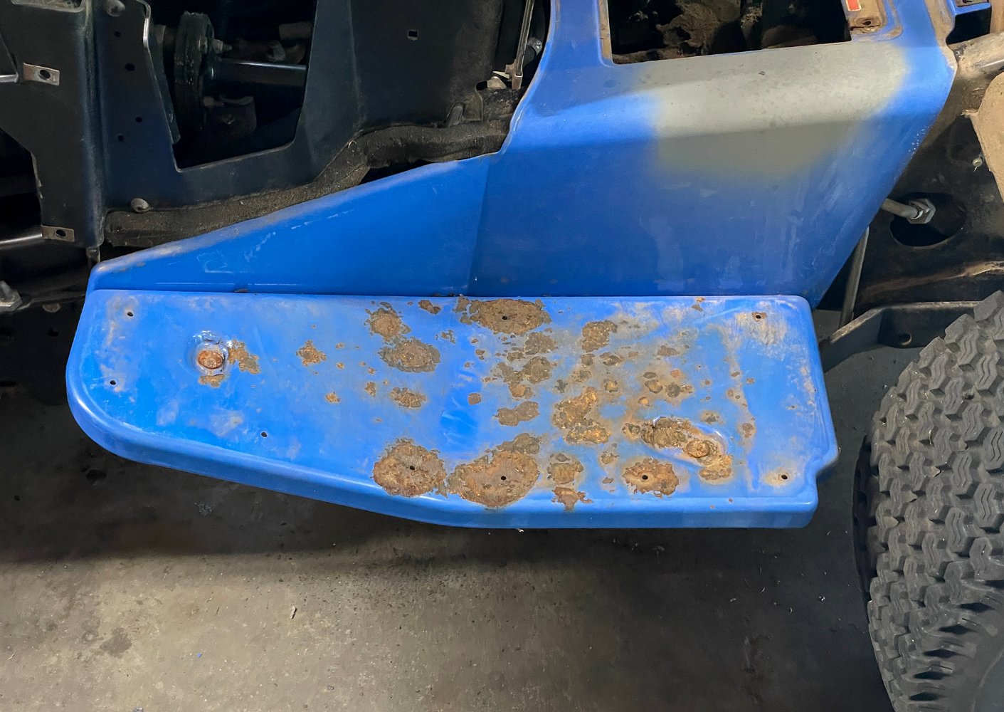

Piece by piece, I'm gradually getting the paint sorted on my recently acquired New Holland GT18 garden tractor. Here are the steps in fixing up one of the foot rests:

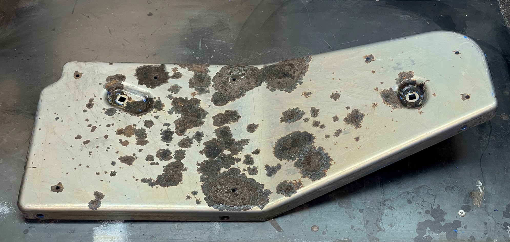

A fair amount of rust had developed on this foot rest panel under the rubber mat:
I slathered on a thick coat of CitriStrip, wrapped it in a poly sheet, and let it sit for a few hours. About 98% of the paint came right off without any scrubbing or scraping:

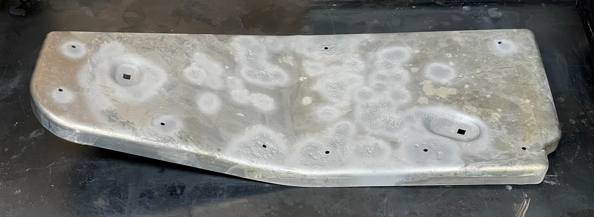

Here's how it looked after washing off the CitriStrip and removing a few bits of remaining paint (the rust isn't quite as deep as it looks):

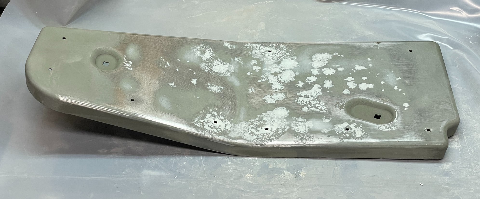

Next, I let it sit in a phosphoric acid bath for a while, which took care of most of the rust, and then hit any stubborn remaining pockets with my spot blaster:
(Note: I don't use an acid bath for high-strength or hardened steel, since I want to avoid hydrogen embrittlement.)

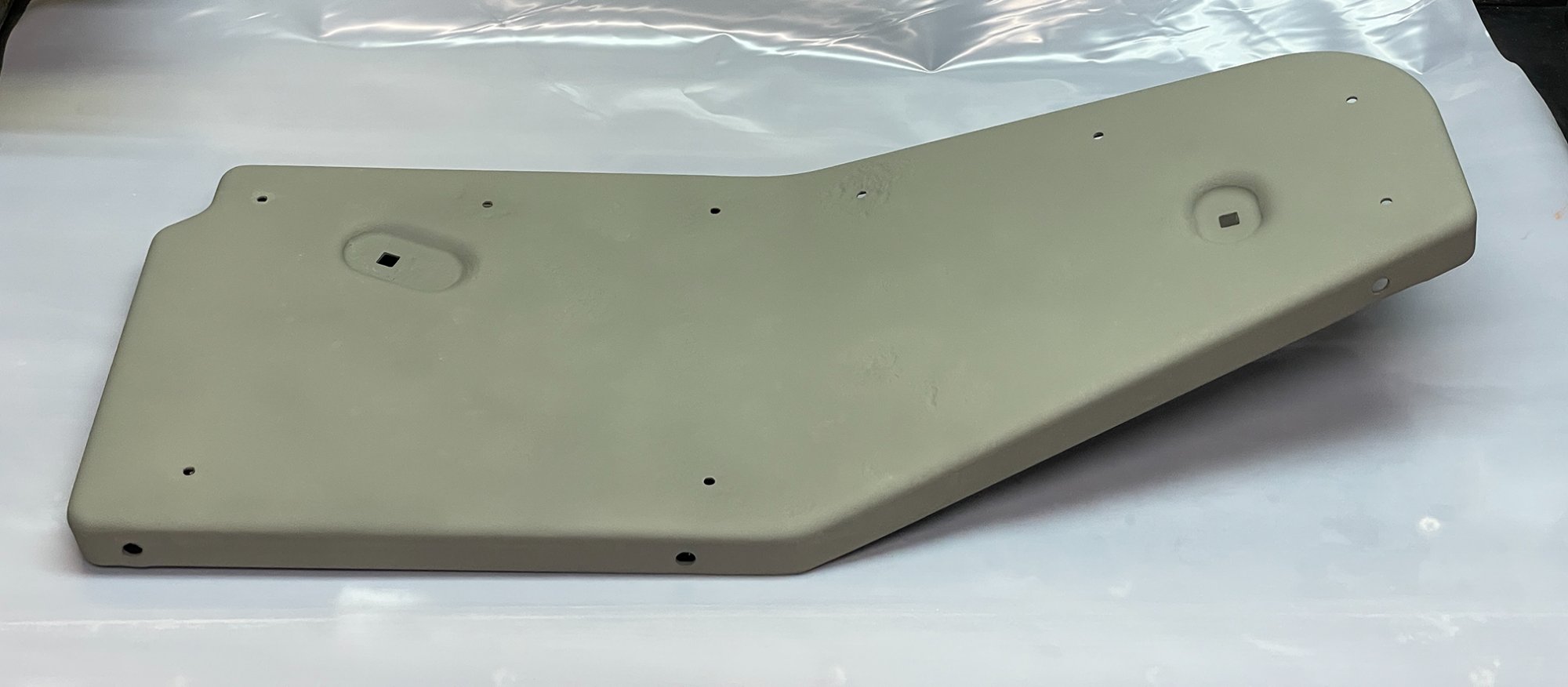

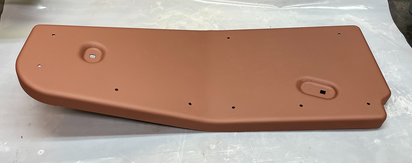

I applied the initial coat of self-etching primer, which contains zinc phosphate:
Then I filled the pits with 3M High-Bond filler and sanded it flat:
Here it is after more primer coats:

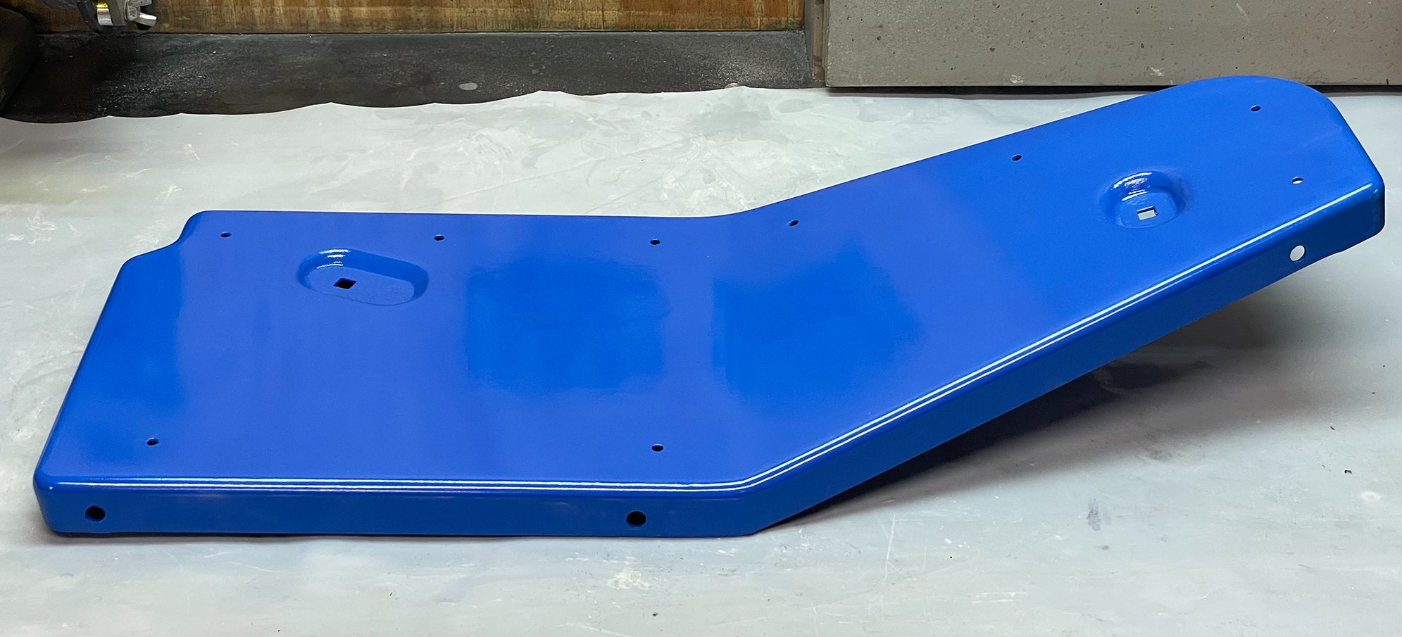

And after a few coats of paint:

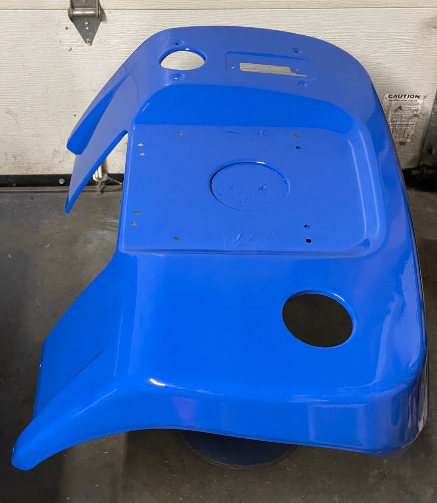

I'm in the process of refinishing the other sheet metal panels. Here's the rear body panel after prep and painting (what looks like wrinkled paint is just masking tape over the data labels):
Another half dozen panels to go. So far, I've just been using factory-approved rattle can paint, but I just ordered a quart of the paint so that I can use an HVLP gun on the rest of the panels.
