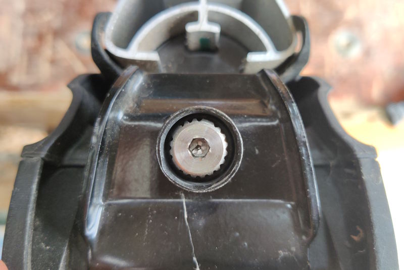

I described the torque wrench as a security torque wrench. This is one of the screws that hold the bars in place:
Thankfully, with the bars off the car, it's quite easy to get mole grips around the outside of the screw so I could get it out. I searched around to see if I could buy a replacement torque wrench (even if it involved also buying replacement screws to match), but nowhere seems to stock them any more.
Having a lathe and a rotary broach is quite handy at times:
I can now fit/remove the screws with a 4 mm Allen key. Now obviously it isn't secure any more, but I've never attached anything to the roof bars in a lockable manner (I don't have a roof box or anything like that): I mostly use it for carrying hardwood planks or plywood sheets. If someone wanted to nick those, they'd just have to undo the ratchet straps and leave the roof bars in place. I guess there's a risk that someone nicks the roof bars themselves, but I'd expect that risk to be quite low (you'd have to be lifting the cover flap off the roof bars to see that the screws had been modified and then you'd have to have the right size Allen key). Also, I rarely leave the roof bars on the car for very long so again the risk is low.
I did consider just removing the outer washer/shroud thing (that shields the outside of the screw from being undone with pliers), but this felt like a more elegant solution and it's easier to use a t-handle Allen key than a pair of pliers. Also, if I can figure out the torque setting of the original torque wrench (I haven't found it yet), I could choose to use a torque wrench with an Allen key bit to tighten it to the correct torque.
