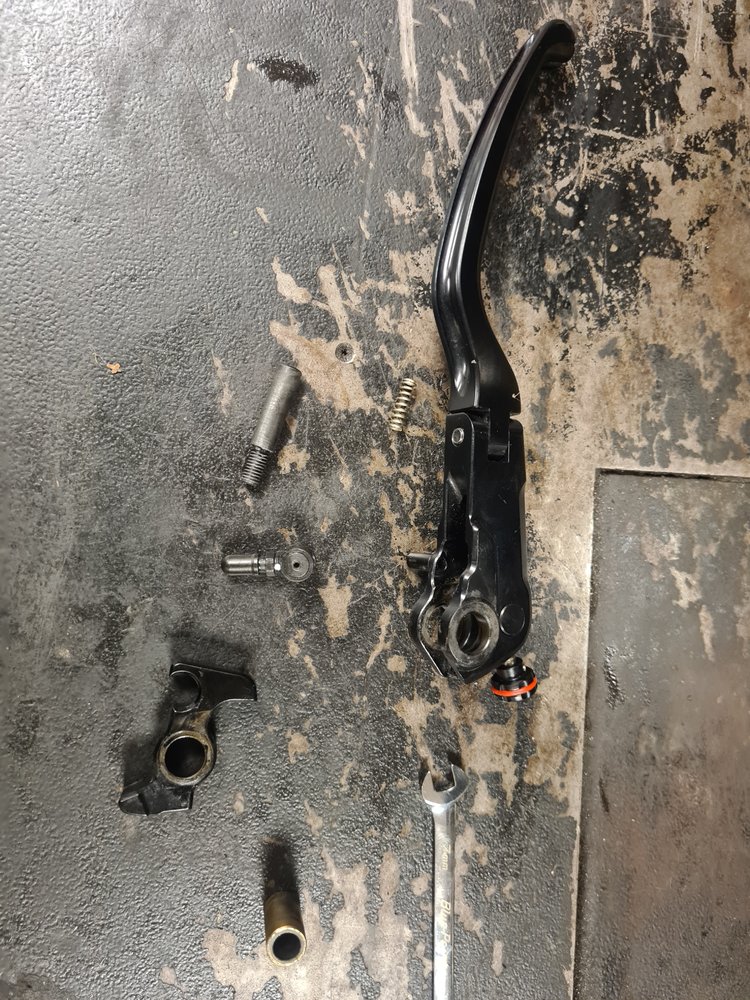

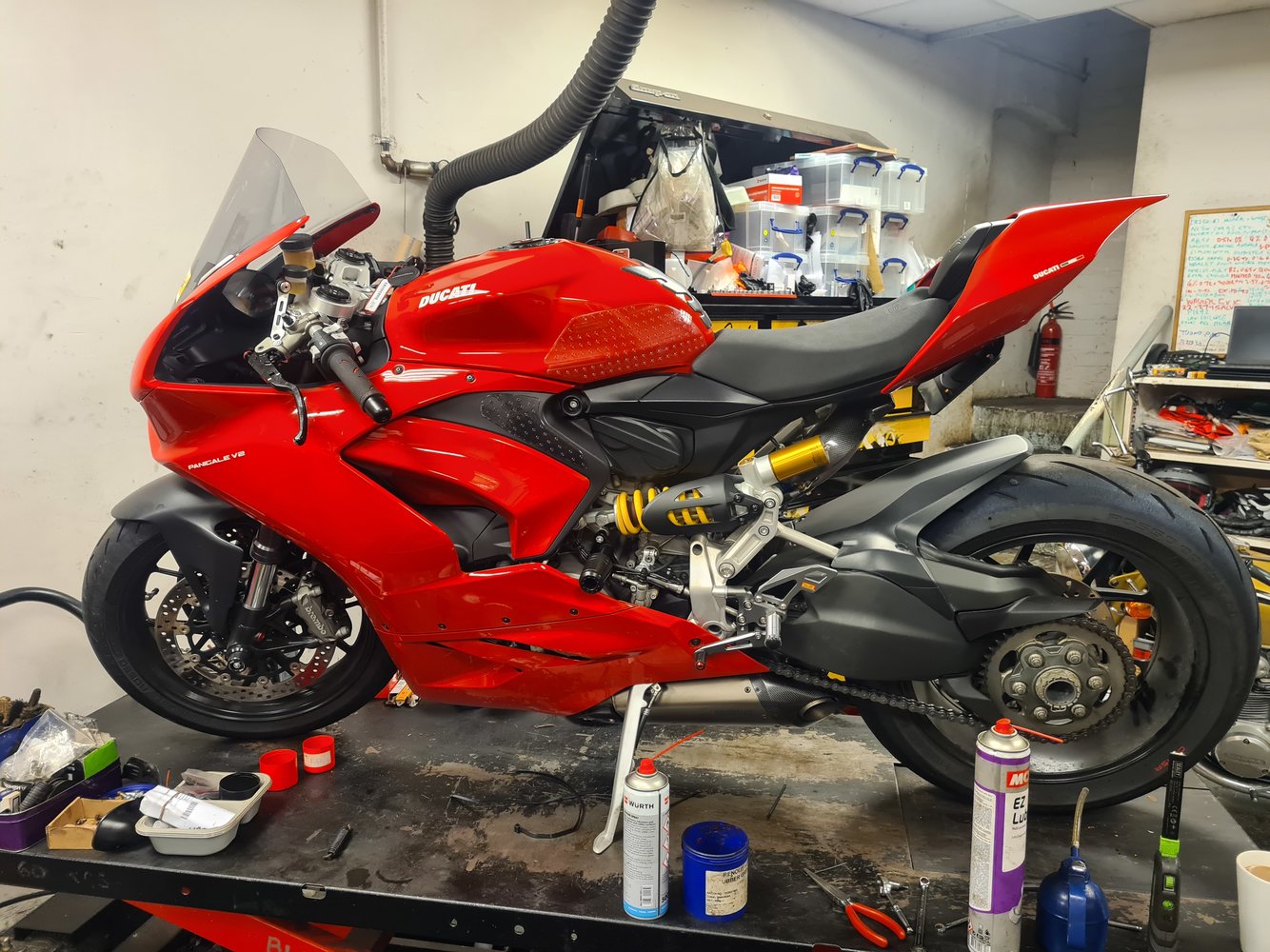

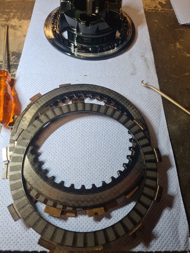

Fancy bike, fancy bits, burnt out clutch in 2000 miles..

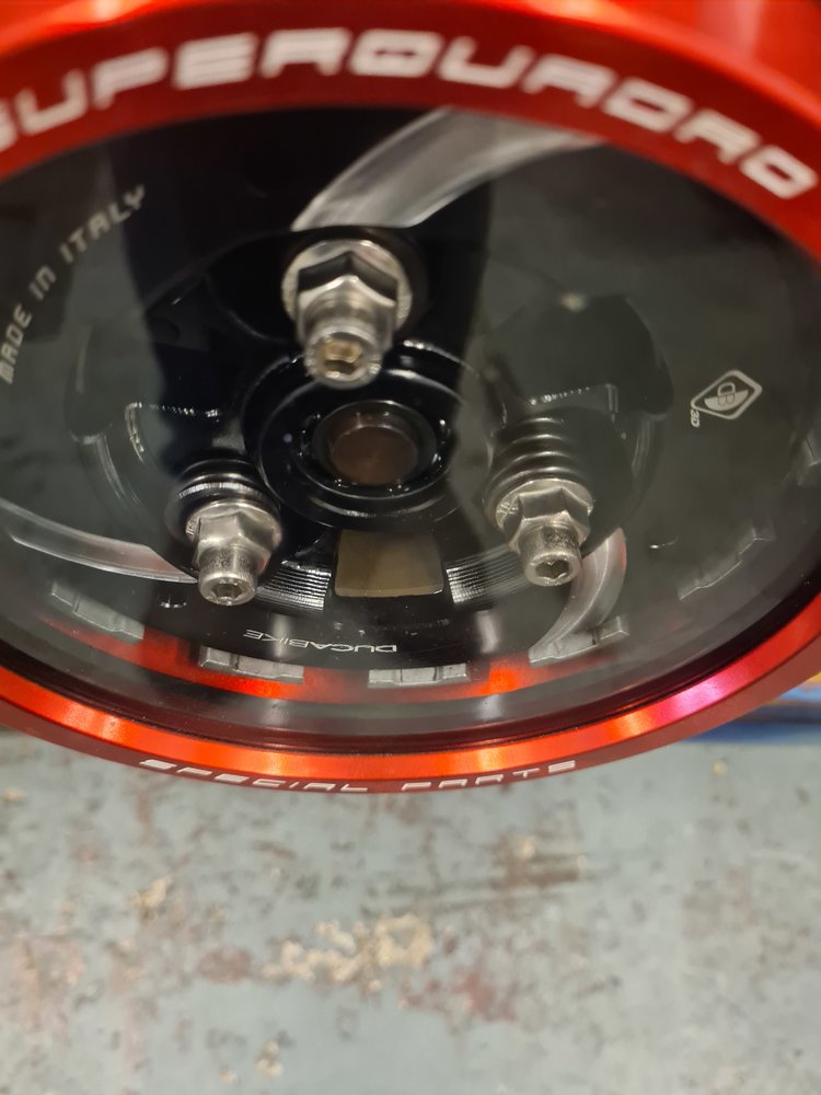

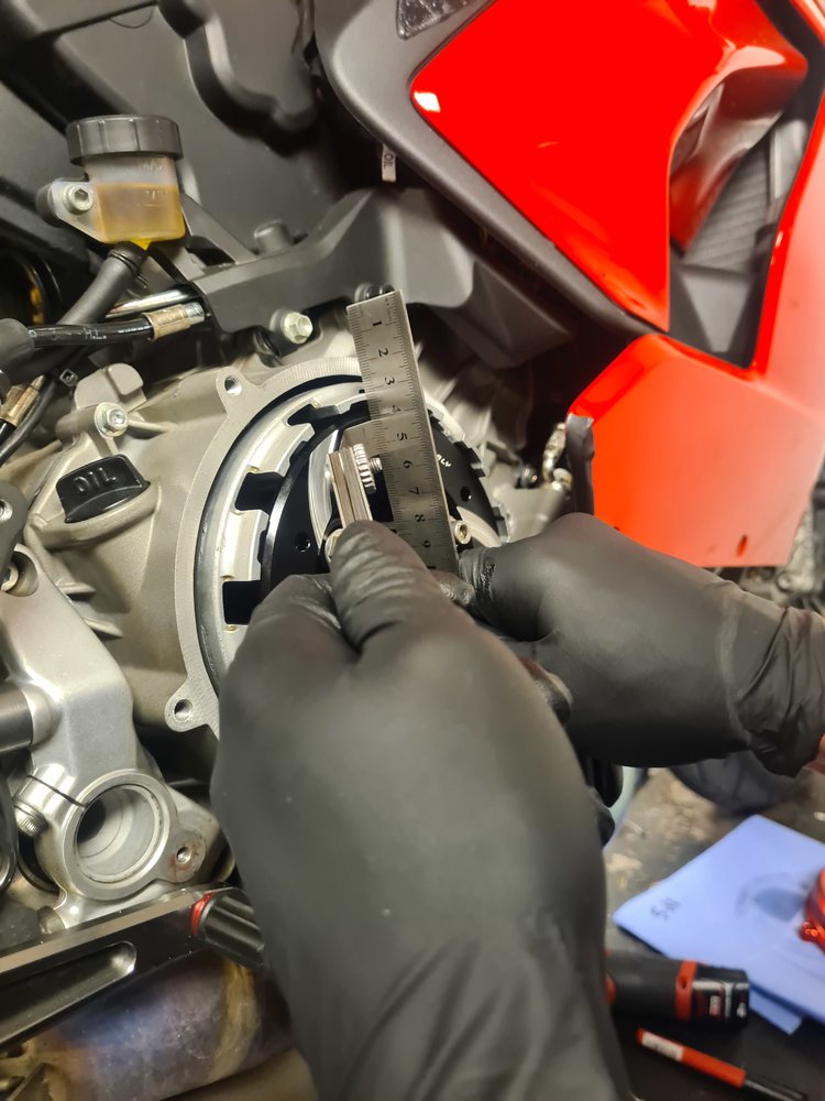

I've got an idea why it's failed but waiting on a new Ducati clutch pack to turn up to do some measuring.
Feel sorry for customer as they bought it all done (ex display bike), obviously person who fitted it all didn't check it afterwards.
I've already proven it's not a hydraulic issue so can't do any more until new clutch turns up.
A lot to be said for leaving stuff alone / standard imho.
Clutch Pack is £400, plus time for fitting and more time to work out which aftermarket part caused the fault in the first place..
View attachment 412711View attachment 412712

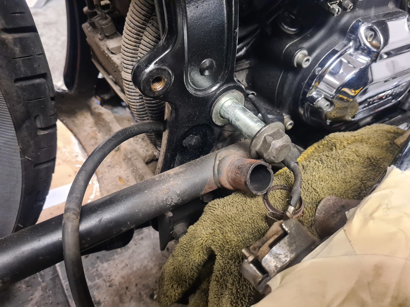

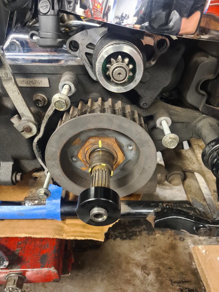

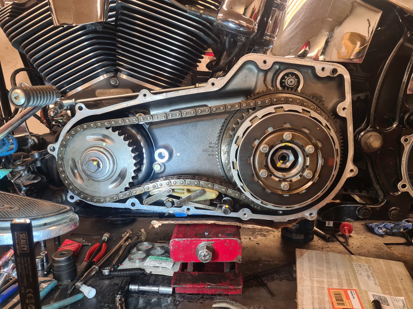

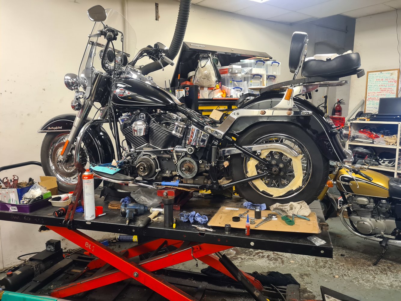

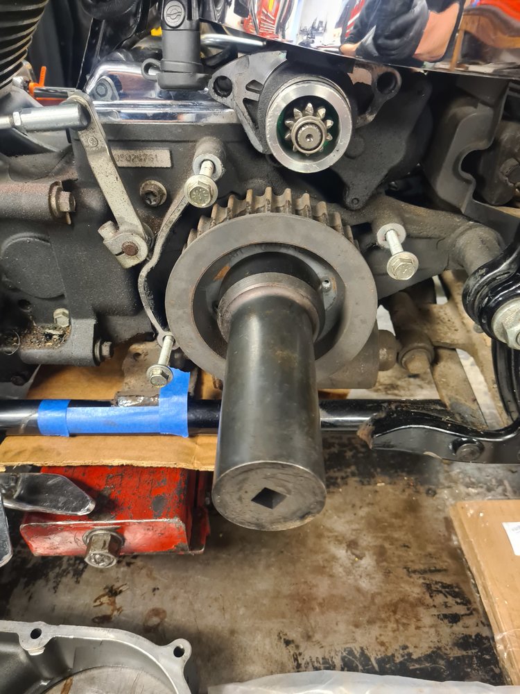

From one end of the performance and technology scale to the other!Harley Softail Drivebelt and pulley replacement.
Remove all the Primary Drive / Clutches and casings, remove exhaust (because they fit the swingarm pivot from the rhs!).

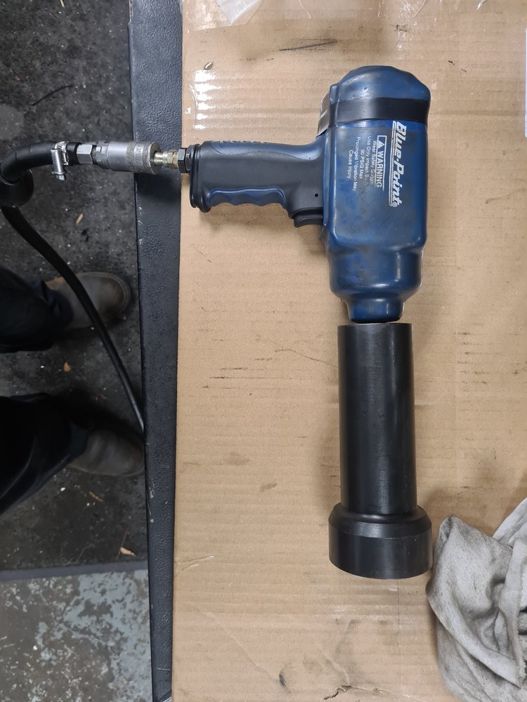

Special tool for front pulley. Special tool for Start bolts (otherwise it's oil tank out as well).
A lot of choice words along the way!.
I put swingarm spindle in from the left when rebuilding to save the next bloke in some time..
View attachment 412723View attachment 412724View attachment 412725View attachment 412726View attachment 412727

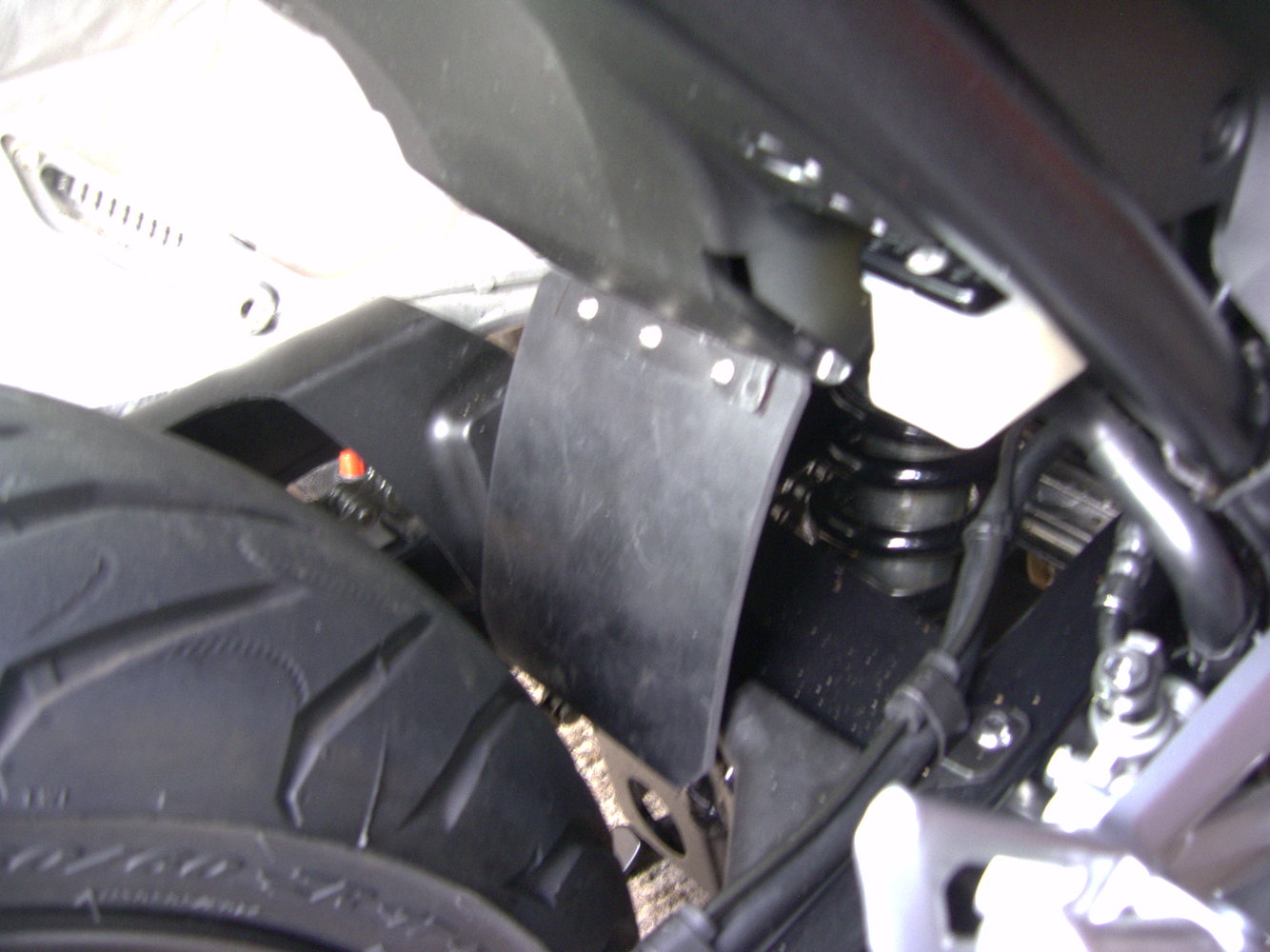

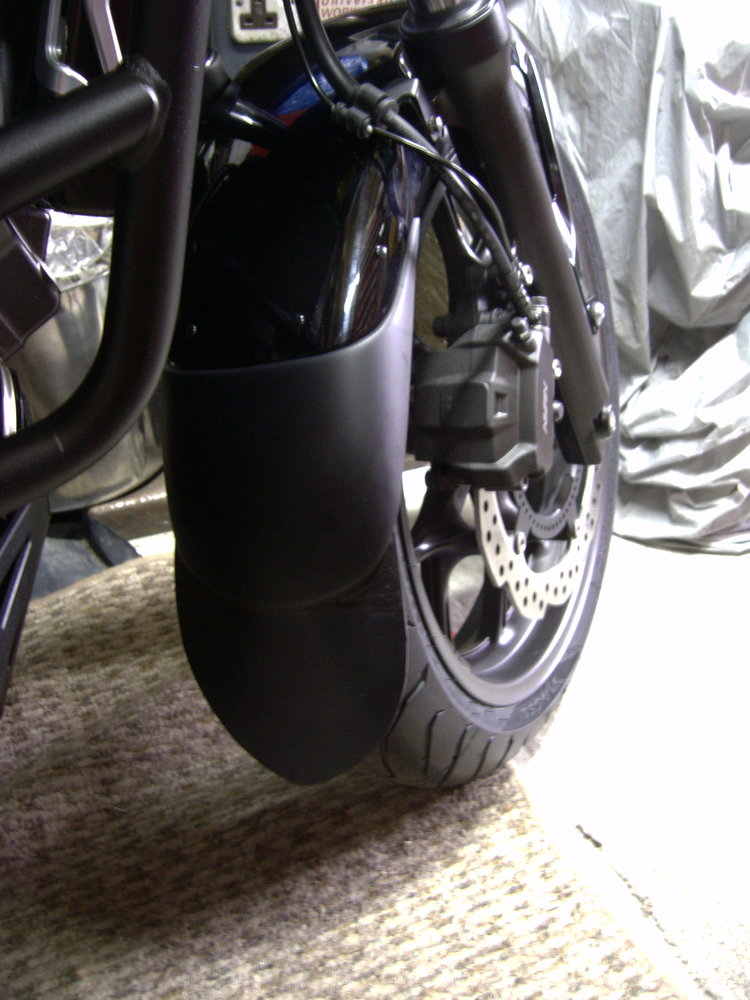

. Oh, its most likely a marketing sales scheme, catering to looks over function. Even the add on extensions are pretty much useless when it comes to keeping sheep & cow ***** from being slung up onto the engine or else ware. So, I bought an A4 size sheet of 4mm thick neoprene and fabricated a five inch extension for the Pyramid extension I initially acquired for extending the stock Honda fender on my recently acquired bike. I'm happy with the result, and had enough material left over to make a deflector to keep debris off the rear shock.
