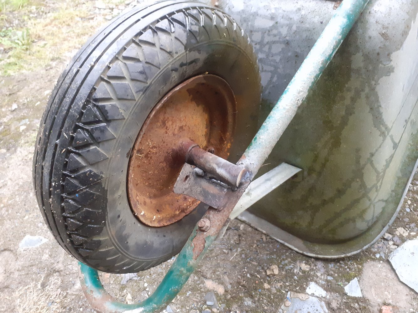

But look on the bright side: The welded-on axle practically eliminates high-speed wheelbarrow accidents!Really chuffed I went to spin the wheel and realised it's a solid axel designed to run in bearings!
I now have a static flower planter.....

Bit of a Rodney moment for me!But look on the bright side: The welded-on axle practically eliminates high-speed wheelbarrow accidents!![]()

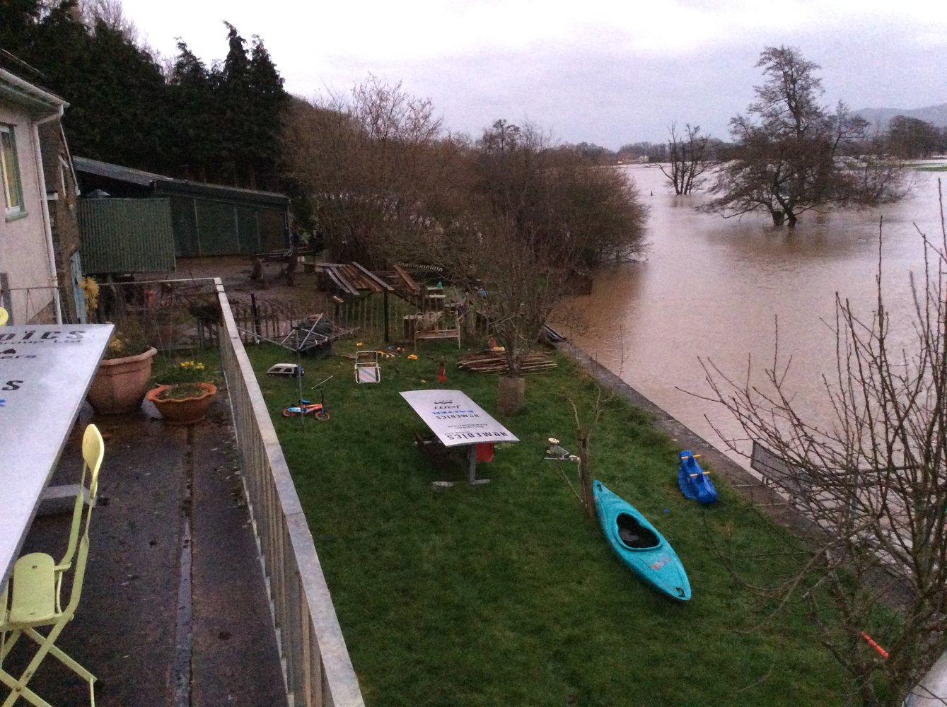

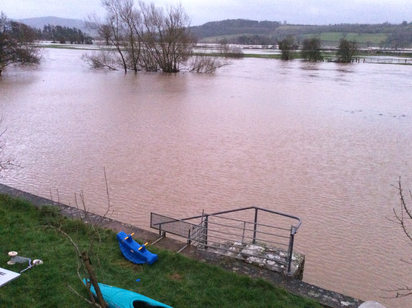

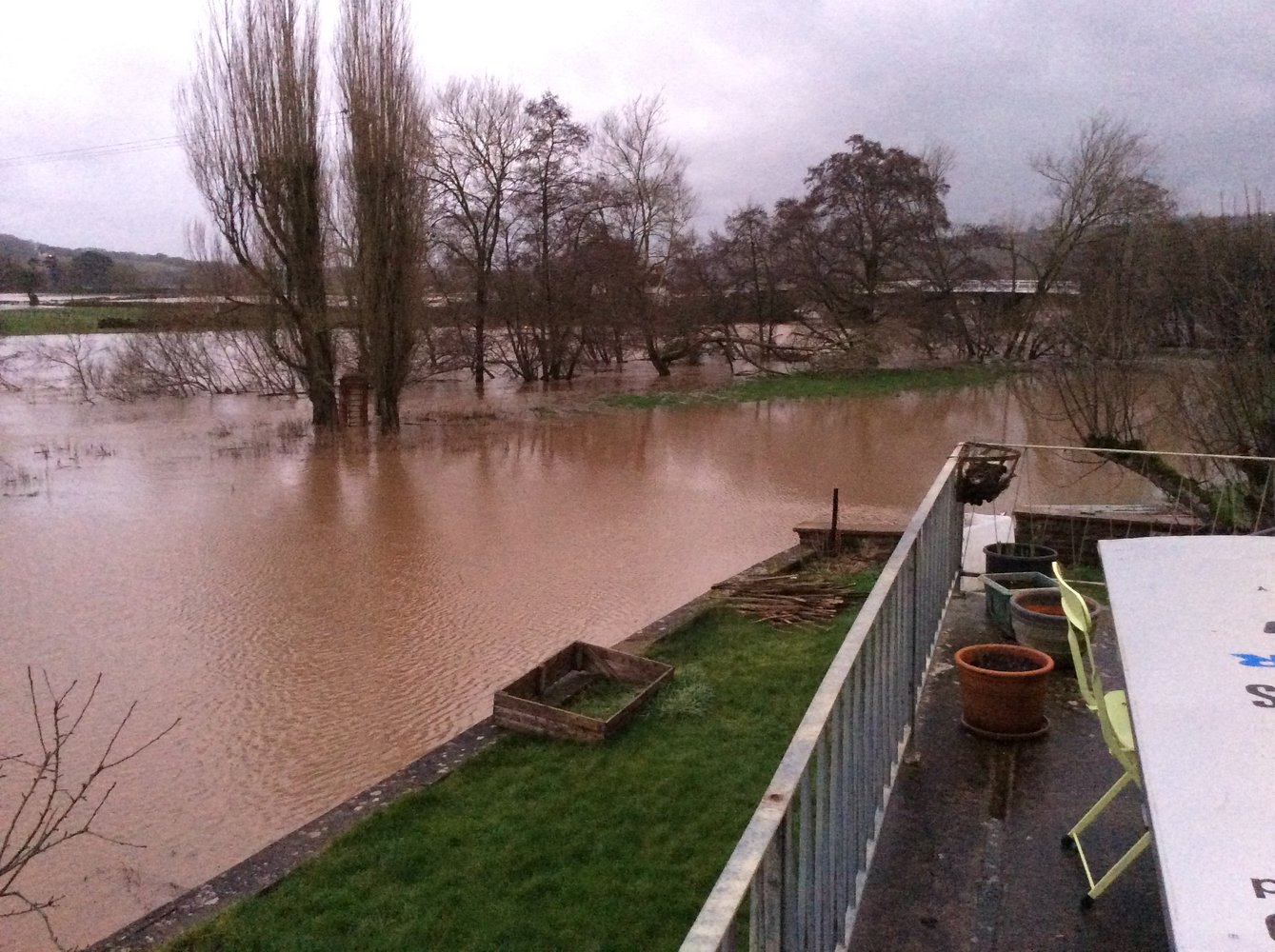

Are the trees holding the phone box, or viki-verki?@slim_boy_fat @dobbslc ,it’s close ,but not that close!were 3’above the highest flood I’ve experienced in 33years,which was last February.
I did post a few photos of that one last year.

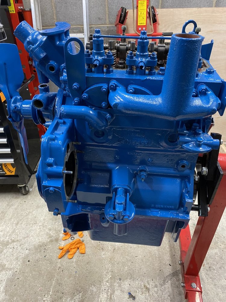

Can’t wait to hear it runNot all today, but over a few weekends, rebuilt a Perkins P3, new liners, crank, rings, bearings, all clearances to factory spec, put together and the first coat of Fordson Empire Blue on. Needs another coat before bolting the bits and pieces back on, the fitting the adapter plate and clutch and bolting back onto the body.
I was going to spray it but the castings are quite rough so a decent quality Tractol paint goes on nicely and can be worked well into the metal.
Looking forward to firing it up.

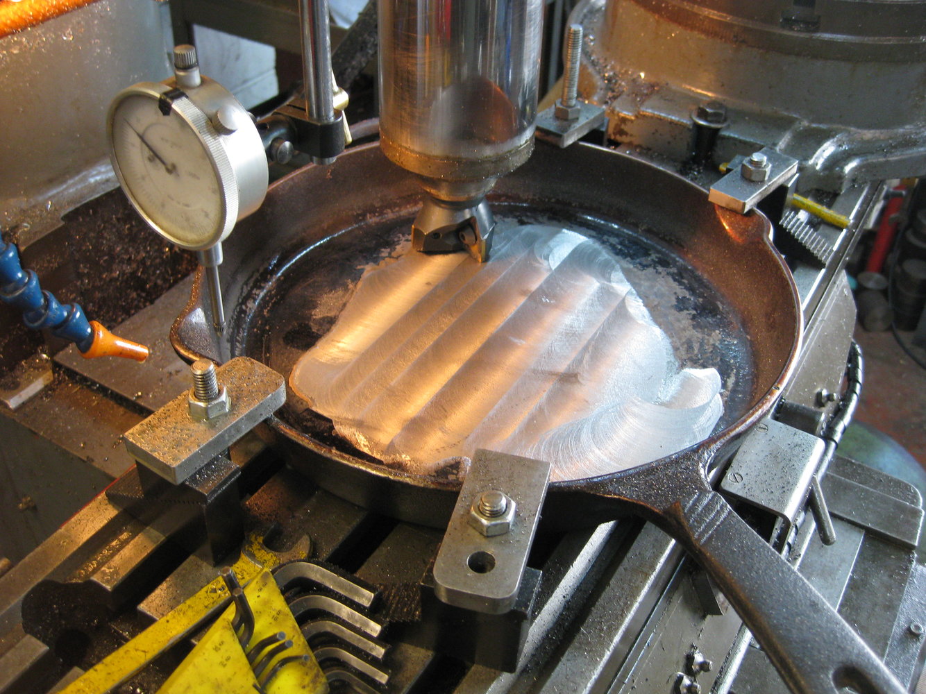

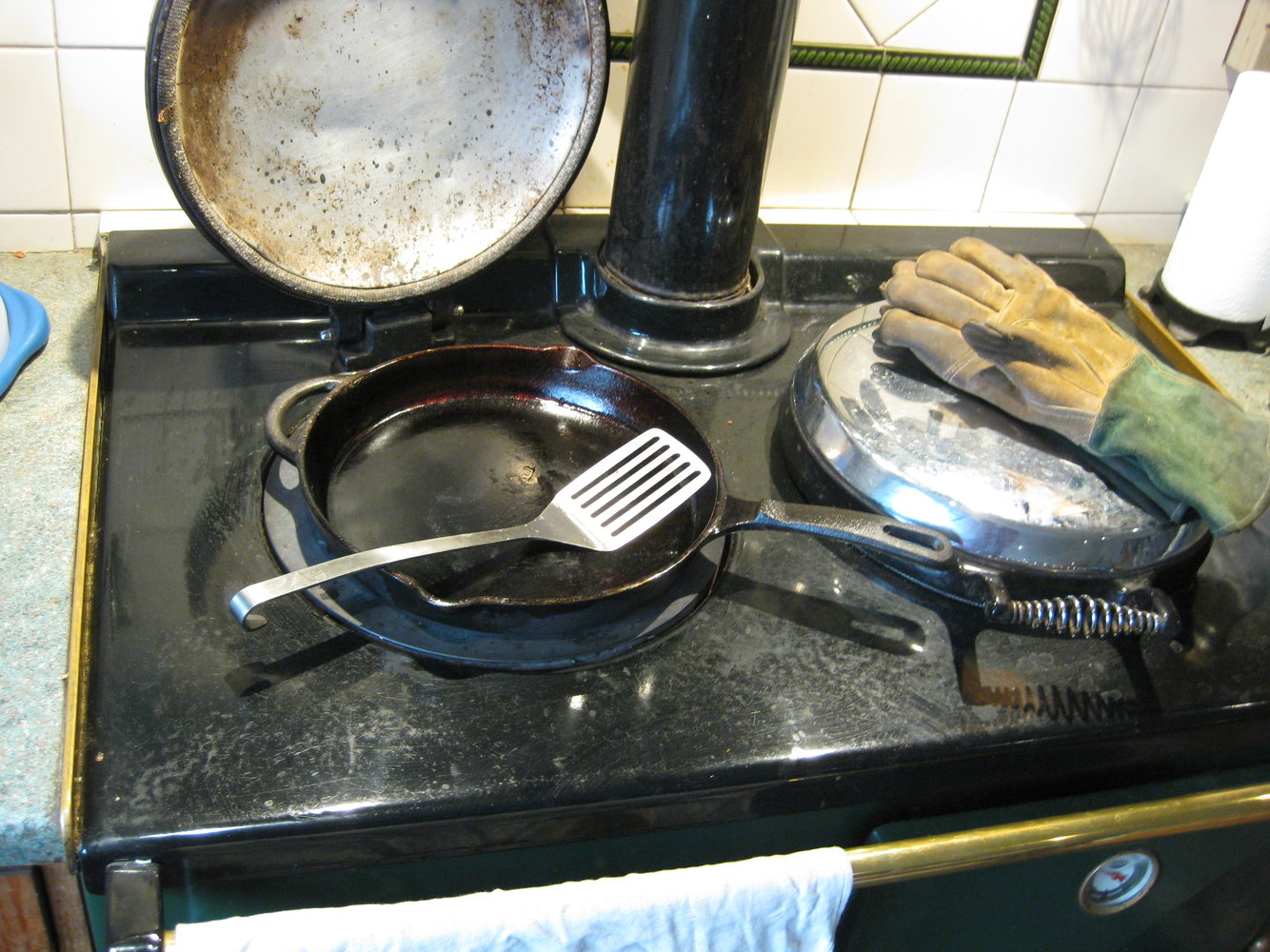

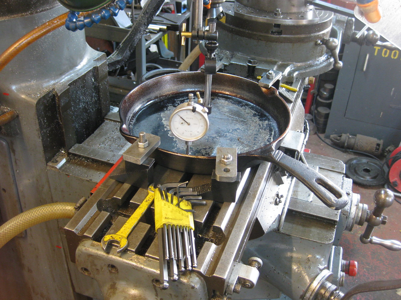

I have an induction hob at home, if I use a cheap frying pan that's not 100% flat on the bottom the pan gets hot spots!Some weeks ago I dropped my Le Creuset frying pan on the stone floor in our kitchen -the result was a frying pan with the entire handle section of the casting broken away. This was closely followed by disbelief at the £££ cost of a replacement. So I bought a bog standard cast iron frying pan from Amazon for ££, reasoning that once it was seasoned it would be non-stick without any fancy coatings. however, the inside of this pan had a noticeable dome in the centre.
Resulting in one of my more unusual milling jobs....
Not really looking for a surface plate degree of flatness but needed to get an idea of what was doable with the dial gauge.
Blended the milling work with a 40 grit disc in the DA sander before seasoning it with some cooking oil and returning it to its natural environment.
