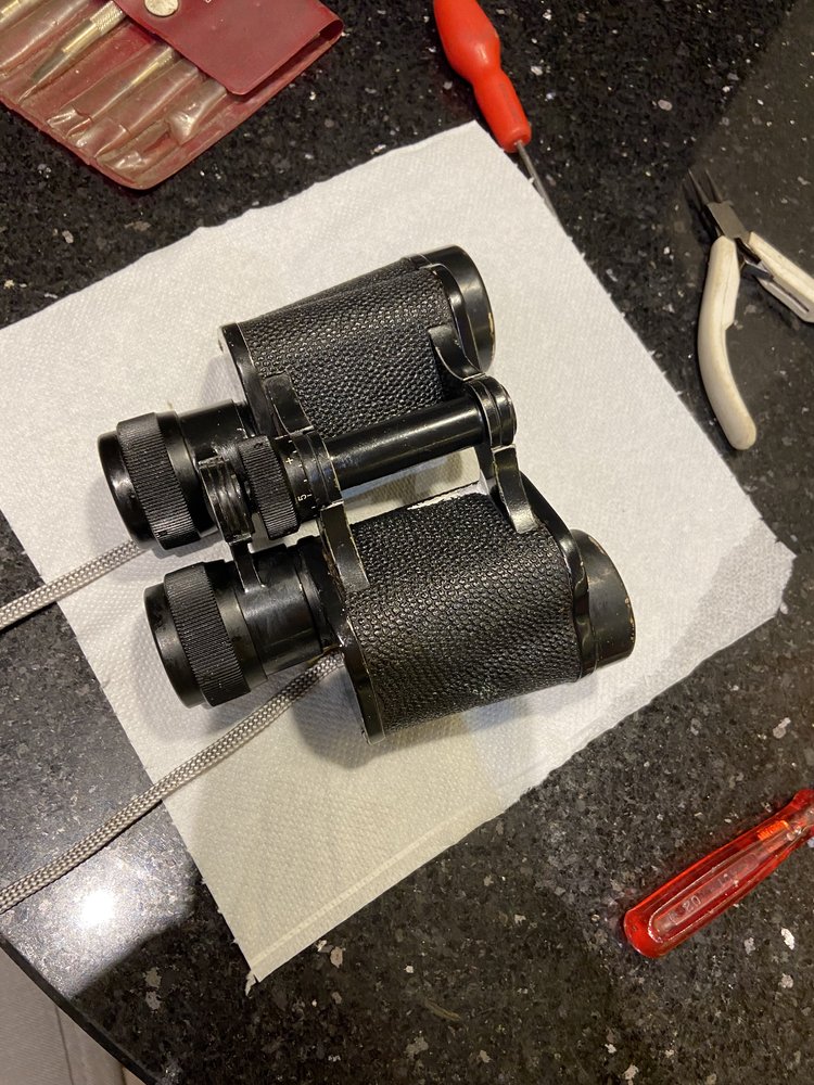

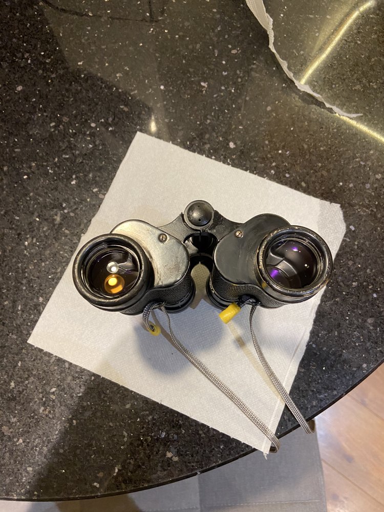

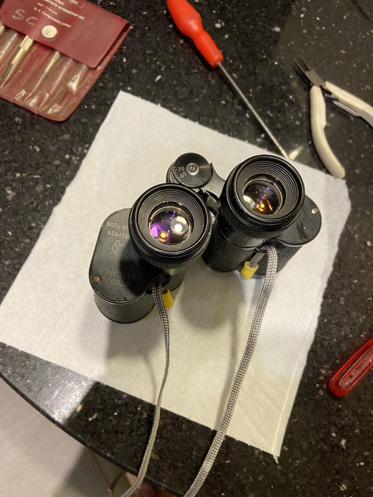

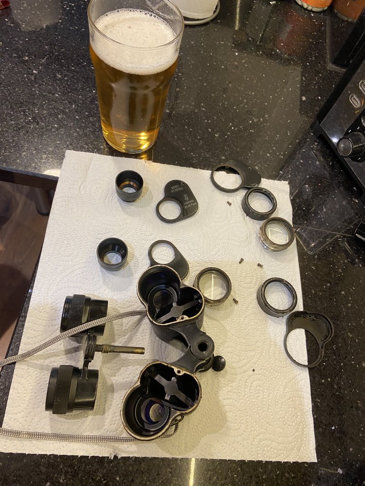

Ive left the prisms in. I do have a book on how they were collimated. Manahed to clean them, there were a few spots of fungal growth . Theyre good quality fully coated not sure when they were madeCan you re-collimate binoculars yourself? I'd always imagined it was something that needed special kit, maybe lasers and an optical bench.![]()
Made at the KOMZ plant (thats the logo), possibly in 1965 - the Soviets had a habit of the first two numbers of the serial being the year, but it's not always the case.Ive left the prisms in. I do have a book on how they were collimated. Manahed to clean them, there were a few spots of fungal growth . Theyre good quality fully coated not sure when they were made

I bought a job lot of binos on ebay a while ago for £18 if I recall, amongst them a good pair of Bausch &Lomb. They were all good, gave one each to the grandkids, one in the motorhome etc.The patient survived. Much cleaner optics

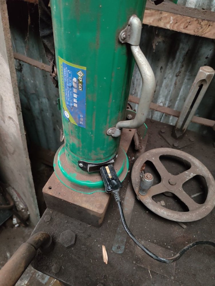

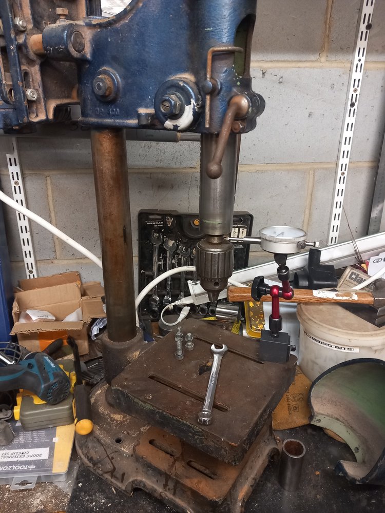

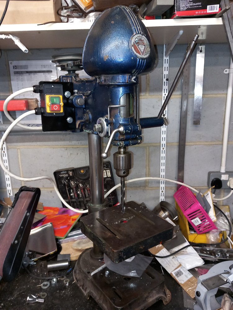

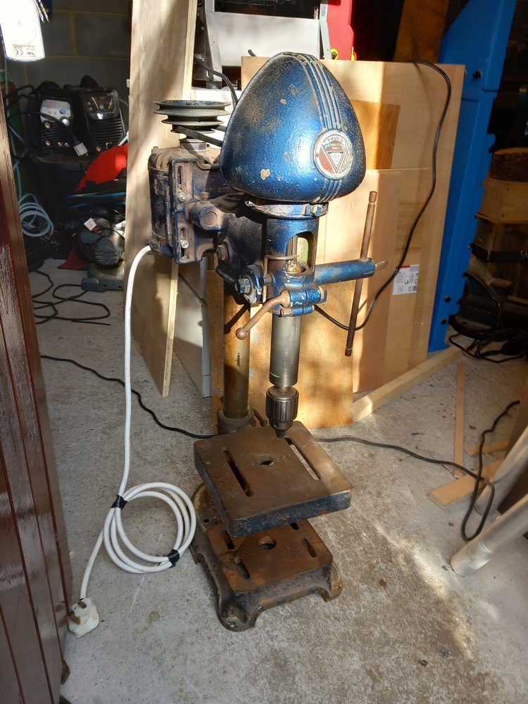

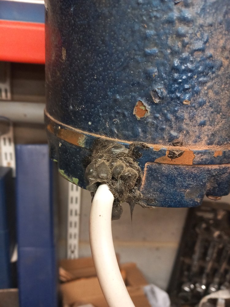

Was there not room to bring the cables out the back of the box?I've finished faffing with this Tauco drill. Still scruffy but useable now.
Before as purchased:
After:
New quill spring fitted. Switch and mounting plate added. Cable gland fitted to the motor and switch. Cleaned up most of the bare metal with a brass wheel. The top of the column has been mullered by previous owners so the body won't come off the top. I think it could do with a new pulley bearing but they are only available in the US. They retail at 60 odd dollars before shipping and customs. Will just have to live with it. I reused the cable which is chunky 2.5mm square, hence the large loop from the motor to the switch. The switch makes it look like an Aldi Special Buy, but I couldn't find anything period and cheap.

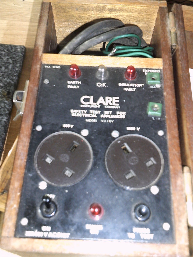

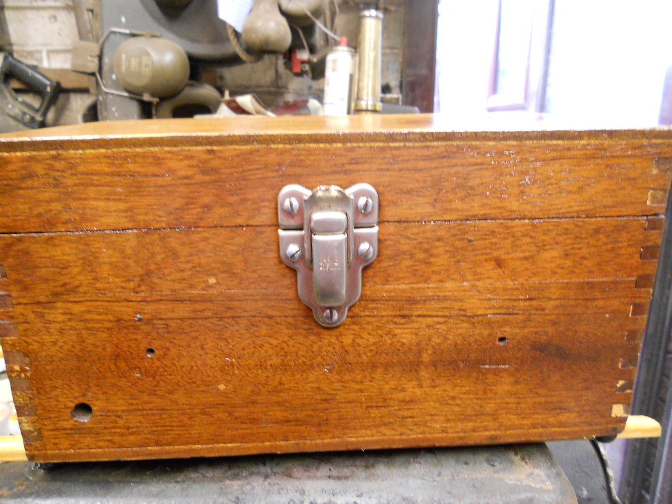

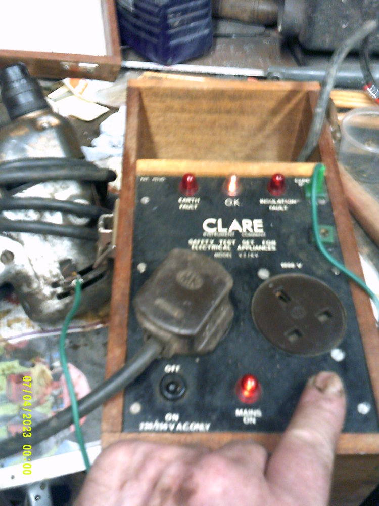

It’s a go-no go type portable appliance test kit.View attachment 408065

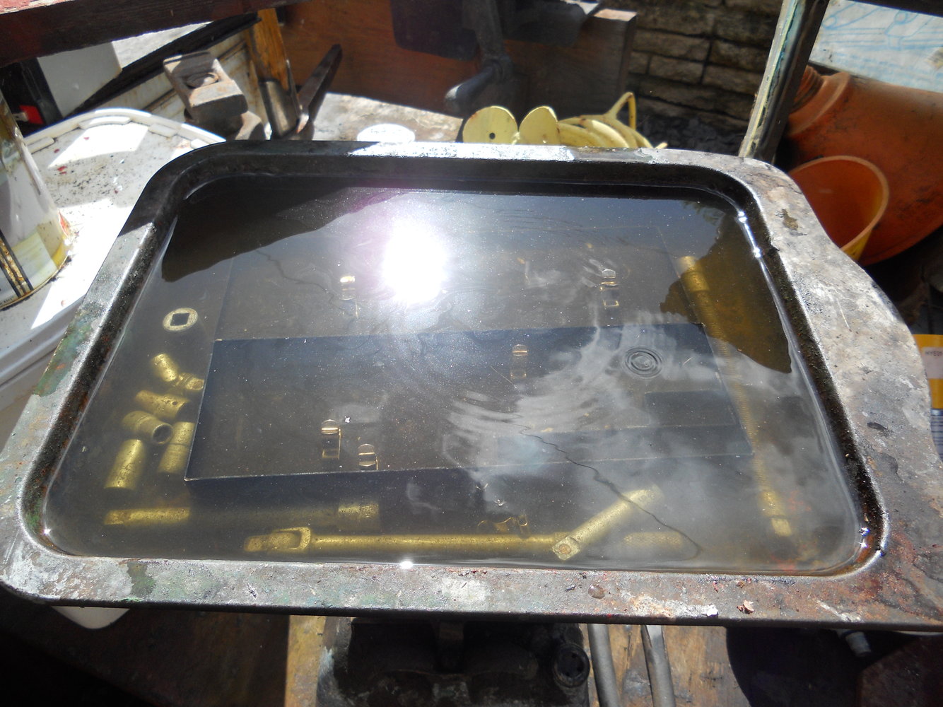

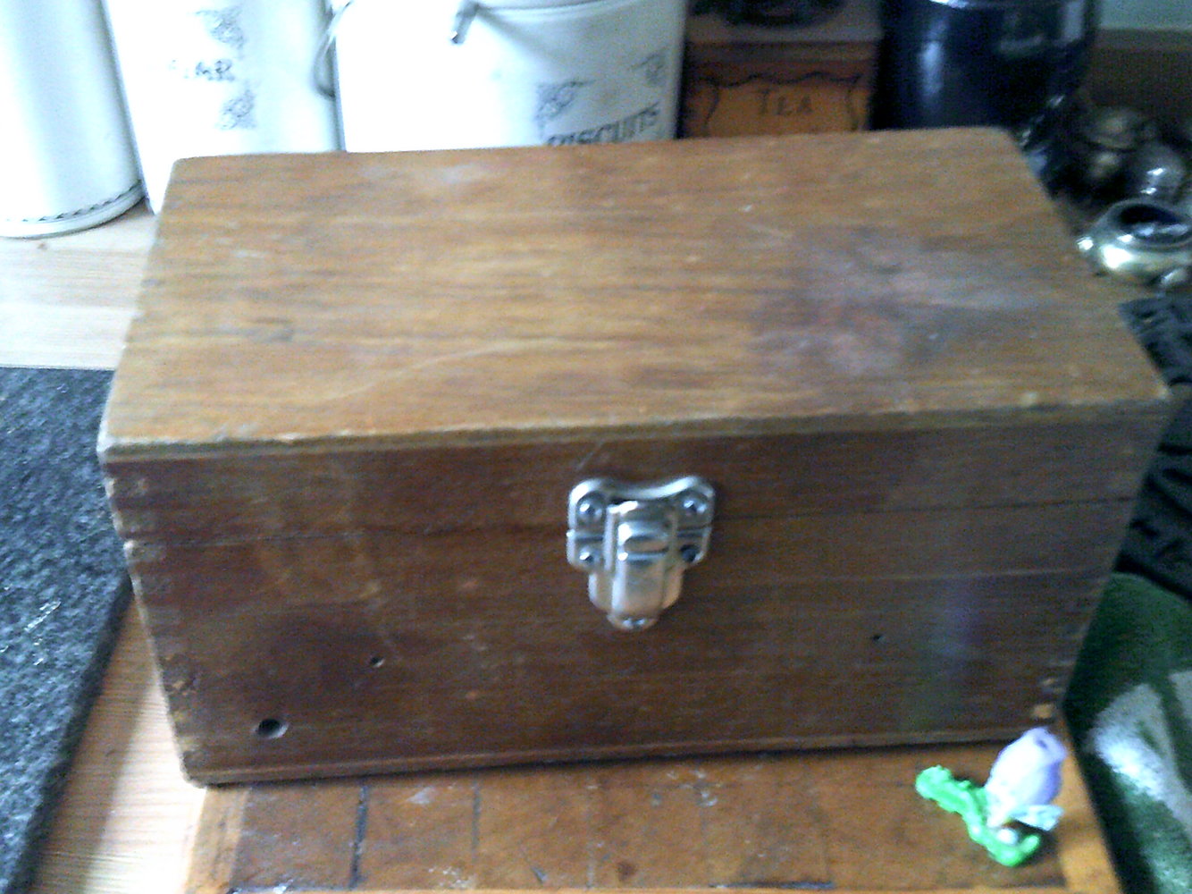

This Care Earth Leakage Tester came my way the other day.
The lid was seized tight, the hinges were the issue.
But opening it, it was complete and even better.
It worked.

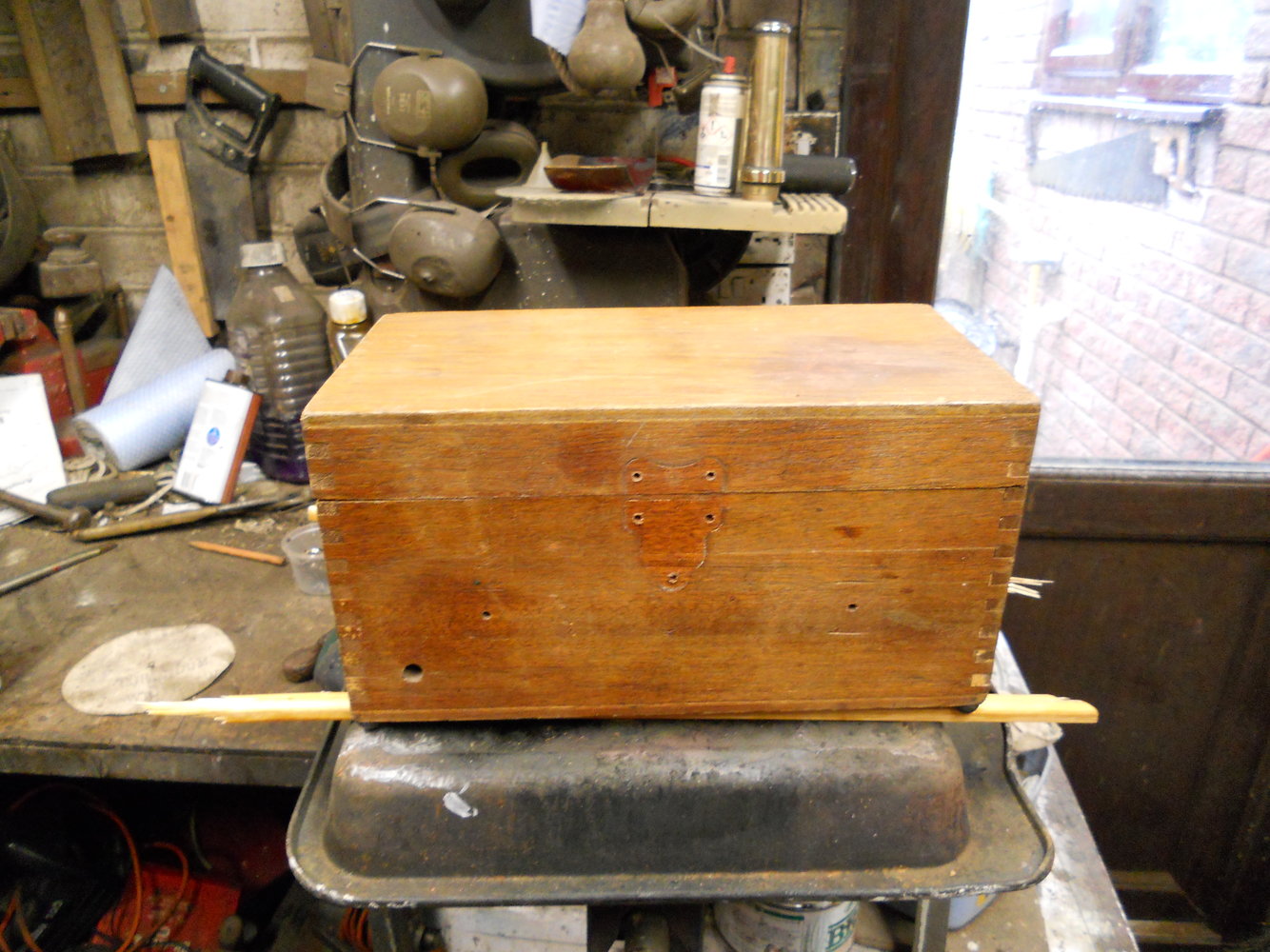

Copper on show, this and the new hinges were New Old stock from the manufacture.
In the clean up.
Off cuts from a old car wing were turned into a scraper.

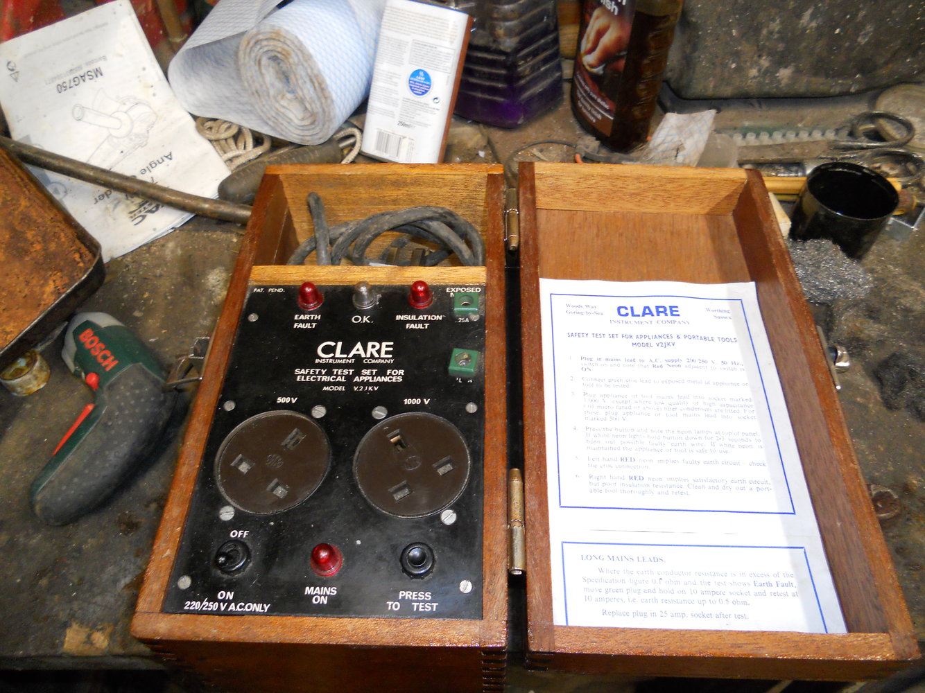

Finished.
Now on its way to its new owner.
Next time you could use 20mm conduit couplers with 20mm bushes, you can get long pattern bushes if youre going through thick stuff, the glands would just screw into the couplersThe threads on the cable glands are very short. I drilled a hole in the back of the mounting plate and box to do this but the plate is four or five mm and there was no thread poking through the box to secure with the nut.
I'm not a fan of the loop sticking out of the side but it is high up and well to the rear of everything.
Edit.
I could have made a large clearance hole in the back so the 5mm plate wouldn't be an issue. I do get terrible tunnel vision when I'm working.
I will look through my boxes of electrical treasures for some thinner, more compliant cable that I can route better.
