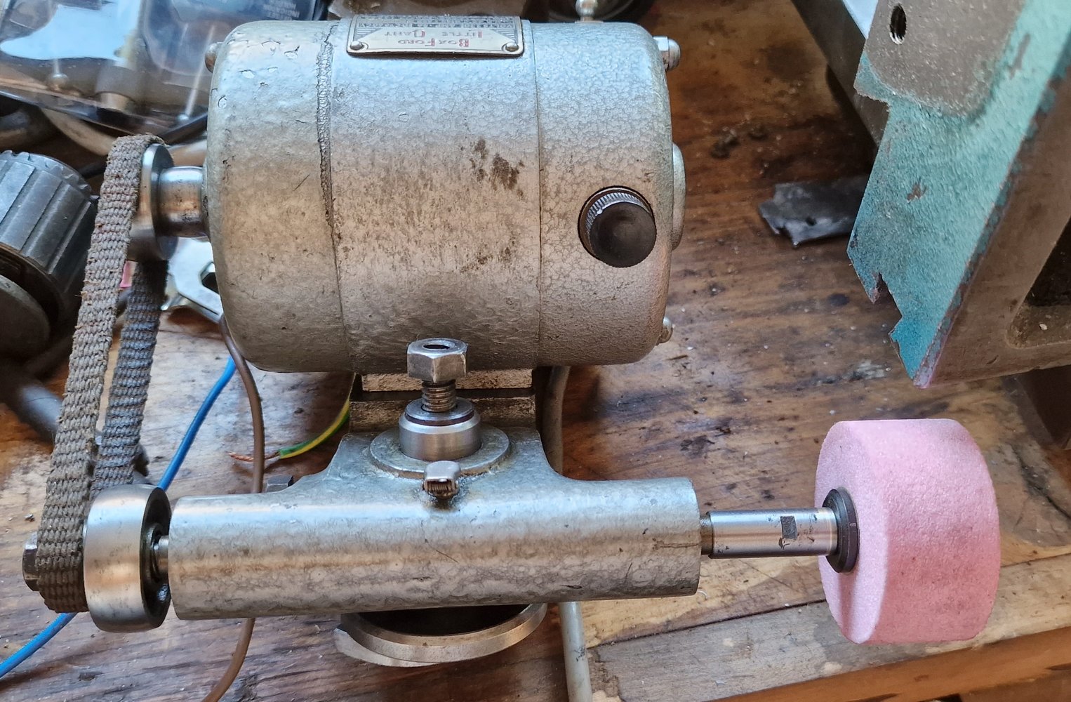

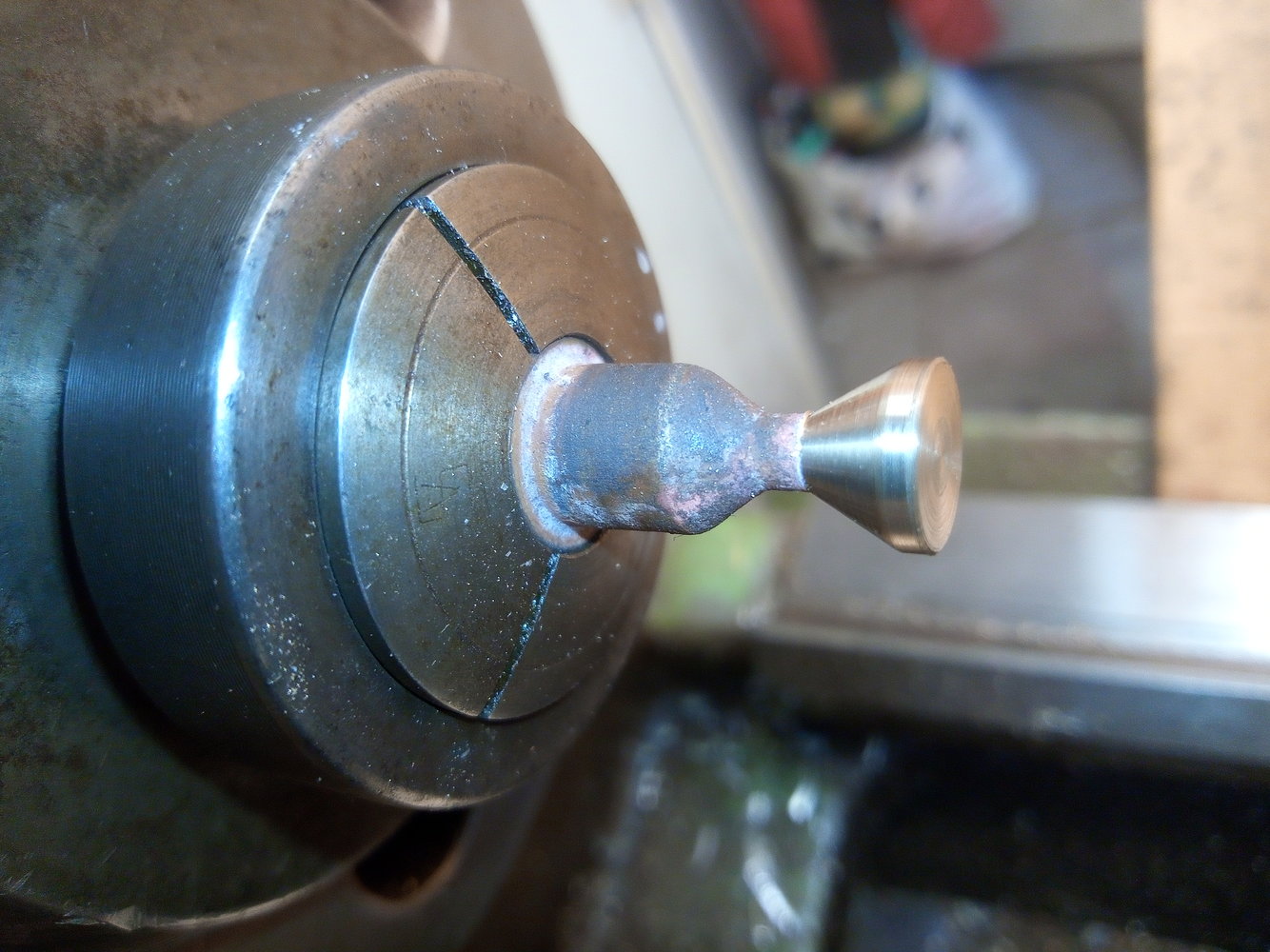

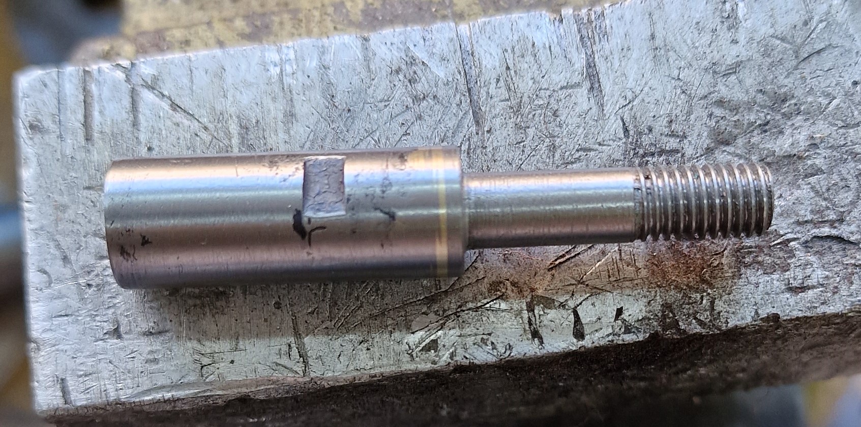

I attempted to use my as-yet untried tool post grinder. That ended up with a complete rebuild

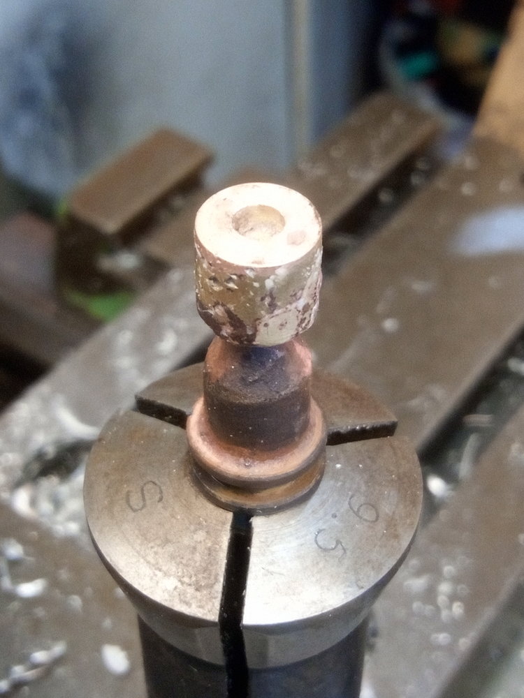

Today I gave it another go, only to find that the stone arbour was bent. It had been badly repaired (no image) so I had to put it right.
Cue some lathe work and silver soldering. I tuned the threaded part off, then drilled the body ready to tap it to screw another piece in. Only to discover that that had already been done and a poor bit of silver soldering had been resulted in the thread being slightly off-centre. The shaft had then been skimmed, but was still out of true and undersize.
I just bored the end with a 1/4" slot drill, turned a stub to go in, and then silver soldered it, before turning to size and threading the end. I took the opportunity to lengthen it by a few millimetres as well. The main spindle is either 1/4" x 32 ME or 1/4" x 32 UNEF. I thought it prudent to have a tap just in case the silver solder went where it shouldn't have done. It didn't, but I've still got a taper and plug, plus a die coming from Tracey Tools. Only £12 all-in.
Hopefully tomorrow I can get on with grinding the ends of the ball screws to diameter

That is assuming, of course, that they're fit for purpose.
