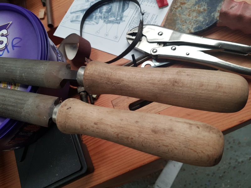

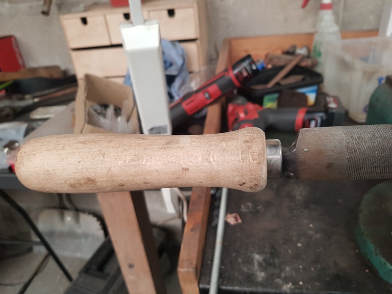

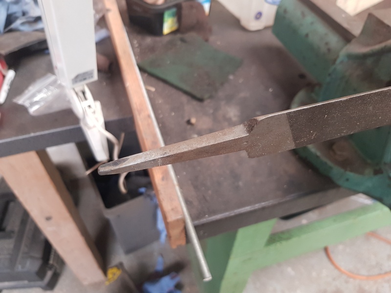

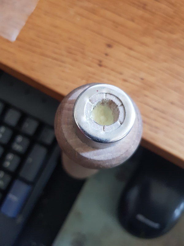

So, here's a file with a badly fitted handle, its one I probably picked up at a car boot or with some other tools
I thought his would be a good place to start. I drilled the handle out a bit more and filled it with sulphur

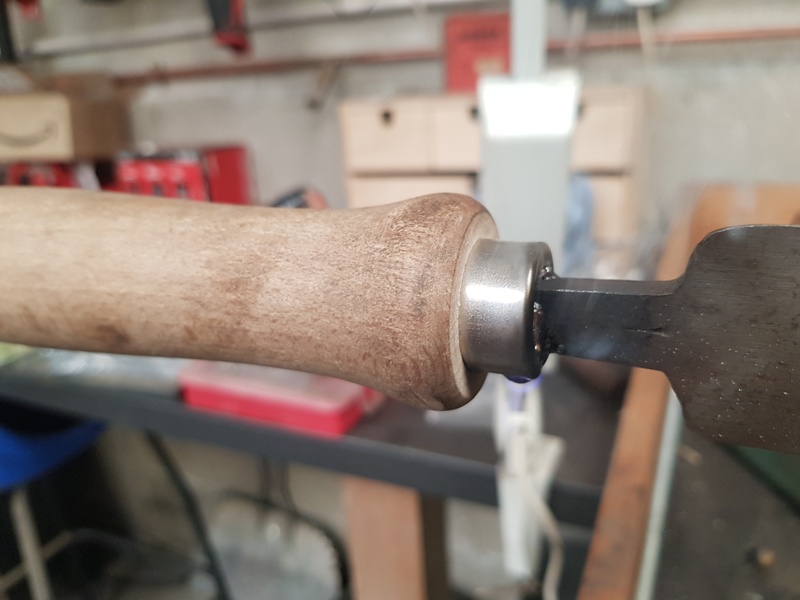

so heated the tang up with my propane torch, it didn't get to cherry red, just very hot

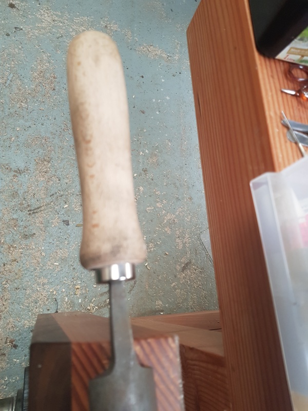

Handle on but I made a mistake and didn't have a BFH or mallet nearby and the workshop was filling up with fumes. You may be able to see a slight blue flame underneath the ferrule where molten sulphur is dripping onto the floor. So not quite far enough on, but it definitely won't come off.
It went much better with its sister file
Two down, about 40 to go. This may take a while as I need to let the fumes dissipate between sessions. I'm working from home this week and normally on line meetings finish a few minutes early, so it only take a a couple of minutes to drill and fill the handle, heat it up, shove it on, introduce it to BFH then run out so I'm slowly working through them, about one an hour
