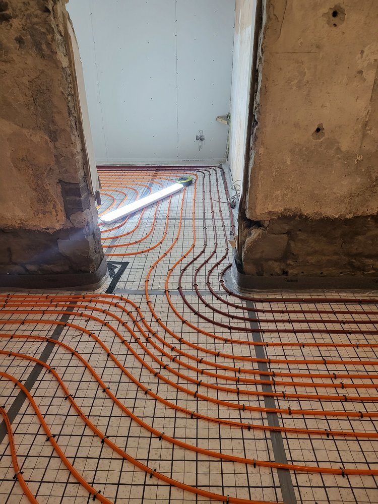

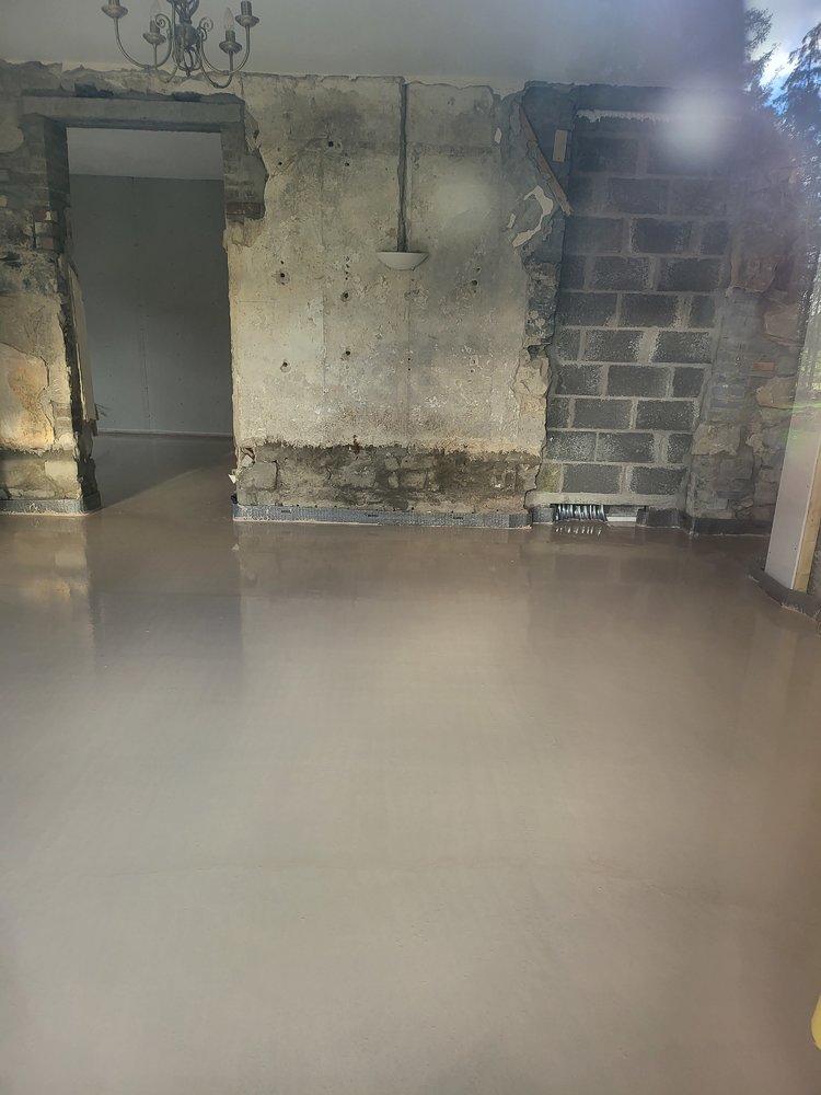

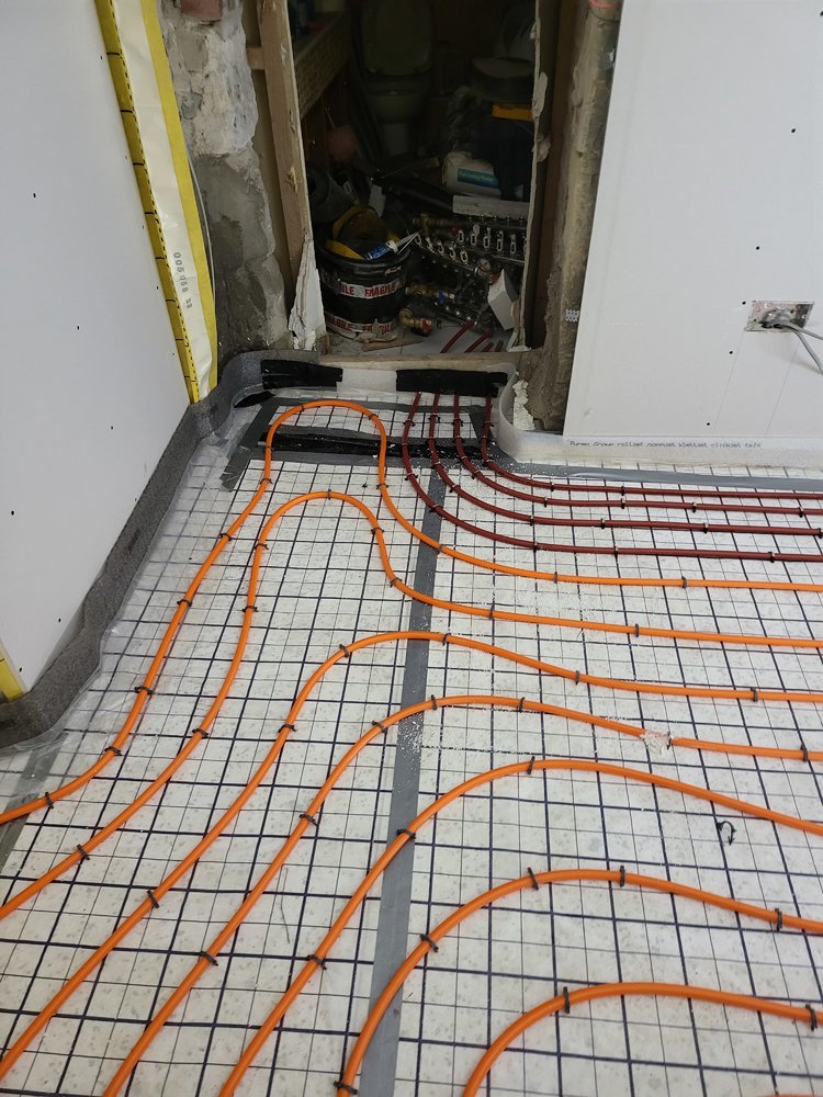

So if you wanted to. you could remove doors and skirtings lay GSHP heating pipes on a non insulated floor , pump in 60mm covering then fit new skirting and cut the tops & bottoms of the doors to get them to fit the slightkly smaller frames instead of having to chop out the floors and put in a deep thermal floor .
Perhaps even being able to do the same on broken screeded floors , "Like wot we ave ere ". or pop & remove the screed and do the same .
