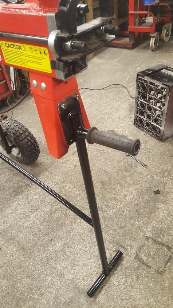

That's worthy of

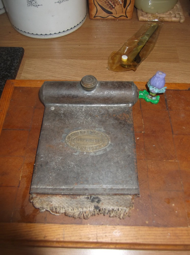

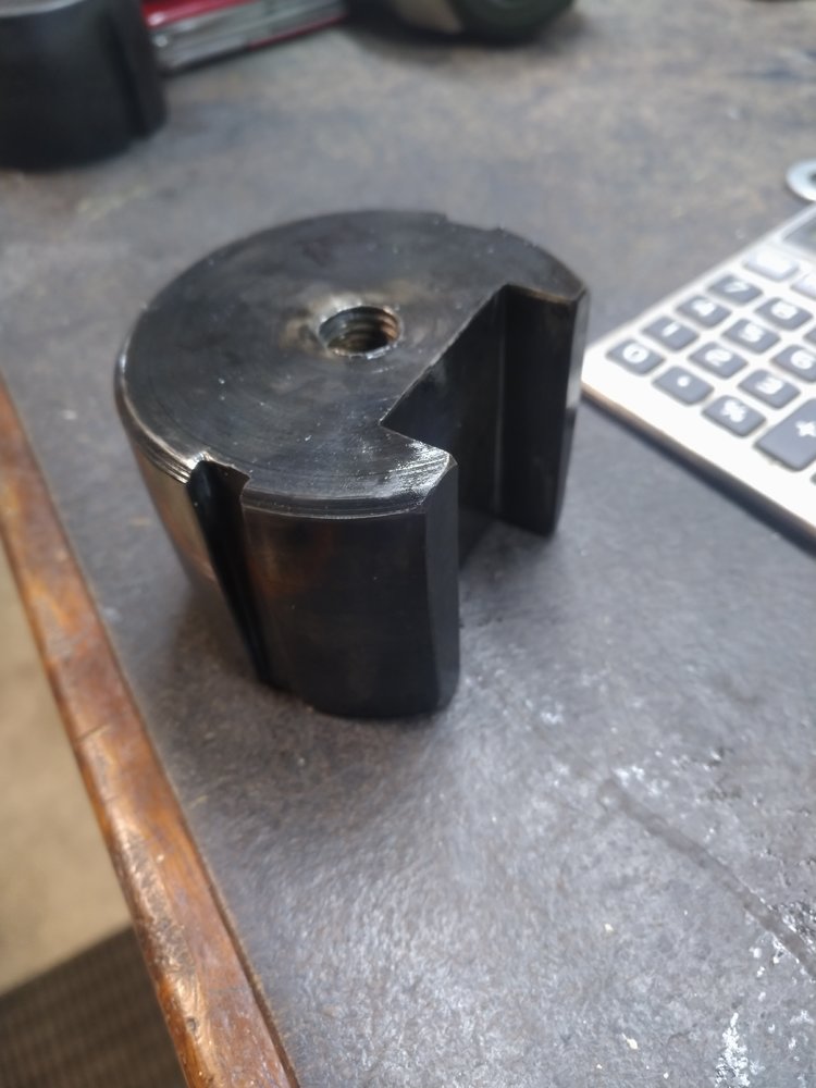

I've seen those before but can't think where or when... something to do with a gullco carriage perhaps?
No. its a foot?I've seen those before but can't think where or when... something to do with a gullco carriage perhaps?
