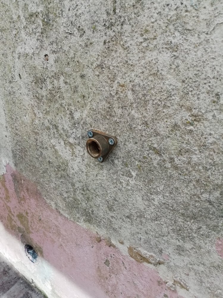

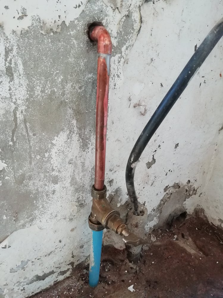

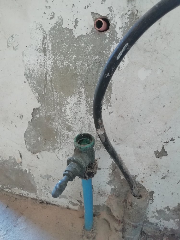

I doesnt matter how many outside taps you have they never seem to be in the right place or the hose just not long enough, so todays quickie was to stick an outside tap on this unused main in one of the outbuildings except the size of the thread was like nothing I had in stock, luckily I had an alkathene to 15mm copper stop tap and pipe inserts left over from my house bashing days, a bit of copper and a nice flush backplate, just got to find a bib tap now...
