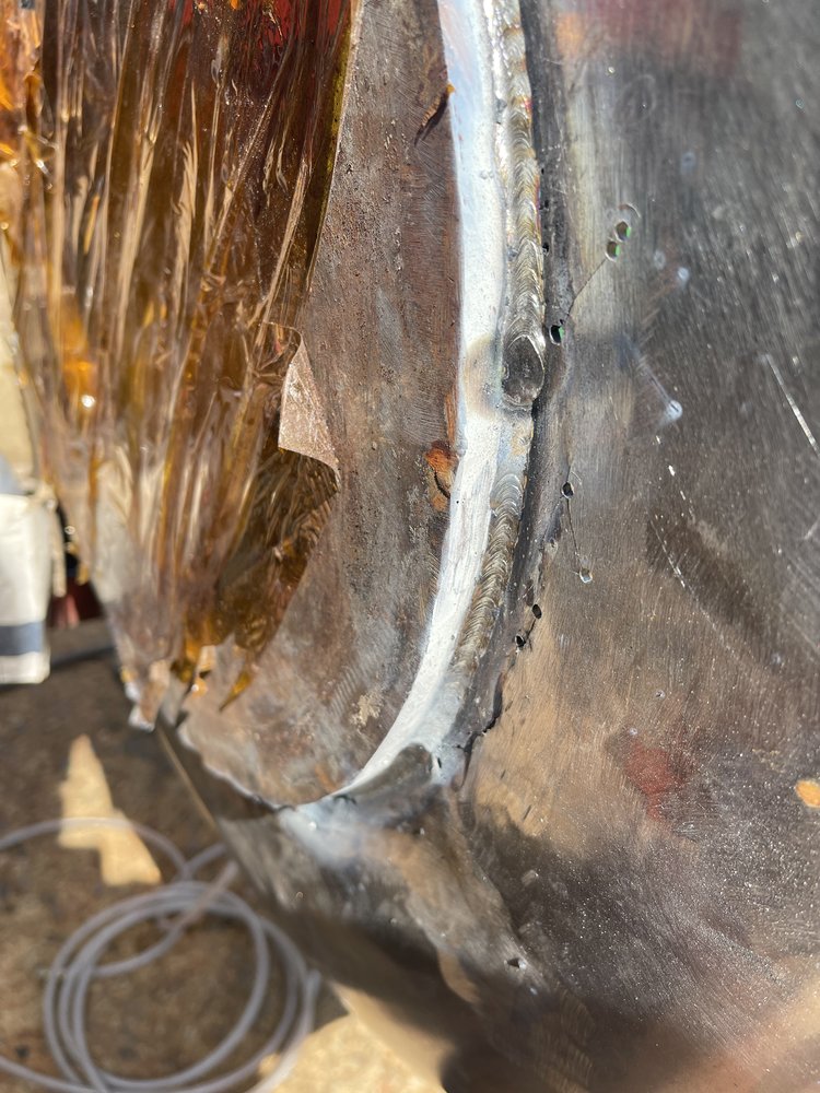

What is it ?Full of porosity. But more grinding to do with a 2.8mm disc.
Tomorrow morning I will dog the round disc back down, create a purge dam inside and weld the disc with a few 3.2mm stainless rods. This much dirt and crap you're never going to TIG weld it.
Then I'll attack the cracks
View attachment 346776 View attachment 346777 View attachment 346778 View attachment 346779 View attachment 346780
Dough Mixer Bowl. A big one. Believe it or not this is actually fairly small.What is it ?
I think we are almost back to the original weld now.
View attachment 346787 View attachment 346788 View attachment 346789
Replacement would be north of £1200 last time I looked, if they're available. These are 30+ year old mixers (aka the best).Is that bakery run by a half scot half Yorkshire with his wallet clamped at 50 ton , Whats the cost of repair like compared to replacement?
Most of the time they're not available so it's used bowls you have to buy. Still north of £500.
Repair. I don't know we are at 2.5 hours of grinding, drill, grind a bit more, jet wash a bit more crap out. That's £110 so far. They probably gonna be the wrong side of £300 by the time we finish
