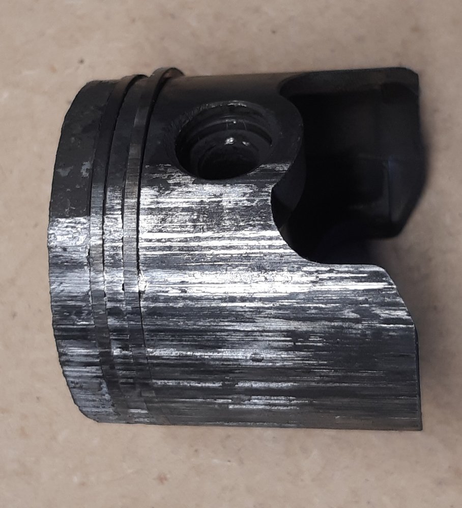

Probably best described as "slightly worn".How's the cylinder, no better I'd imagine.
That's what mine looked like after I lent it to a neighbour and he ran it on neat unleaded, he'd never heard of a two-stroke engine before.Maybe in hindsight I should have actually measured the amount of 2 stroke oil in the strimmer and not just "Slopped a bit in"

Your neighbour is an anus, a chocolate starfish.That's what mine looked like after I lent it to a neighbour and he ran it on neat unleaded, he'd never heard of a two-stroke engine before.

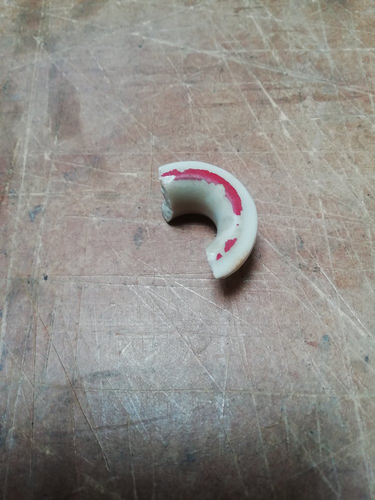

Keep it in the stuff I don't mind lending out box, and let someone else find out how good your fix is.I gave it a good bevel so some decent material there although I'm expecting it to snap and get smacked in the face by the breaker bar
Get an impact 6 point socket, they are stronger, so hopefully grinding some off will be OKYou replied too late. I tried it and it twisted and thankfully didn't break. In the bin it goes! I ideally need a deep, thin walled, 3/4 inch drive, 30mm socket. They exist but are expensive... Think I'll just get a non thin wall and grind it down.
I used to repair these things, and saw this very often. Biggest cause is leaving the fuel in the tank. Should always empty the tank back into your can after use, then start the thing and run it dry. A few days is OK, but you certainly must do this before a lay up.Maybe in hindsight I should have actually measured the amount of 2 stroke oil in the strimmer and not just "Slopped a bit in"

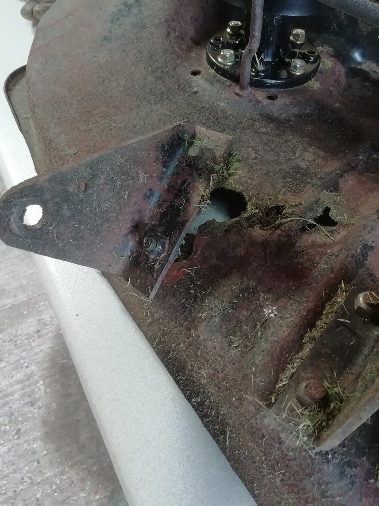

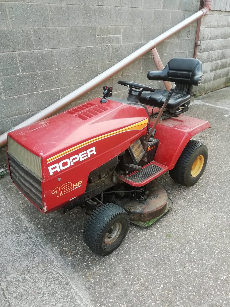

You got your moneys worth out of that one..Gutted!! pulled this out of a metal skip about 4 years ago, weve run it since and boy has it worked hard but we have a failure today! a support bracket has pulled off the cutting deck and there also appears to be more holes, looks like im going to be weldering now the weathers warmed up!
View attachment 403019View attachment 403020
View attachment 403021View attachment 403022
If the repairs are tidy I might even post them up!
It’s not dead yet it'll go again!You got your moneys worth out of that one..

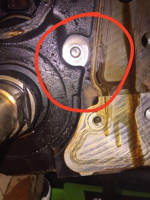

View attachment 411768View attachment 411769the bolt for the timing chain guide rail snapped, now i cant it out.
Left hand drill bit, left hand m5 tap, you’ll get it out leaving the thread intact.View attachment 411768View attachment 411769the bolt for the timing chain guide rail snapped, now i cant it out.
