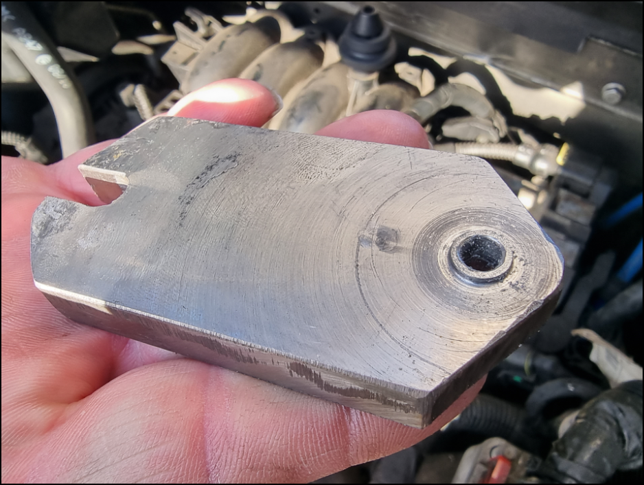

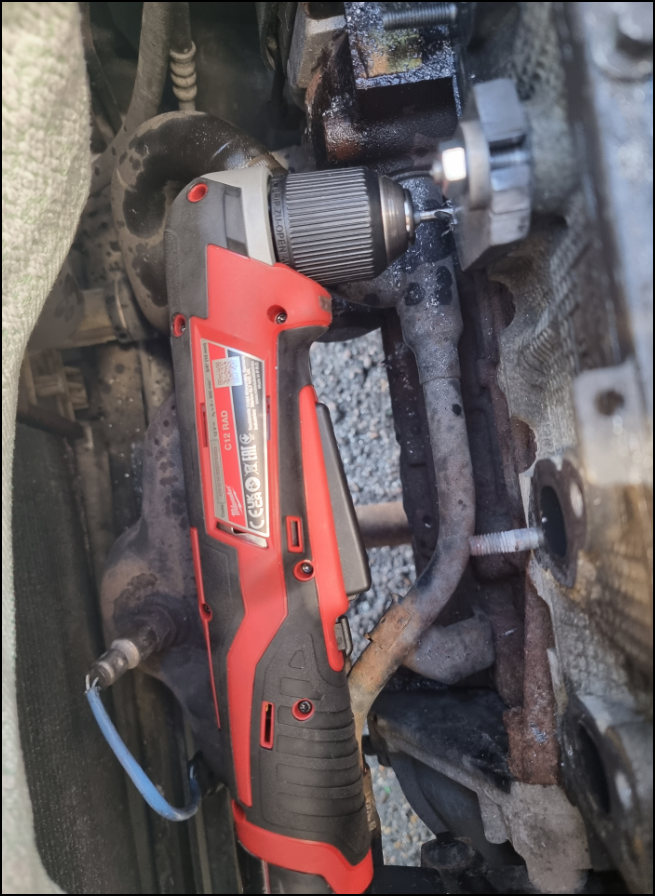

The reason? Four snapped manifold studs on my granddaughter's Fiat 500. Didn't want to take out the radiator and air con rad so the only way was to drill them in the space I had.
So I first made a drilling guide by drilling some thick gauge plate then facing it off to leave a locating stub which located in the shallow counter-bore they put on the hole for the studs (which I was VERY grateful for)
This drilling guide, and the angle drill allowed me to do this:

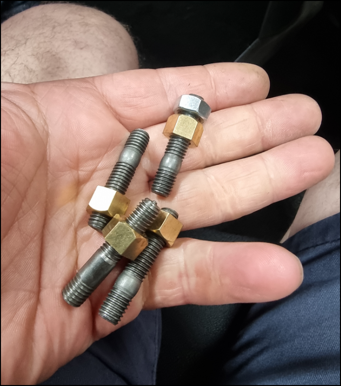

And fit these:
And fit these:
