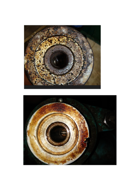

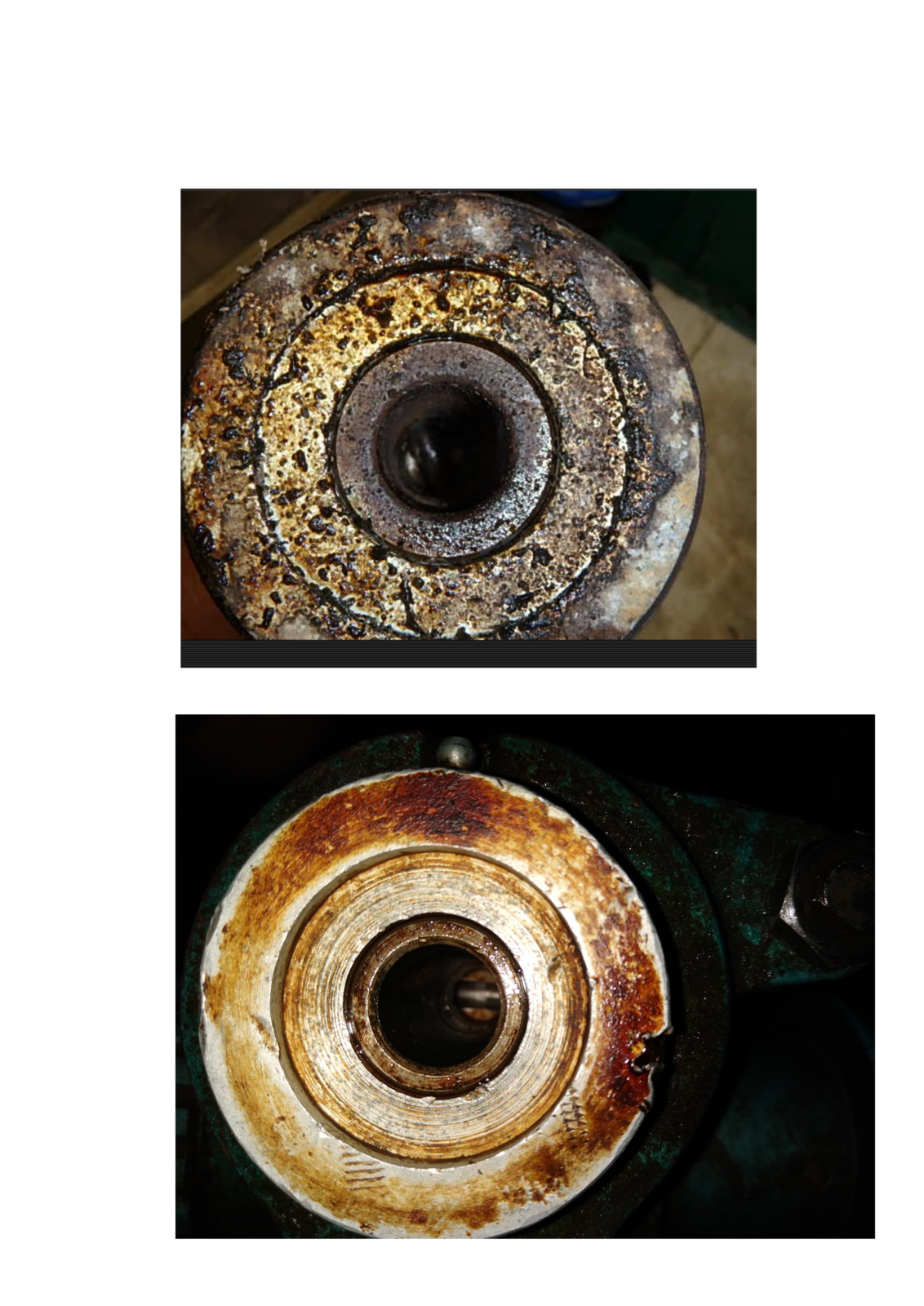

MMM yes unfortunately it does...Oh well cant win en all... lolThat top pic looks remarkably similar to mine (with regards to the 3 distinct sections)

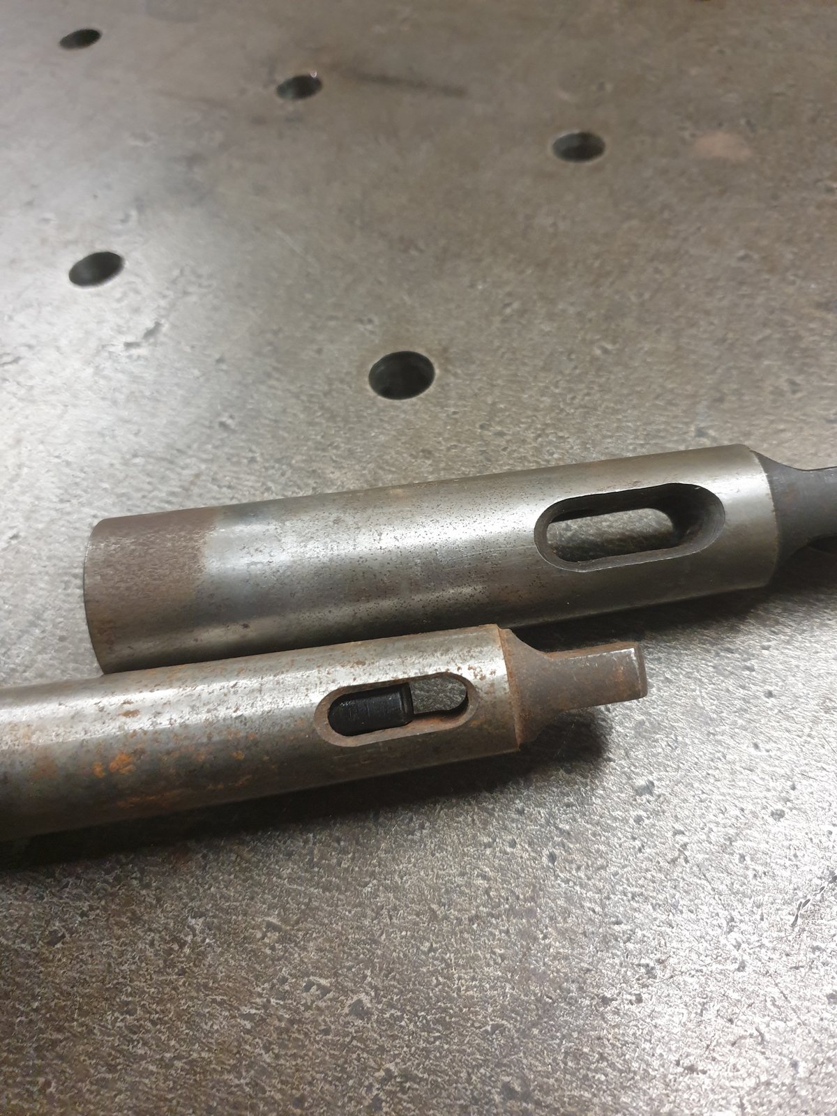

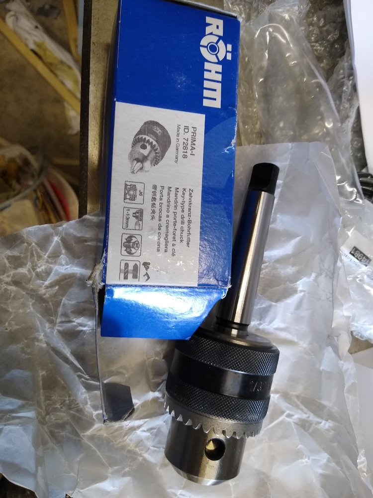

what size is your quill Cheb?The quill, sizing, and what the cover looks like.

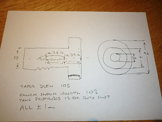

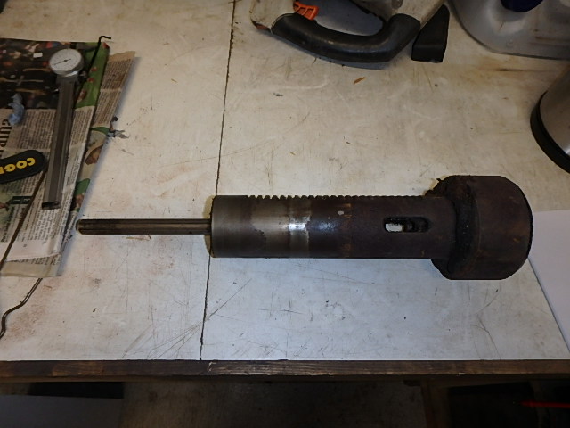

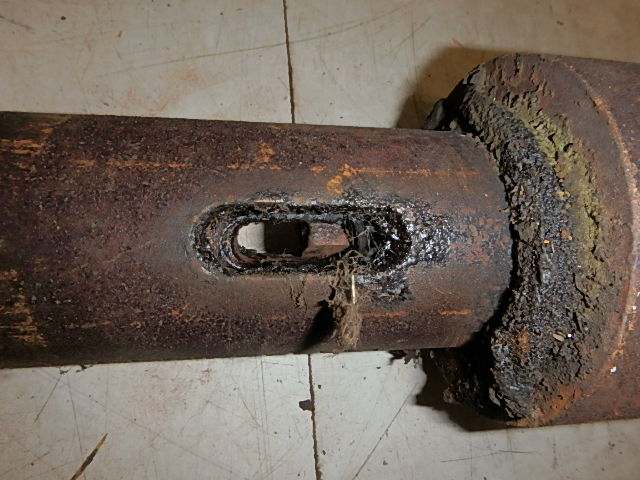

Yours looks like it's got a smaller standard taper than the OP. So being brave and stupid I am still wondering if the OP has a 3 MT machine at best and a cut 3 Morse taper stuck in it. That said he has pushed something up and it's not got an accute change/stop.That's my TD teacher spinning in his grave. The rough notes were even worse. The second photo is the with chuck shank inserted.
