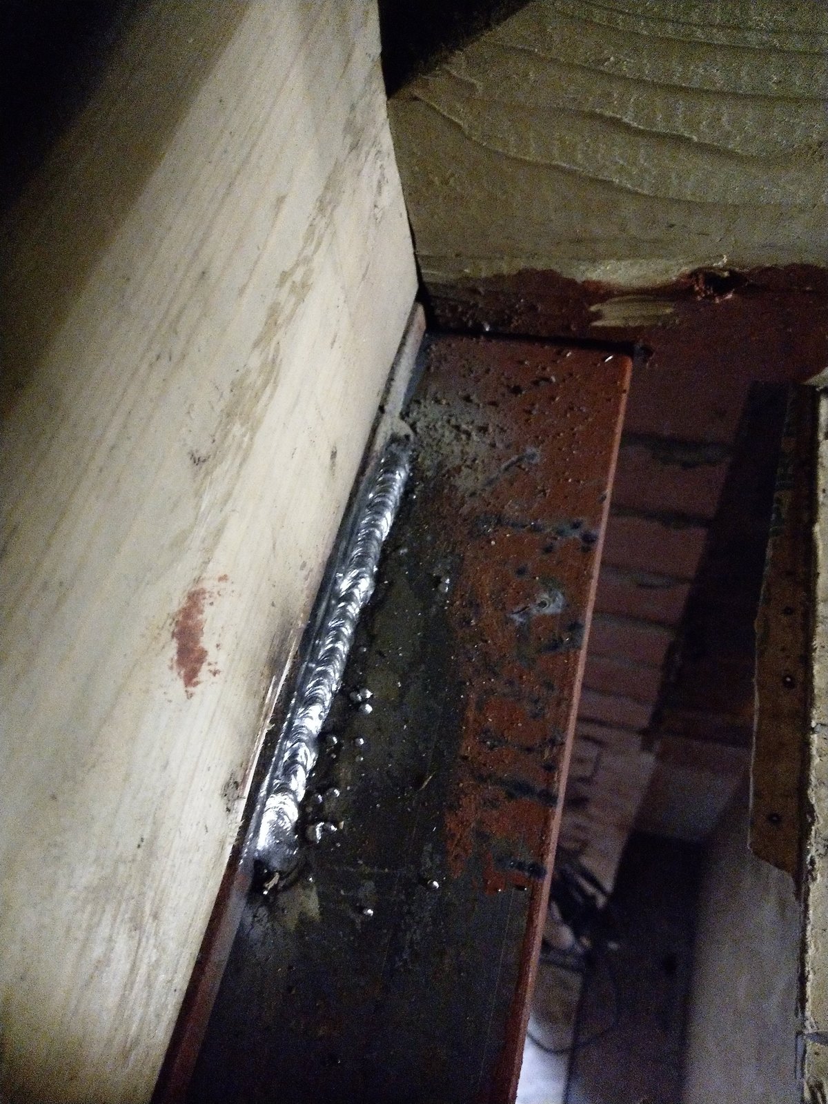

^^^^^ shouldhave you rund when i welded a mower deak the metal was so thin as soon as i put the welder to it it melted ended up like pigen poop after i had to fill the holes

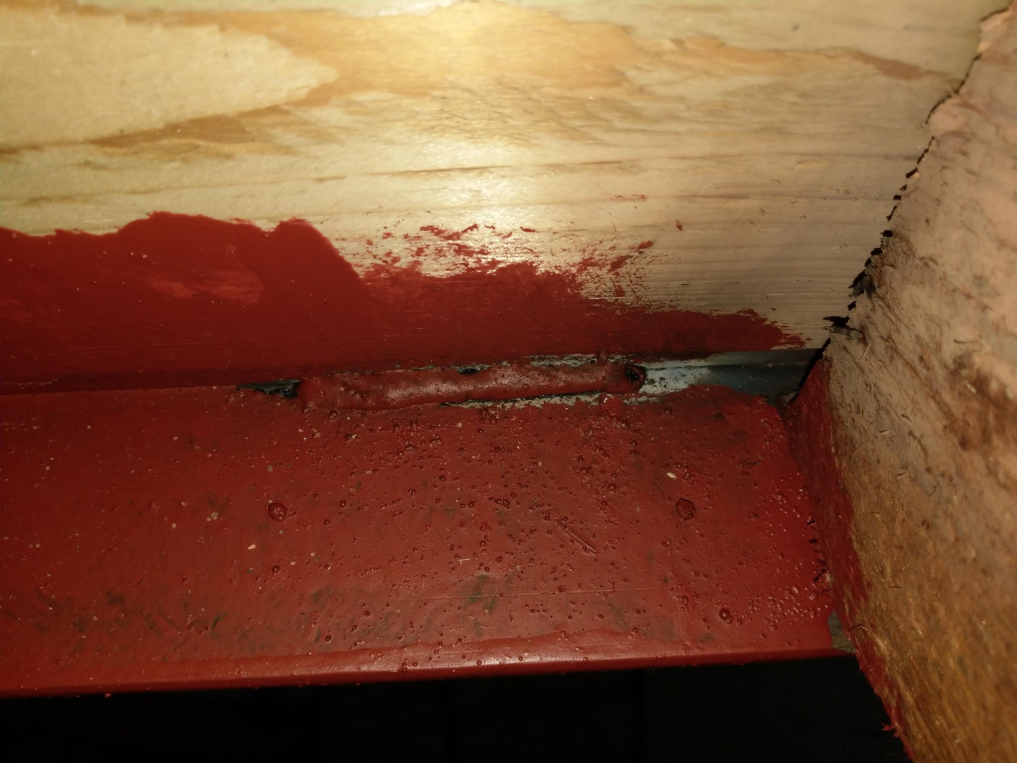

I think a child with a £60 aldi welder could have done better

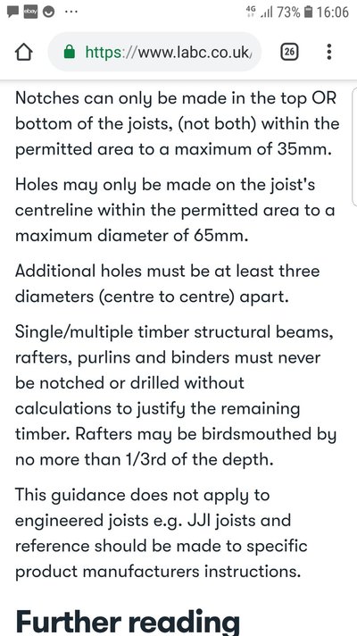

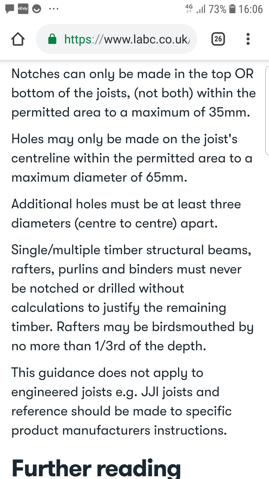

Wouldn't be too happy with those notches at the bottom of the joist either.

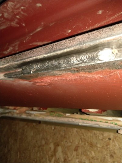

That little Lorch has some power!
