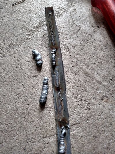

I just bought one. Totally useless, zero penetration, the weld just sitting on the top of the metal, it fall of.230 quid. Please review it mate.
This is just an example, I tried different metals, sanded before. Yes earth clamp, funny.Try cleaning the metal, and attaching the earth clamp to it...!
Odd, my static arc 140 mig works perfect, thick or thin material, Flux core or gas. You have set the polarity correctly for the wire type you are using?I just got a replacement from the supplier and..... kinda working. It is definitly not a quality stuff, working properly only over the 100A range, hard to use for smaller jobs.
