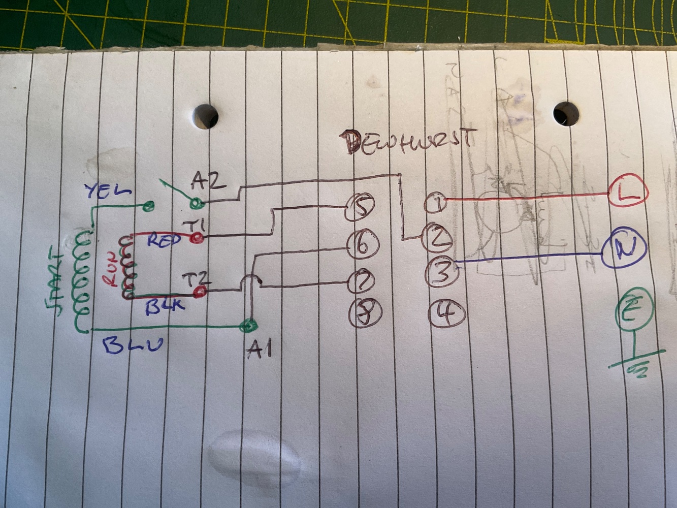

How about this:
Move the red motor lead to T1 and wire to Dewhurst as advised here: https://www.model-engineer.co.uk/forums/topic/crompton-motor-and-dewhurst-switch-problems/
I think you’re meant to include an on/off switch or contactor before the Dewhurst as it doesn’t like switching the load.
