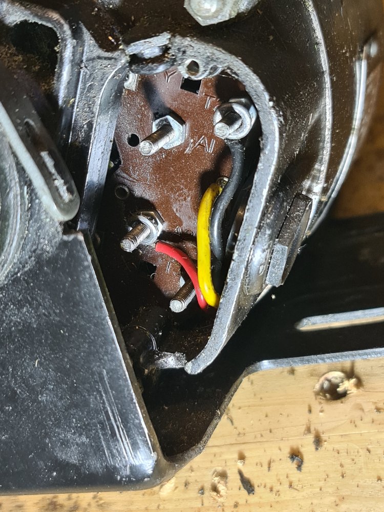

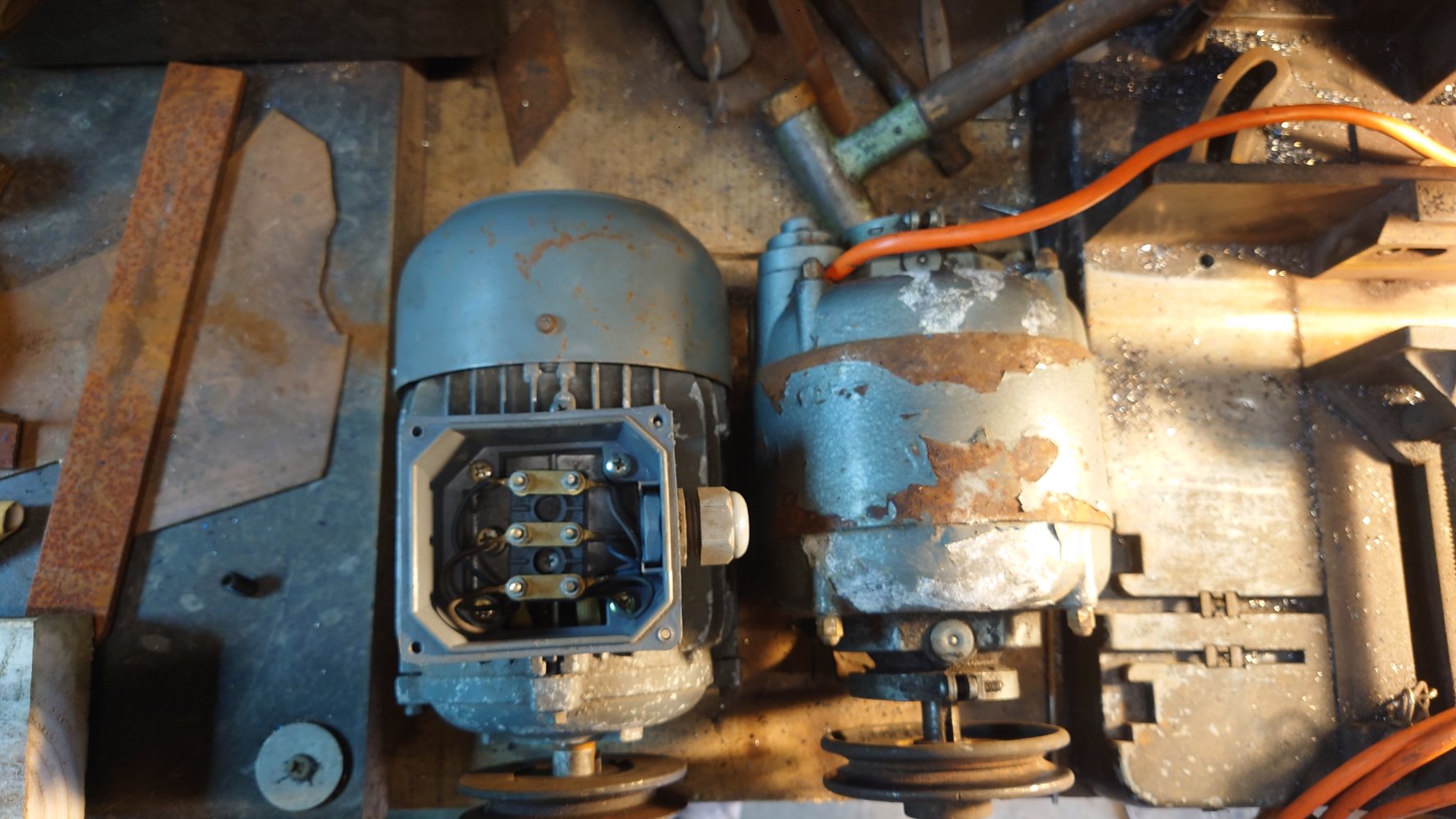

Looks like windings are shot
...but in one direction only! Weird? Idk normally I see motors that either work or they dont, but this one runs fine in one direction, but is slow and starts to smoke in the other direction. Any ideas how that can happen?

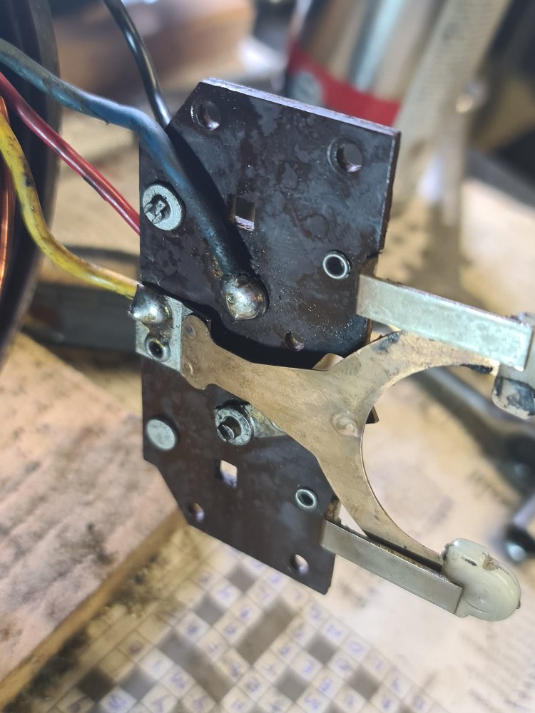

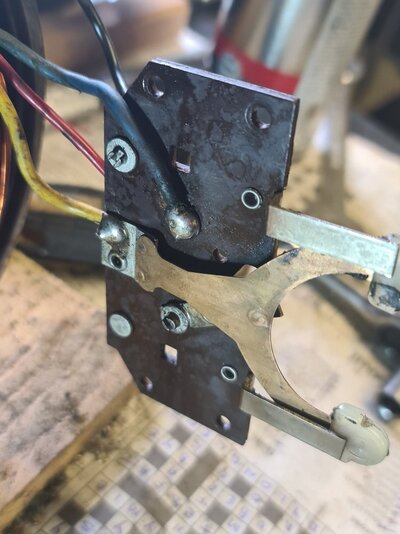

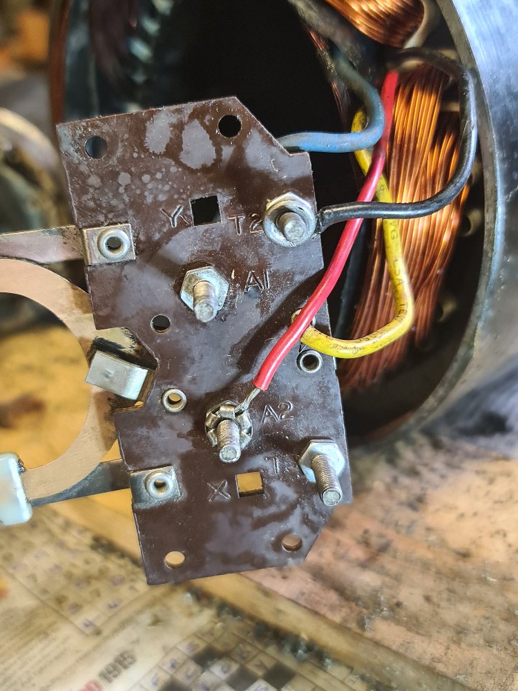

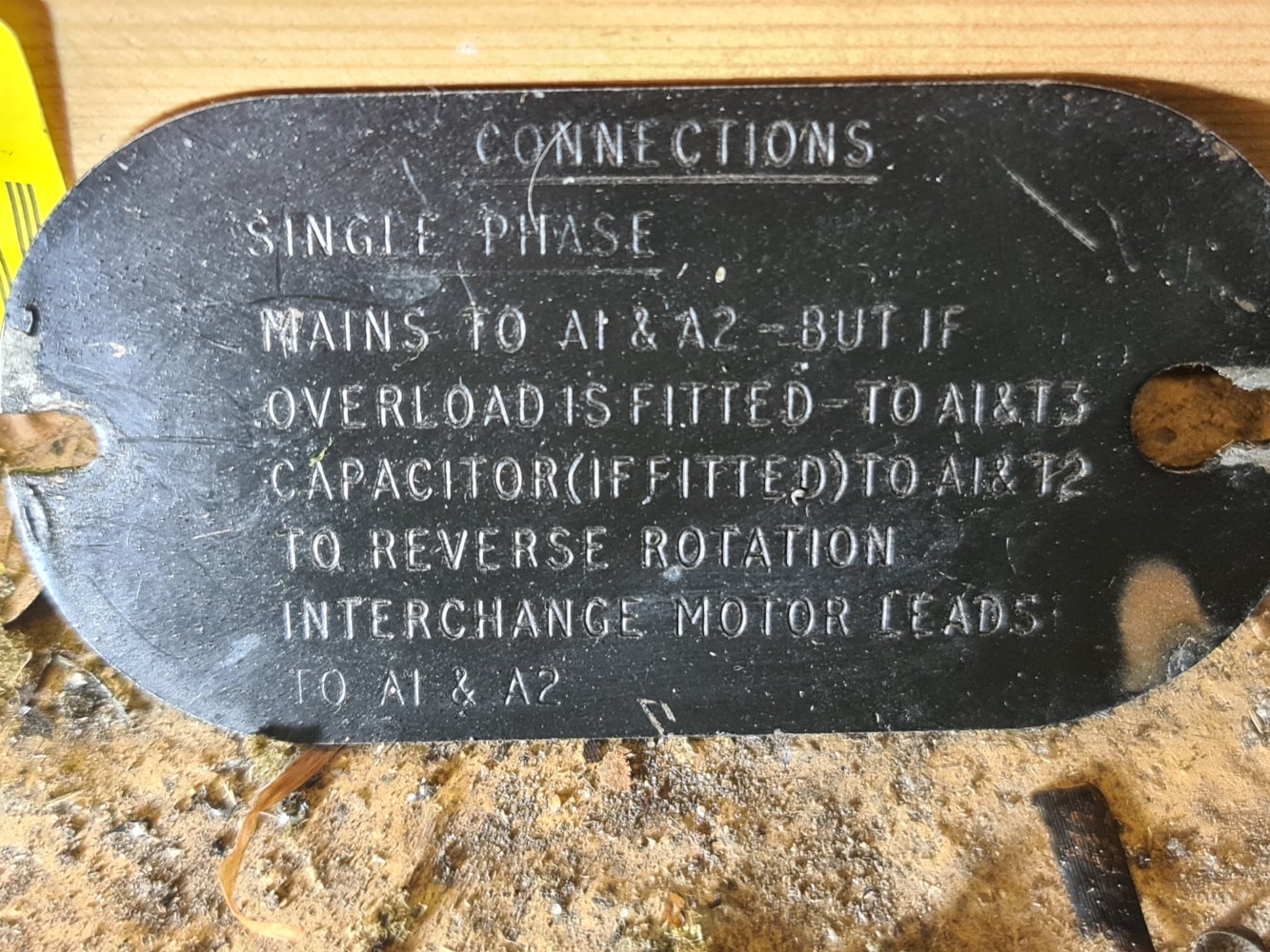

(It's single phase GEC motor, drum type switch, T2 from switch had been disconnected by previous owner (left floating inside box too). Resistances are ok A1 A2 T1 but A2 /T2 and T1/T2 are both OL)
Not even sure I need reverse on this, so could run as is - but is this winding break the start of something bigger?
