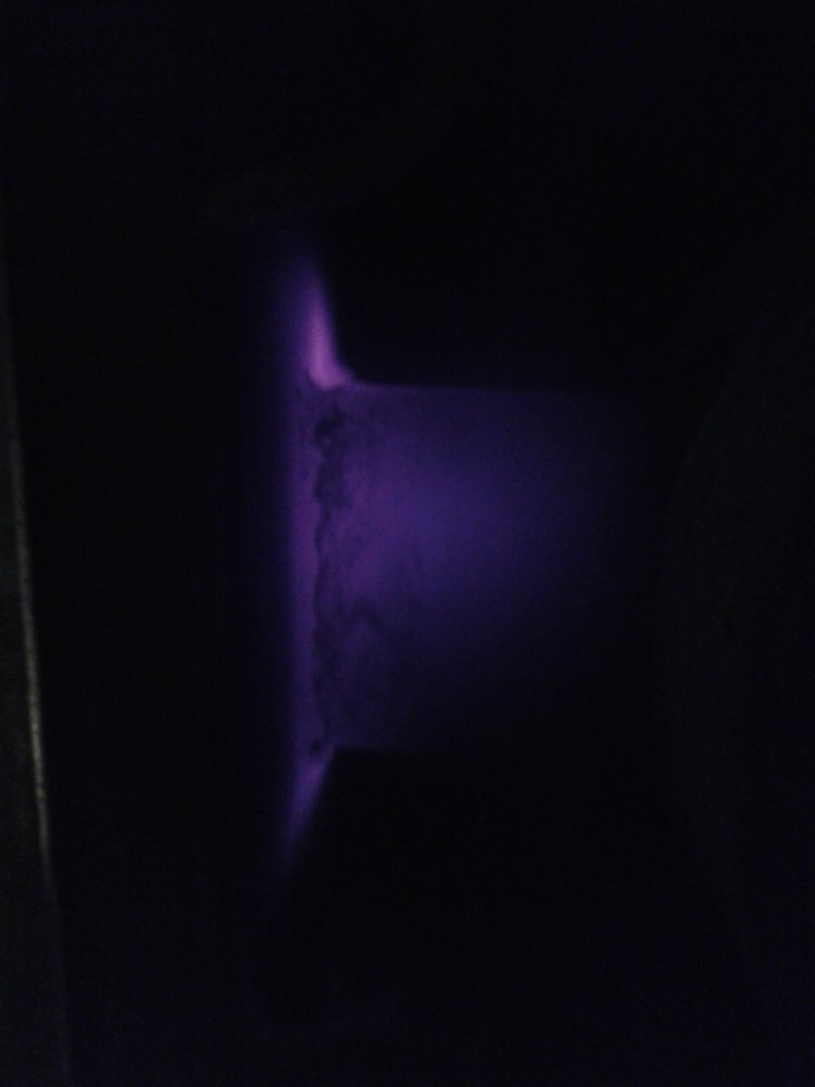

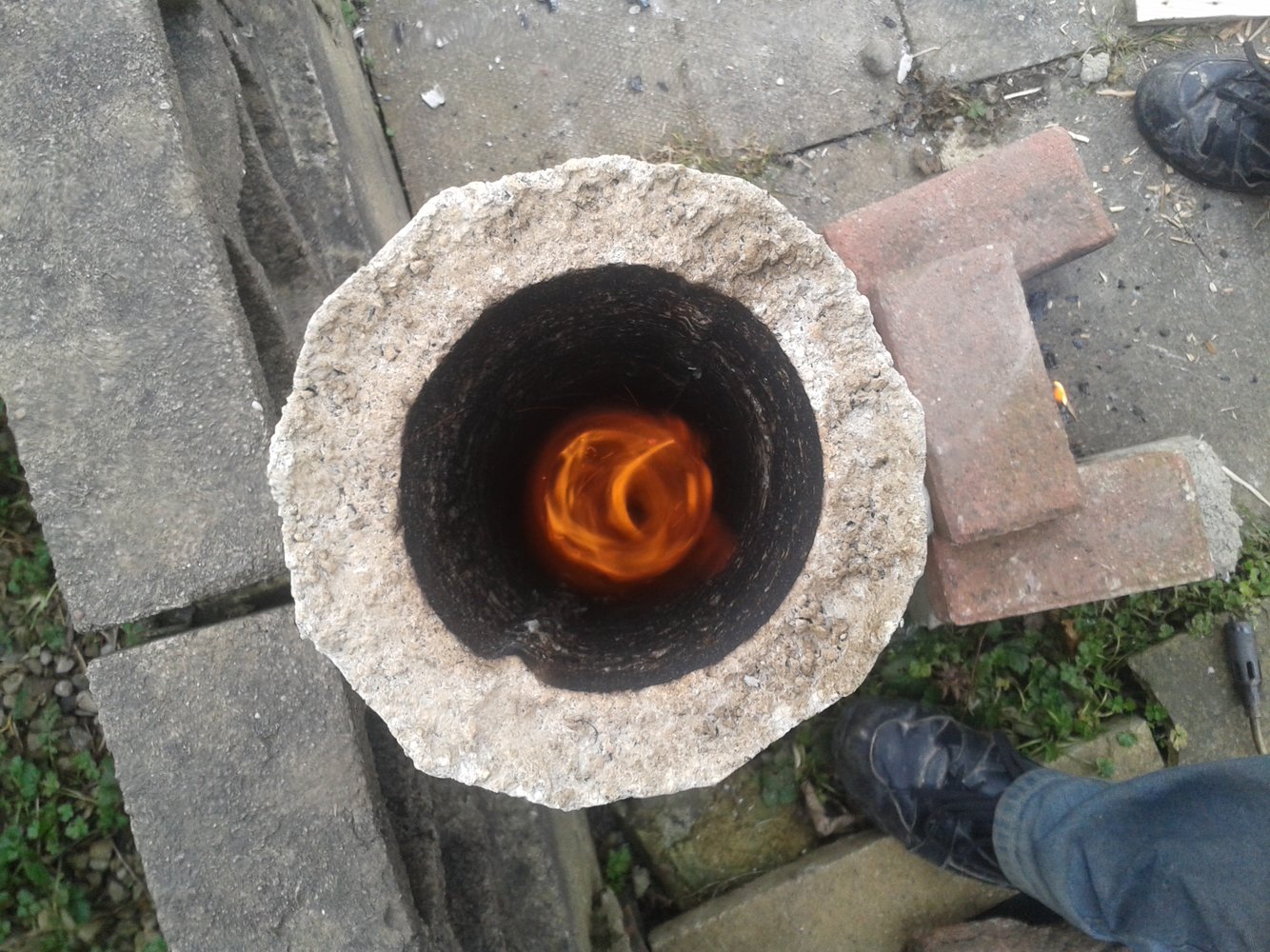

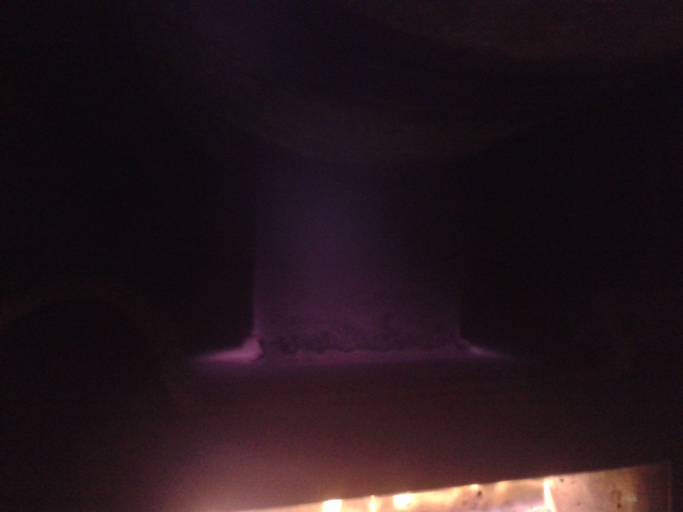

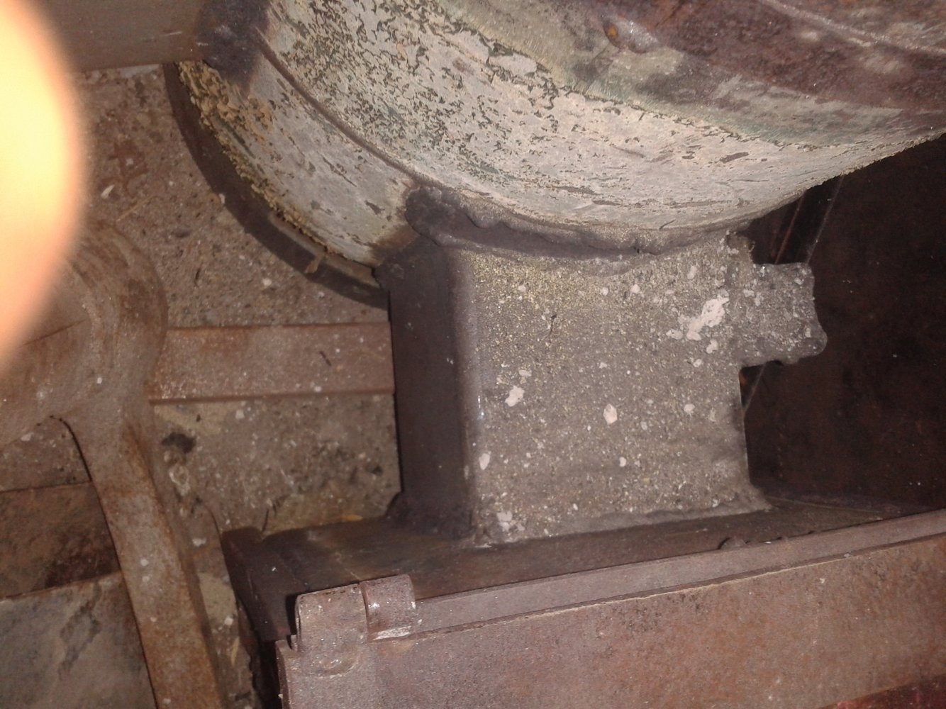

Think that's probably a yes then!put it this way what temp melts 304 stainless steel
as ive had mine glowing red and its 3mm thick stainless steel 120 x 120 x 3mm
this is at the throat entrance at the vortex entrance it will be higher they do burn at 1500f 2000f
View attachment 286145View attachment 286146View attachment 286148

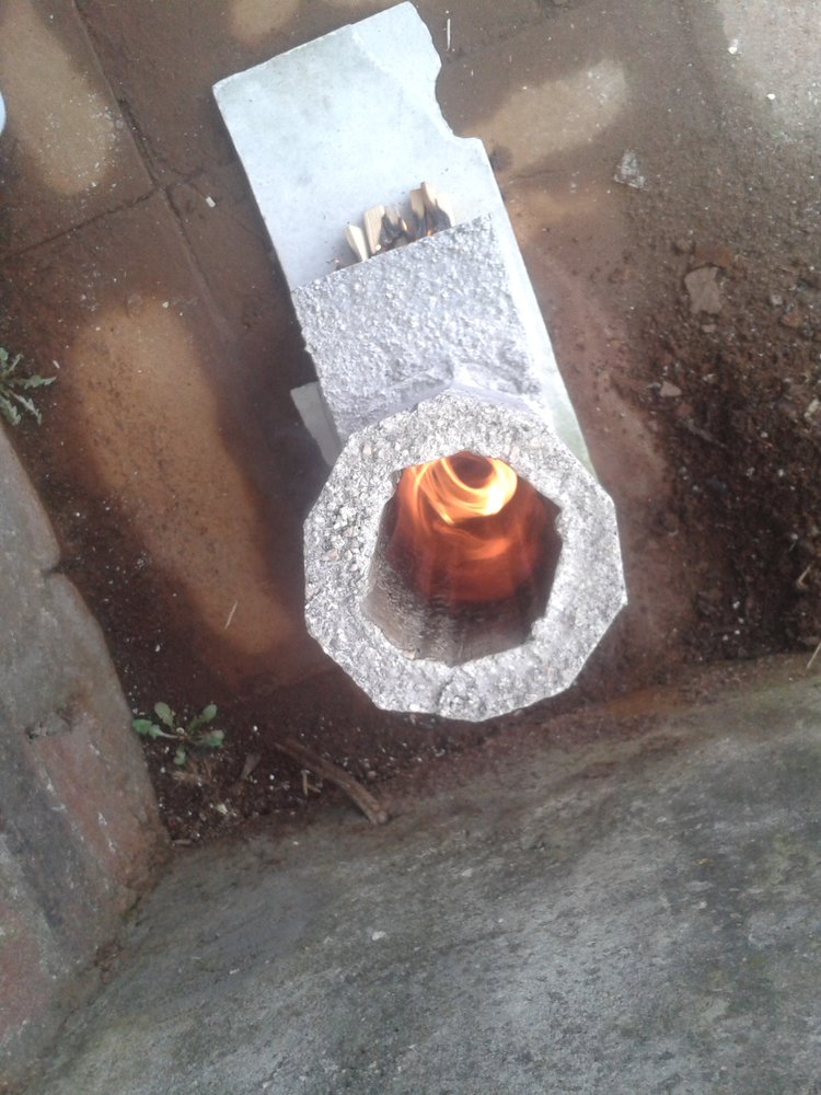

I had to change to a core build instead
I bought perlight and refractory cement to build it
View attachment 286150View attachment 286151

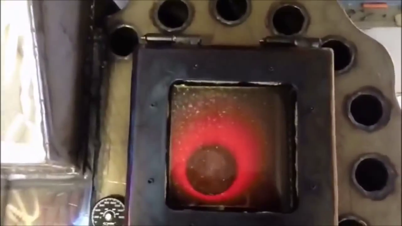

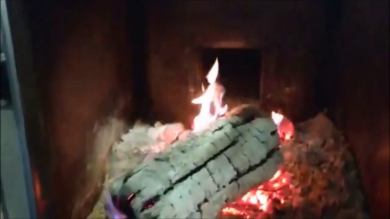

not mine but i have there vids

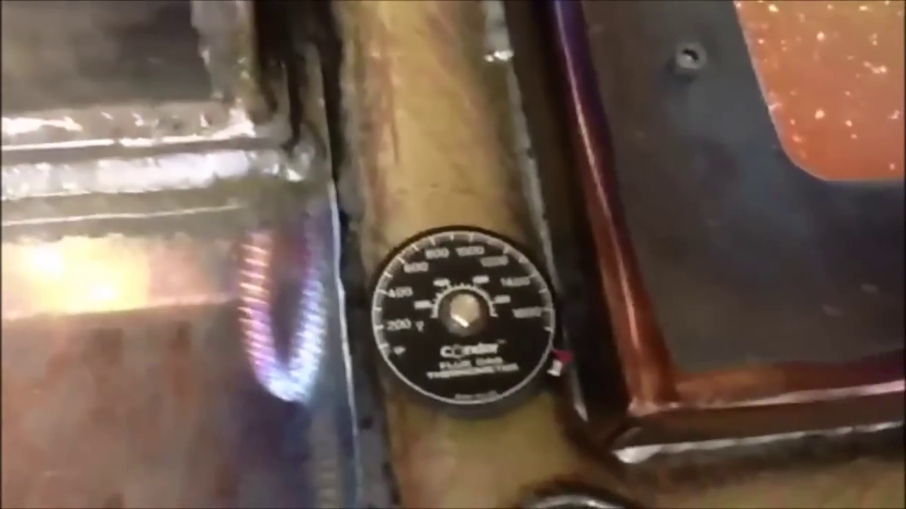

its external temps on thick stainless steel is recorded over 1800f so they do get hot
from one log
bottom right you can see the red indicator off the scale
I just made a hybrid from 2 stoves i likedThink that's probably a yes then!
