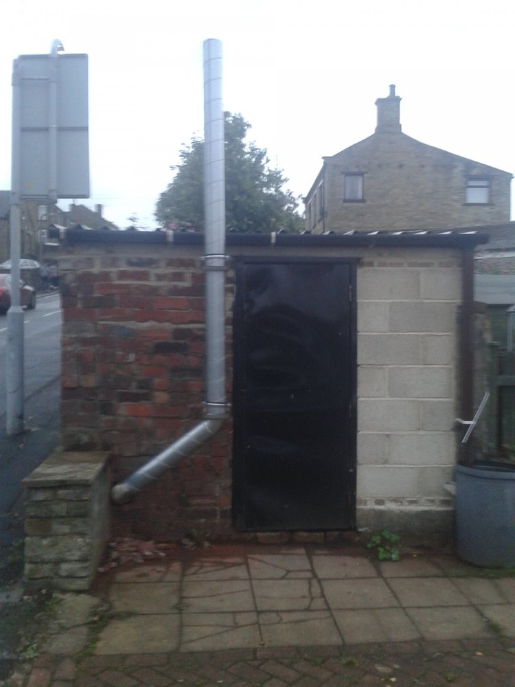

Coulda just been my shed roof he was talking about, it's much lower than 2 story houses which it is amongst with flu about 1m highI know the top of the flue has to be so much above the ridge to stop fumes going in the house but it’s not 3m! I’ll dig it out as I looked into all this for my wood burner here.

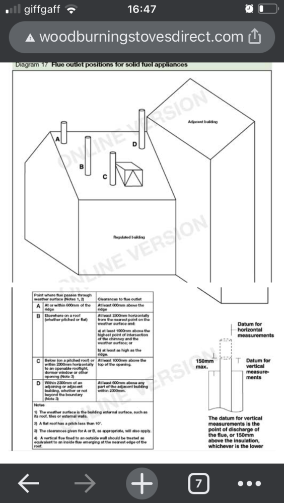

My flue is about 8 meters away from any house but maybe only 4 meters away from a council garage which has a higher peak than my flue. my flue is about 1meter above the flat shed roof that the woodburner is in.pay special interest to this quote
Does the proposed position of the stove mean that the flue will be within 2.3 metres of the house?
If the flue is less than 2.3 metres from your house the flue height will have to go the full height of the house until it reaches at least 600mmm beyond any point that is within 2.3 metres of the adjacent building.
the above quote also means other peoples houses as well so not advised to be ignorant with it thinking you can get away with it because its away from your house but near others
otherwise its 600mm above your roofs tip
as long as your flue is over the required amount you should have been fineIn over 5 years of me wood burning I have not had a complaint from any neighbour, in fact quite a few have given me wood to burn that they wanted rid of. Most upsetting thing for me is that someone reported without talking to me first.
silly quote but yes if someone has a bee in there bonnetIs the stink and smoke from barbecues covered by this legislation? Sorry @Parm
Yes as you say @gaz1 I think the flue would be ok even though the fella told me it should be 3 meters high.as long as your flue is over the required amount you should have been fine
