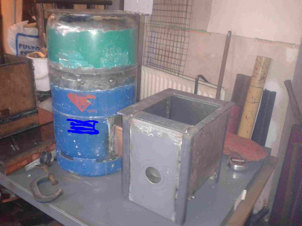

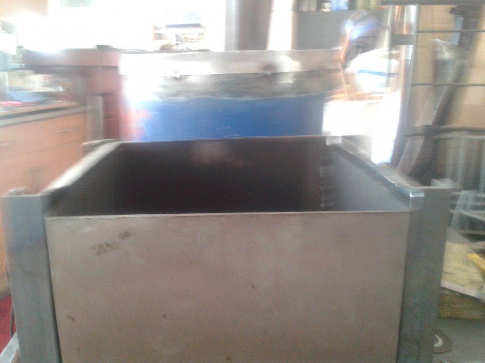

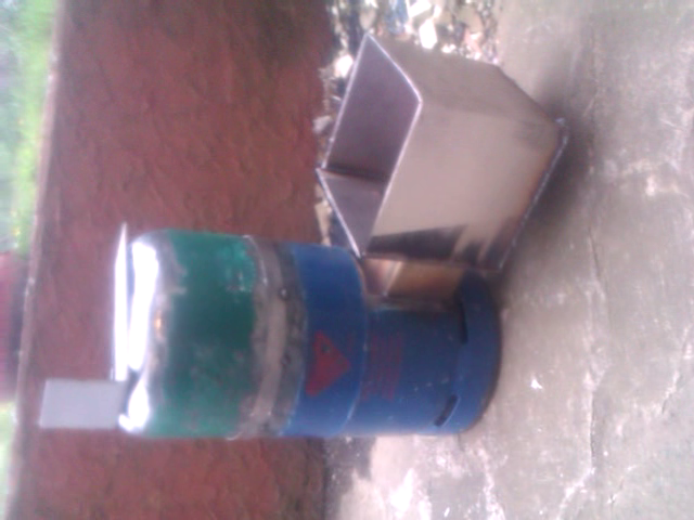

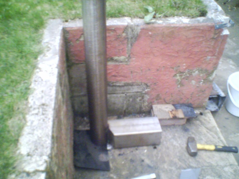

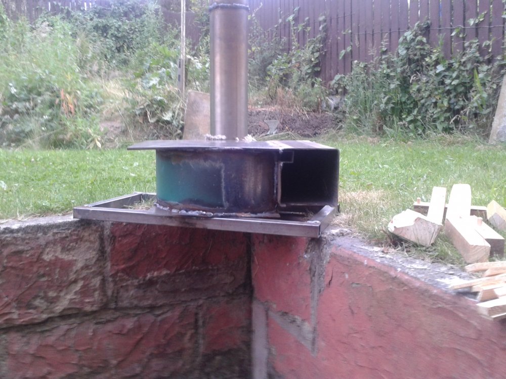

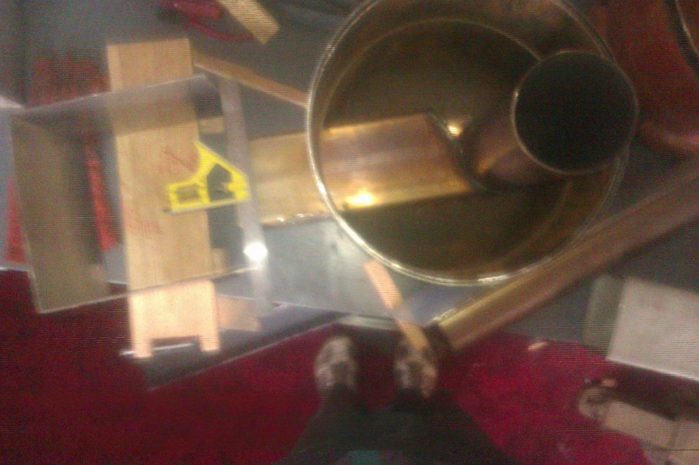

ive chosen the design i want to use and also the heat output of the system
a simple build which will also be dual fuel logs and also sawdust combining 2 different builds with output of 800 degrees F
im using stainless steel 120x120mm 3mm 304 box and 100mm 2mm 304 round pipe for the internal burn sections ive looked at the wire needed for the mig 308Lsi is easy enough to get but 309 is proving to be much harder to aquire rods i can aquire for arc welder
im wanting to change from stainless steel to mild steel for the door seal and also to fasten the door onto the frame as the frame will be welded to the gas bottle
