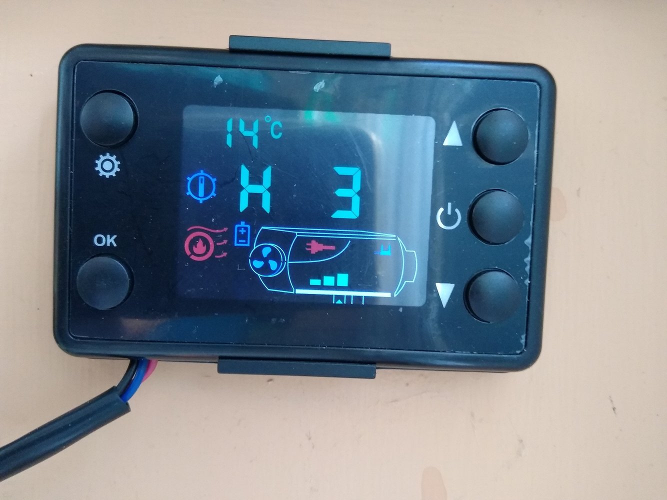

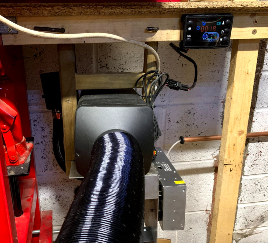

No, Tom, the minimum may well be too much when it gets up to temp - my workshop is very well insulated. I most certainly don’t need 5kW, to warm my workshop quite quickly.
It appears that the current minimum fuel setting is somewhat in excess of the advertised value. I need to see if the controller can be turned down to its specified value (it is presently as much as 45% in excess of its advertised minimum - if the pump is the standard 22ml/1000 strokes).
