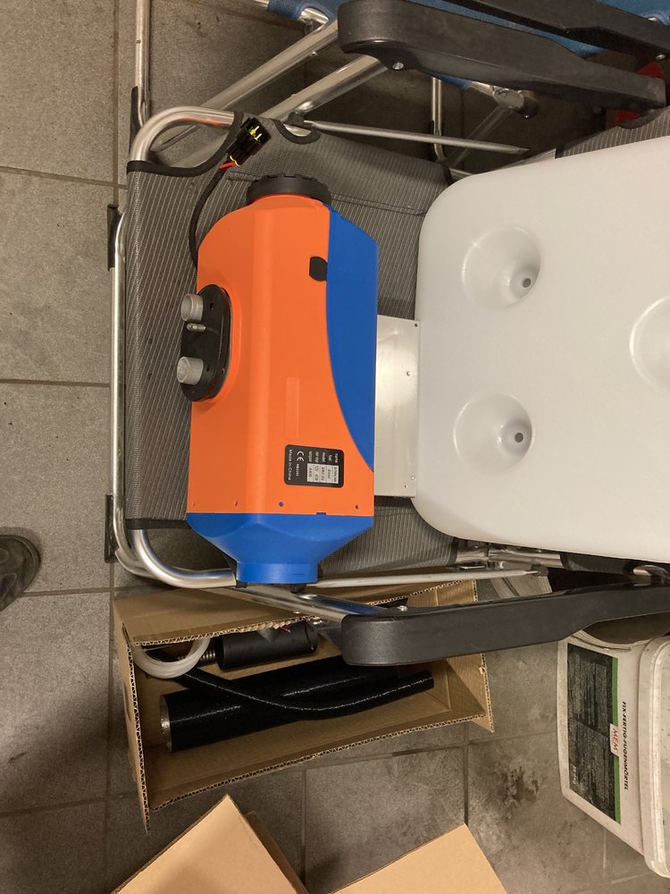

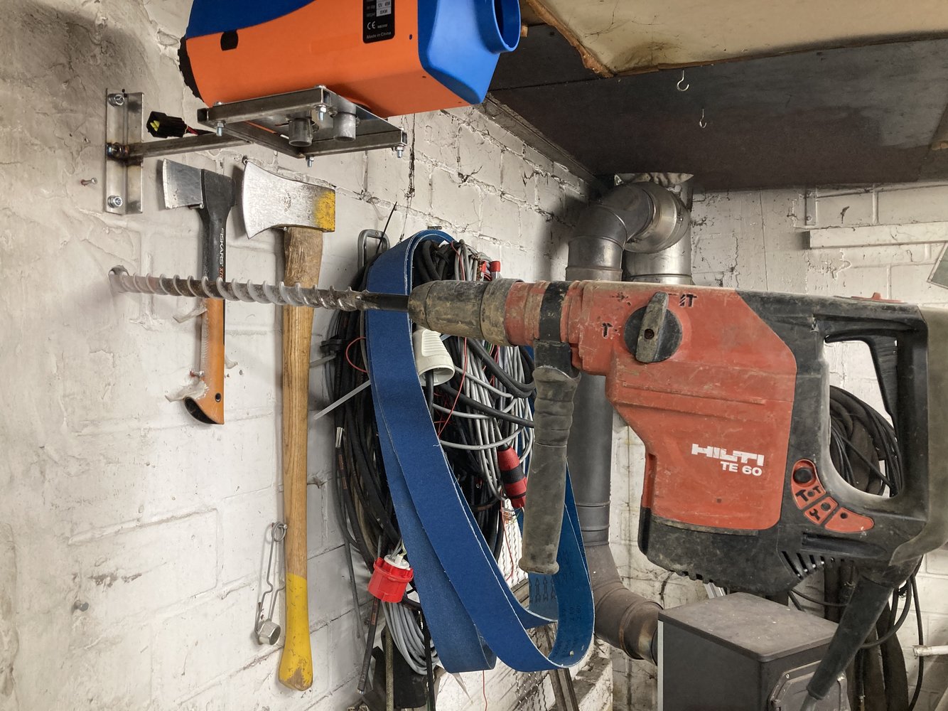

At first I thought you'd mounted it vertically and was going to respond with a "Ummmm.... will that work?".This is what I got today.
Because I got about 2000Liters of diesel (or kerosene don’t know what the heating stuff called in English) and using nearly nothing I will feed it into this unit. I change over to woodchips for my prison..
Exited to feel the difference in my garage but as usual it will generally took some months to install such things. But maybe….

But if the air recirculates and gets hotter every time it goes round , you may be surprised at how well it works ,,, unless all the heat leaks out of courseI‘ve got mine running. Still bits to sort out, but content that it does what it says - even if the heat output is not as claimed in the advertising hype.
