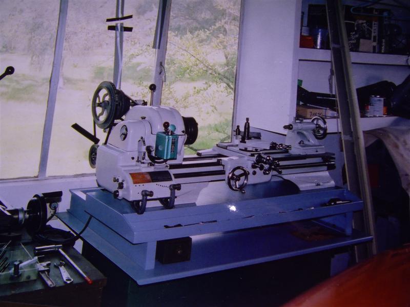

Here is a photo of a 6" Atlas lathe I restored. Took it apart, every nut, bolt and gear etc. Two weeks later I painted the individual parts and put it all back together. For a table to mount it on, I welded a 4" channel (as a tool tray) to a 12" channel and boxed it in.

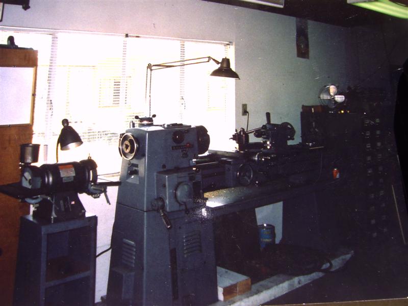

Note: The cracked window behind the lathe was not due to operator error, but by a "flying feral cat". I was chasing the cat out of the garage when it jumped up onto my 14" x 48" Clausing and tripped the on lever. A split second later the cat was hurled across the garage by the chuck and into the window; was one of the funniest things I've ever seen, lol. Needless to say the cat never came back to crap in the garage again. Here's a photo of the Clausing also, sorry about the picture quality. View attachment 88948 View attachment 88949

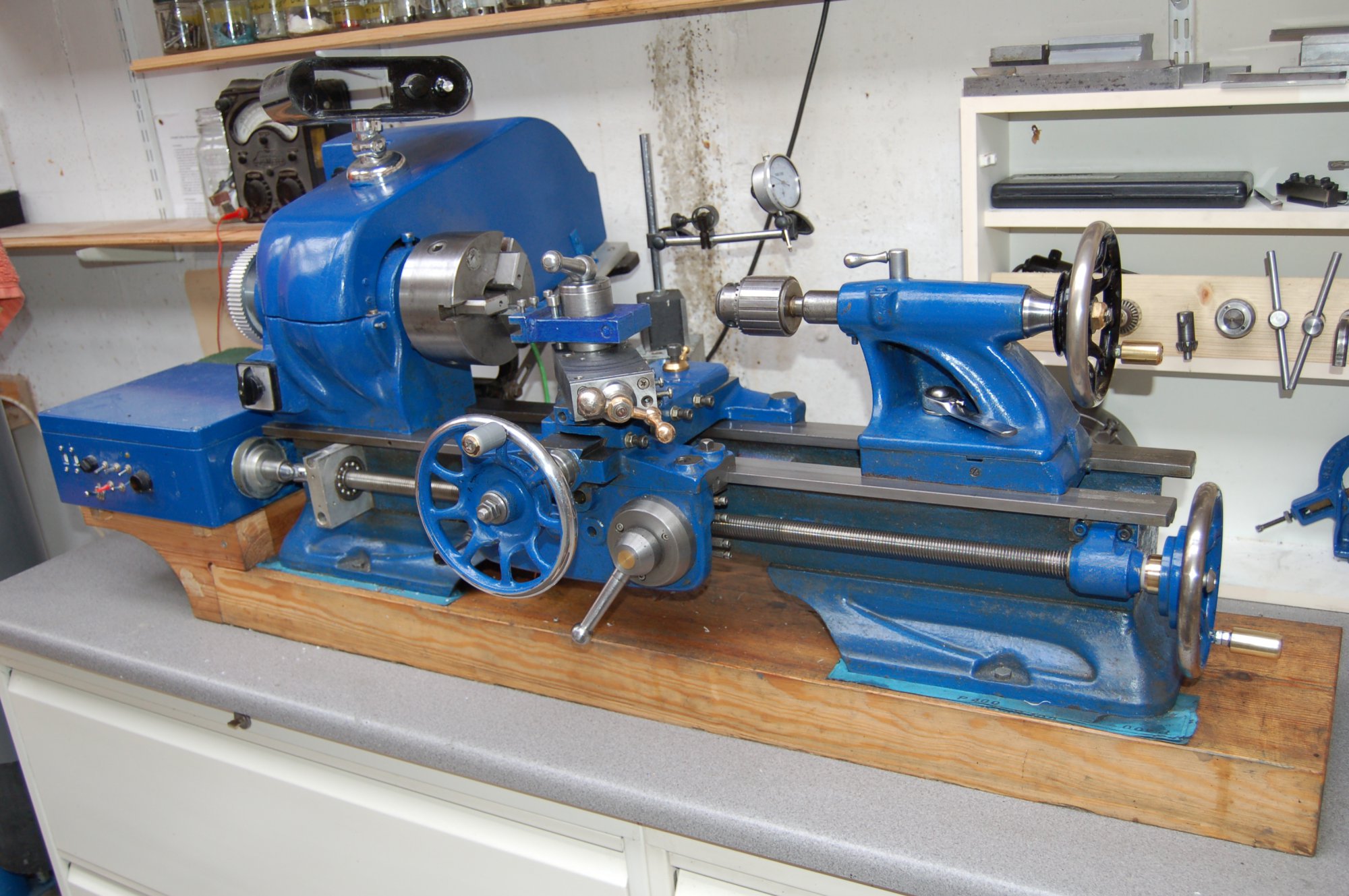

That is a nice looking lathe... you were lucky to have all the parts, my Atlas 10F was in a sorry state but I decided to change its appearance a little, so although it might not
look like an Atlas...it certainly is. I removed all the back gearing and fitted a stepper motor drive, it can cut any thread you like imperial/metric/Outer mongolian etc... and the
main single phase motor has been changed for a DC treadmill motor so reverse is at the flick of a switch.
hope it is of interest.
rgds...Bob.View attachment 96380

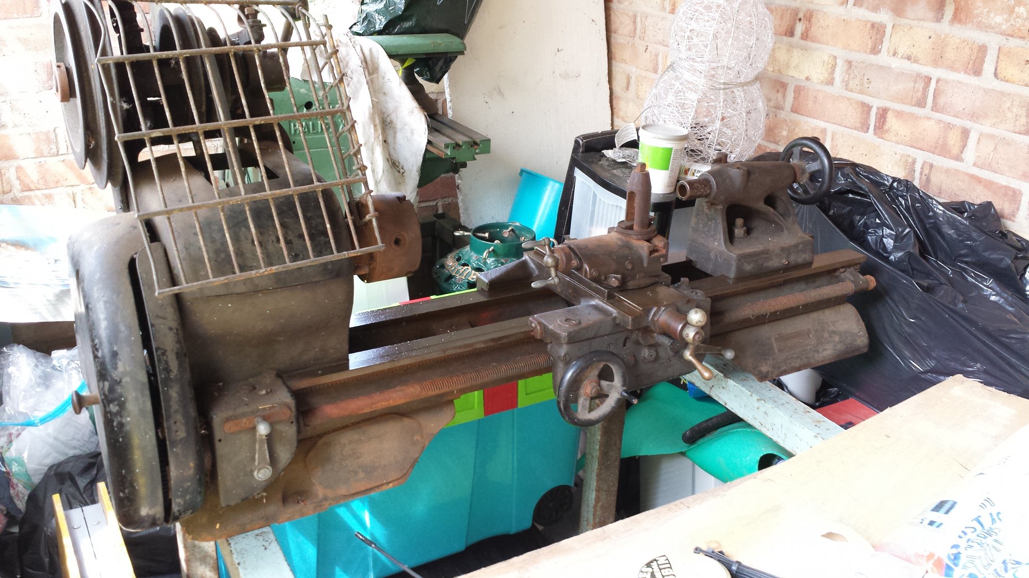

Very smart, significantly better than my Sphere (10f clone) that sits in the jobs for one day pile!View attachment 96387

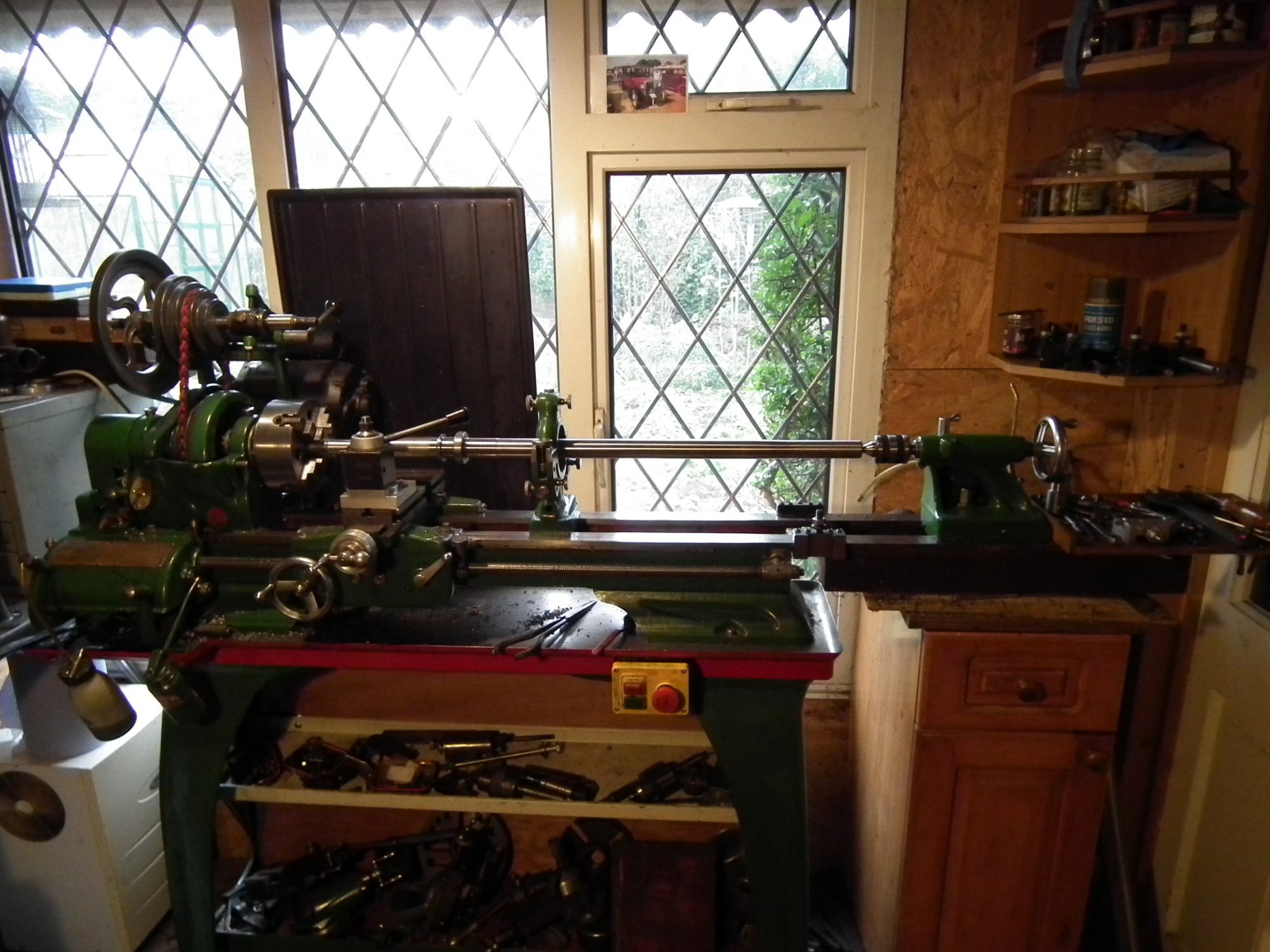

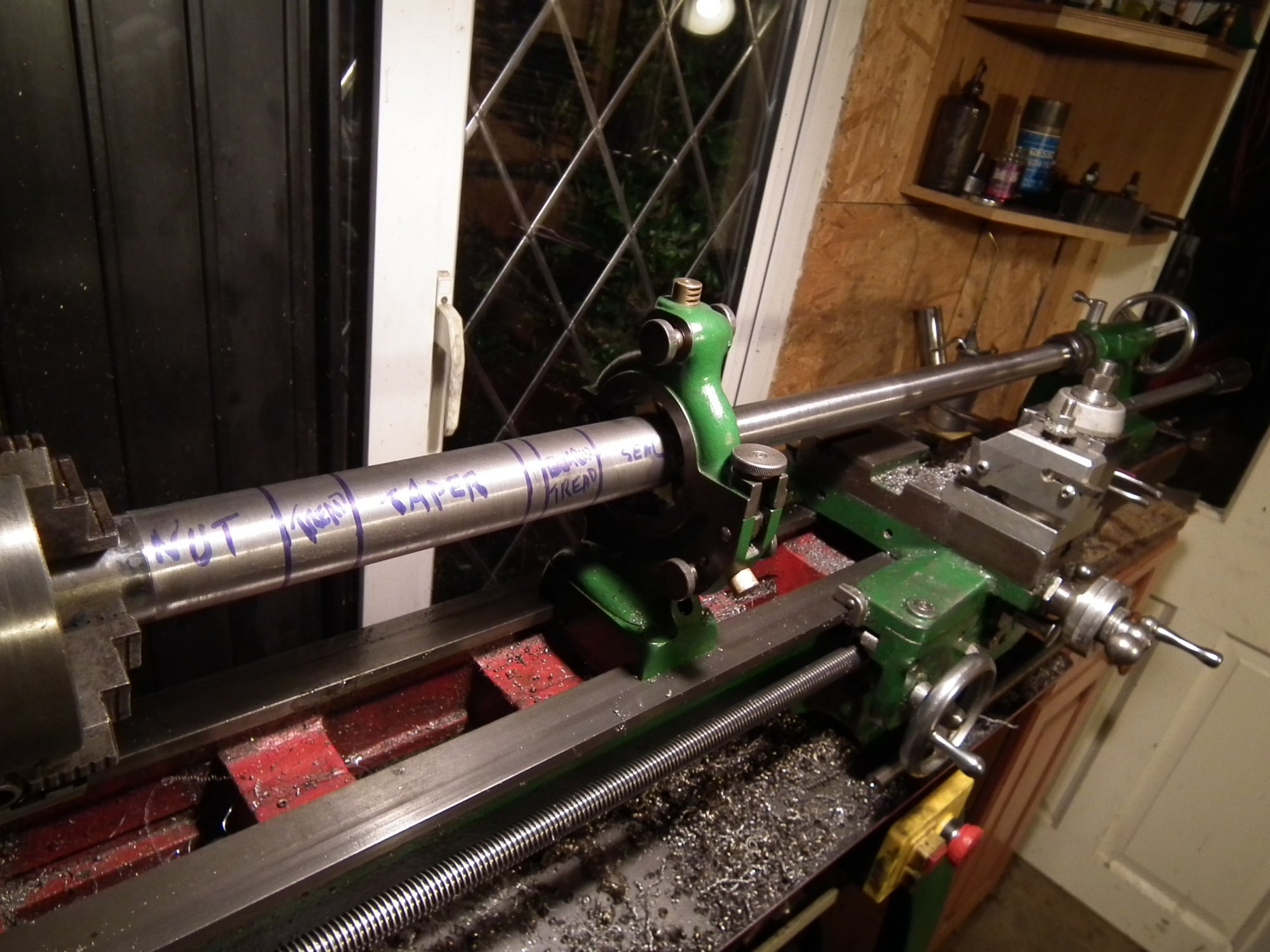

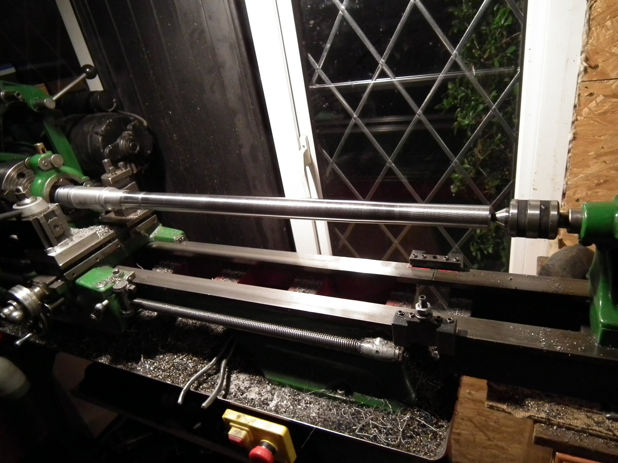

As we're talking Atlas Lathes, here's mine today punching way above it's weight and length
View attachment 96416 View attachment 96415
whats the other bed from.Most excellent Sirwhats the other bed from.
And what you doing mister

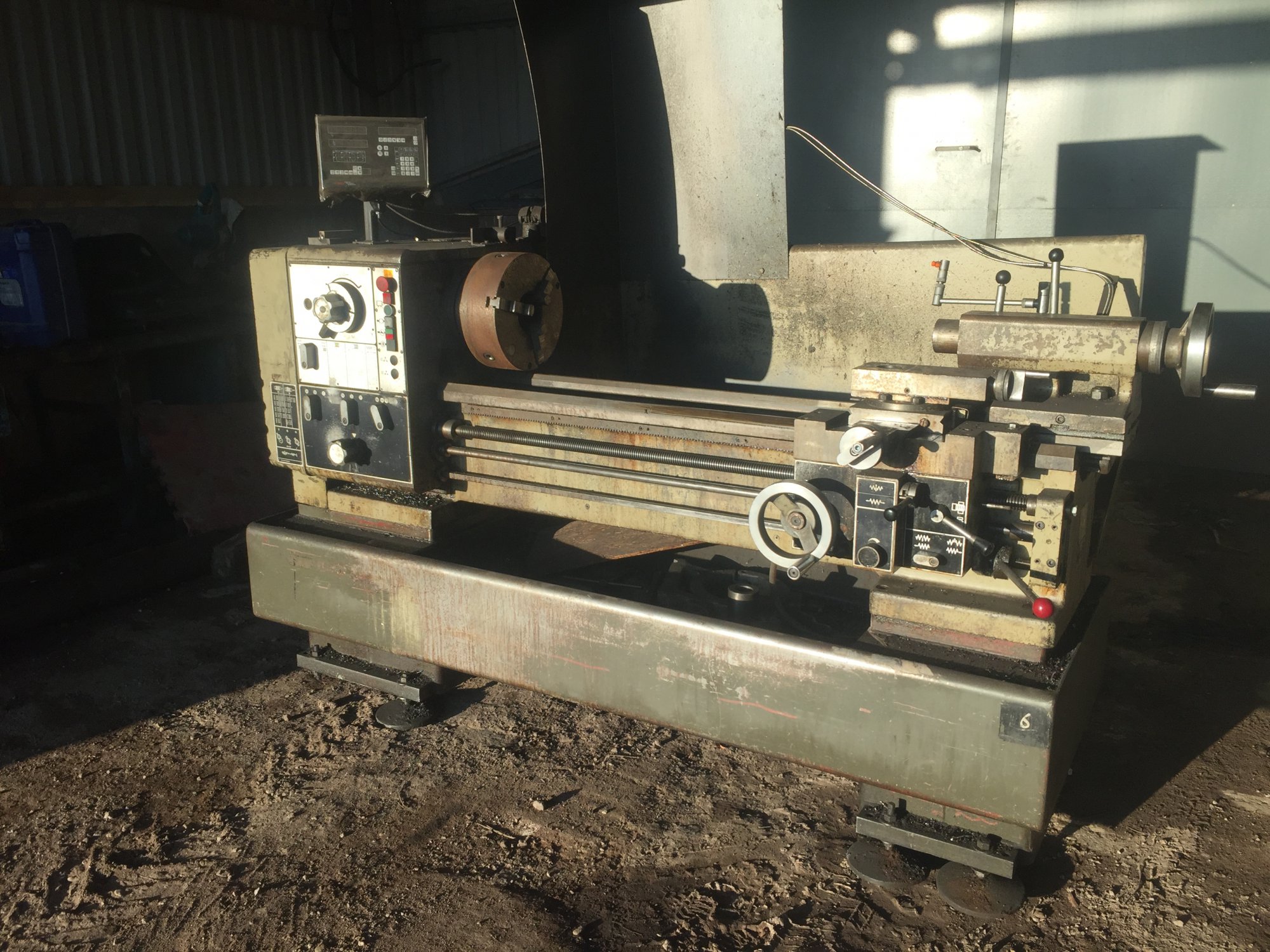

how much thenGot myself an old m400 to sit alongside my even older 13" Harrison.
It's worn but will be ample for what I use it for. I'm not chasing tight tolerances - just a few thou is close enough for me. Came with a 3 jaw, 4 jaw, fixed steady, taper turning attachemt and a DRO
