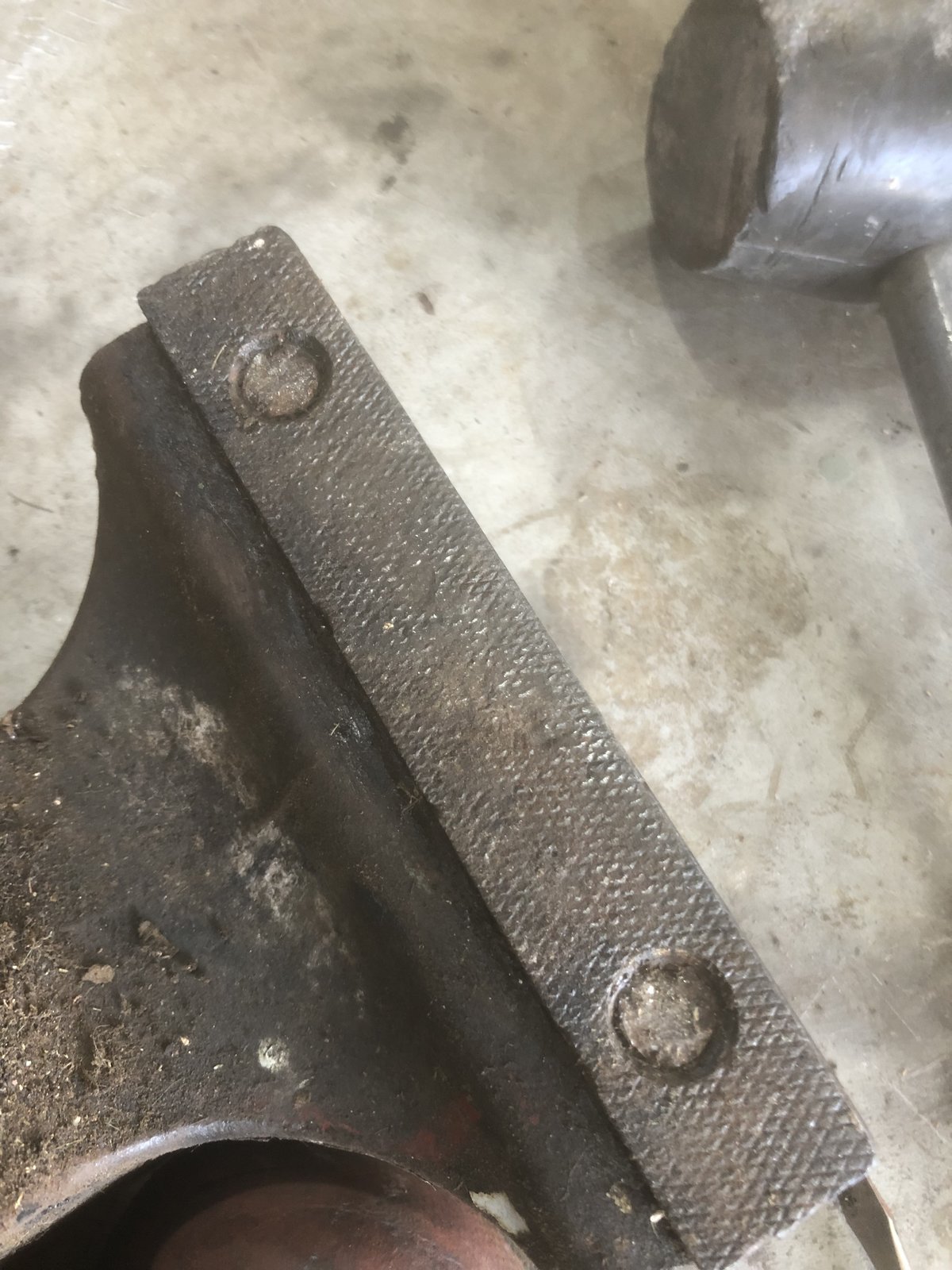

Based on the machine screws that came out of the vice, they're BSW or UNC (as have same thread pitches). Some research shows the thread profiles are slightly different, but for the non-critical application of holding some jaws in place the BSWs are working fine!
Is kind of critical though... because jaws that rattle off are a pain.
Surely UNC?

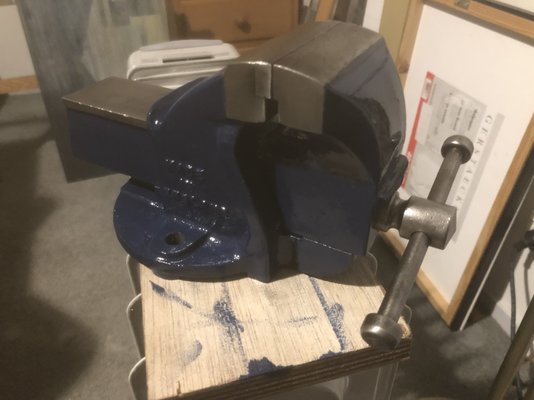

Record No 0 ticked off!
Yes. Ok.
UNC.
Dam autocorrect at an in godly area in the morning.
I was heading to pointy head land.
I should of been going to Bracknell.

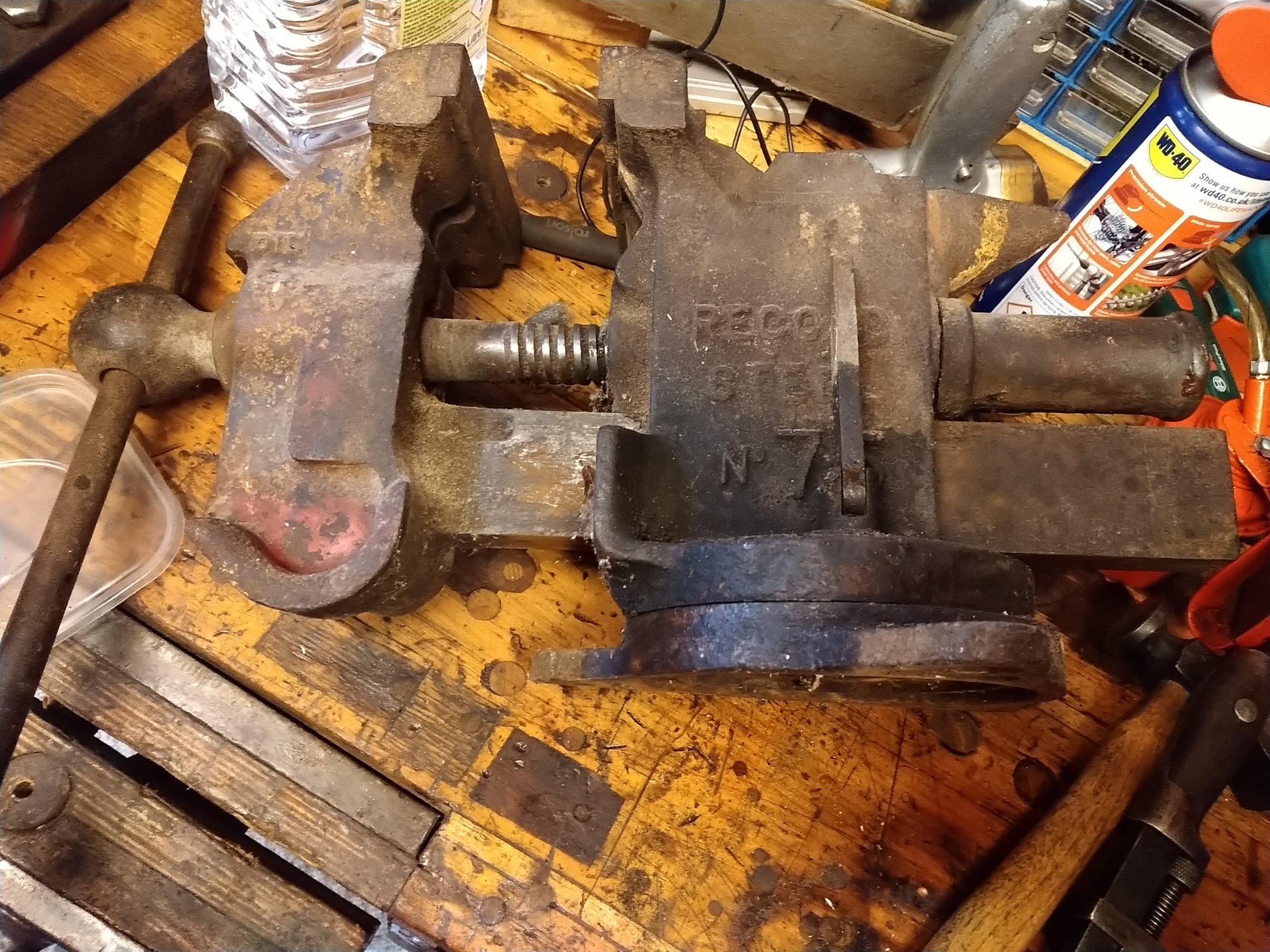

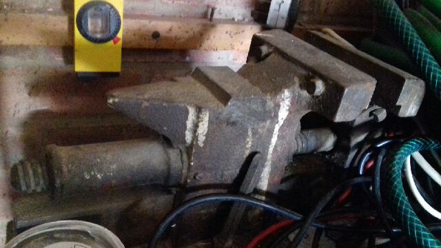

Well it's here, cost £25 and appears to be in good nick. Just given it a dose of anti seize all ready for the morning. Hopefully more pictures and information to follow.'erindoors found this while house clearing. ApparentlyView attachment 187376 it's mine but it's not made it home yet. Any ideas what it might be?

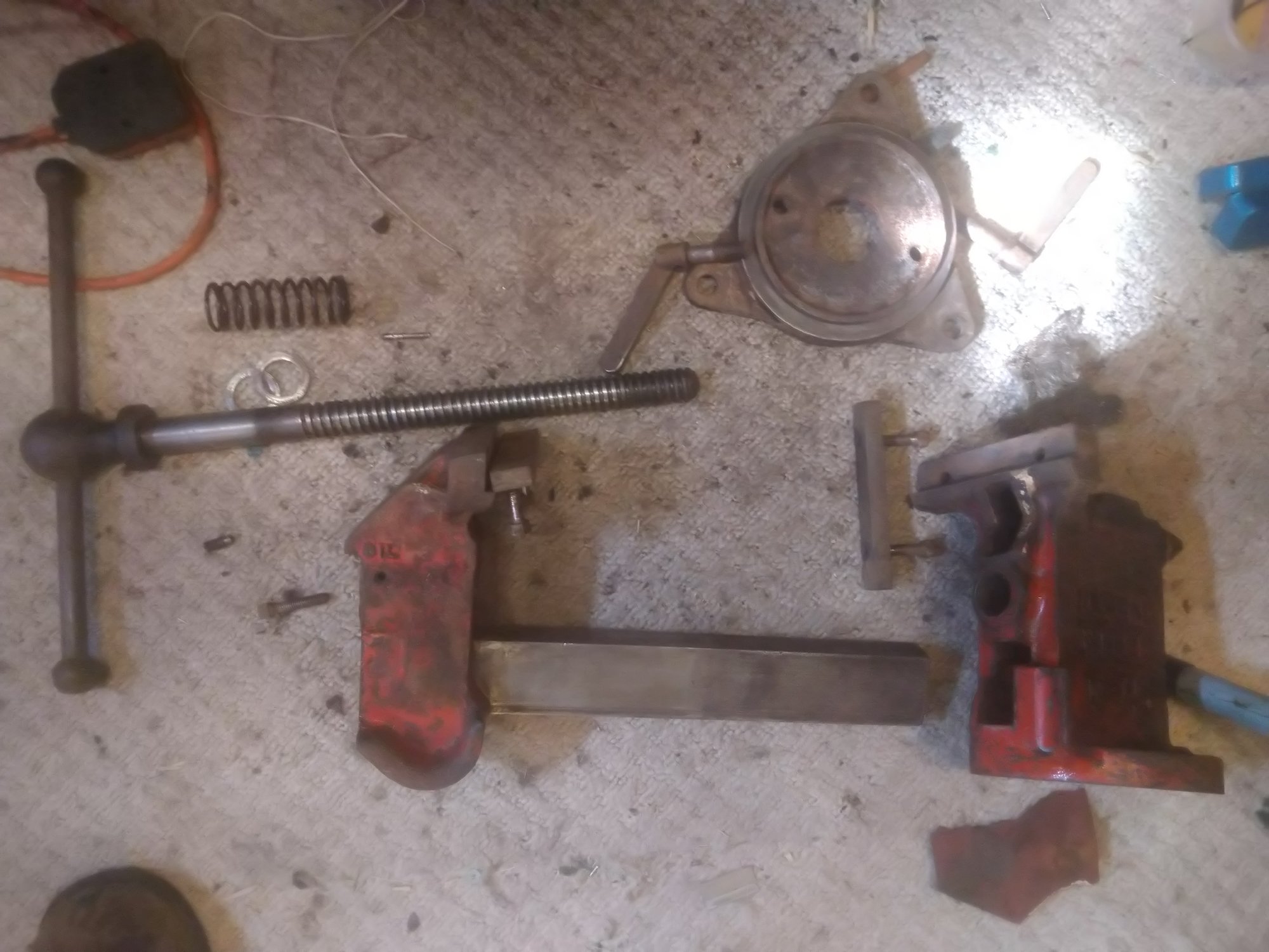

Had to compress the spring in a vice, tie it up with string and then when it was in burn the string off. I'm sure there must be a better way - but it worked. Now all I need to do is decide which vice it will replace.
