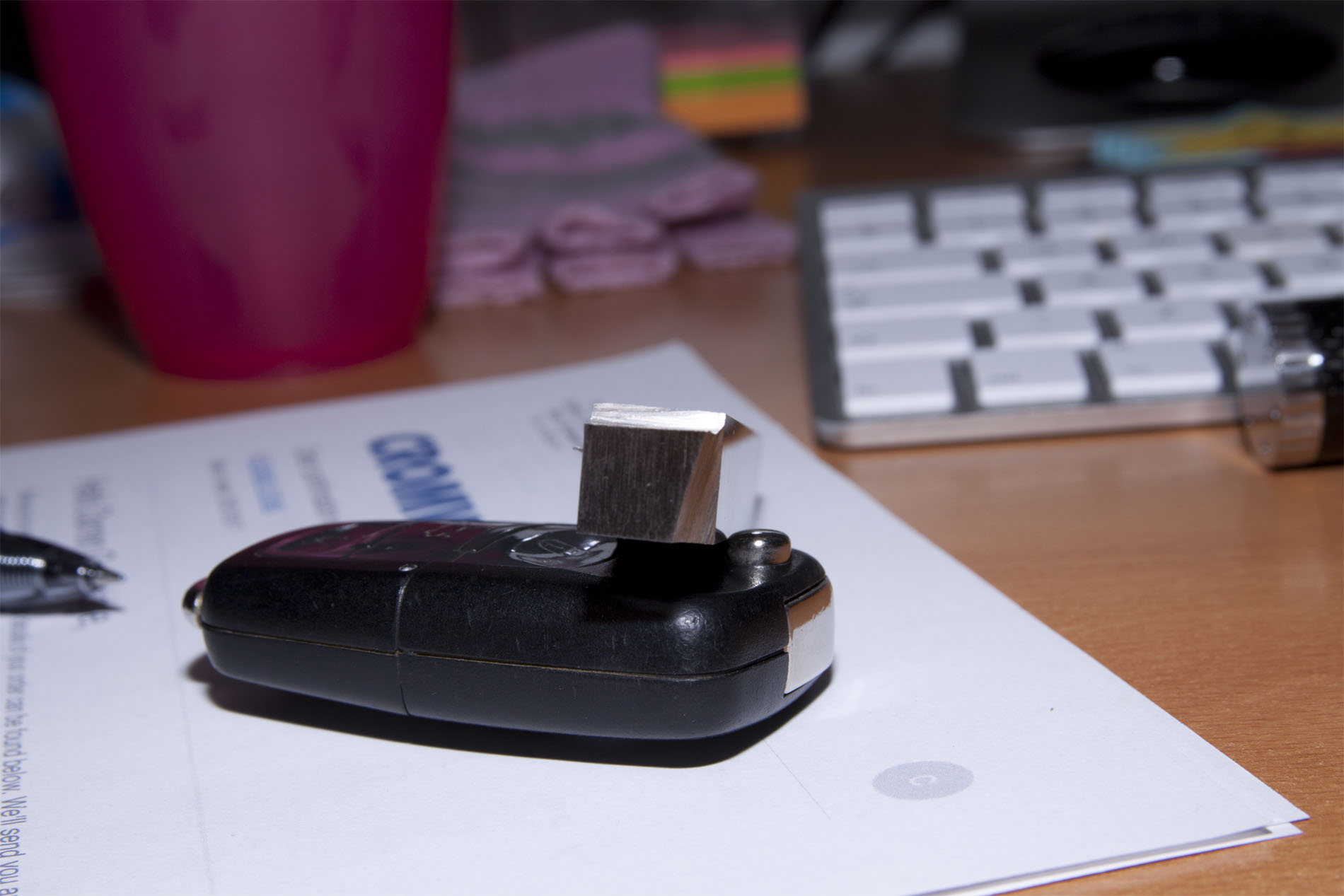

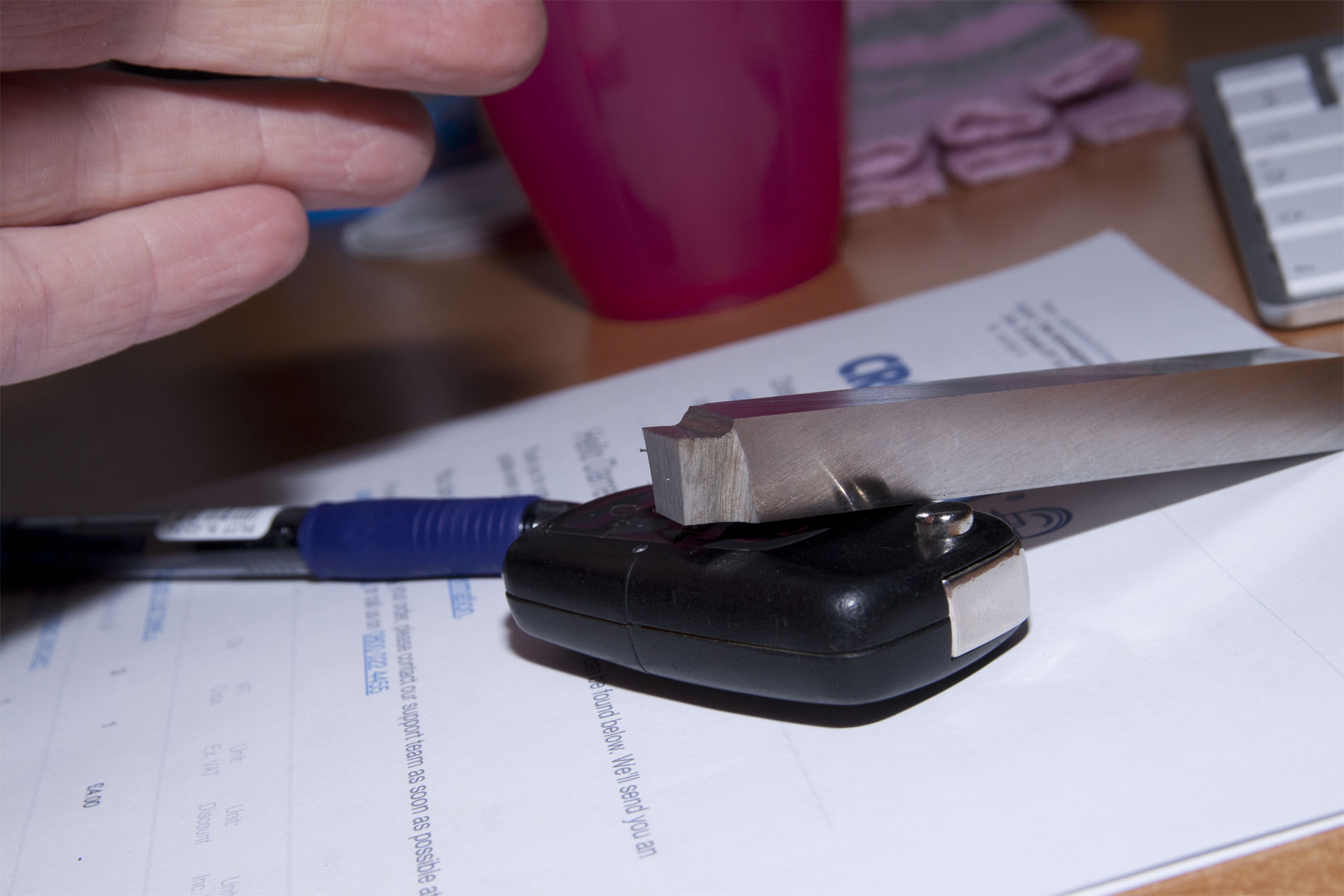

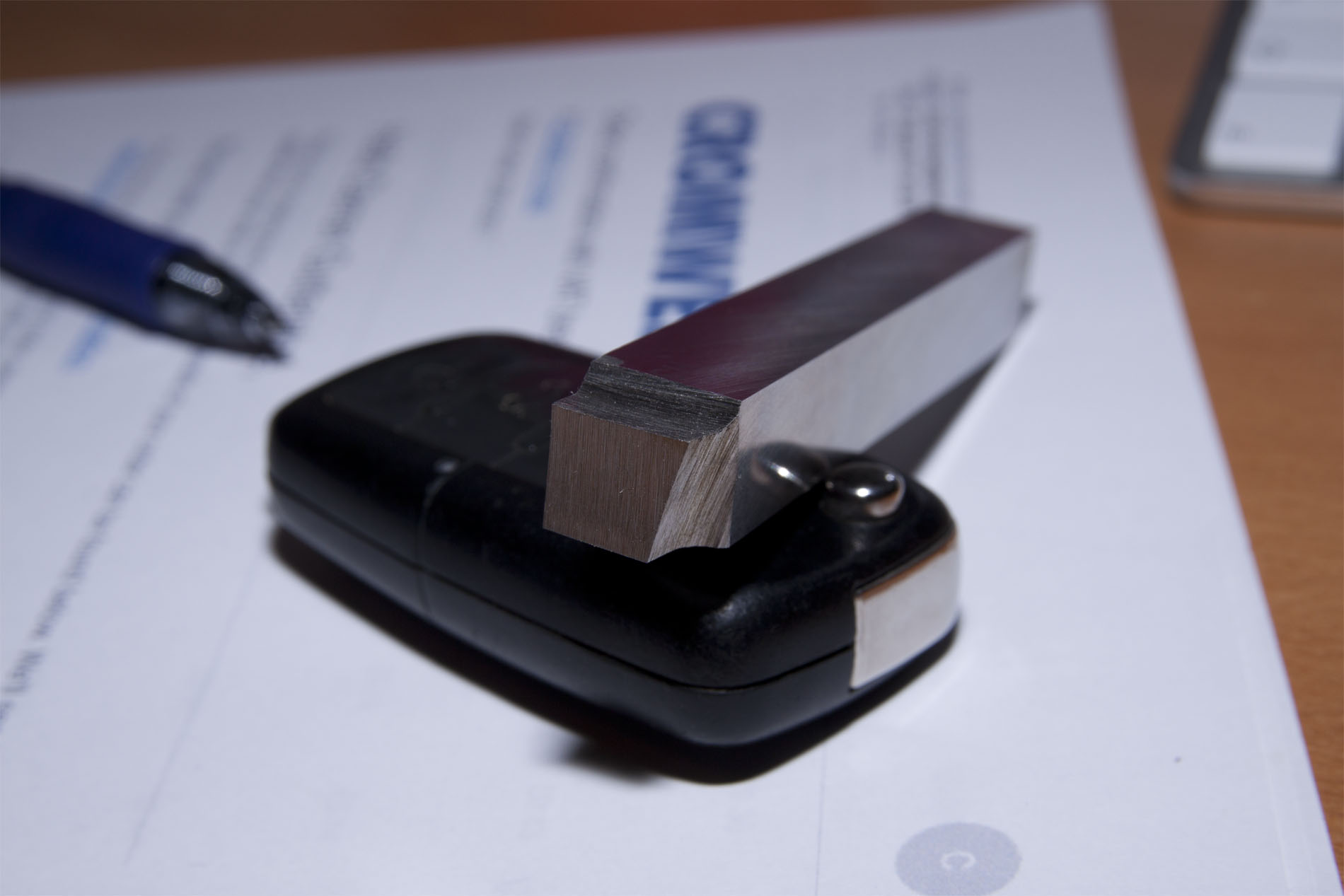

You need a bit of rake on the top edge

Tools, 12 or 8 not much difference when using them, half of mine are 1/4" as I was given the tool steel ages ago.
Do you have an angle grinder with a cutting disk? if so use that to get the basic shapes (cut off steel and not grind it away to get the basic shape) before finishing them off on the grinder. I'd have a bit more side rake on the top.
http://www.steves-workshop.co.uk/tips/toolgrinding/toolgrinding.htm

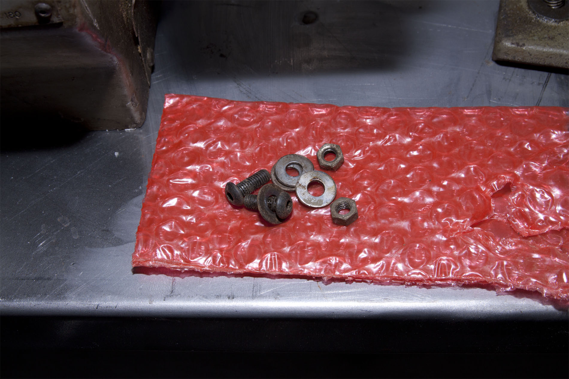

I think so going to put all the bits out on the bench in a minute.Did you find all the nuts and bolts that were packed in with it
