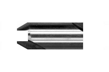

Next time i snap a centre drill, how do i get it out without mangling another drill bit?
On the odd occassion this works buy a lottery ticket!usually with difficulty. basically it depends on how it's broken, sometimes you can break them up / back it out with a centre punch if you can get enough of it too hit

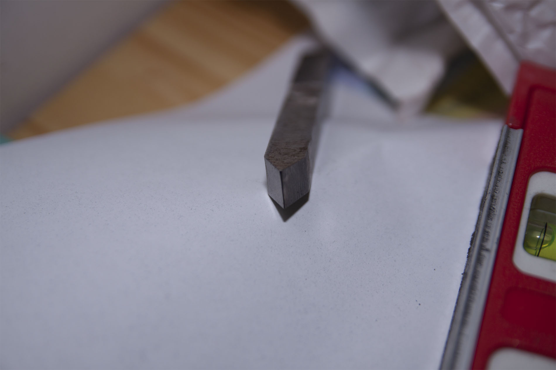

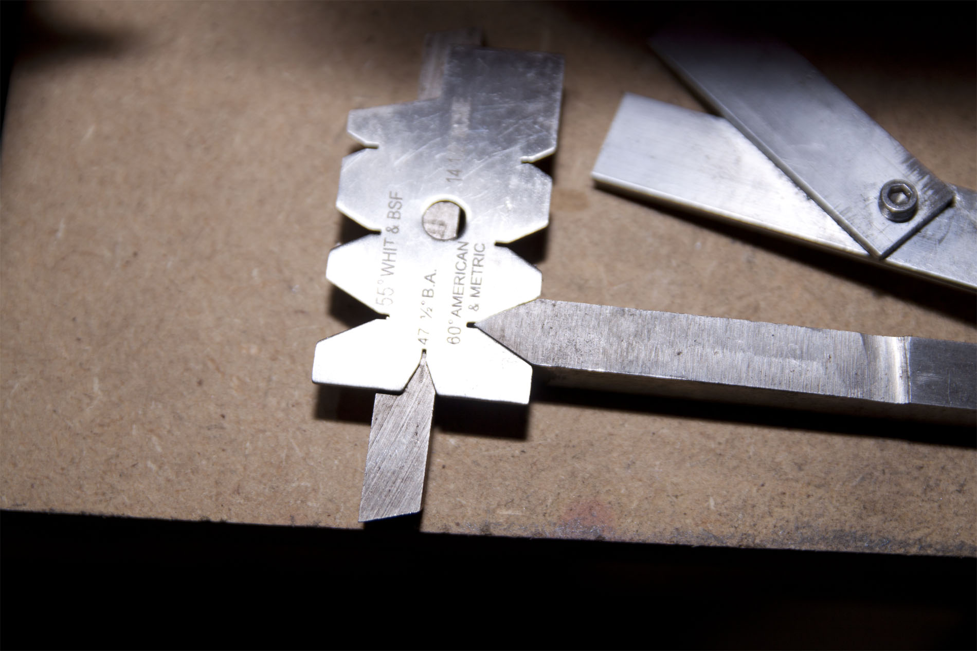

Thats a thread cutting gauge your using. You need to read up on lathe tool sharpening, understanding rake etc. Nd dont let the tool colour, keep dipping it in water.
http://www.steves-workshop.co.uk/tips/toolgrinding/toolgrinding.htm

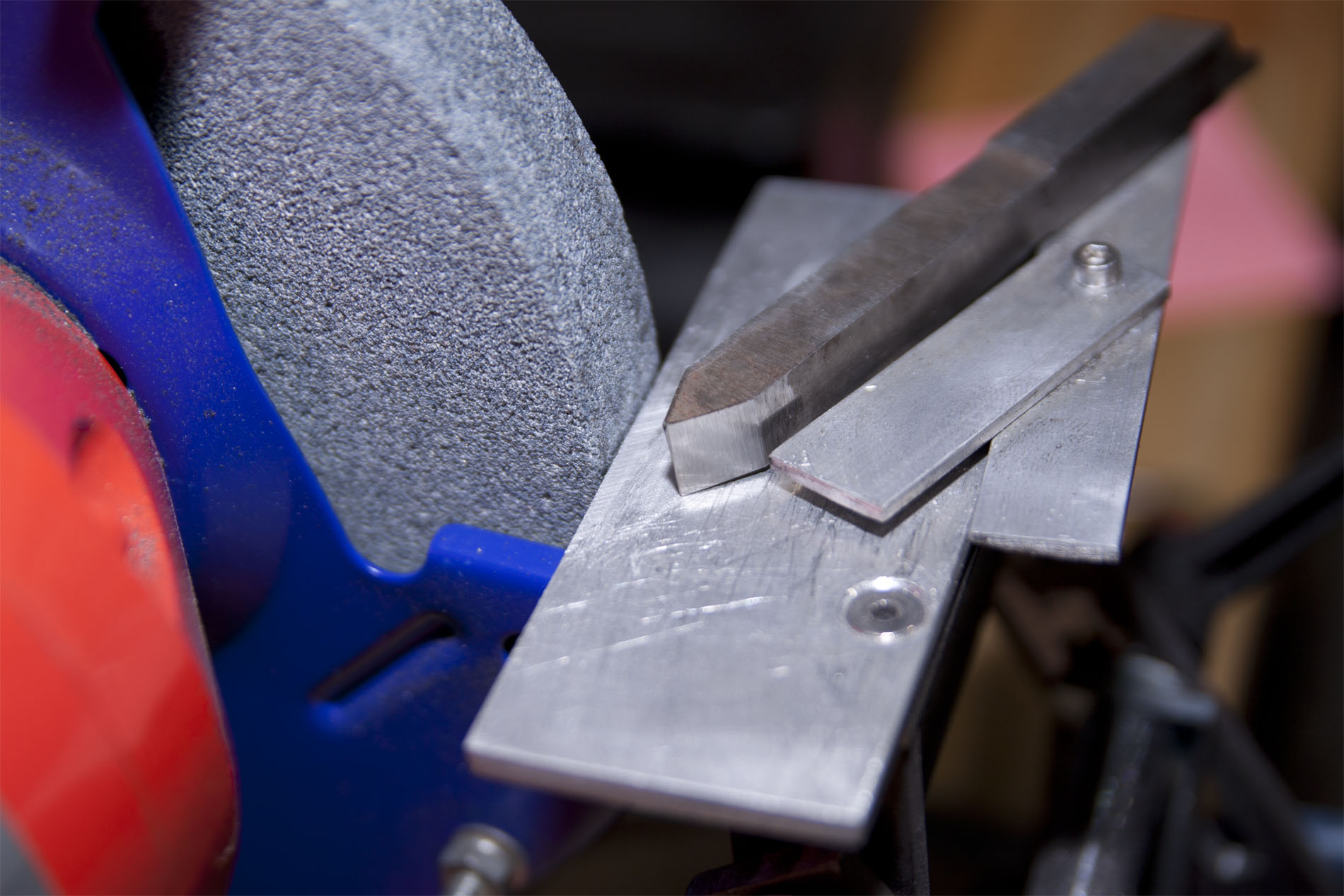

Did you grind that tool all the way back on the top? No need for that, you're just weakening the tool, putting in a load of heat, wasting time (and grinder wheel) and making more work if you need to grind the tool a different shape. Threading tools go in just a few mm, so that's all that needs to be ground.
I did hit it with the dressing tool, i think its just a crap wheel, i have a green wheel to go on.Also your wheel is visibly blunt. You need a dressing tool.
Do they have different Grits what should i be getting?Green wheels are no good for HSS, don't even try it. Look for a good Aluminium Oxide wheel.
a course and a fine oneDo they have different Grits what should i be getting?
Thanks guys, should these only be for grinding the lathe tools or can i use them for other things as well?
