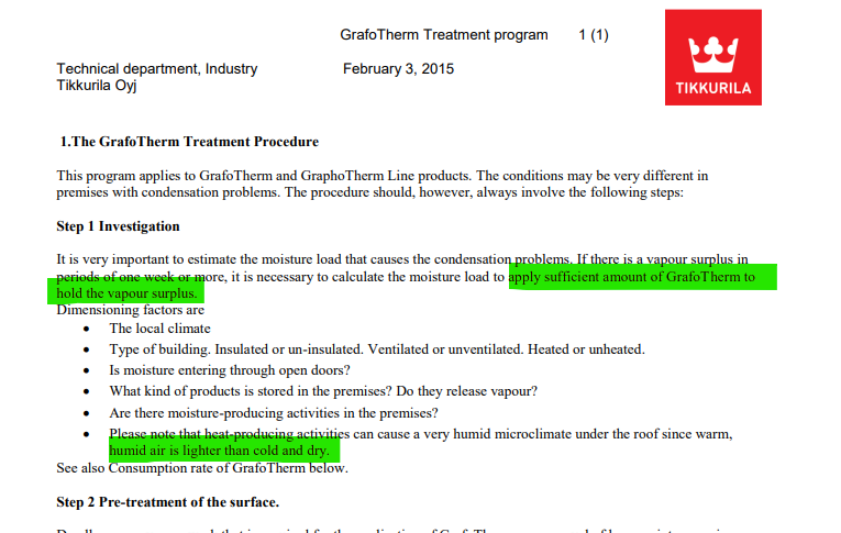

They had the option of having it sprayed inside with some anti condensation stuff, they had it done and it’s been fantastic, not one little bit of moisture any where and the coating is really thin.
whilst your clearly forgetting if that container is in direct sunlight it will expand seperating the metal from the foam as the foam shell does not expand with the metalMaybe worth reminding people what causes condensation; water vapour carried in the air touches something with high thermal conductivity which is really cold. Colder air cannot carry as much moisture so it just "condenses" out onto the colder surface.
Even a thin barrier of anything with a low thermal conductivity will prevent the air from touching it. Apart from the obvious fire risk, polystyrene is a great example. It might become literally as cold as the steel (in this case) but it cannot chill the air sufficiently for it to condense. Those fireproof expanded foam coatings would be my goto solution.
The upshot being if you can "tank" your container with anything that stops air touching the steel, there will be no condensation issues with the surfaces of the container. Same cannot be said for any cold steel objects inside it of course...

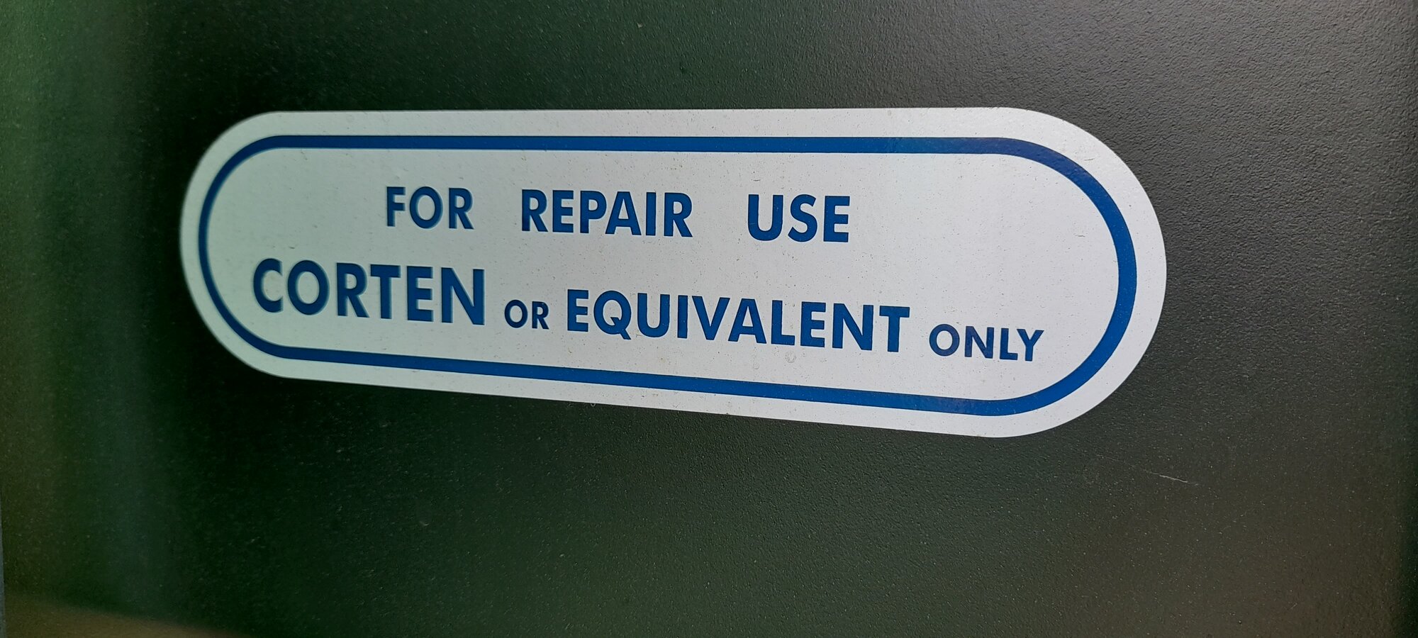

I dont think single use ones are.The container will be supplied with a lock cover welded on (and painted).
I had assumed all containers were made from cor-ten steel.
