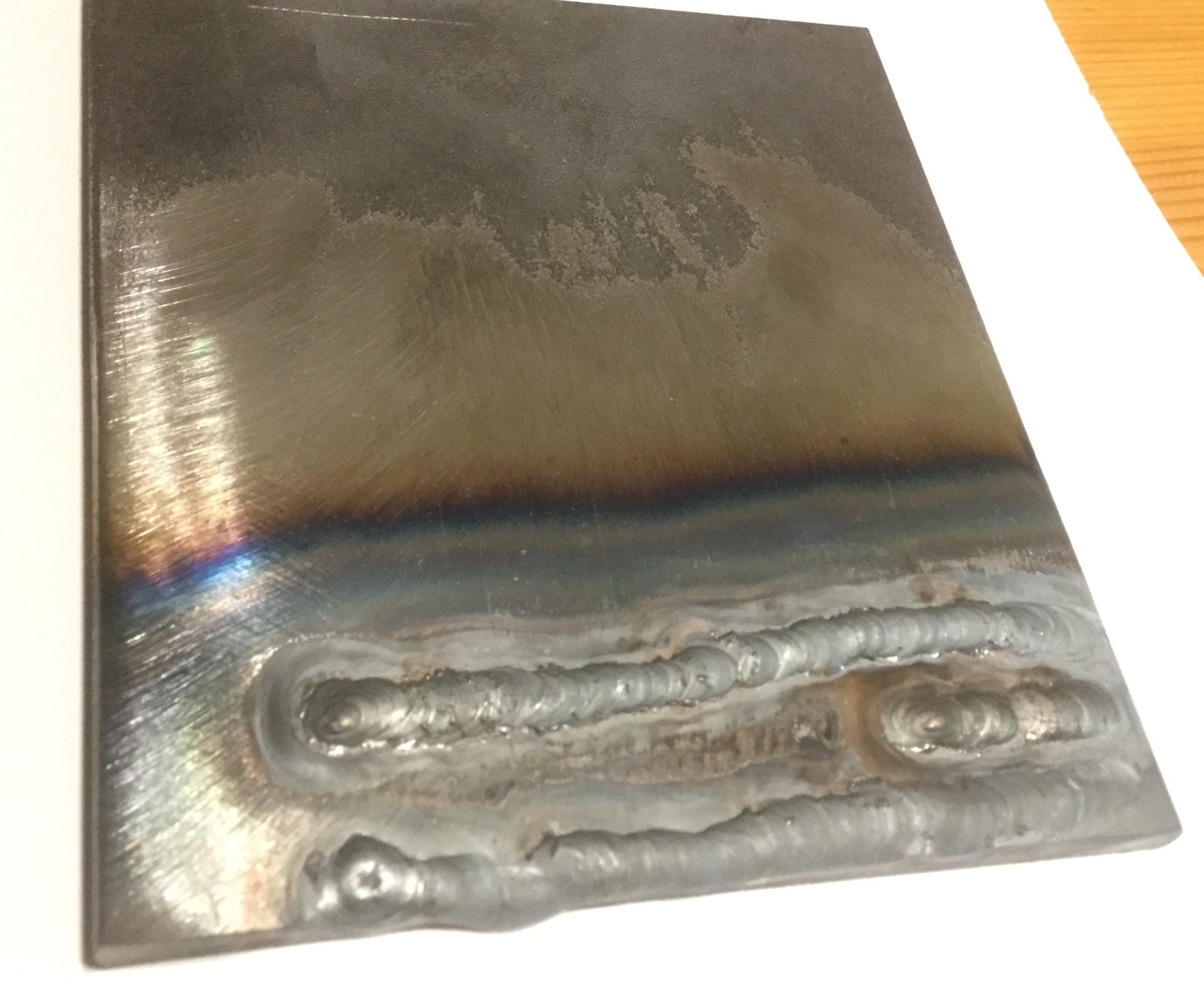

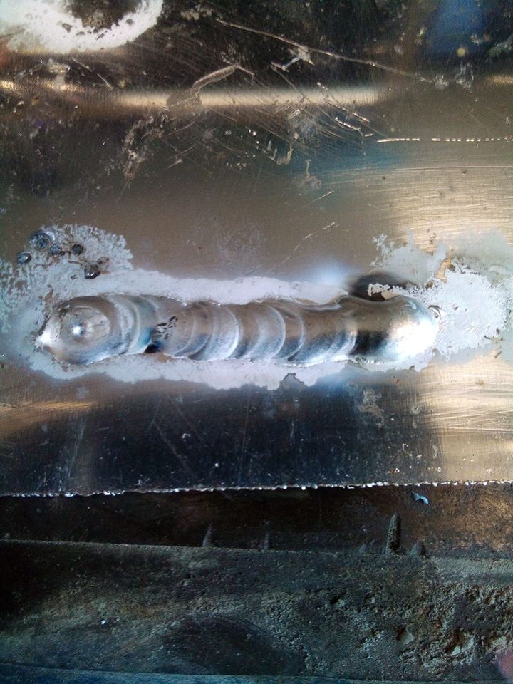

First ever go at Aluminium.....Is that steel? The settings I gave are for aluminium.

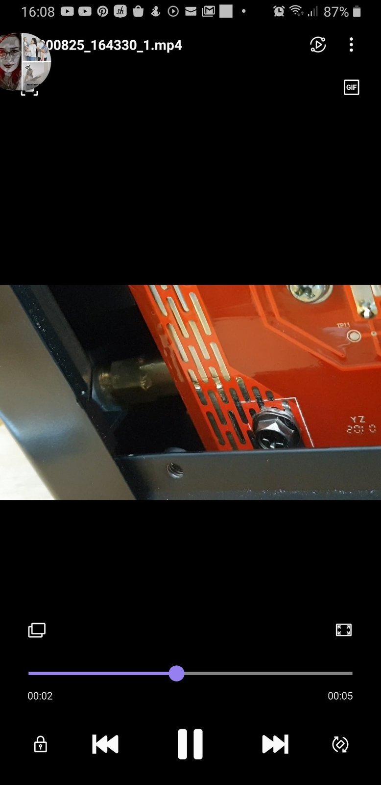

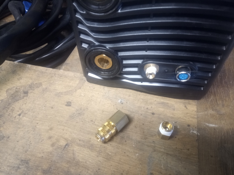

It's exactly the same inside? Hard to say, but quality of this welders is the best compared to other Chinese producers. We can see it in the number of complaints... On the 206P we only had only one complaint.I always check all my welders but turning on the tank then straight off so there is pressure then go inside for a brew or leave overnight and the pressure should still be there on next view or you have a leak. I have had tiny leaks which you cant hear and are found this wayJust a heads up for everyone I have noticed some hissing on my welder.. checked all the connections all good but i sounded like it came from the inside so took the lid off and guess what ? It was leaking from the connection on the back, luckily i was able to get a 12mm spanner in there and tighten it up without taking it apart even further.. might worth double checking so you don't waste your gas View attachment 248229
