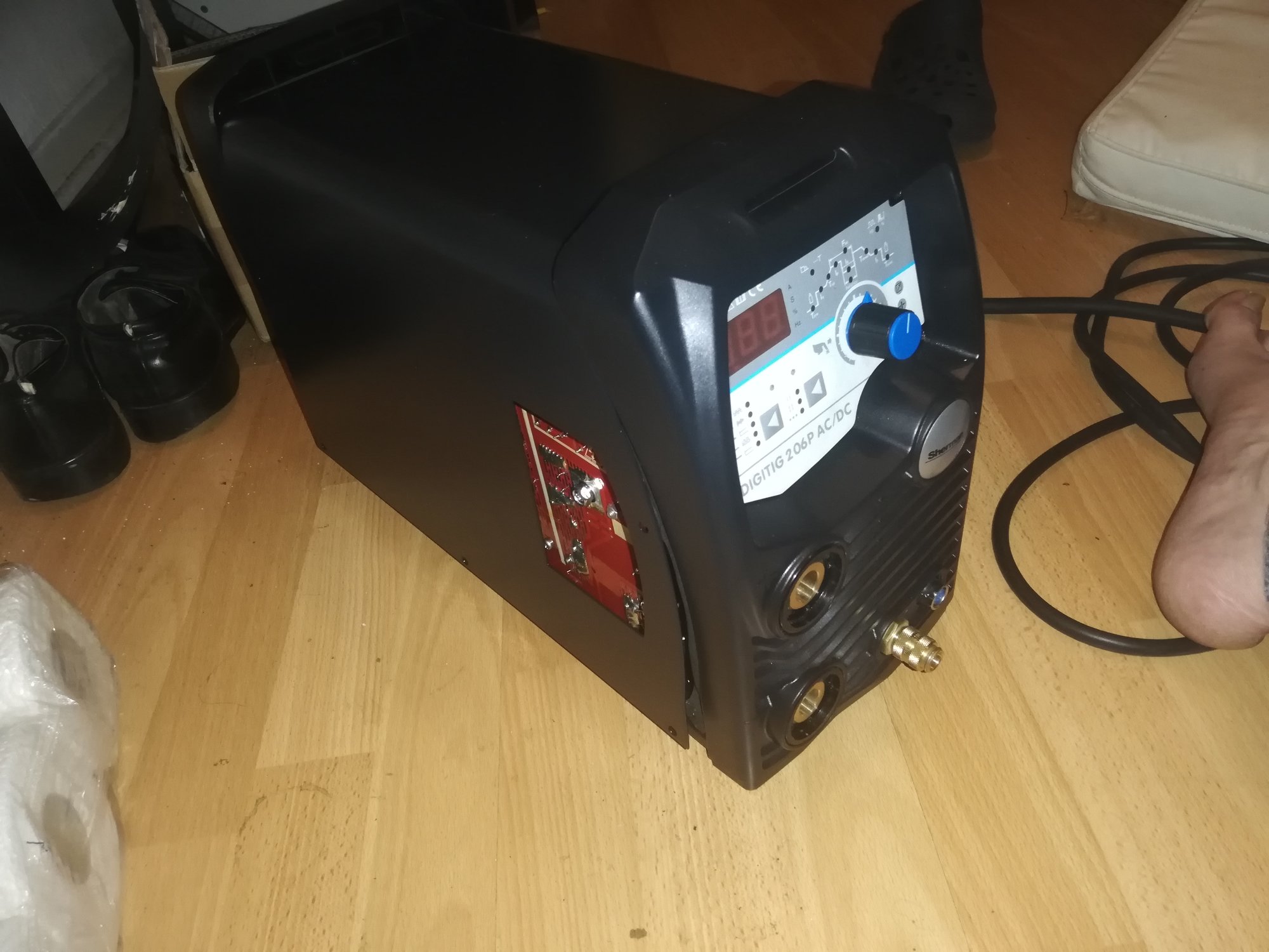

Bit of an odd one, when I am in ac pulse, I have the option of changing base amps from 0-200 but when I put the machine in remote For the pedal I can then only put it from 1-20 amps, anyone know what’s going on?
Mine does the same. I fiddled with the pot on the pedal and got it up to the heady heights of 31 amps with it maxed out. Without the pedal the base amps display works normally. I tried using AC pulse with the pedal and pulse didn't drop down that low by the looks of it. I cant tell what it is putting out though. Does the display show the high and low amps while welding? Bit of a strange feature. No big deal I suppose as the heat soak isn't as bad with pulse so less need for the pedal.
