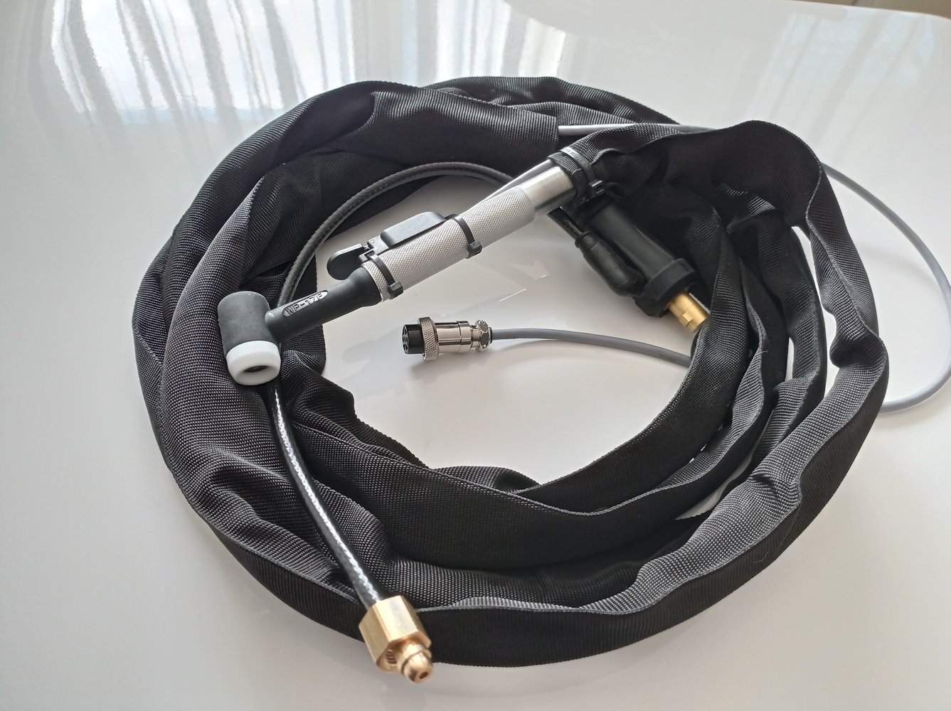

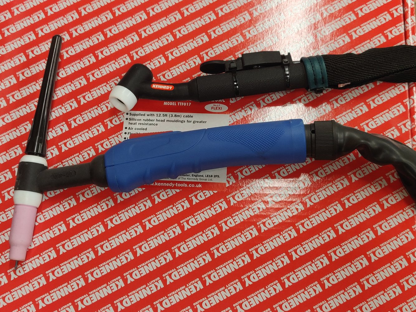

Just for info, decided to get the Kennedy TTF17 torch from Zoro (sub £30 with discount). Looks quite nicely made, here it is pictured alongside the stock Sherman torch.View attachment 280773

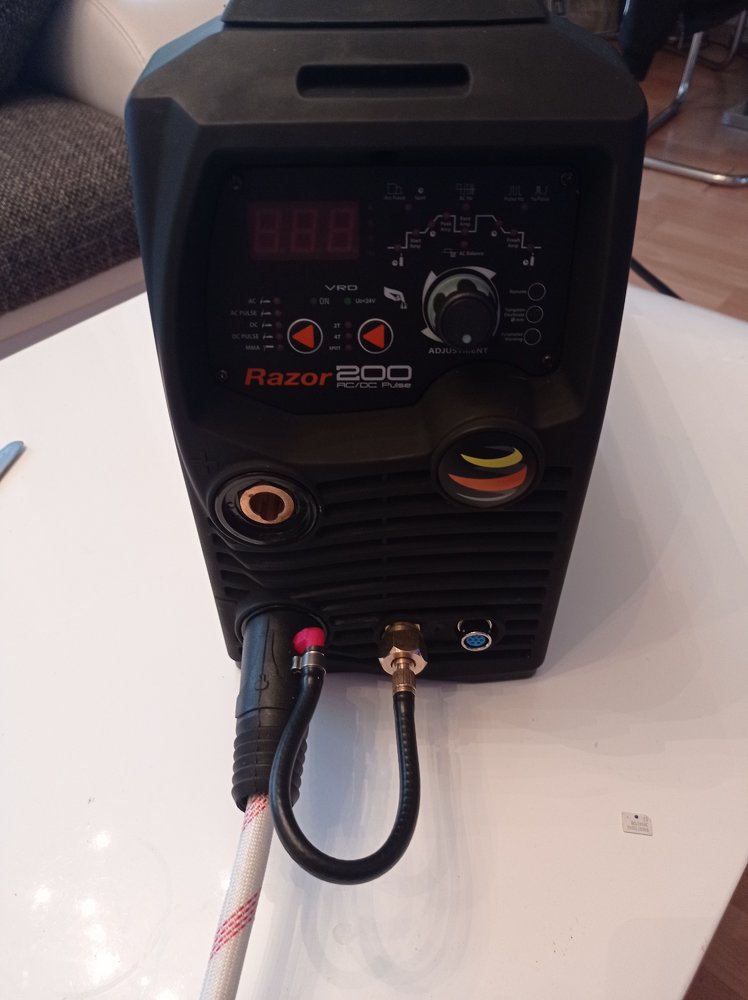

Thanks, just wasn't too sure.Pin 3 and 5 on the plug is for torch switch, doesn't matter which way round you have the wires.

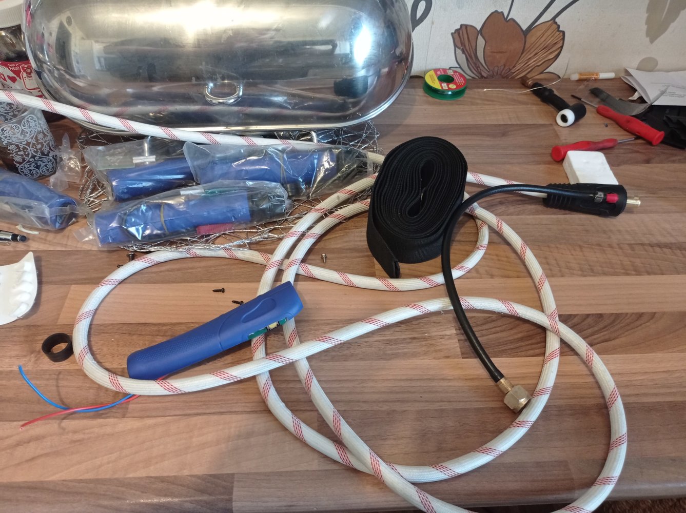

Whom did you purchase it from?Just for info, my kit arrived no problem but the torch is useless as there was no primary sheathing on the power wire but more importantly it didn’t have a pipe between the Dinse air connection and the torch itself and so the gas just pours out and doesn’t make it to the torch head. No reply to emails and they haven’t picked up the phone yet. Buyer beware!
