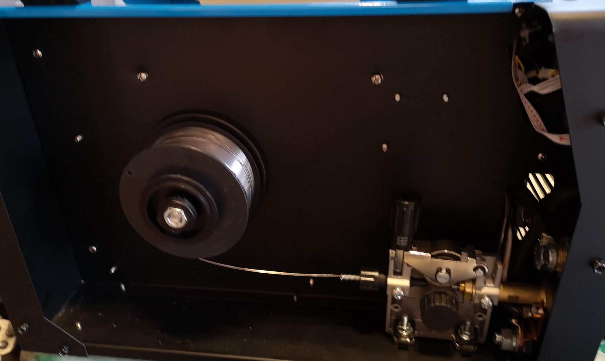

Close-up of the wire feed and its motor:

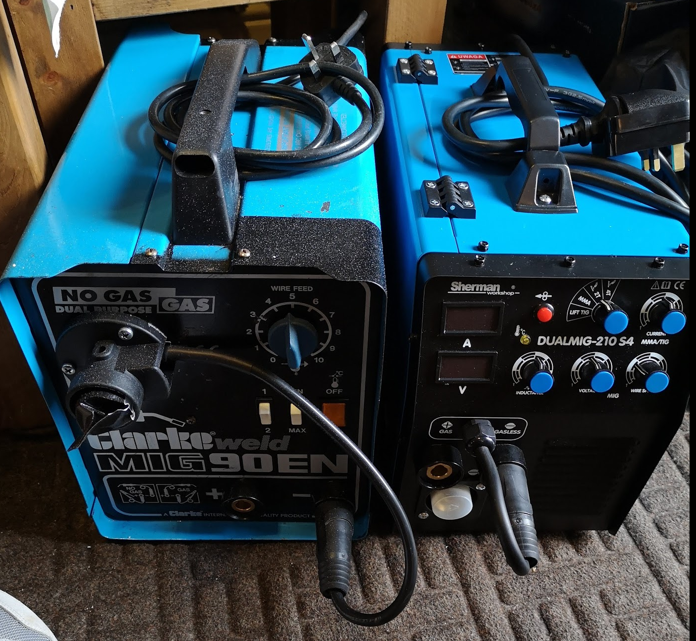

A quick side-by-side with the Clarke 90 (itself with a Euro socket conversion):

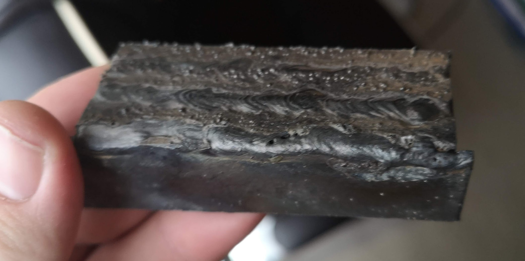

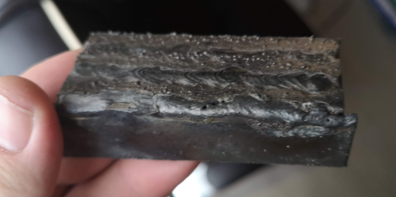

Playing with it
As noted in other threads, I'm pretty bad at welding (as you're about to see!) so here's the obligatory test welds shot while I was playing with the voltage and wire feed settings. Two beads and one outside corner. As you'll see, I didn't quite hit a sweet spot for settings yet(!)
As you can see from the spatter, I'm using flux wire (I only have pure Argon for the TIG), and as per usual, I can't get travel speed constant and I've wobbled about a bit.

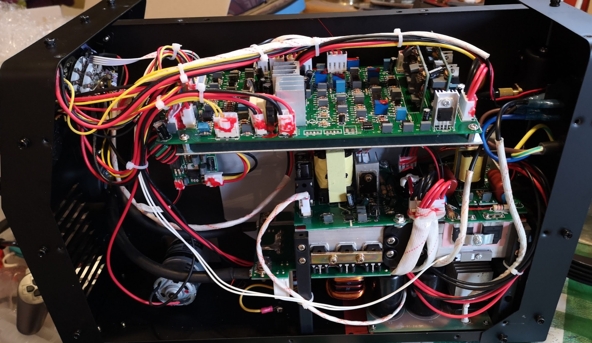

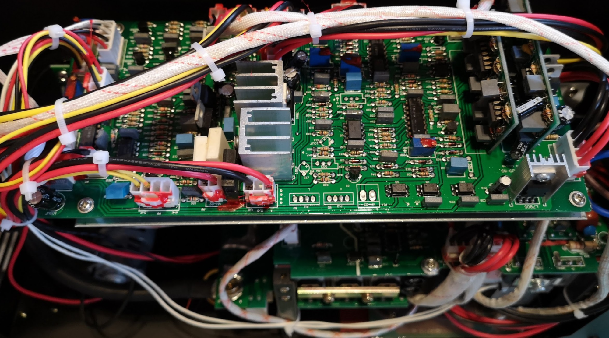

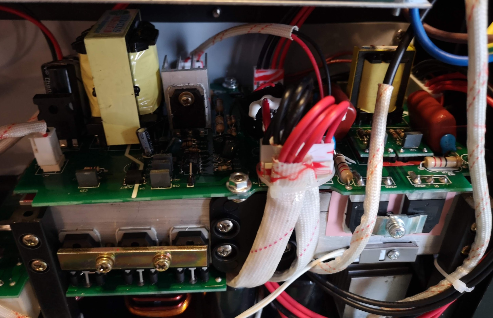

I'll try to add some more case-off shots soon if anyone's interested.

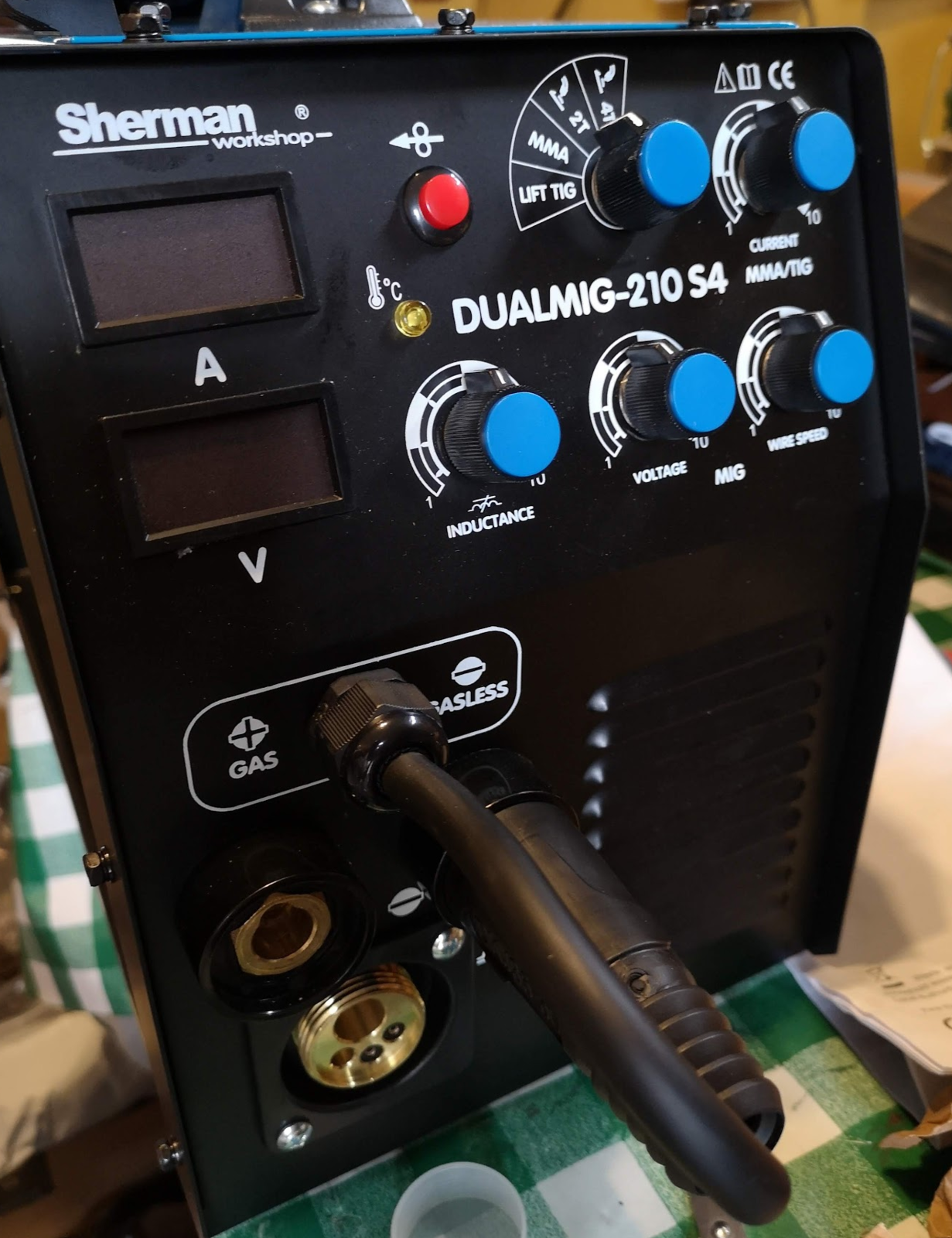

Anyway, it's a Sherman Dualmig 210 S4. At the time of writing, they can be had for about £250 if you shop around, though I paid £270. They're also on ebay for way over 300 which seems far too much for a relative unknown/spec. So price-wise, it's about Clarke 151 money, I guess?
They have a similarity to another 200 amp one that Static Arc were selling, but the panel is flipped vertically and inductance (on the sherman) is replaced with burnback (on the static arc).
My previous (and exceedingly limited) MIG experience is a Clarke 90EN. My one success with that was repairing a concrete mixer frame. A super metal pigeon poo repair. Anyway, despite the Clarke being super-popular, the things that I didn't like about it were a) its wire feed and b) being a transformer machine, albeit a small one, it's a bit heavy to lug about.
Basic specs:
- 200A MIG @ 60%, apparently
- Hobby sized and 5KG reels
- 2T/4T MIG and can do MMA and lift TIG (though I've only so far tried out MIG).
- It comes with MMA leads (2m) and a 3m MB15 MIG torch, which seems ok.
- 1 year work / 2 year home warranty
- Dinse 35-50 sockets/leads
Initial 30 mins thoughts:
- It seems nice - much nicer than the Clarke. It's light. Really light in comparison!
- The variable adjustment is a bit weird, being used to switch combinations

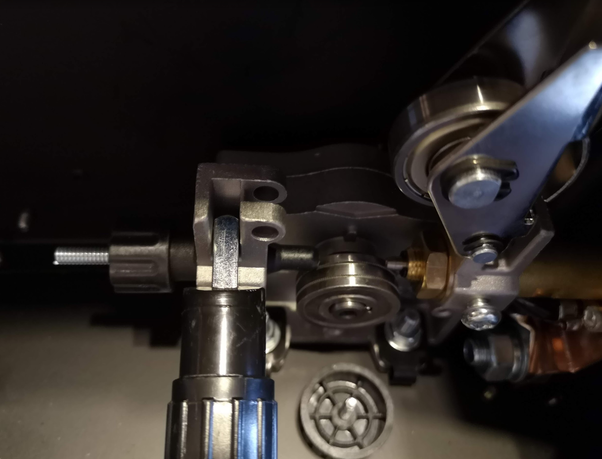

- The wire feed is worlds apart from the Clarke - smooth, doesn't sound like a lego technic motor on acid, etc.

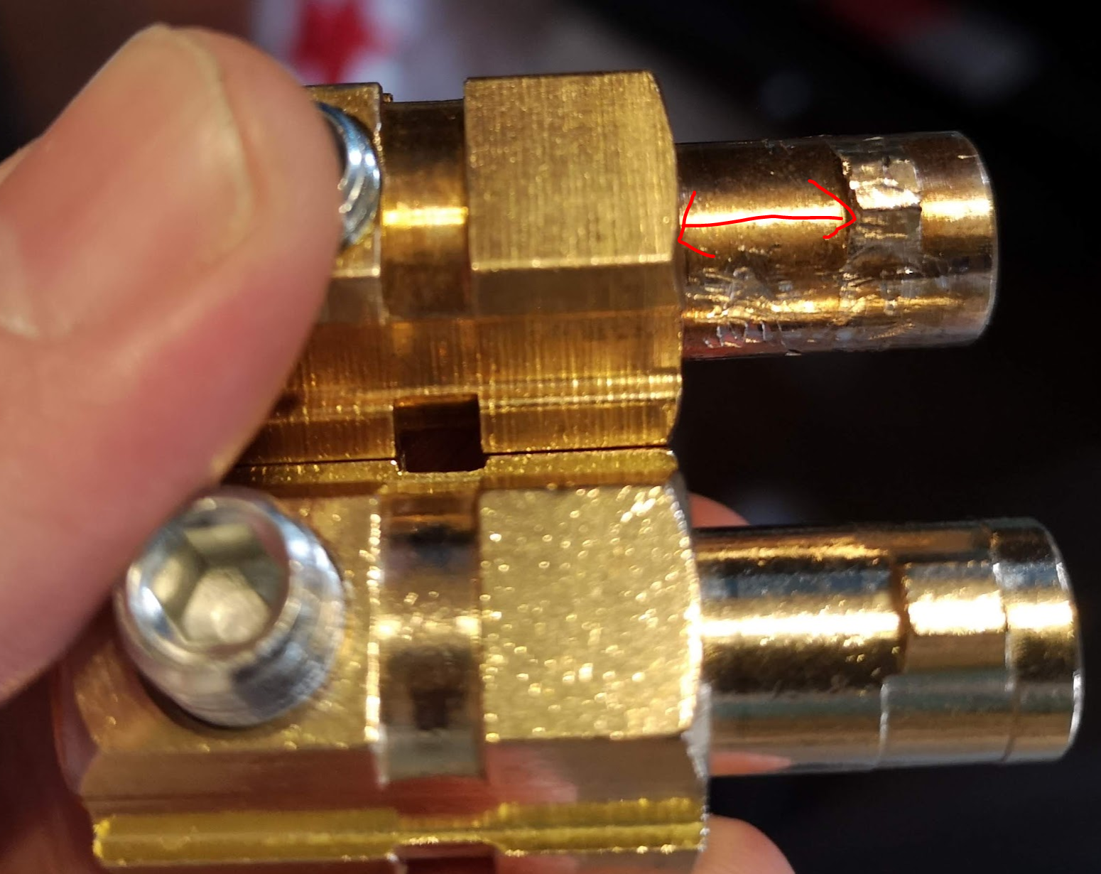

- The polarity change/euro socket lead - two complaints: a) it's very short and b) it came with some crappy dinse plug on it which appeared to be too short and wouldn't fit the sockets. Not a great start. Thankfully, I had some in and swapped it over.

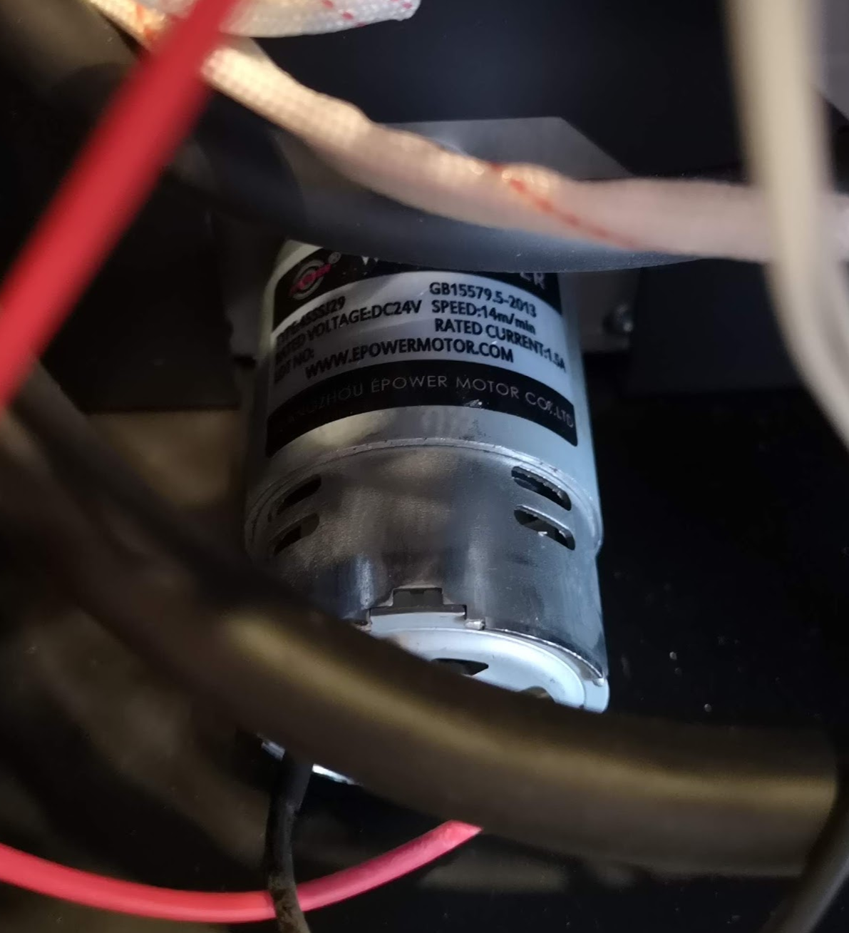

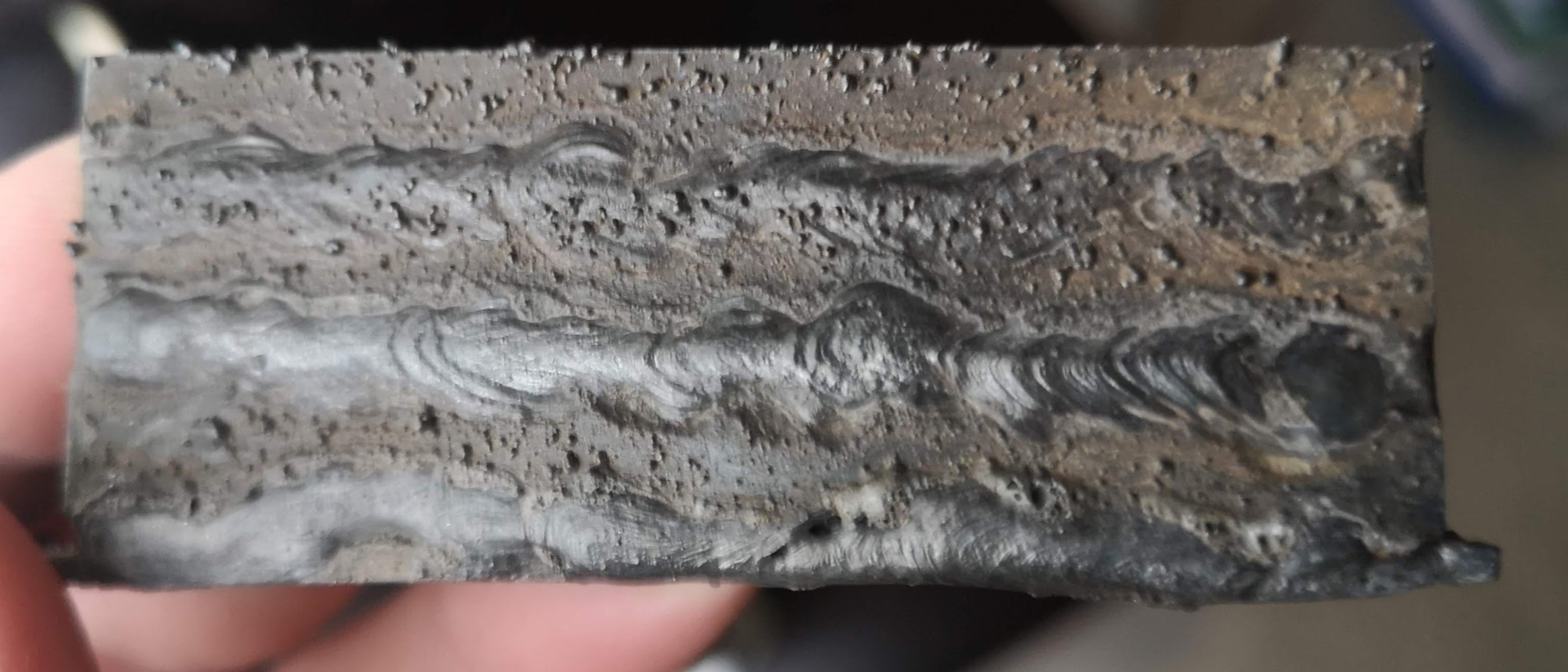

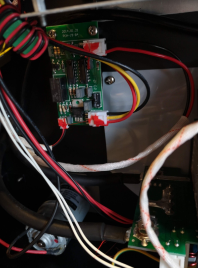

Playing with it
