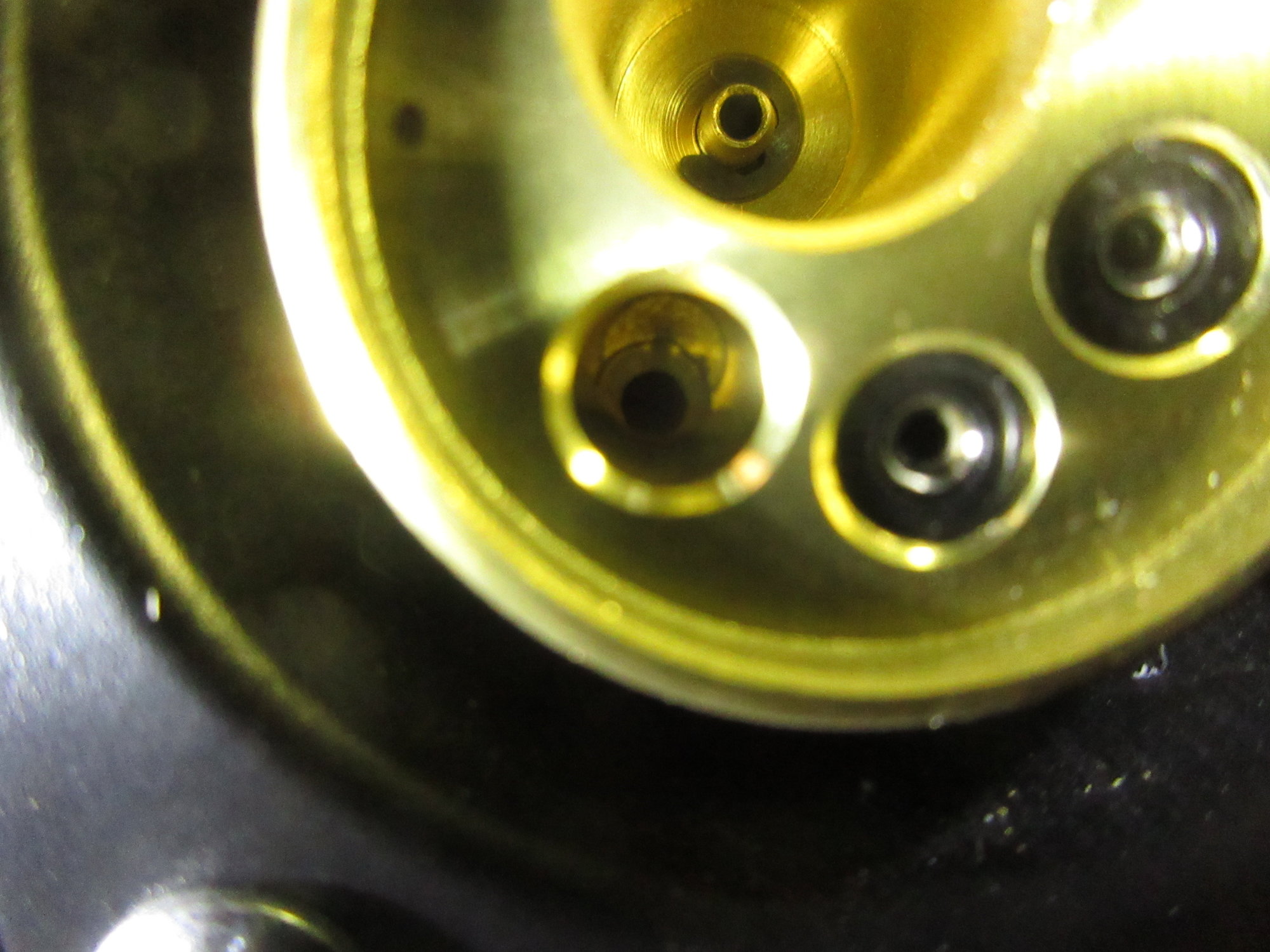

Yes hope so , the mig welds look really bad without gas, next to my stick welds -  my stick welds look super professional in comparison, and I thought mig was easy Haha

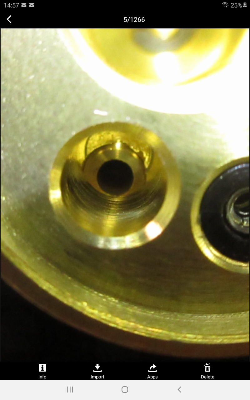

			you can see how the edge of the hole is on the edge of the socket hole
That would be great, its really off centreMaybe @DavidL can have a look at his one and compare it to yours?
Muito obrigado will try that in the morning, still trying to get my head around what will happen , hopefully not sparksNathan there is a simple procedure to see if the fault is from the torch, just cut some solid mig wire and shunt the 2 holes and try to ear the gas flow or the relay trigger from the valve. Another thing is to see if the gas tube is well inserted on both ends.
