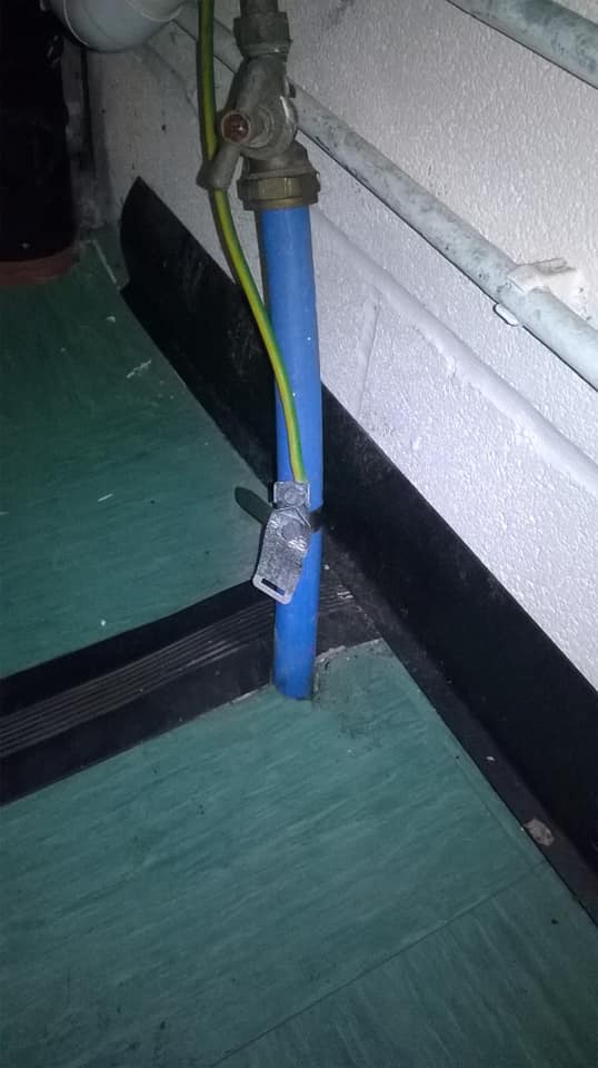

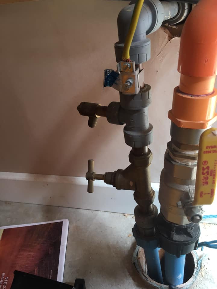

it saves you earth bonding the water from stop tap to electric service supplyyou cant bond plastic
.everything should be rcd protected though
There is some shocking copper about, only buy quality or you would be better off with plasticI have noticed modern copper pipe seems less coppery and thinner wall section than pipe of old?
Box ticking?I have heard suggestions on a number of occasions that copper can react with concrete, so should be wrapped in a suitable plastic (PVC would probably be unsuitable).
if all the pipes were copper you would bond all the metal extraneous parts so there all at the same potential. less chance of getting electrocuted including metal handrails windows steel beams the list goes on. it was called the silly season . fitting an an rcd on the supply eradicates the need apart from you still need to bond incoming supplies gas water and oil lines that are metal entering the buildingWhat on earth is the point of those bonding wires???Box ticking?
