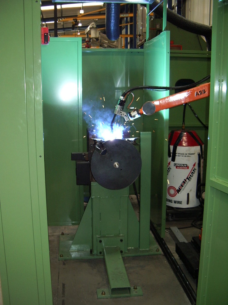

It's not the cylinders i'm trying to do.Pick up a used welding robot & positioner?
This is closing up a cylinder on a 1600kg positioner

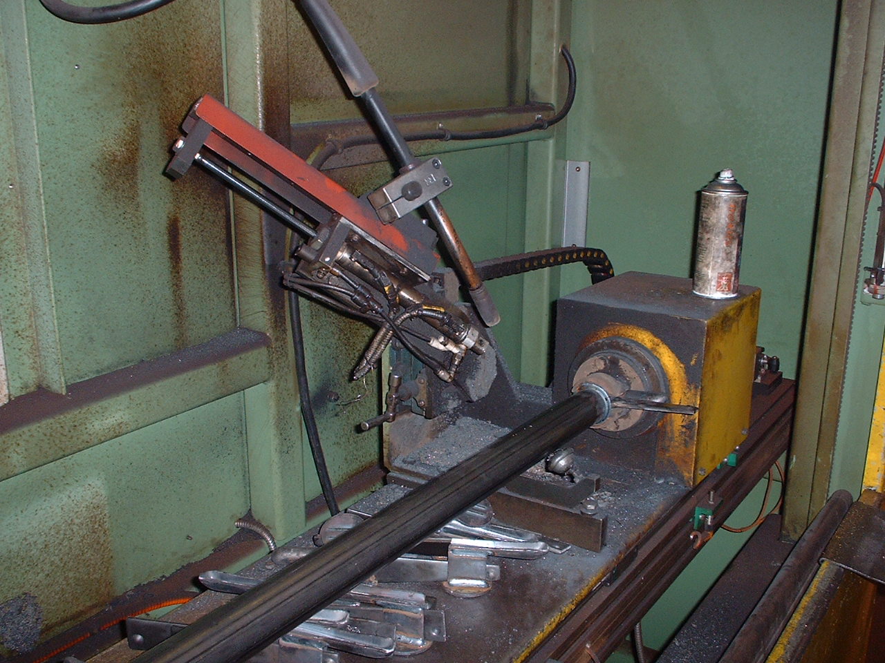

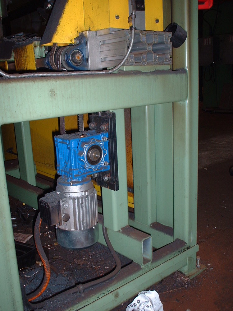

Or if it's just welding round, torch moved in to position with a pneumatic cylinder
and a simple belt driven rotator
