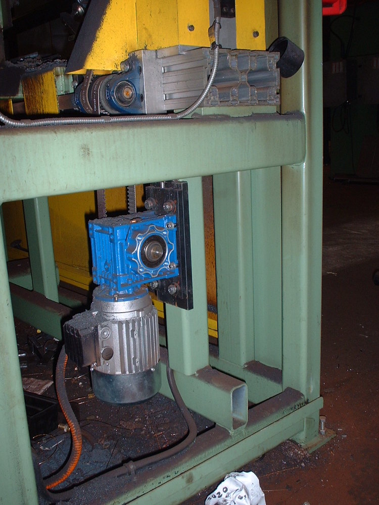

I've received yet another enquiry for hardfacing of a large surface area to very close tolerances.
The last job i passed on to a contact with the understanding that I either carry out the labour or get a commission. A month down the line, customer reported that the job was underway, and nothing from the contact I passed the job onto. Sneaky sods.
Anyway, I now need to build a welding cell to carry out straight line welding, to do this in house.
Now, one way would be to go to Welding Alloys in France and purchase a motorised H-frame. Unfortunately these are a bit cost prohibitive, as they're about 17k plus VAT for even the most basic unit, which would not allow traverse across the part. An actual cell like this is north of £30k.
If the surface area was smaller i might get away with this, but at £1200, still expensive for a small unit.

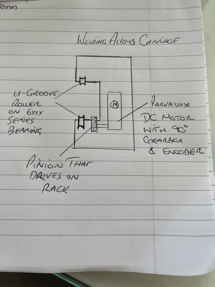

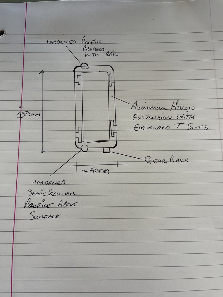

Now, what can i buy in the way of modular rails with steppers and ideally racks. The welding alloys frame profile looks like the attached image. They're not machine tool accurate but more than accurate for welding work. The welding carriage runs along these beams on v-rollers.
Need to stay away from ballscrews unless they're seriously enclosed due to dust generation and spatter.
