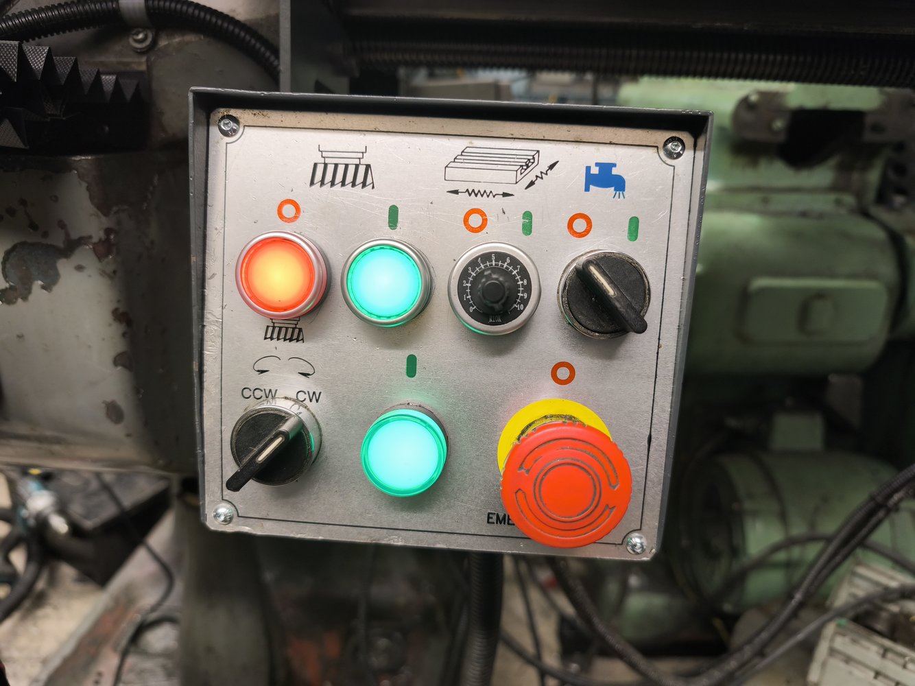

The control panel is wired up.

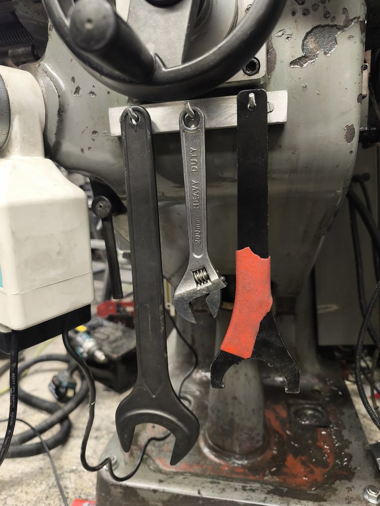

Fitted a small bracket so I hang some tools I use regularly on the mill.

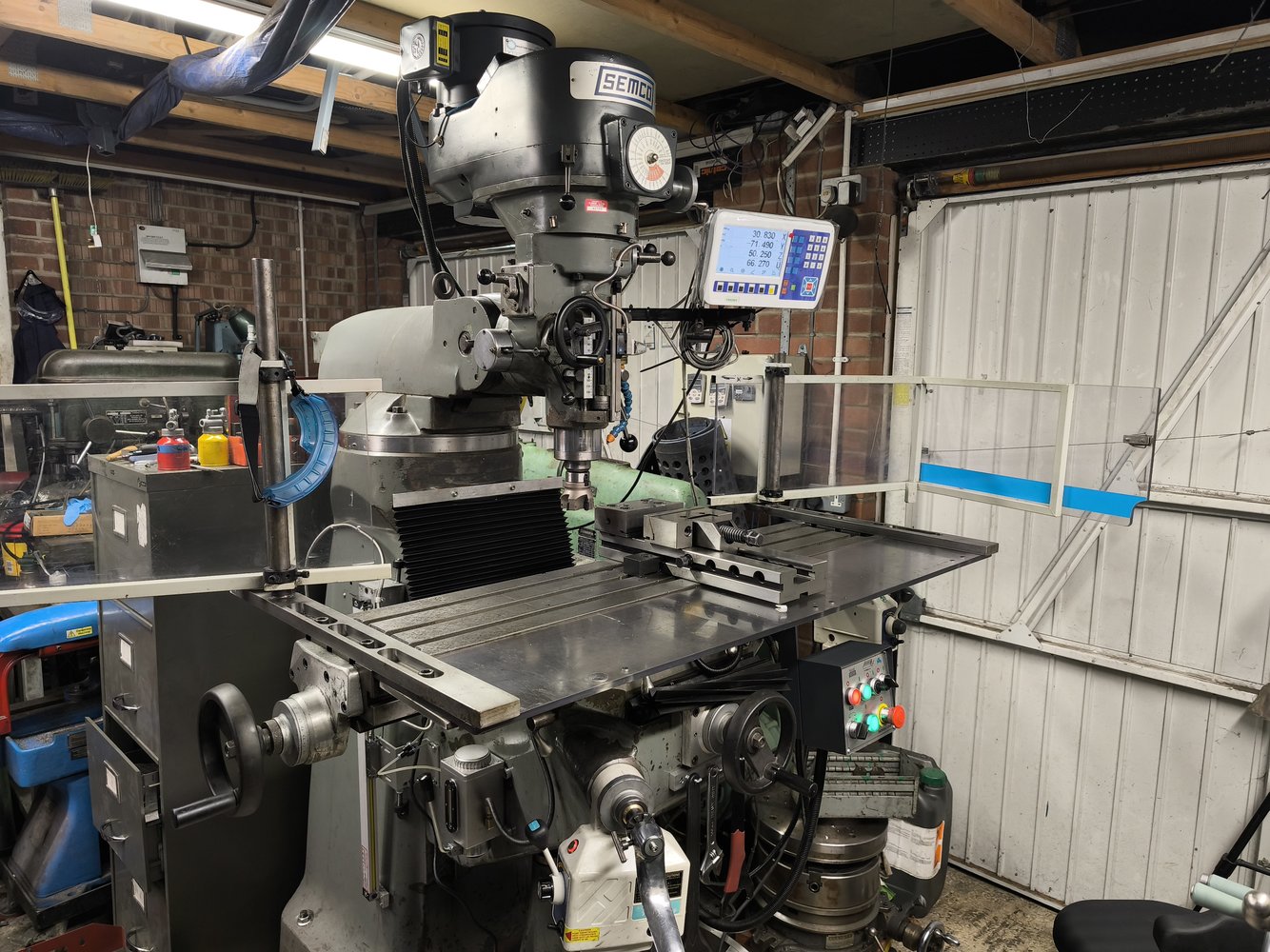

A 'dust' / chip guard to protect the ways.
In hindsight, I should have just gone for a smooth piece of rubber. The chips get stuck in that style way cover.

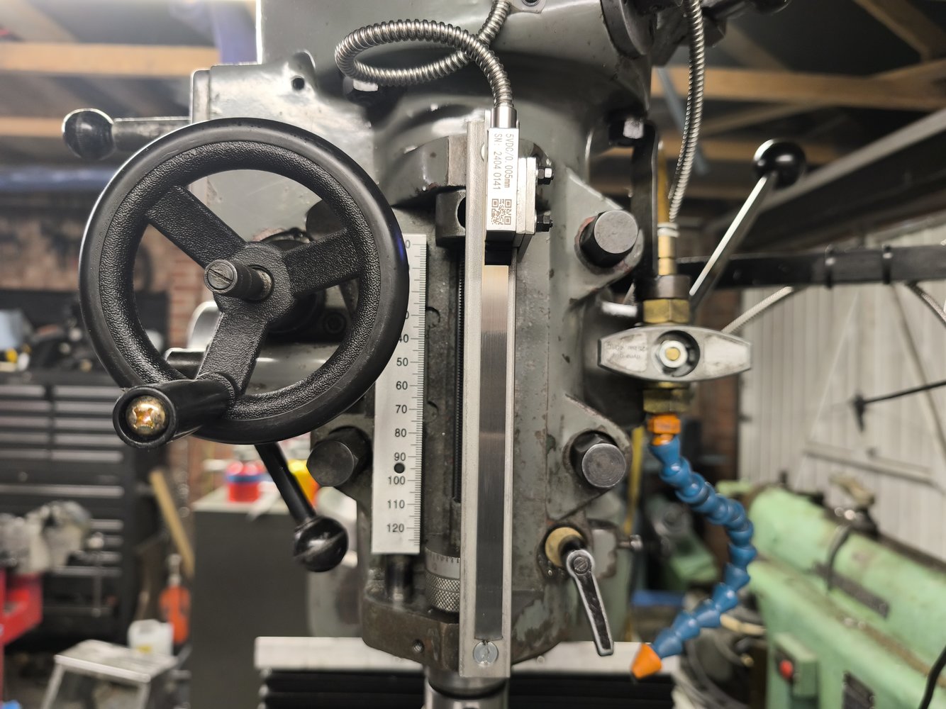

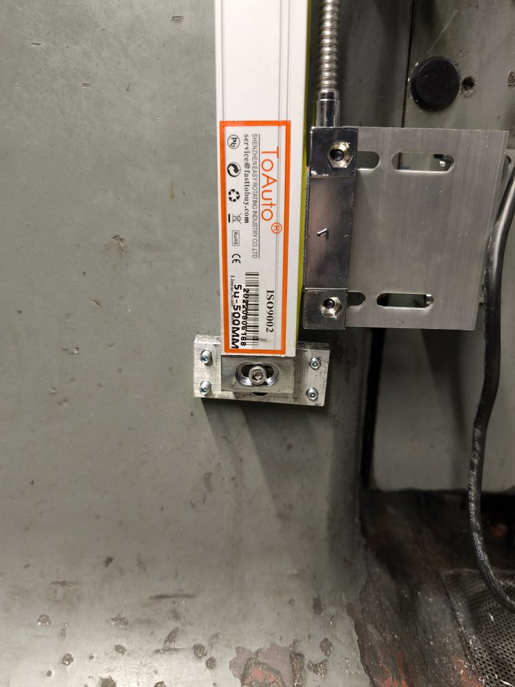

I installed a scale for the quill.

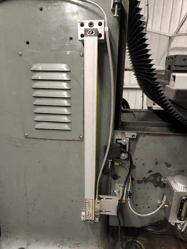

Also a scale on the knee.
It took me ages to get that scale aligned. I must have wound the knee up and down 30 times. Some blocks with jacking bolts were installed to get it all aligned.

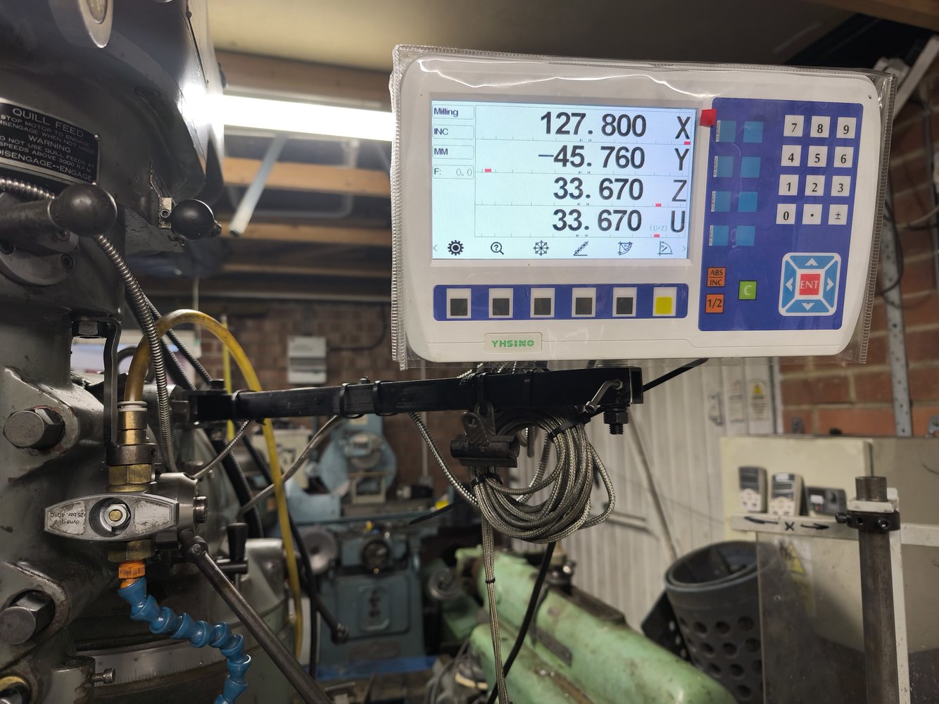

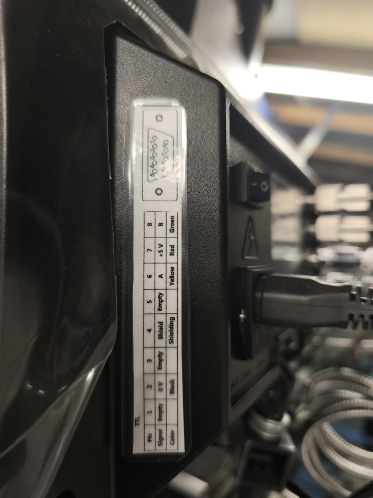

ALL the scales had to be rewired for the Chinese 5-axis DRO. I printed and laminated the scale pinout which the DRO uses for future reference.
The 5-axis DRO (I am only using 4-axis).
It has got a really cool summing feature built in. The Z-axis (quill) and U-axis (knee) can be summed so you can get an accurate reading regardless if you move the quill or the knee.

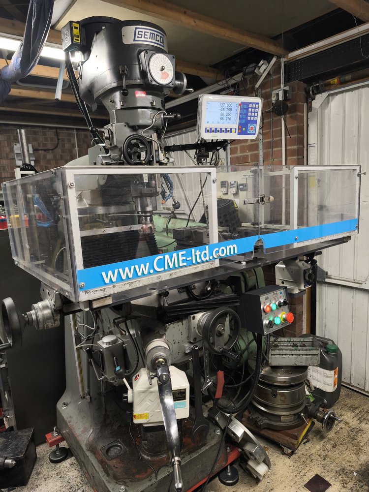

Finally, I re-installed the guards the machine came with.
I have a bit of a love/hate relationship with those guards.
Pros:
1. They contain the mess/chips to a degree.
2. I have to dodge less hot chips.
3. In theory, the machine is a little safer.
Cons:
1. The guards take up quite a bit of space.
2. It can be a pain to open/close the guards each time you want access.
I did remove the guard switches so the machine can be run with the guards open.
