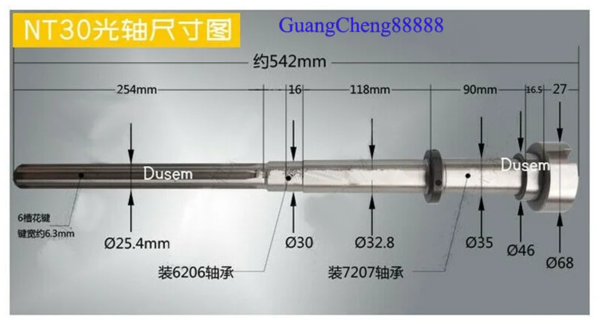

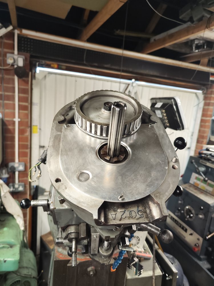

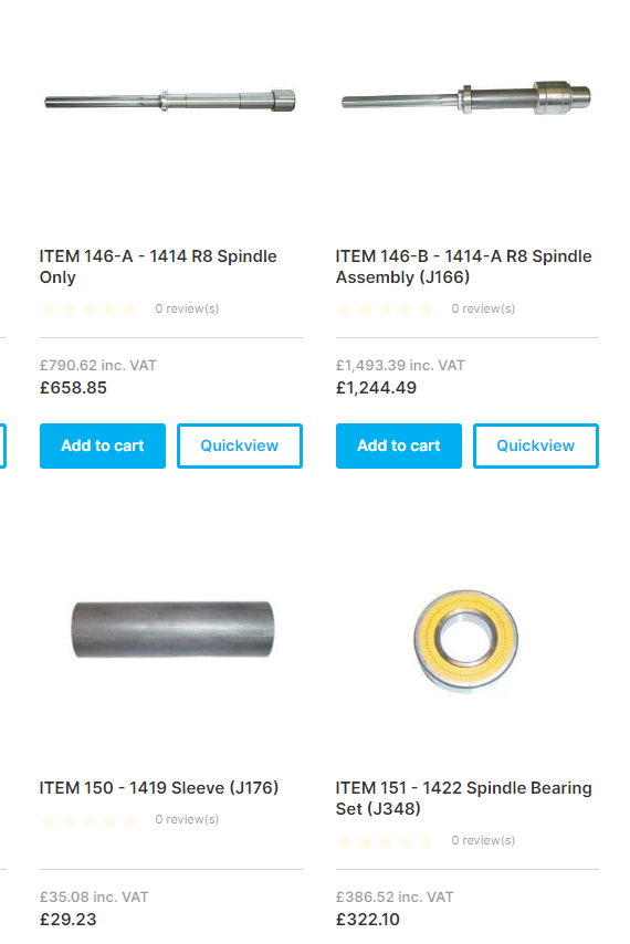

Yes spacers need checking on surface plateMate paid through his company so I got these . Had him check spacers in his inspection room as have to be absolutely parallel
can get very expensive ...
Just run the machine up and if theres no play or noise cheaper to go R8 route
