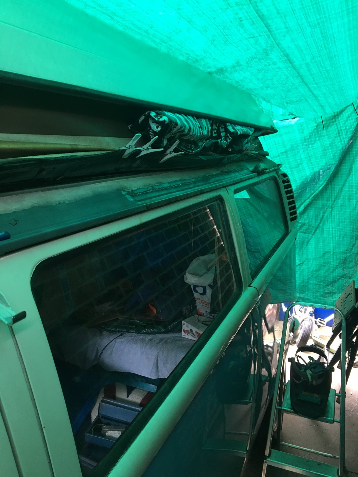

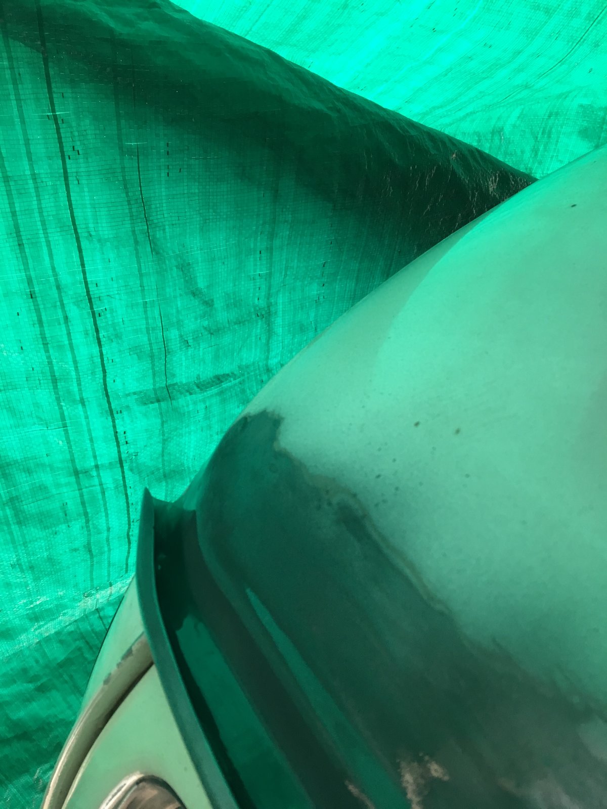

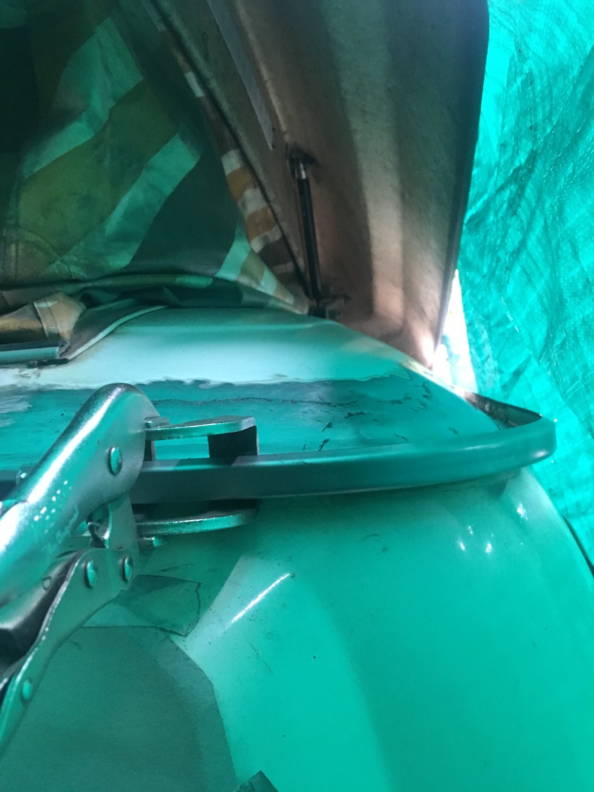

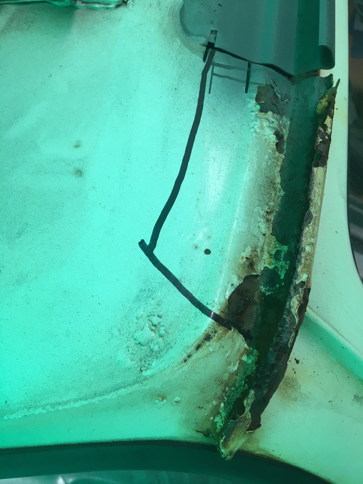

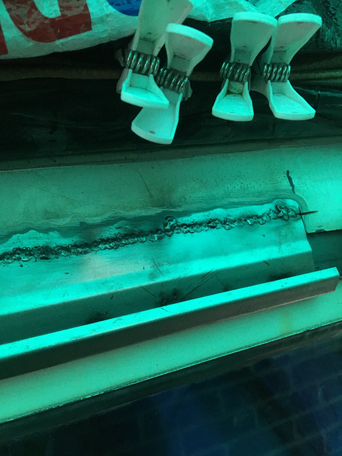

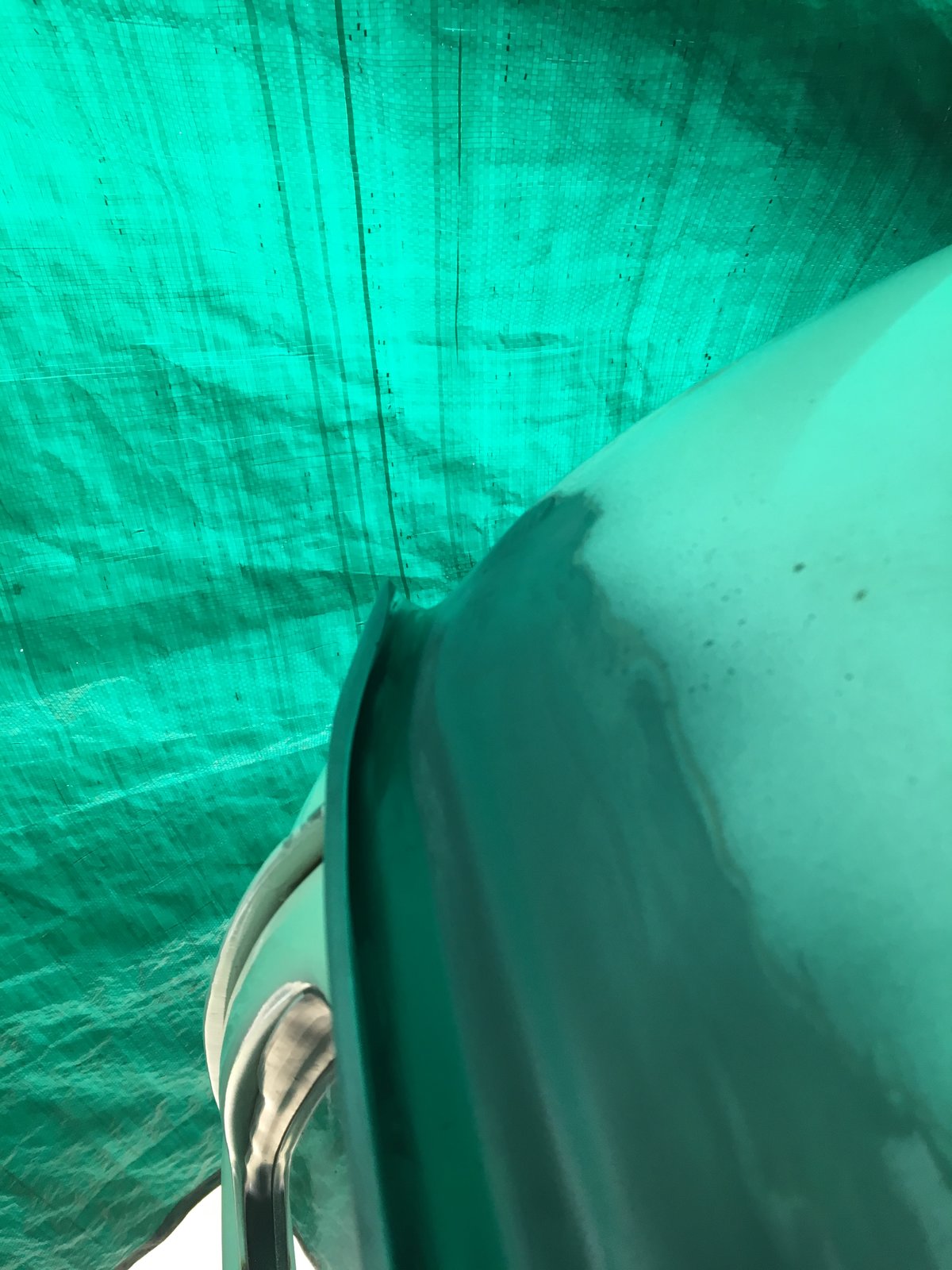

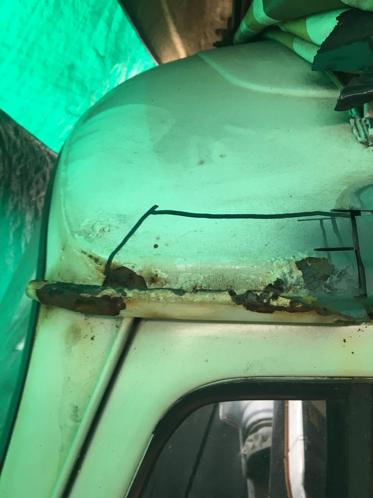

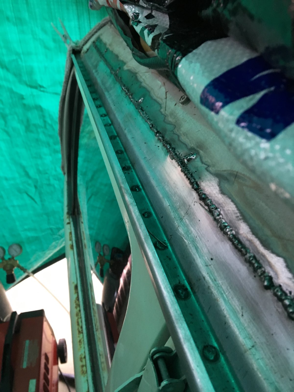

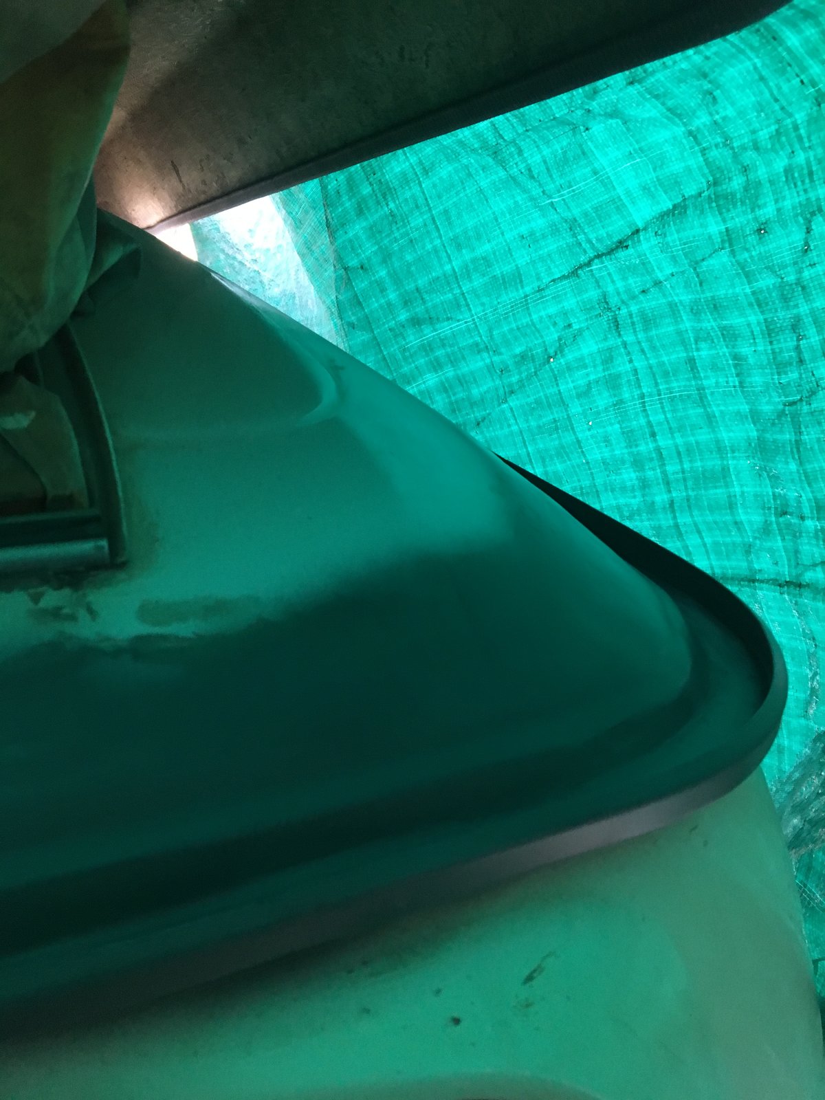

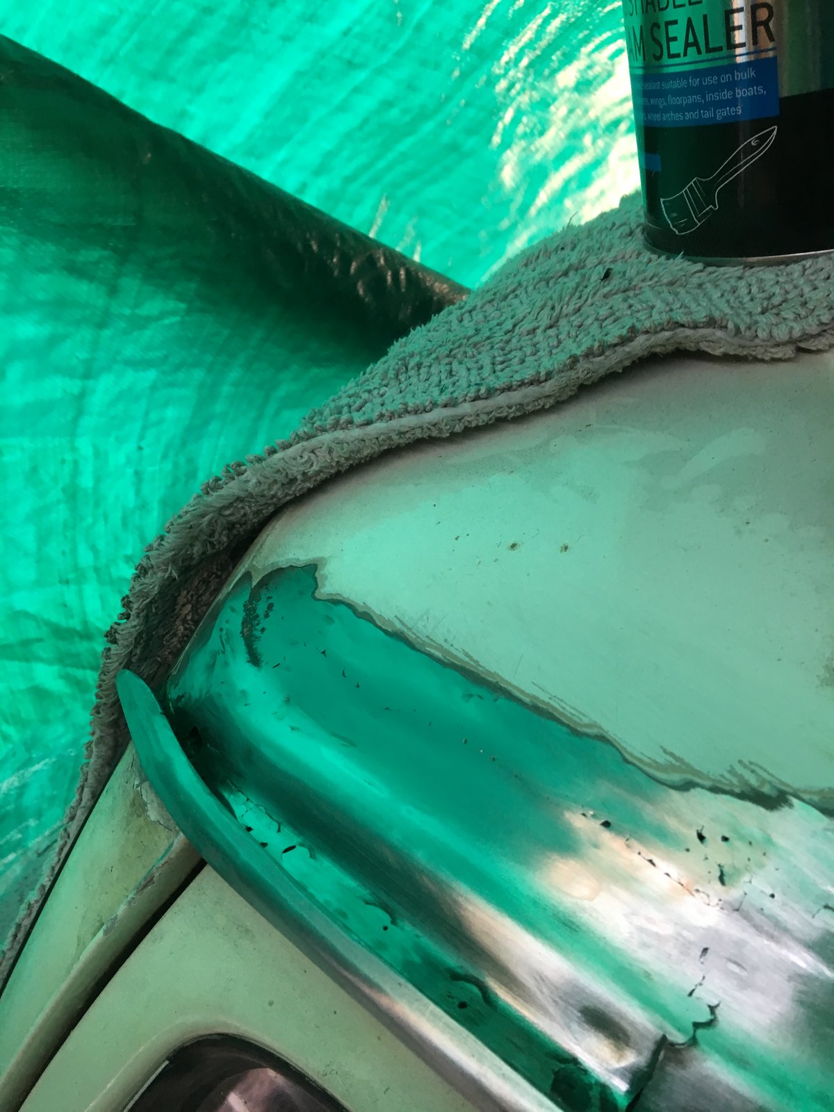

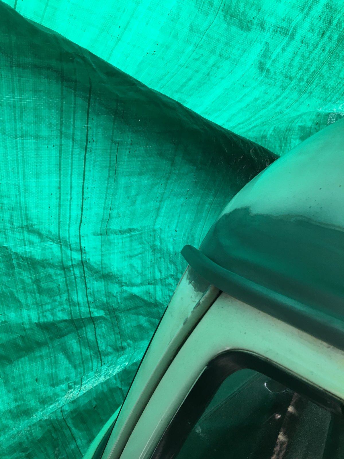

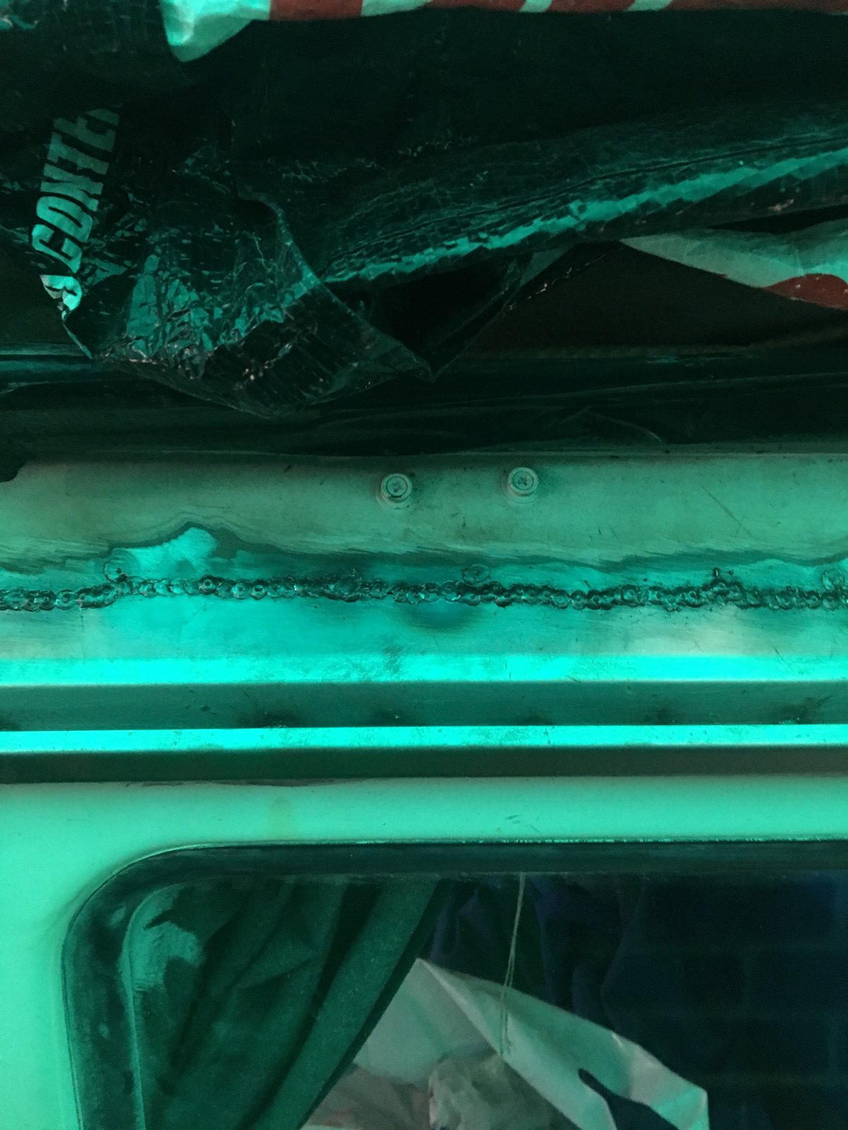

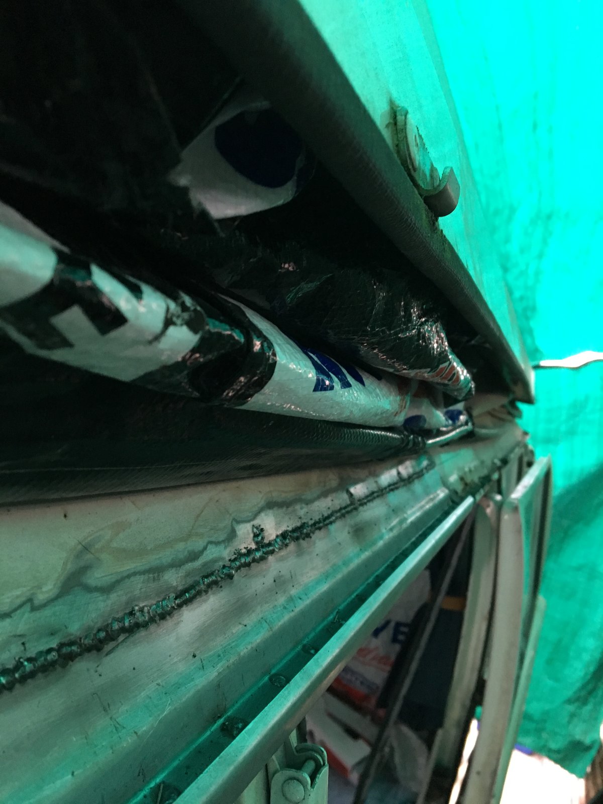

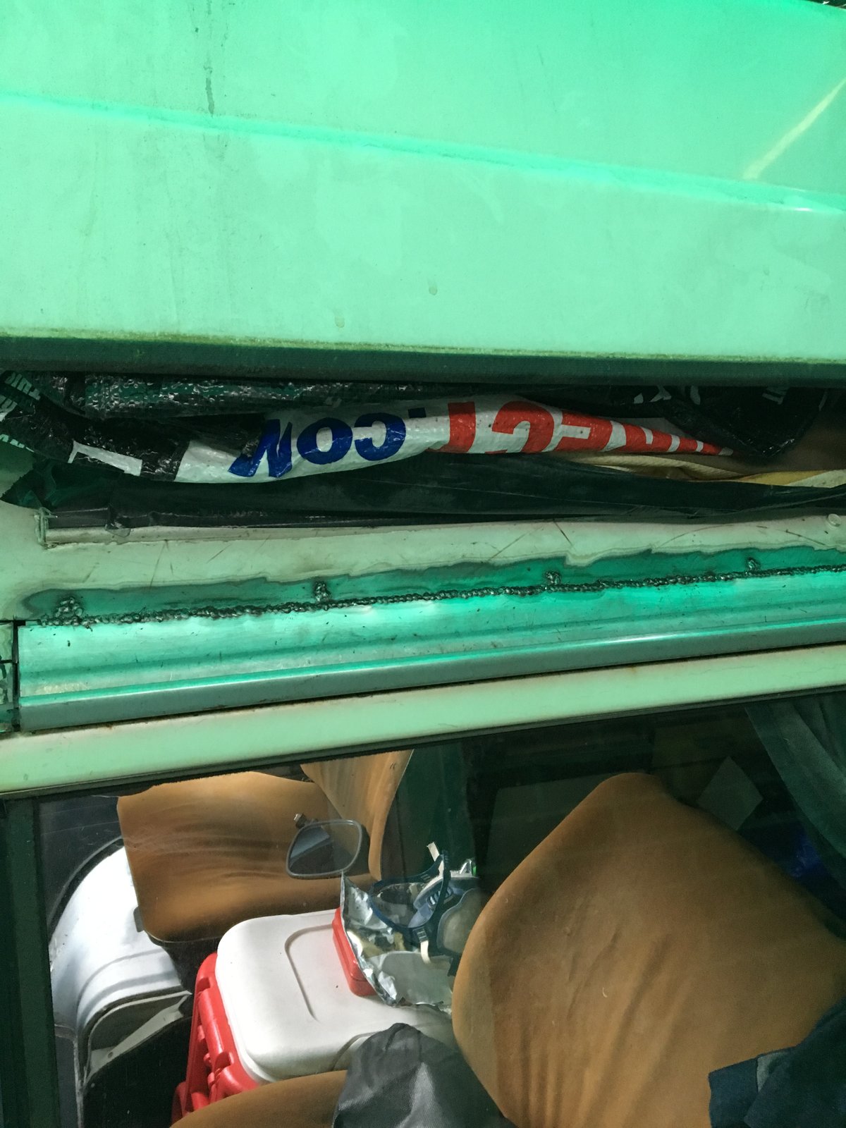

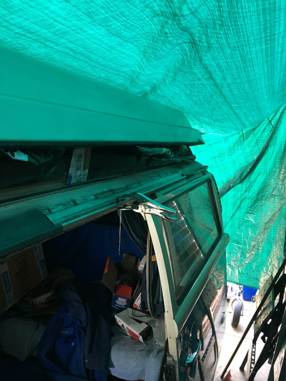

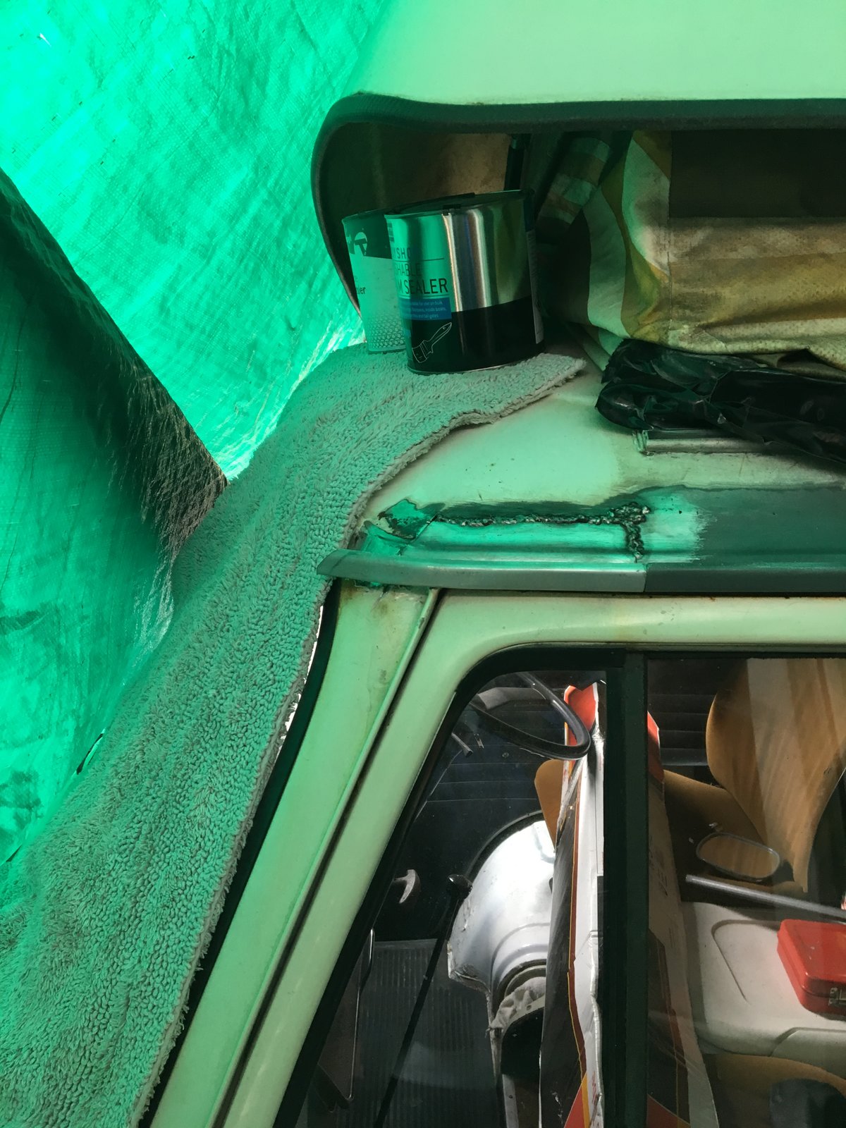

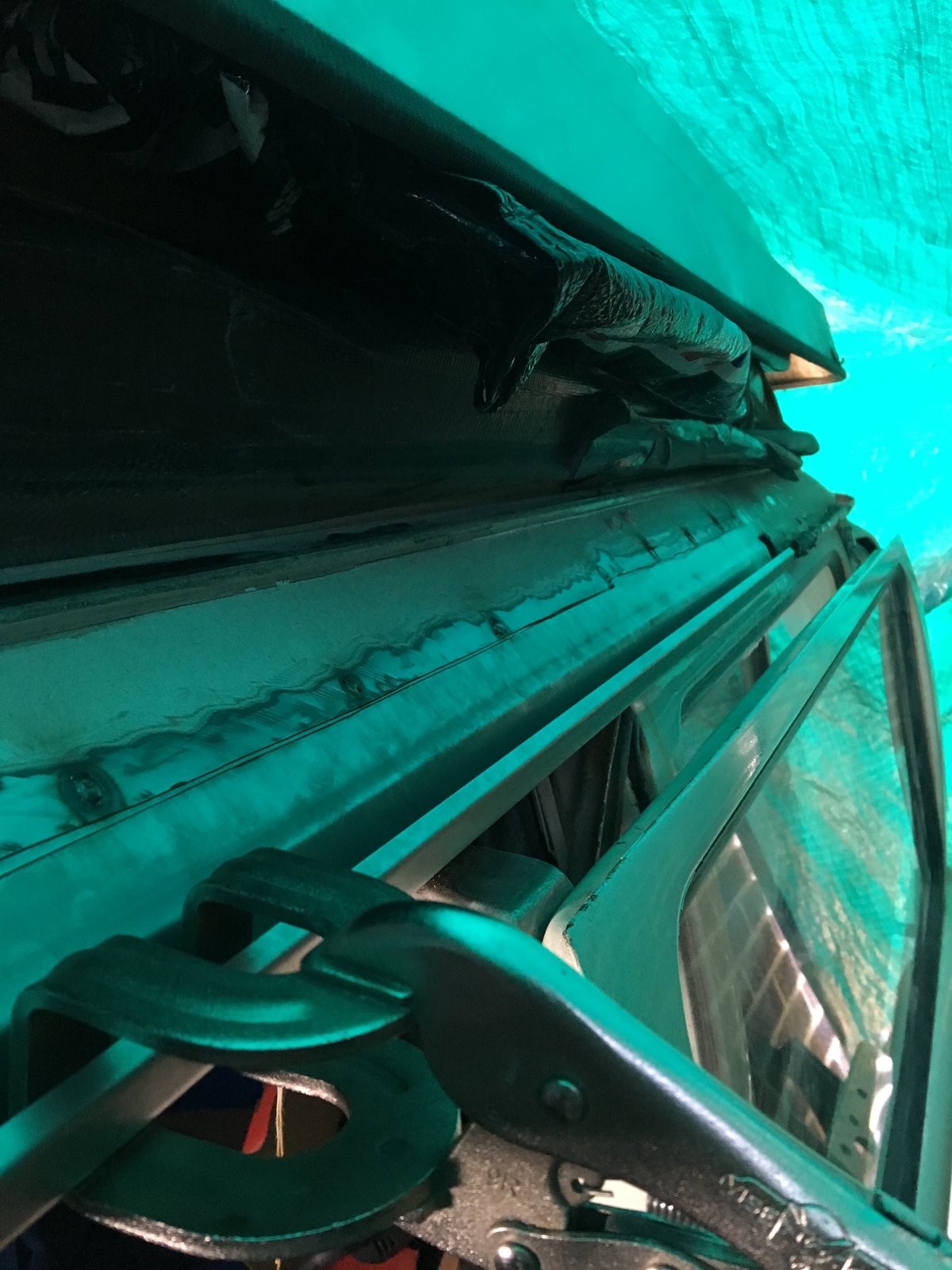

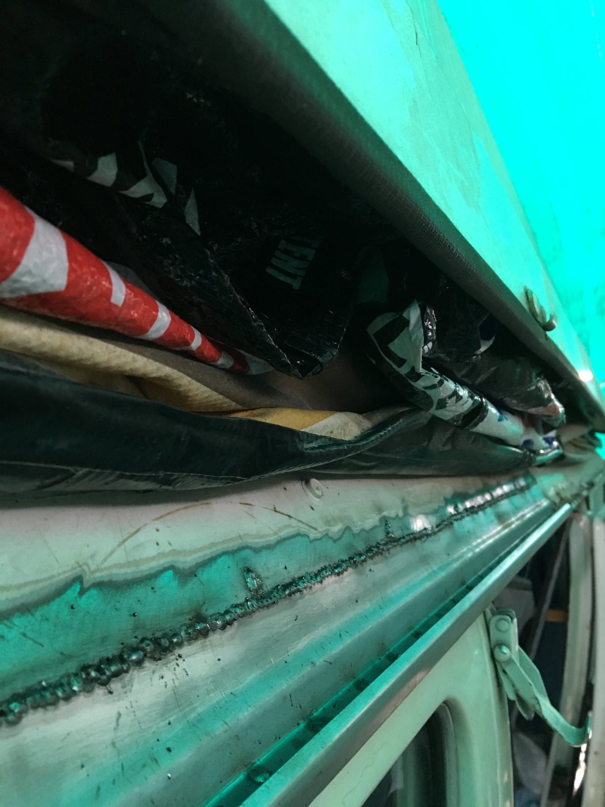

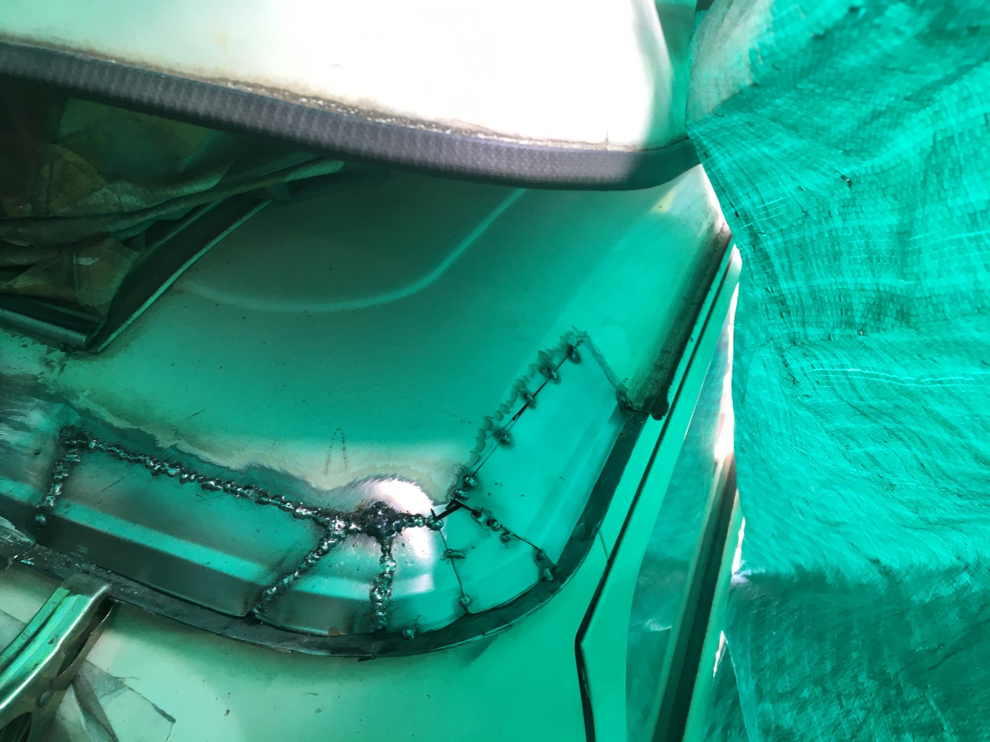

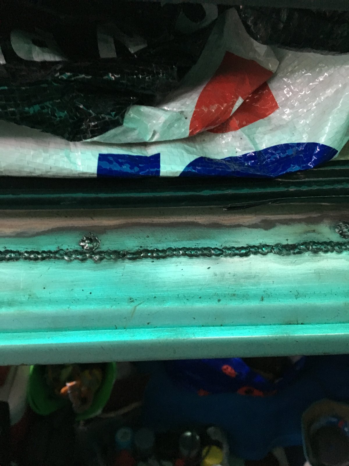

First repair panel welded in. I followed the same process as before by fitting a support strip, using spot welds, under the parent metal.

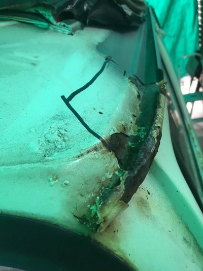

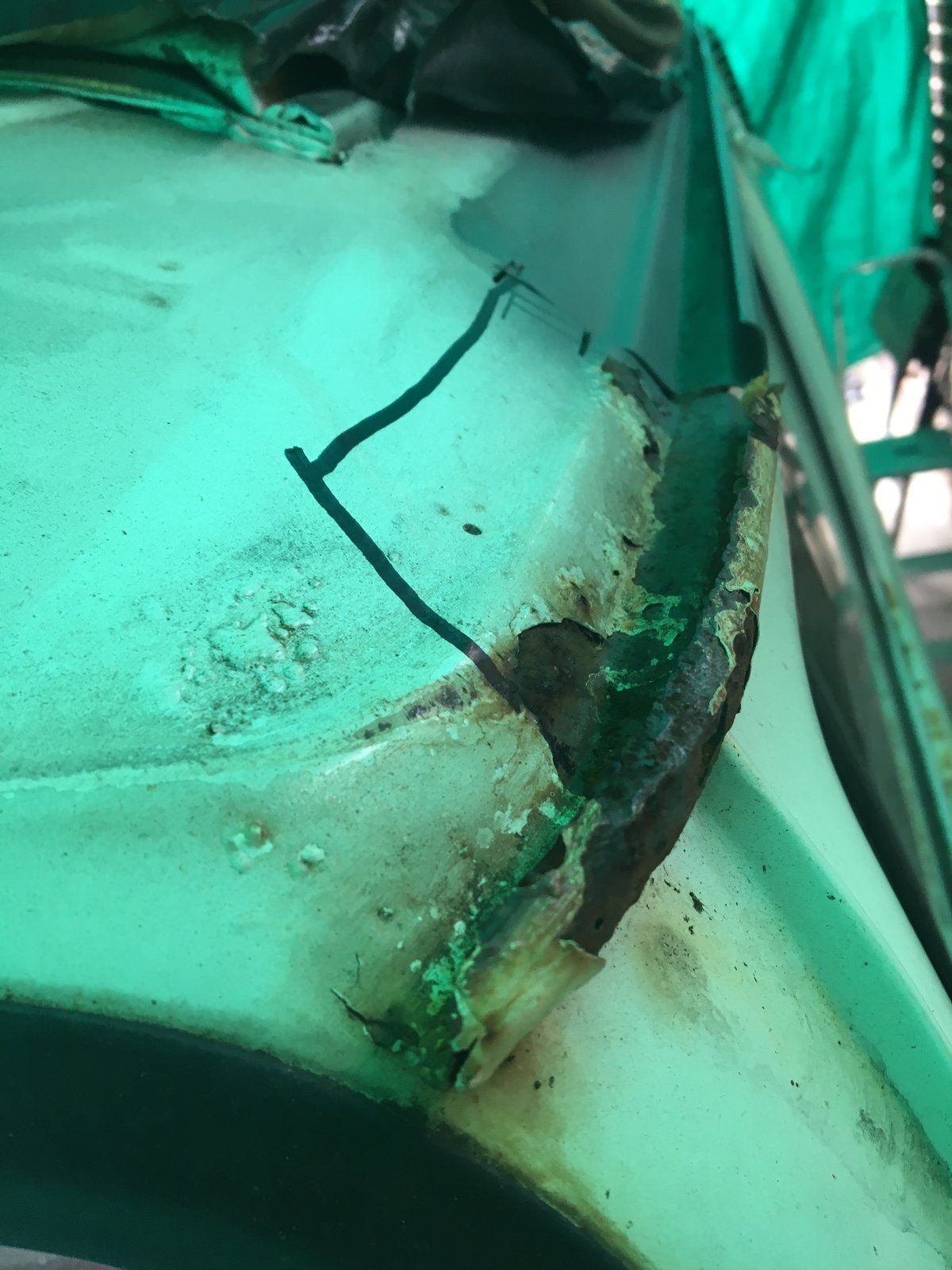

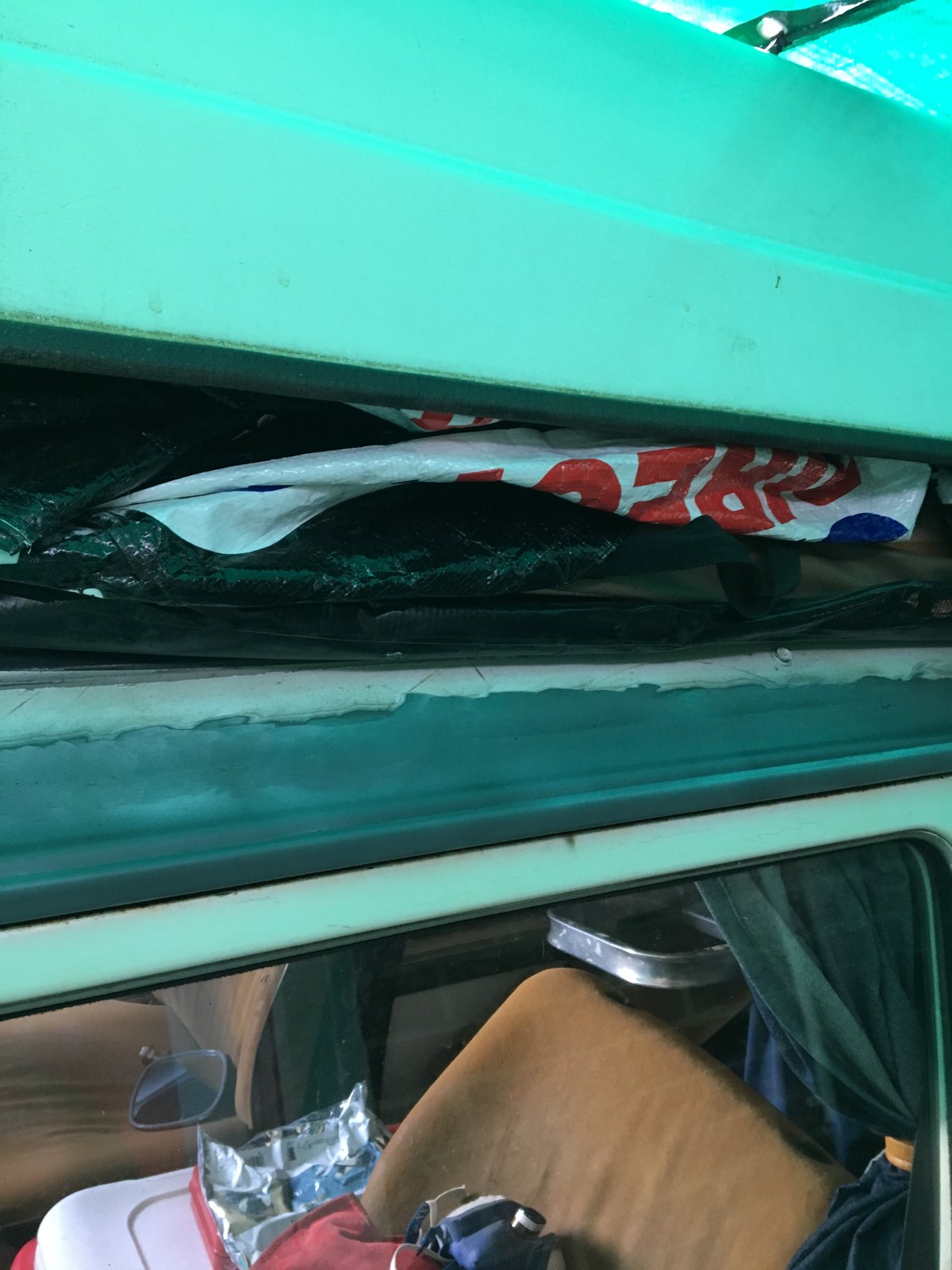

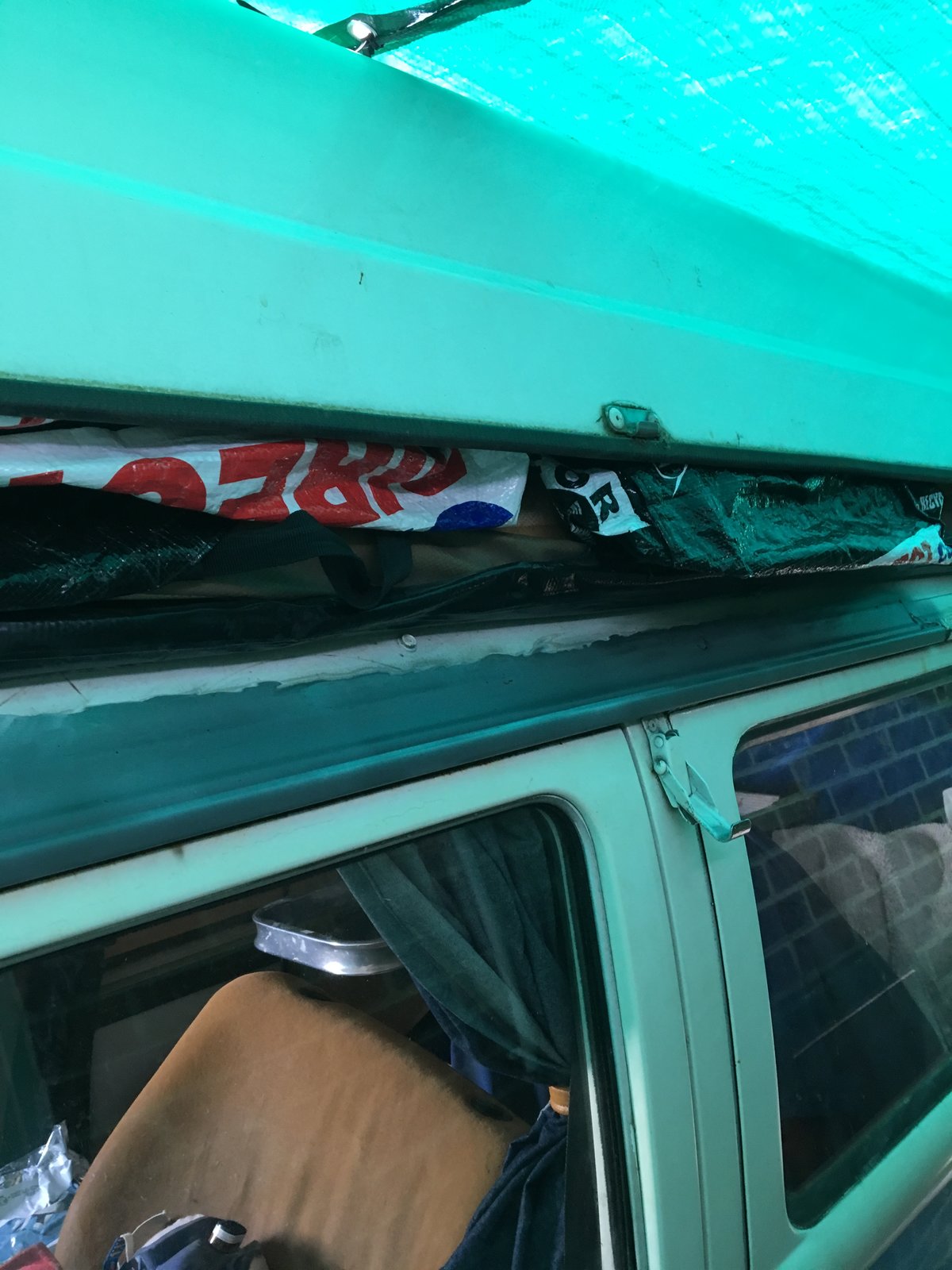

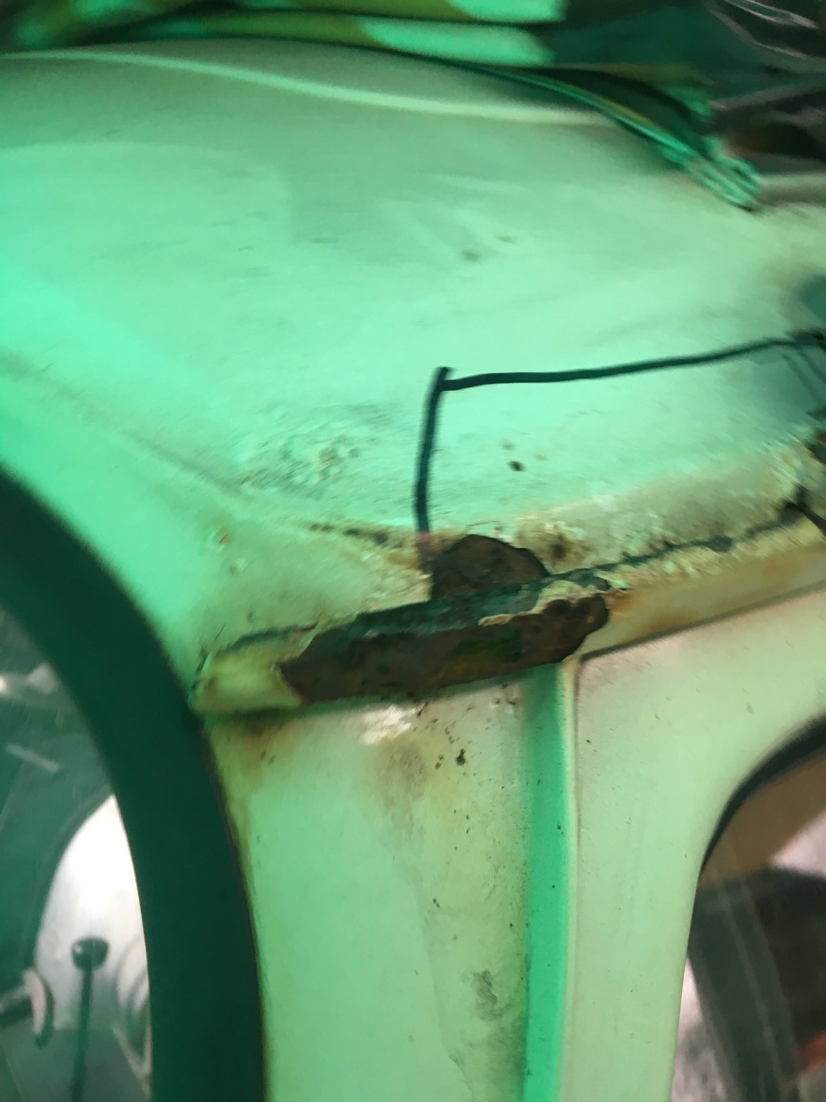

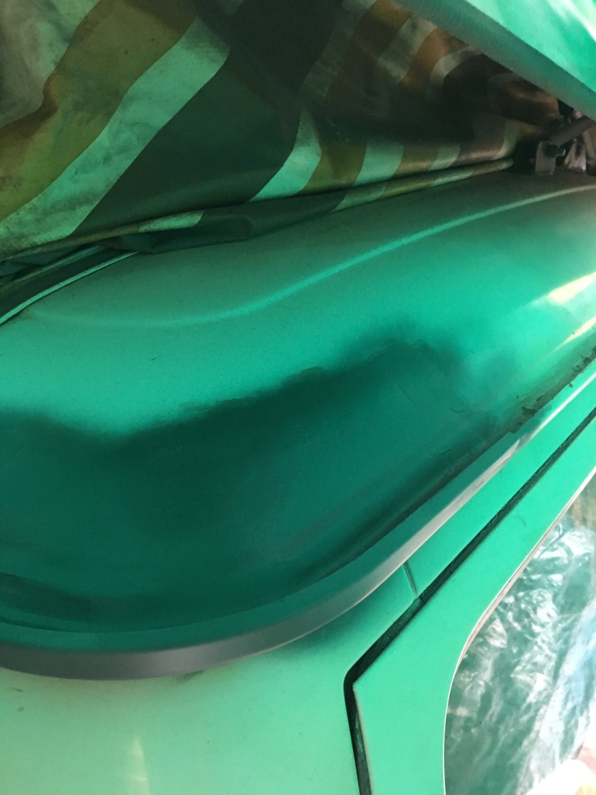

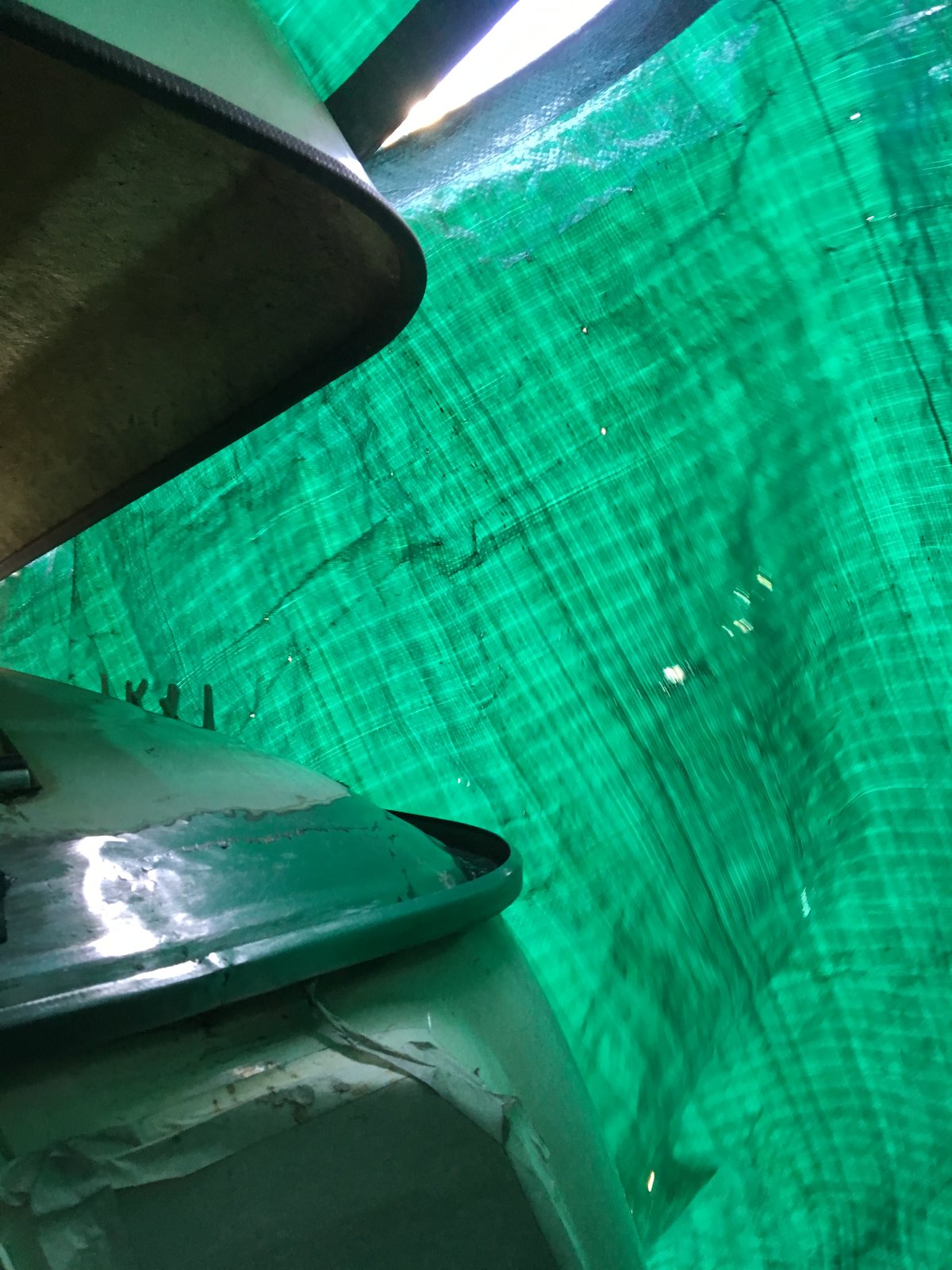

The rust hasn’t spread up as far on this side so I’ve shortened the repair panel so I’m keeping as much of the original metal as possible.
